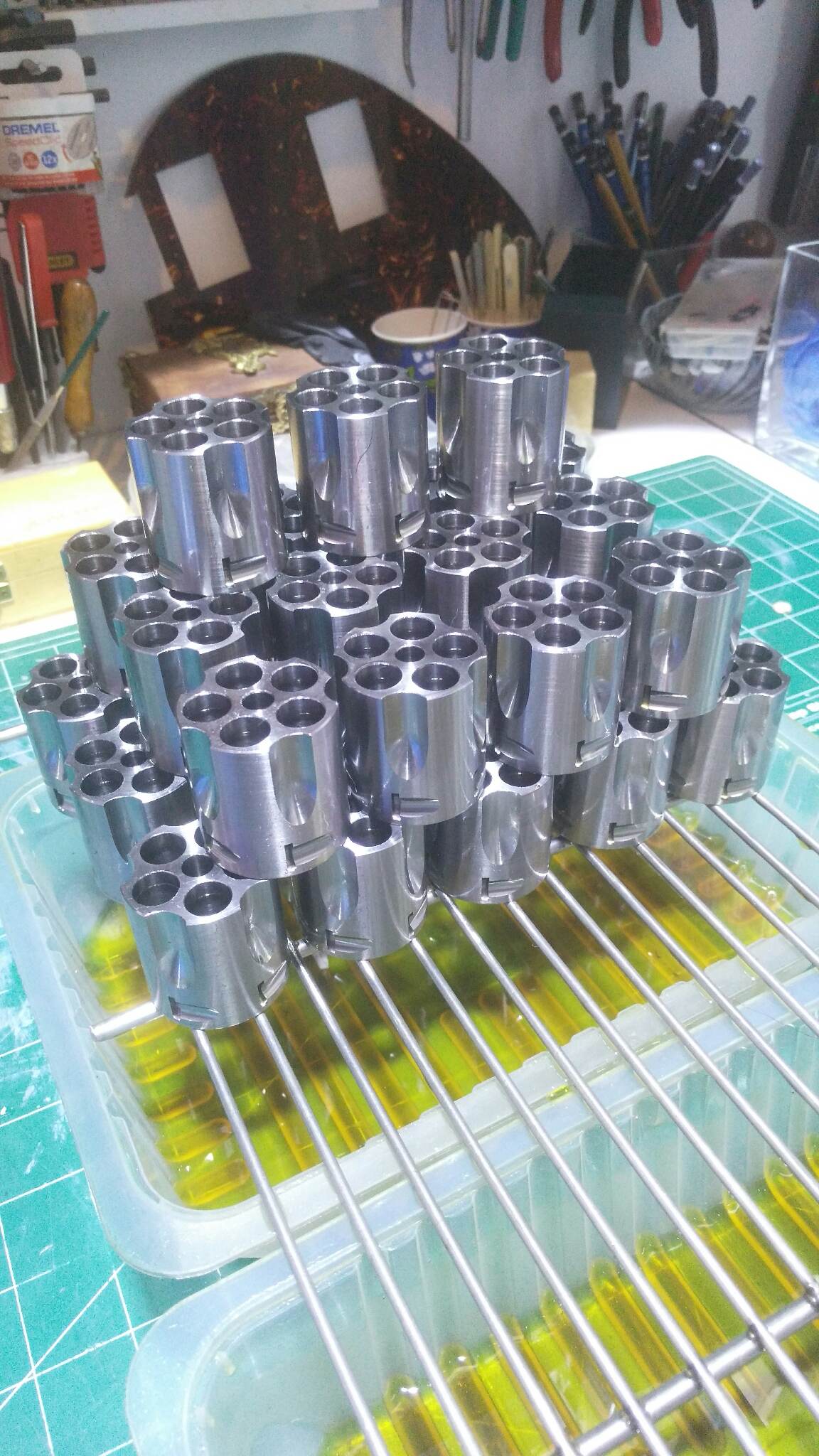

After packing up the cylinders, these are what's left. Steel only. Once these are gone, that's it.

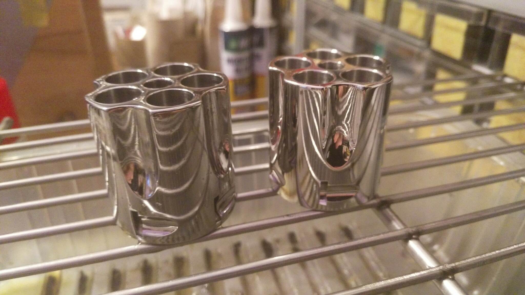

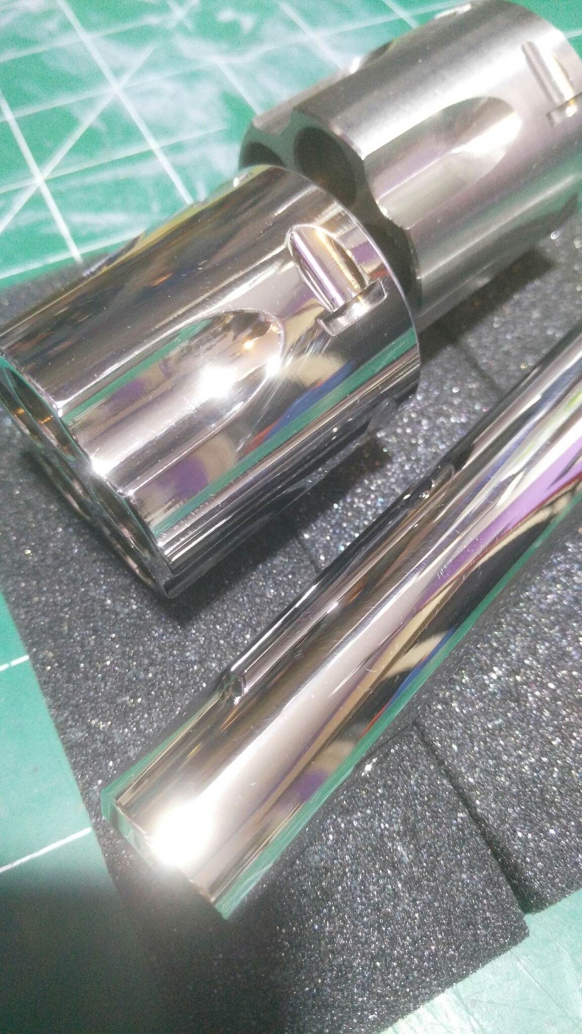

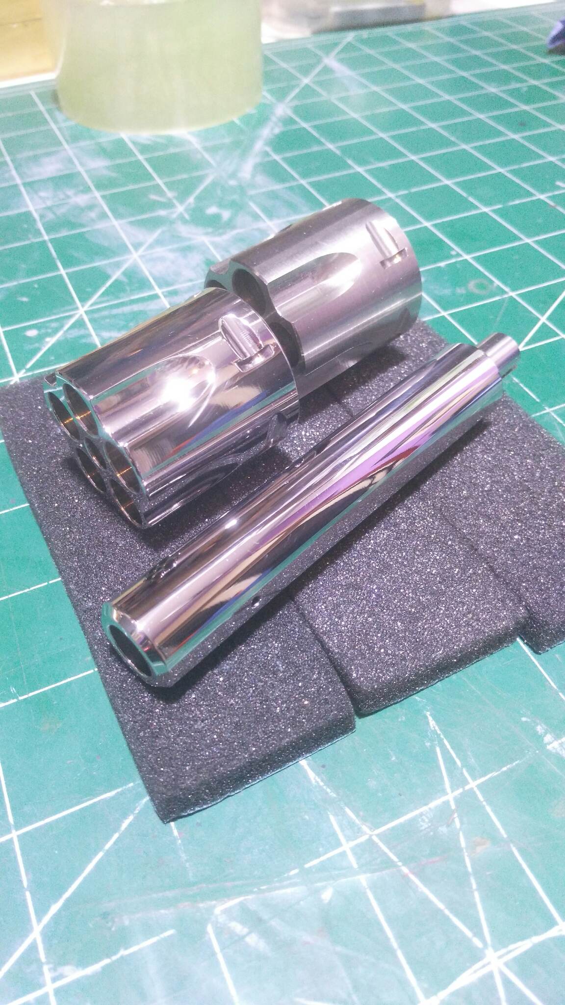

Before being packed up, I snapped a shot of a polished stainless duo next to a machined finish stainless cylinder. I love how 304 polishes.
Here's a machined finish stainless barrel with some color to it. That's not heat color, that's just the surface finish messing with light.

Color difference aside... the steel is darker whereas the stainless steel is brighter... the steel cylinder polishes up really nicely. The stainless is still my favorite.

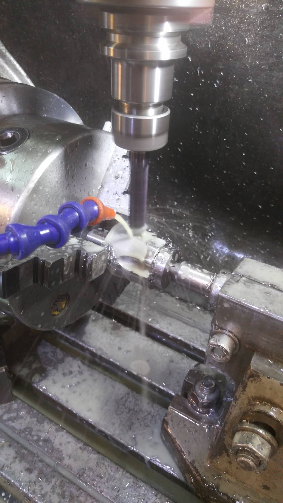

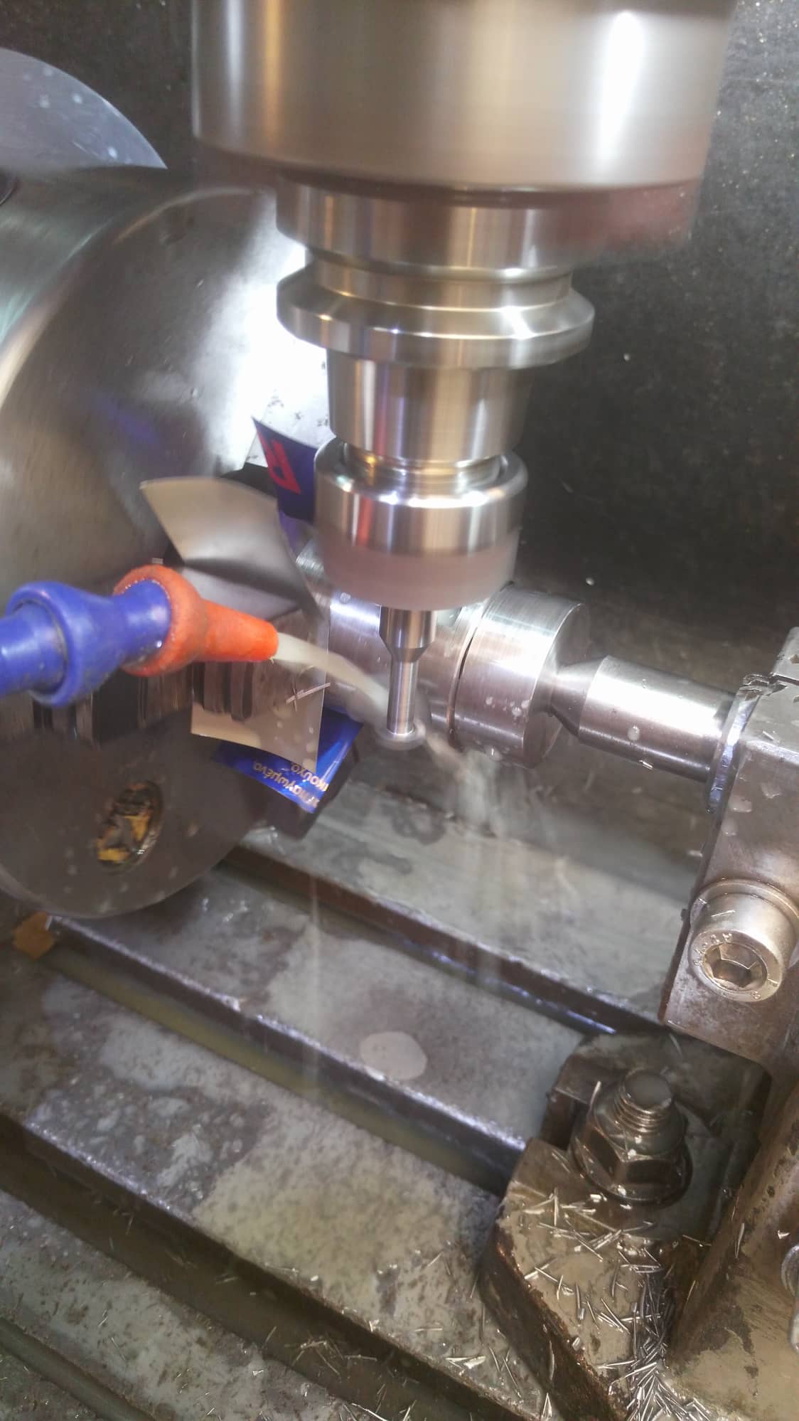

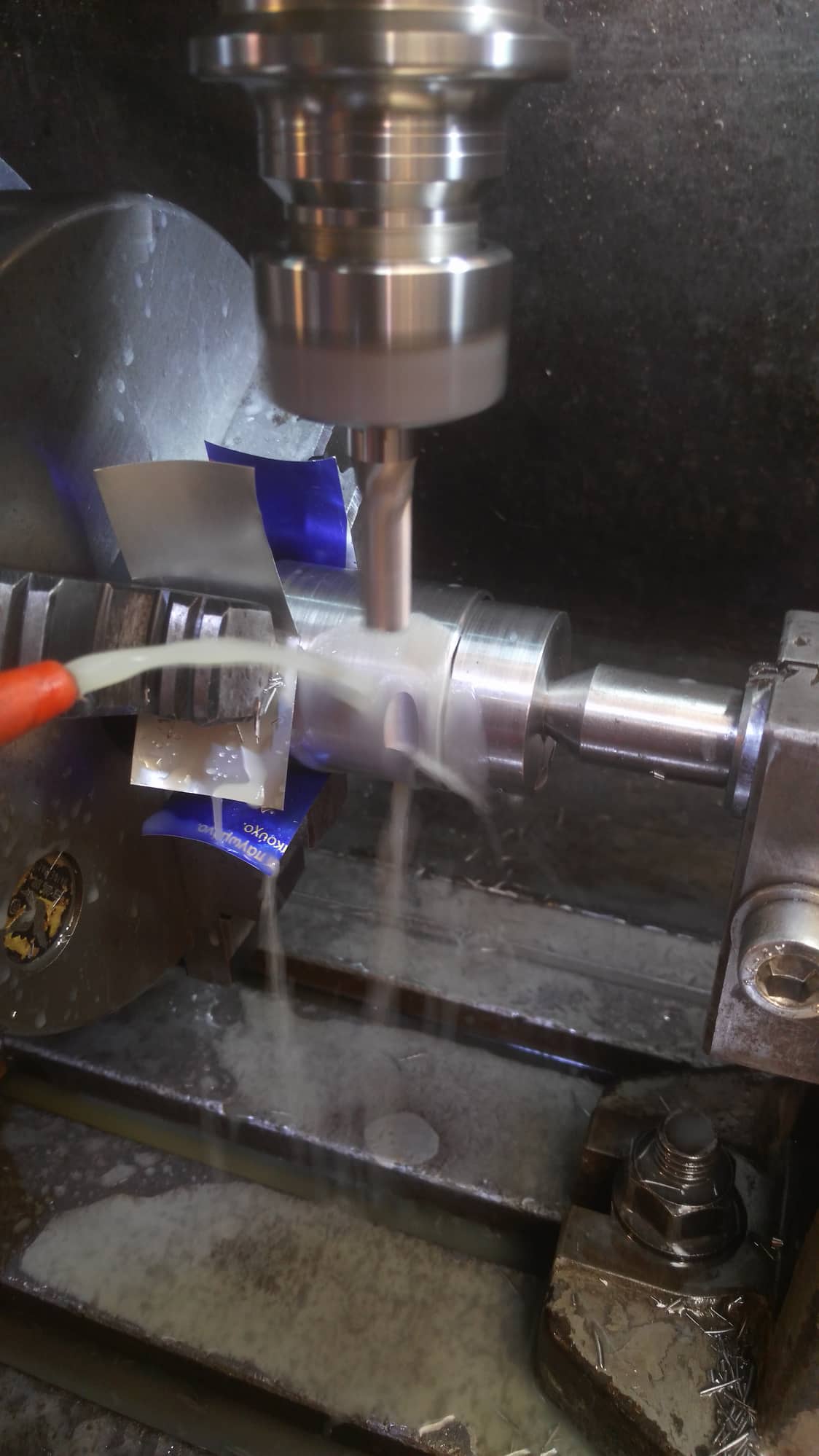

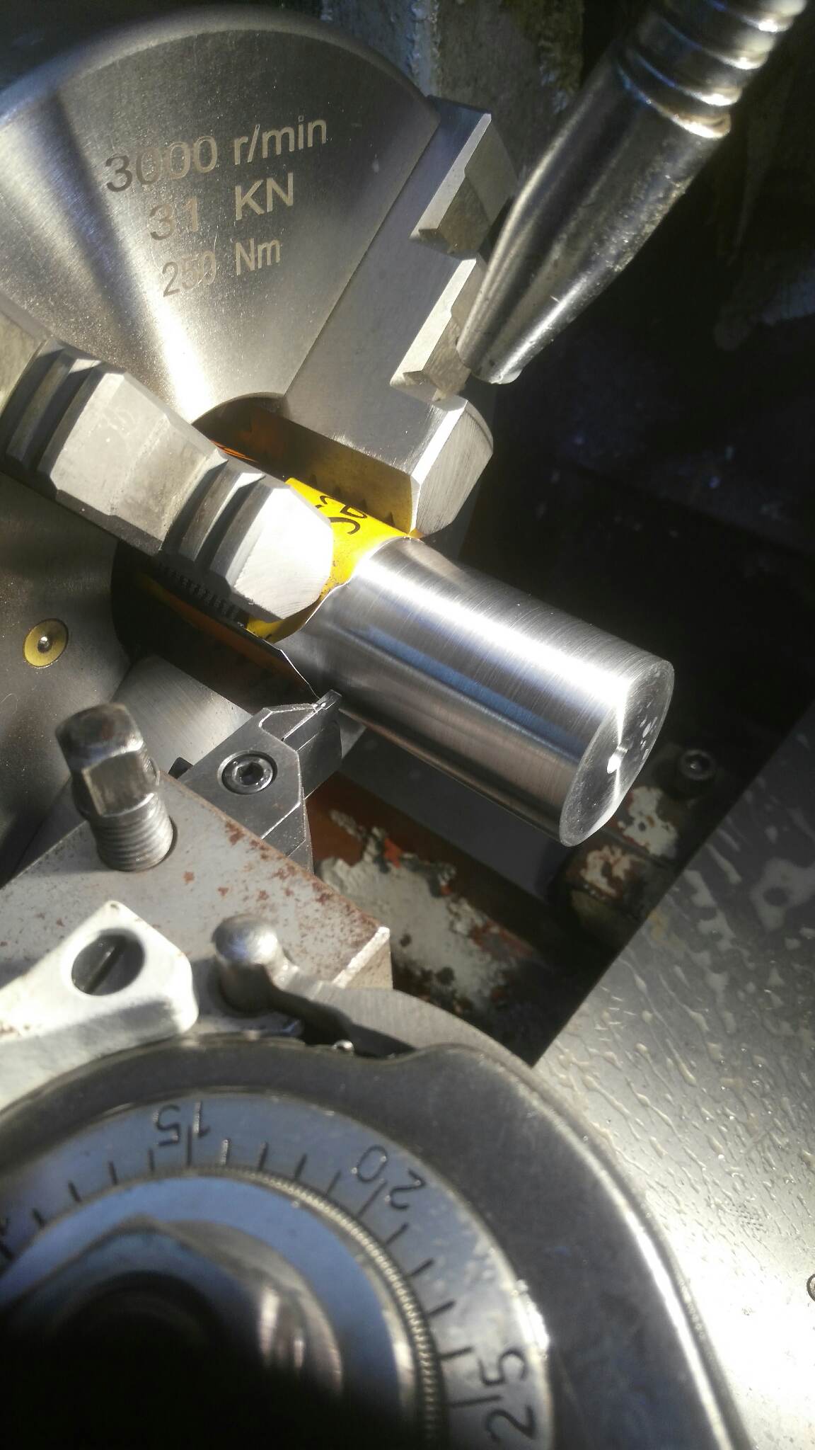

I thought I had pictures of all the steps, but I can't seem to find the main body drilling pics (If I find them, I'll update them). Oh well, until then, here are the steps it took to make one of these cylinders...
All the operations on the lathe are manual, meaning I'm making the machine go brrrrrr. The mill is mostly cnc controlled, but there were points that I flipped it back to manual control.
Step 1.
Cut slugs of 10cm long from bar stock. Each one will give me two cylinder blanks.

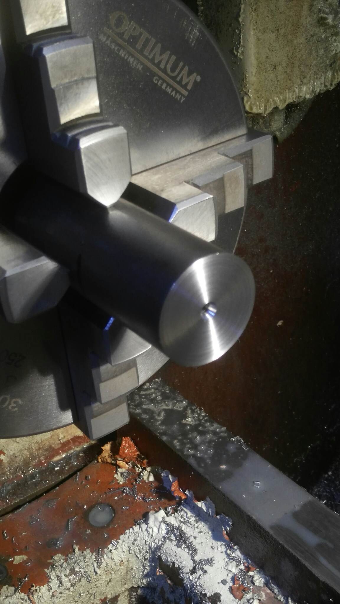

Step 2.
Face off first side of slug and drill center point. Drill 4mm hole 1/2 way into slug.

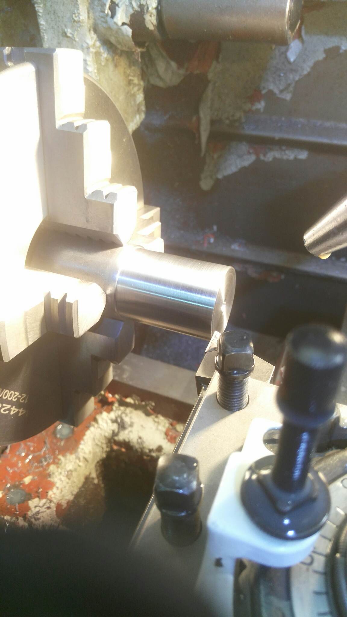

Step 3.
Turn OD to spec on first half of slug.
Step 4.
Wrap part with aluminum from a soda can and turn around to repeat steps 2 and 3 on the second side.
Step 5.

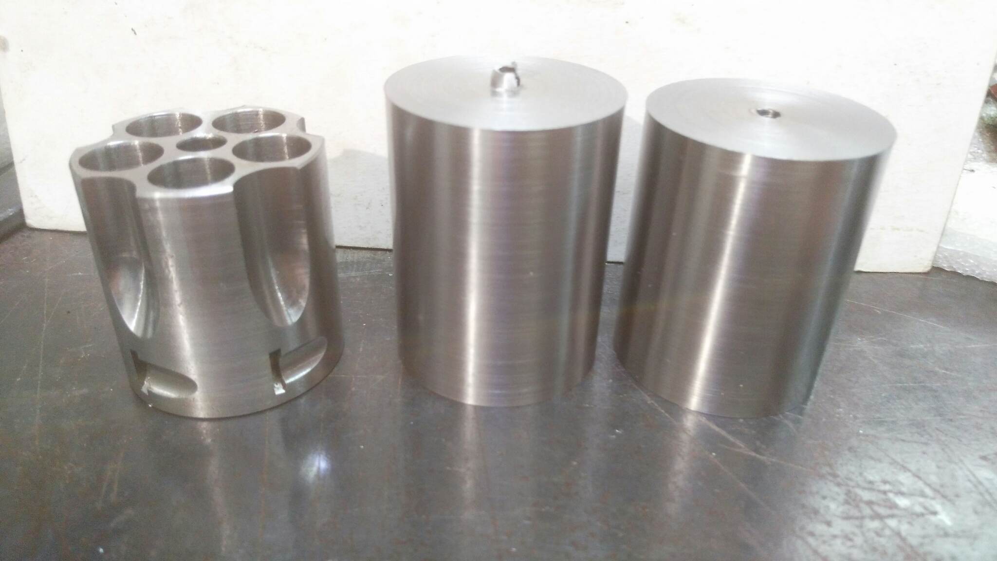

With parting tool, at roughly 1/2 way, part slug into two cylinder blanks.
Step 6.
With cylinder blank in the lathe, cut-side out, blank is brought to specified length.
Step 7.
First operation in the mill is the 7mm hole on the forward facing side.
Step 8.
Next comes the 8mm hole in the back of the cylinder.
Step 9.
With 8mm side facing up, center points are drilled for the main holes.
Step 10.
Center points drilled, 10mm drill is used to drill through the cylinder body.
Step 11.
11.5 mm drill is now used to chase the 10mm hole part way down.
Step 12.
11.8 mm reamer is used to chase the 11.5mm hole and bring it to size and depth.
Step 13.
11 mm reamer is used to chase what remains of the 10.5mm initially drilled.
Step 14.
8mm end mill is loaded to open 3x 1.5mm deep pockets to allow clearance for the 2mm end mill in the next op.
Step 15.
2mm end mill is loaded up to open 3x slots in the 8mm pockets.
Step 16.
Back onto the lathe to open the recess on the side with the slots for the ejector mechanism.
Step 17.
First of the catches, 8mm end mill.
Step 18.
10 mm x 2 mm T-Slot end mill.
Step 19.
Ball nose end mill loaded for the flutes.
And that's most of what it took to make them.
