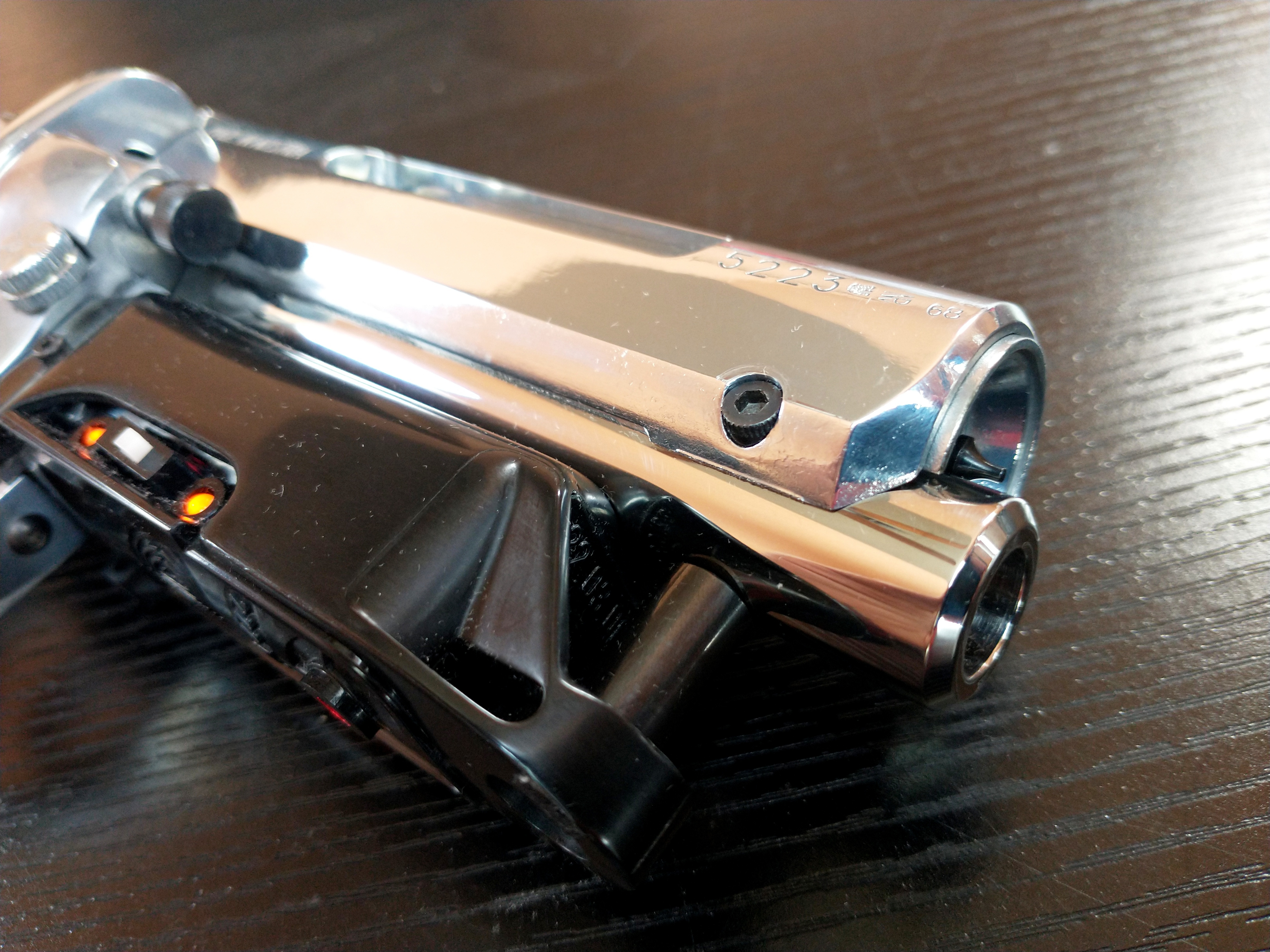

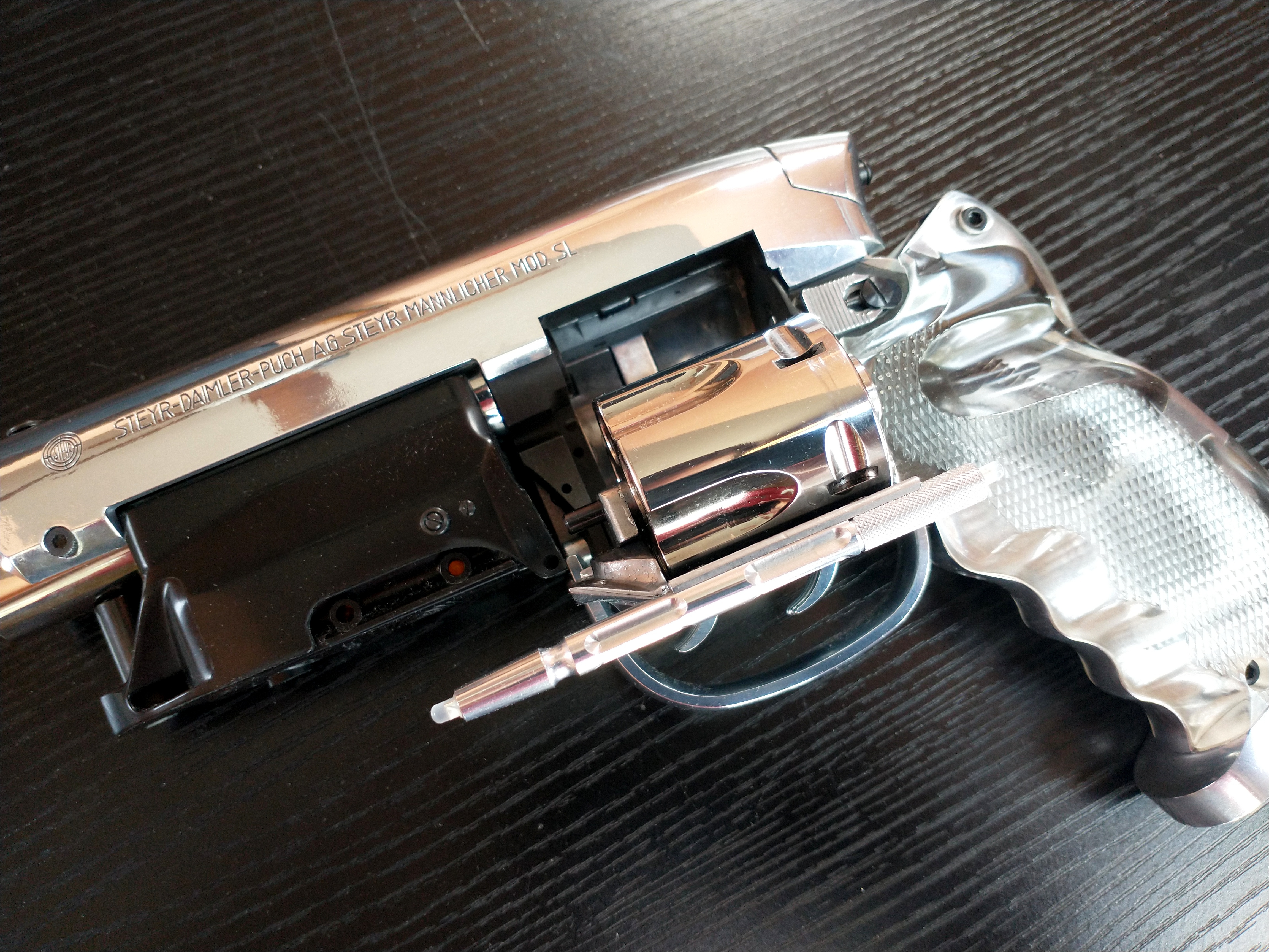

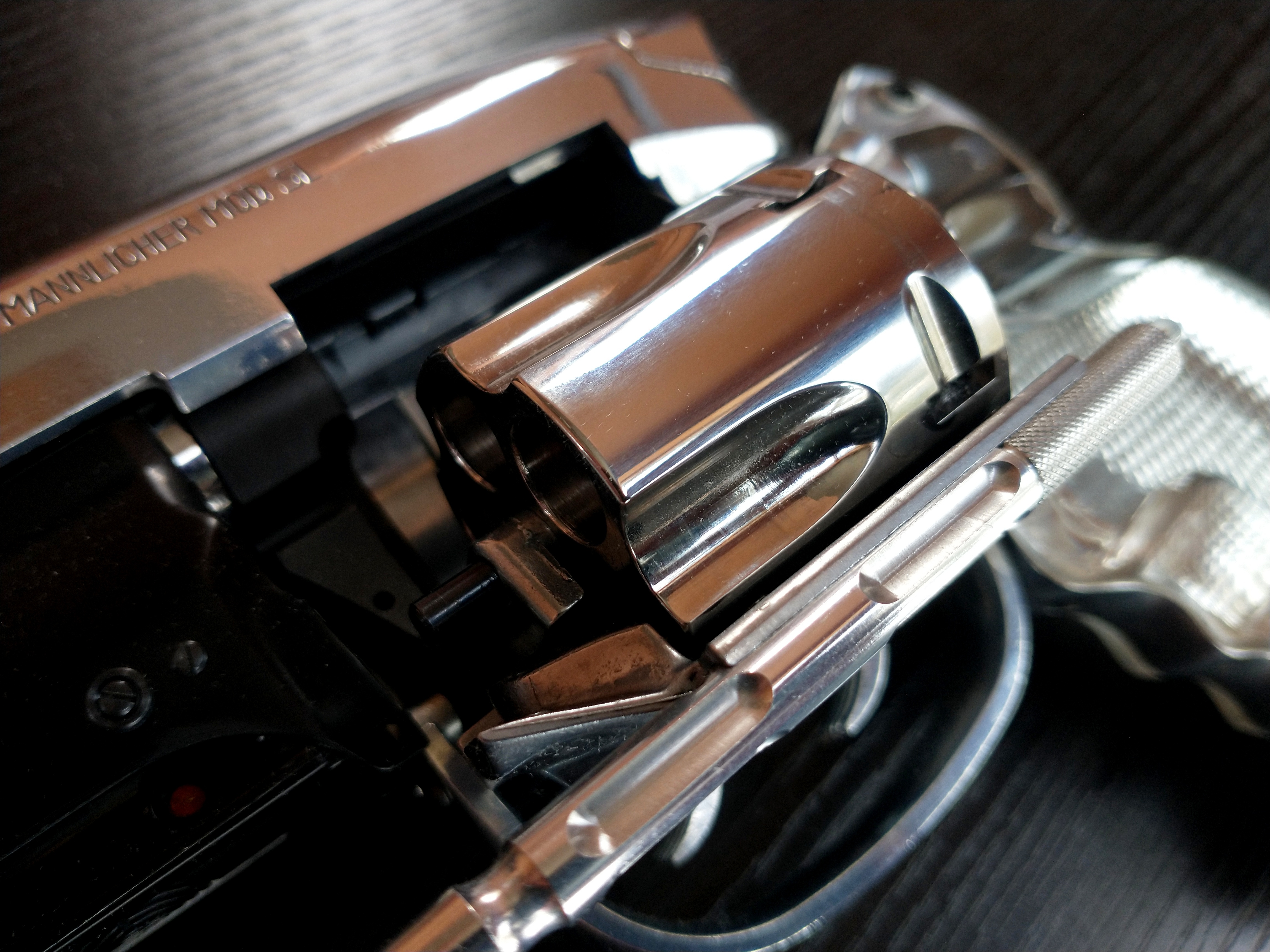

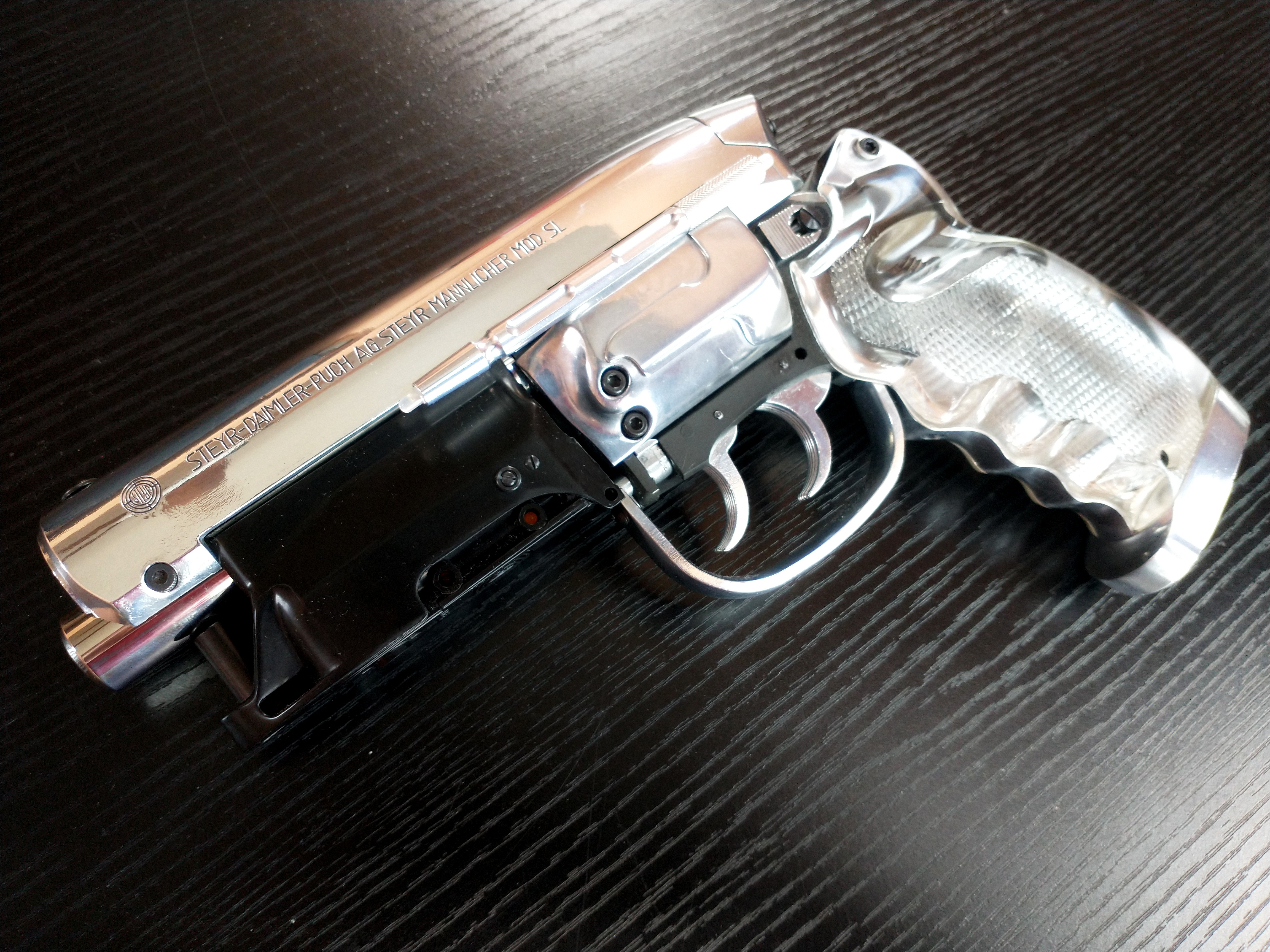

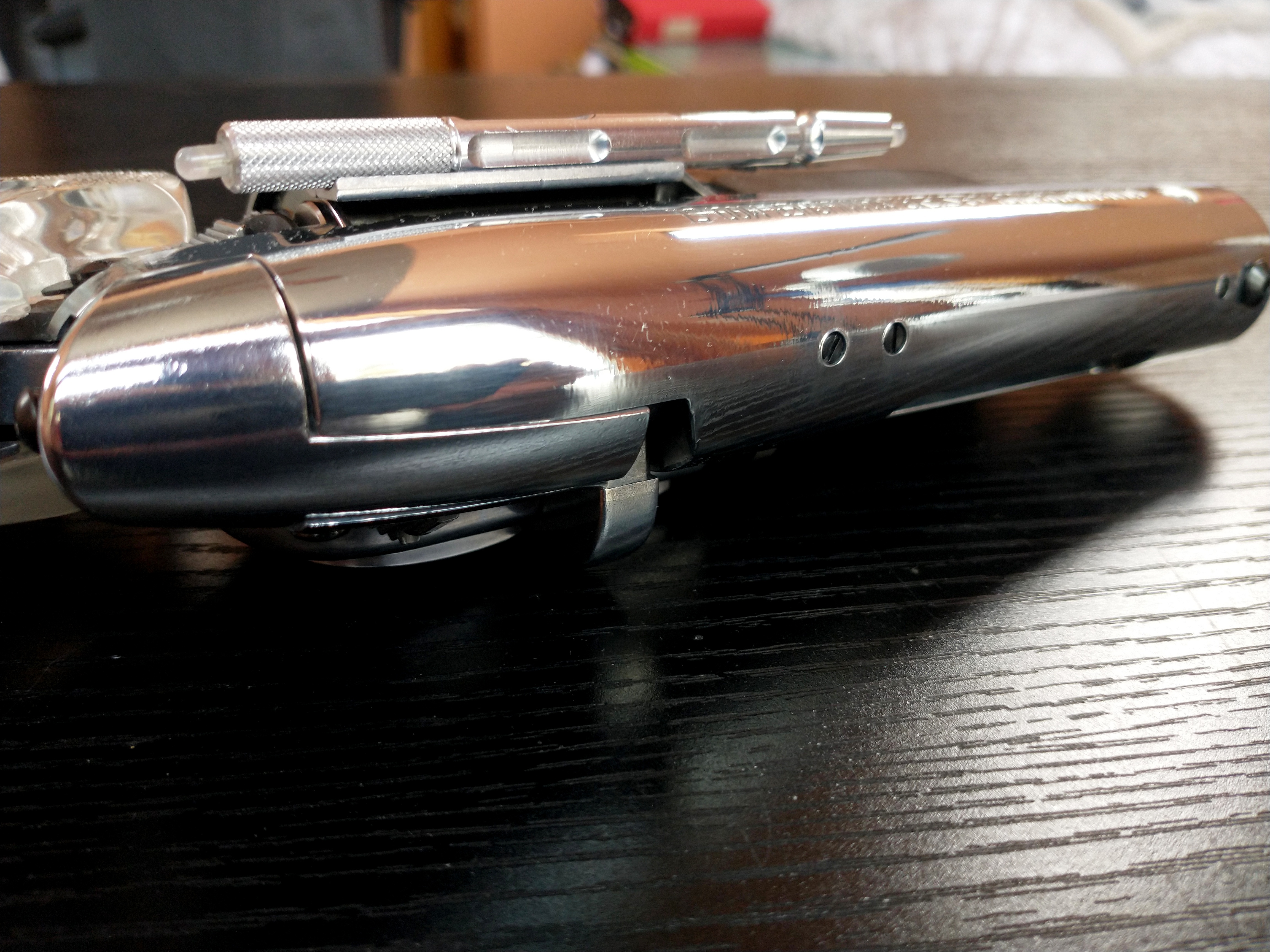

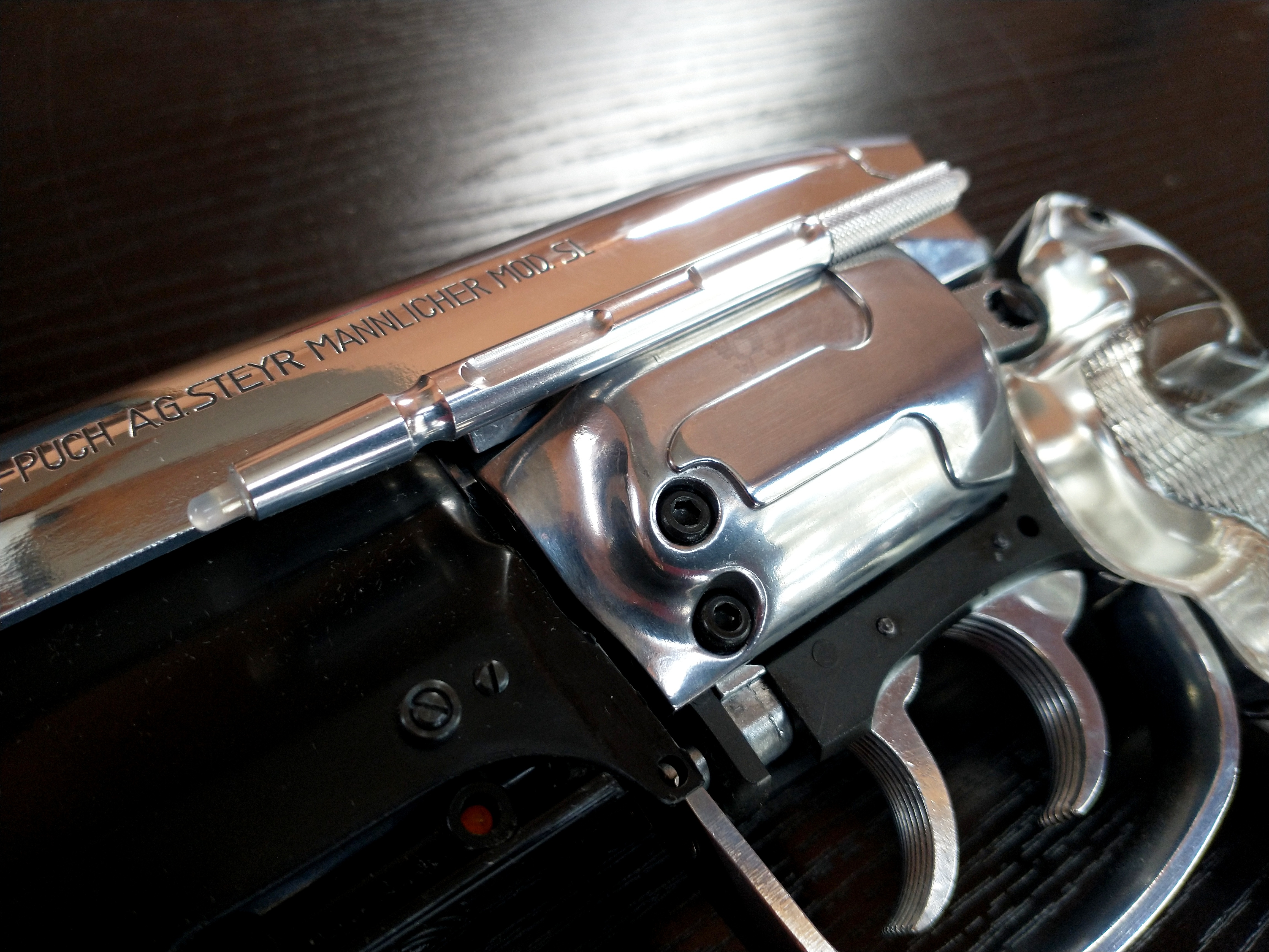

Lucky enough to to get a chrome plated blaster, and a 24k , comes with honeycomb grips or ivory white. I do believe I'm the only one in the U.S who has the chrome plated and 24k, only 10 made.
The other two snub launcher blasters are from impulse101
Currently polishing a blaster to a chrome mirror like finish(hopefully)with white lights,(blaster type:seller: model and props, paint stripped bare bones then sanding)

Thank you very much for posting. Your blasters are stunning. I was very tempted to pick up the chrome plated and 24k blasters myself, but ultimately decided to pass. They're certainly beautiful blasters, and I suspect they'll only appreciate in value. The snub launcher blasters are super cool as well!

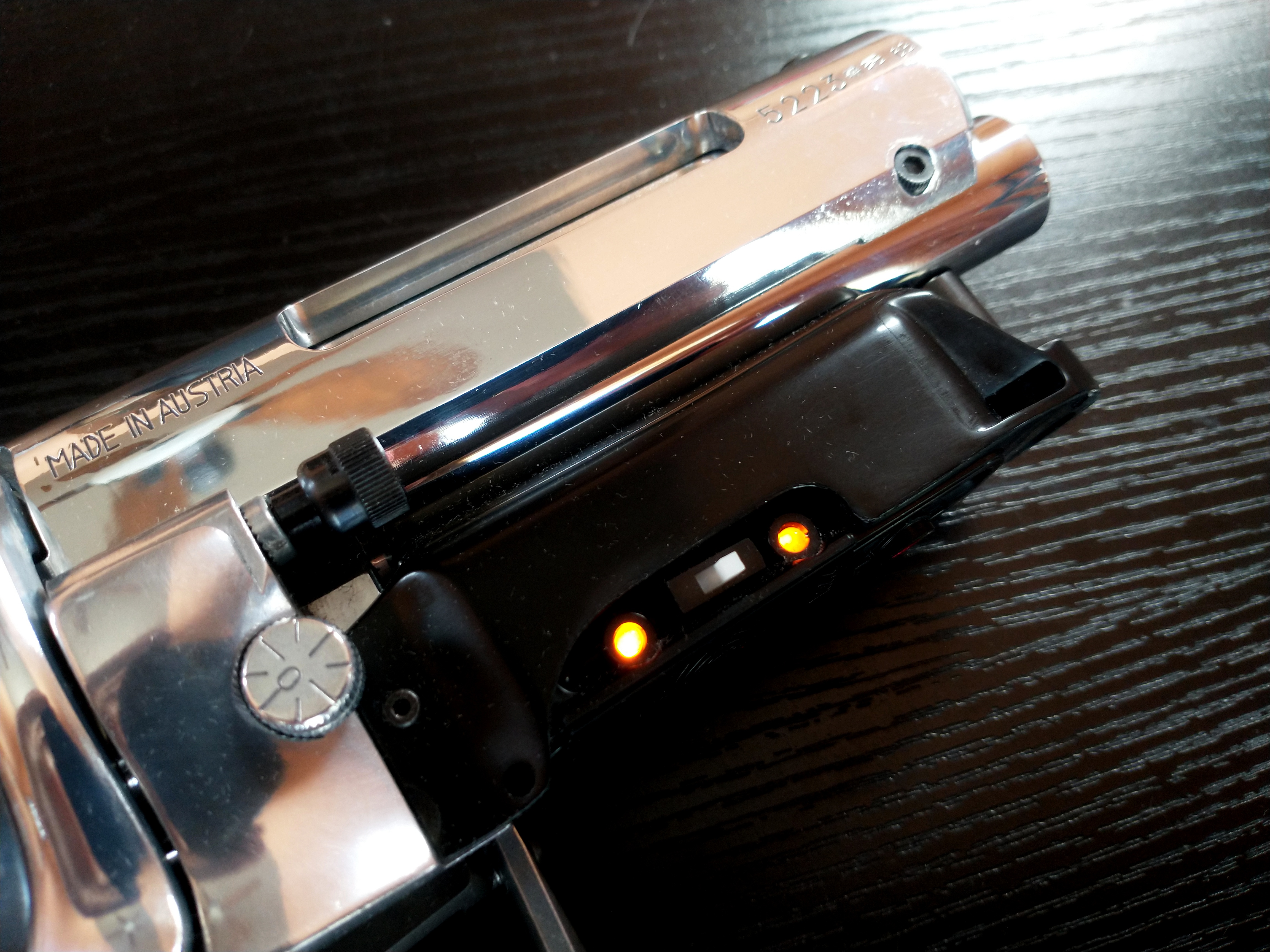

I love the work you've done in regards to replacing the standard LEDs with white LEDs. My original intention was to replace the red LEDs in the magazine housing with white LEDs, but I quickly discovered that white LEDs draw too much power for the small, coin battery to handle and I had to settle for orange LEDs. Would you by any chance consider doing a quick tutorial on how to wire/power white LEDs in the magazine and targeting rod? I'd love to have a targeting rod that actually illuminated and white LEDs would certainly be an improvement over my orange ones in terms of aesthetics. However, I completely understand if you're too busy or would simply rather not. Regardless, thanks for posting and I'd hope to see your final creation!
