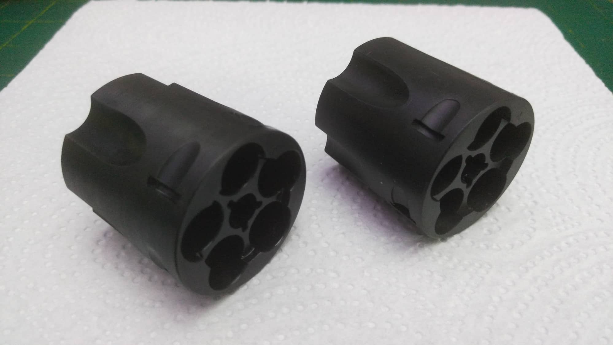

Hold the phone, I just had a slew of messages from Ted and I see he’s been on the forum.
He says he’s had to emake his cylinders because, on checking, the first batch were off dimensionally and holes weren’t aligning. He tells me he is well into making a new set and sent me these pictures to show what he’s got so far;
Maybe he’s going to turn this around after all.

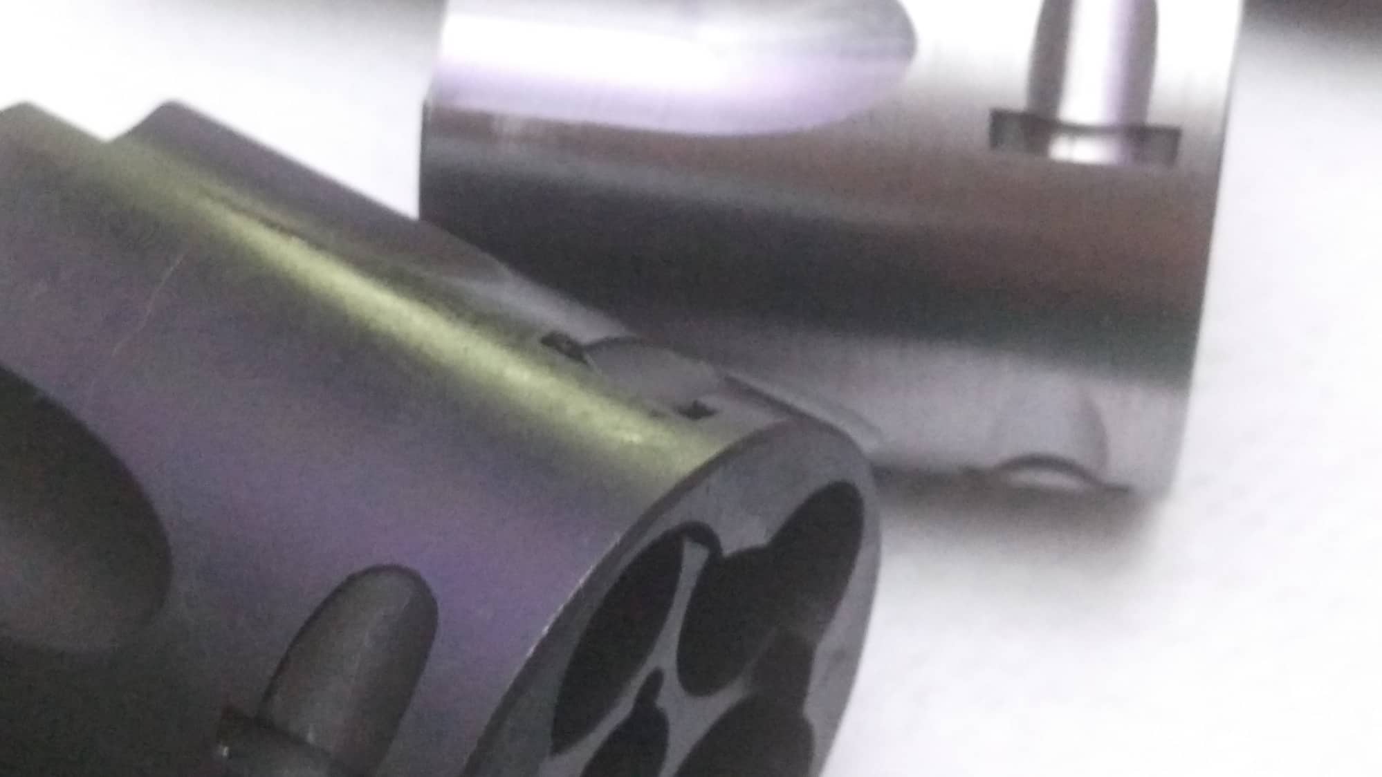

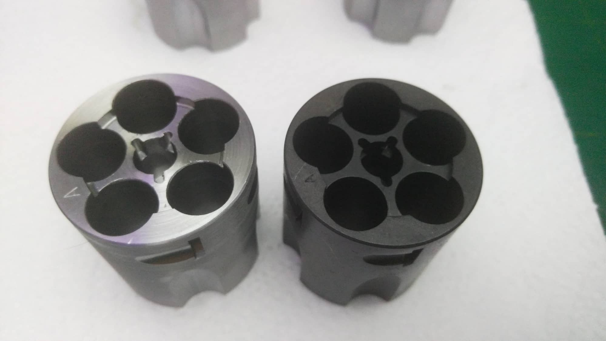

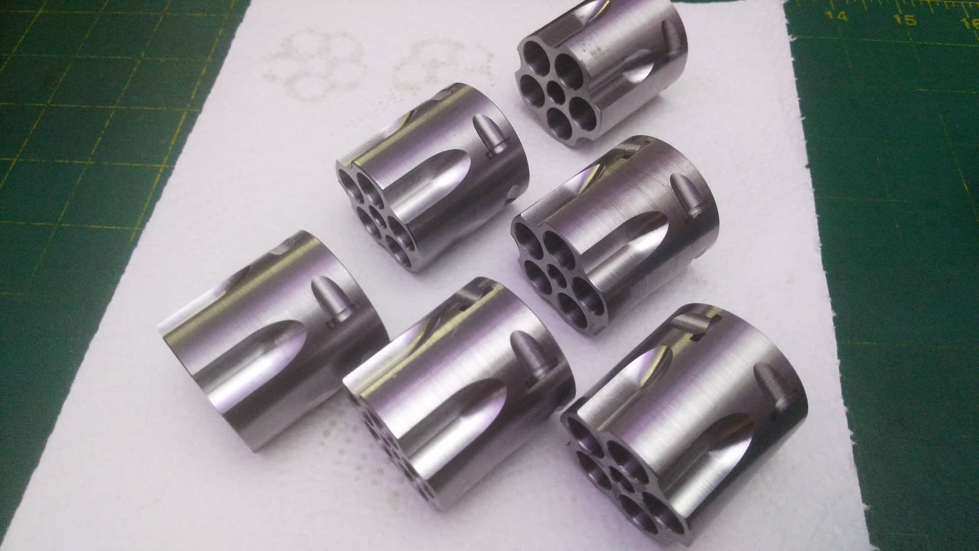

Here's an update for everyone that everyone has been waiting for...
The first bunch of steel cylinders are done and are almost 100% dead on.
*the cylinder in the lower right corner is 0.5mm shorter than the rest as per the updated version.
There are however a couple of minor differences from the original cylinder sent to me from User1402.
1. The catches on the side is the most obvious one. The original tomen has a bit of a lip causing the catch to be smaller than it should be. There was no way for me to duplicate this without going with an EDM machine (which I don't have) and the mill will only do so much. So the catch is a little taller than the original. However, looking at the original bulldog cylinder, they're identical.
2. The A stamp is slightly larger. Instead of 2mm tall, it's around 2.4mm.
3. No washer blocking things. No way I was going to even attempt that.
4. No picture of it, but the flutes were done with a ball nose end mill whereas the original Bulldog cylinder (as well as most other cylinders) are cut with a cutting wheel on a horizontal milling machine. I don't have access to this so a ball nose end mill and CNC were my only choice. This creates a bit of a shine that looks like a sharp line down the center of the flute. I'm going to test a scrap piece with some red scotch bright on a rotary tool to see if I can give it the same kinda look as the original bulldog and get rid of the "line". If you look up a pic of a bulldog cylinder and zoom in on the flutes you'll see what I mean. The lines on the original are along the length of the flute whereas mine aren't.
Everything else seems to be the same. I checked, double checked then checked again before checking once more to make sure the measurements I was getting off the steel versions were as I was reading them off the original and the blueprints that tomenosuke had published. I'm fairly certain that I have it all dialed in correctly now.

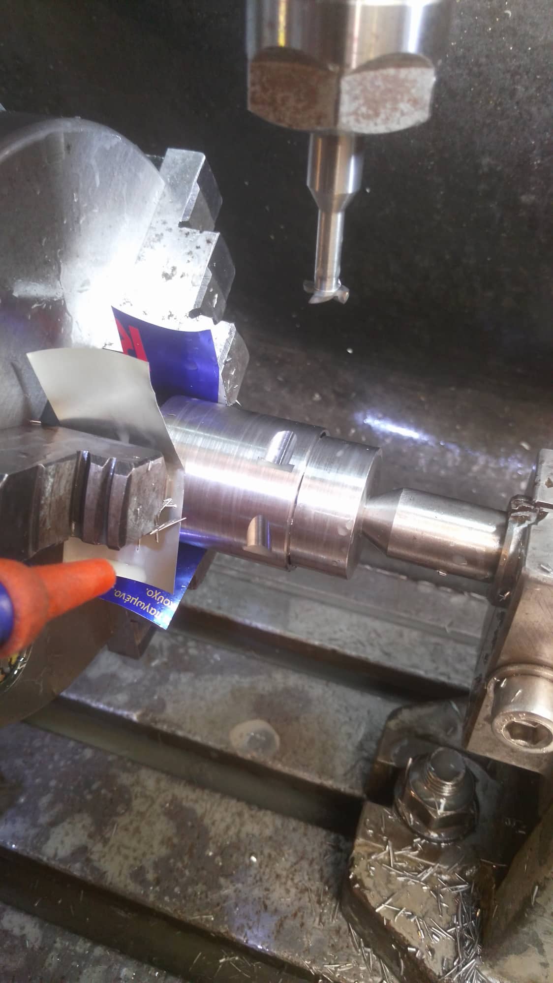

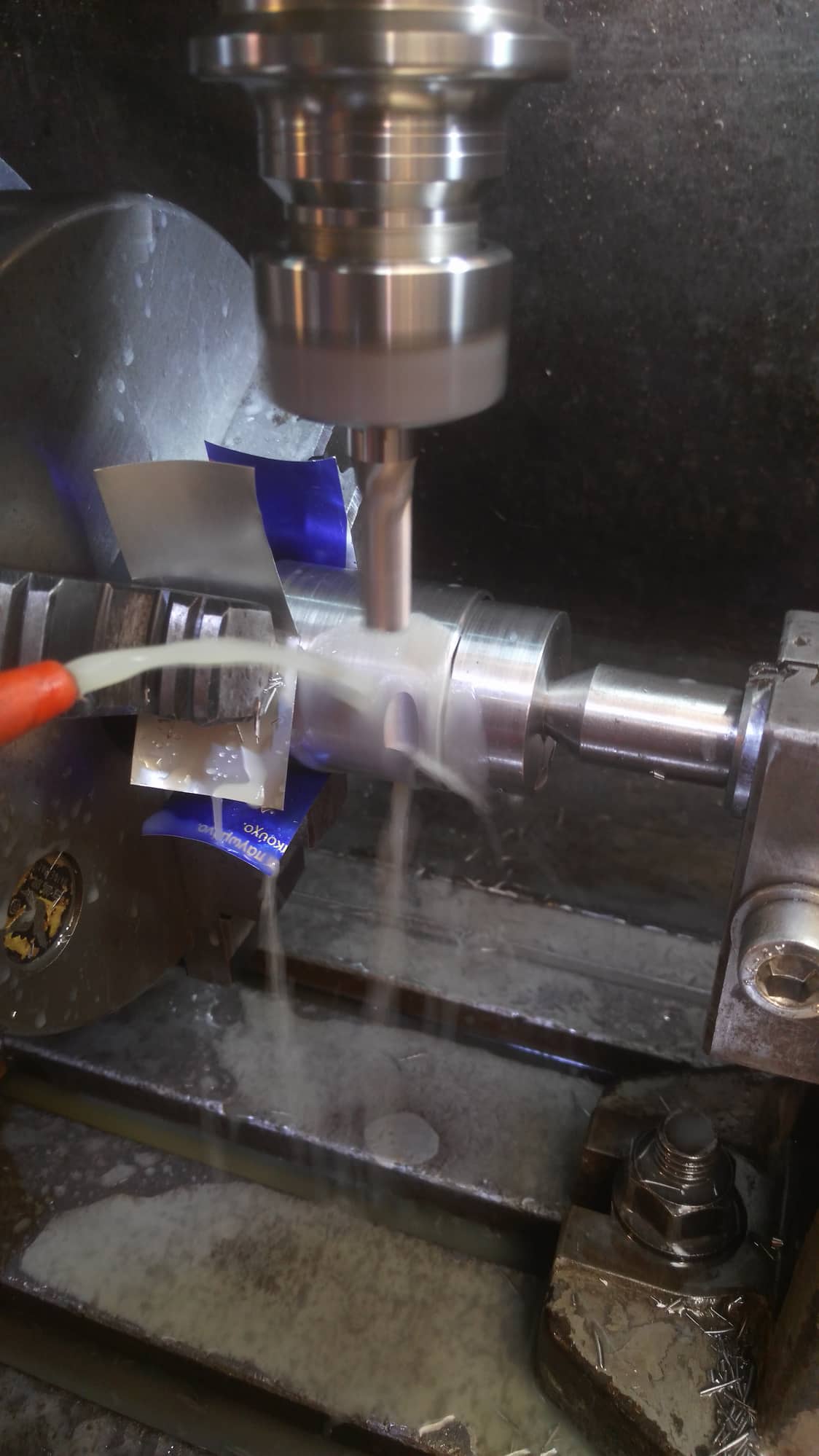

And for some viewing pleasure... some of the in-process machining of the final steps...
Side catch - flat end mill
T-slot

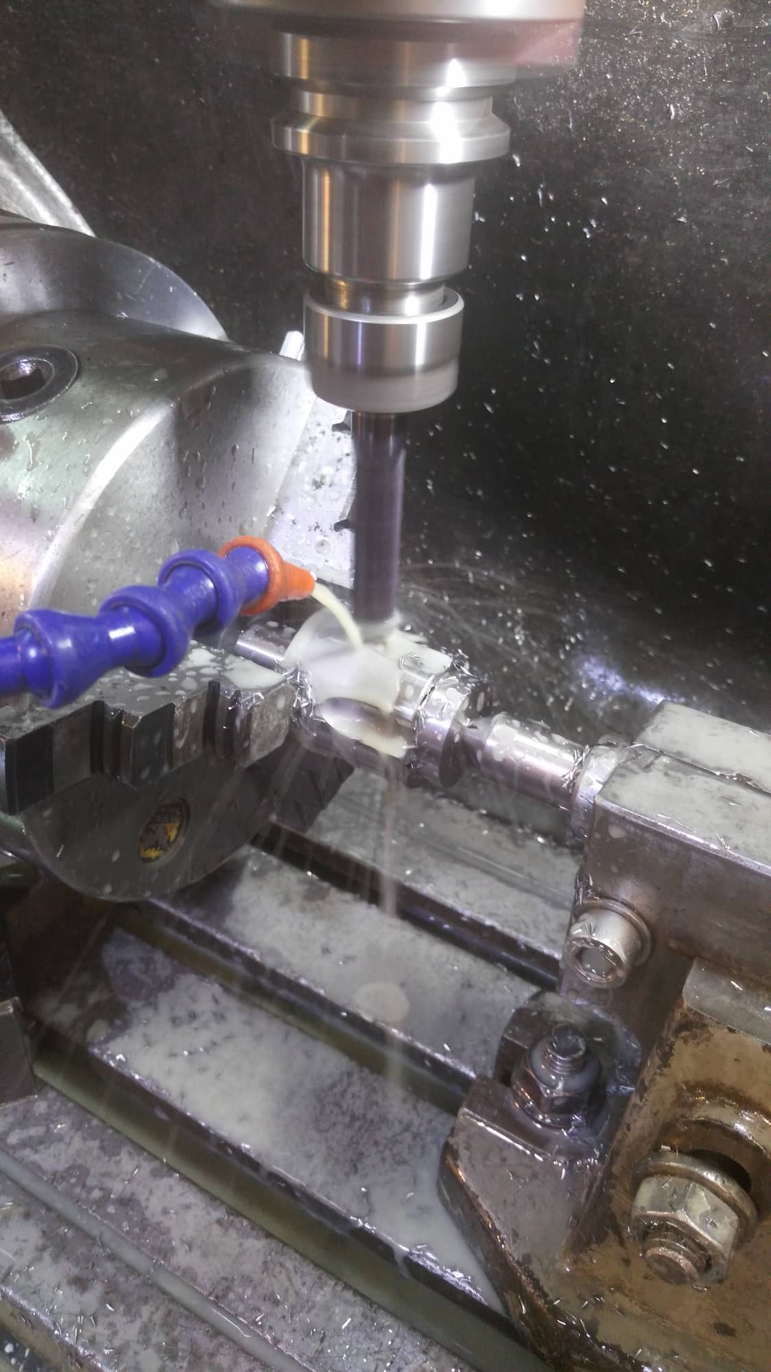

Ball nose end mill - had to go with a long end mill due to clearance issues... and I get to 0.4mm from the face of the jaws when the end mill reaches the end of the flute.

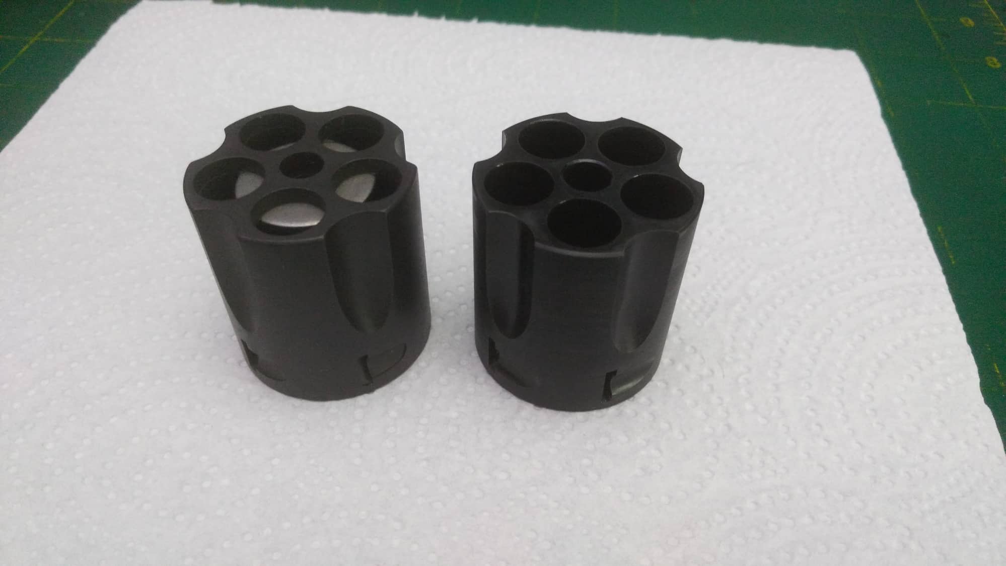

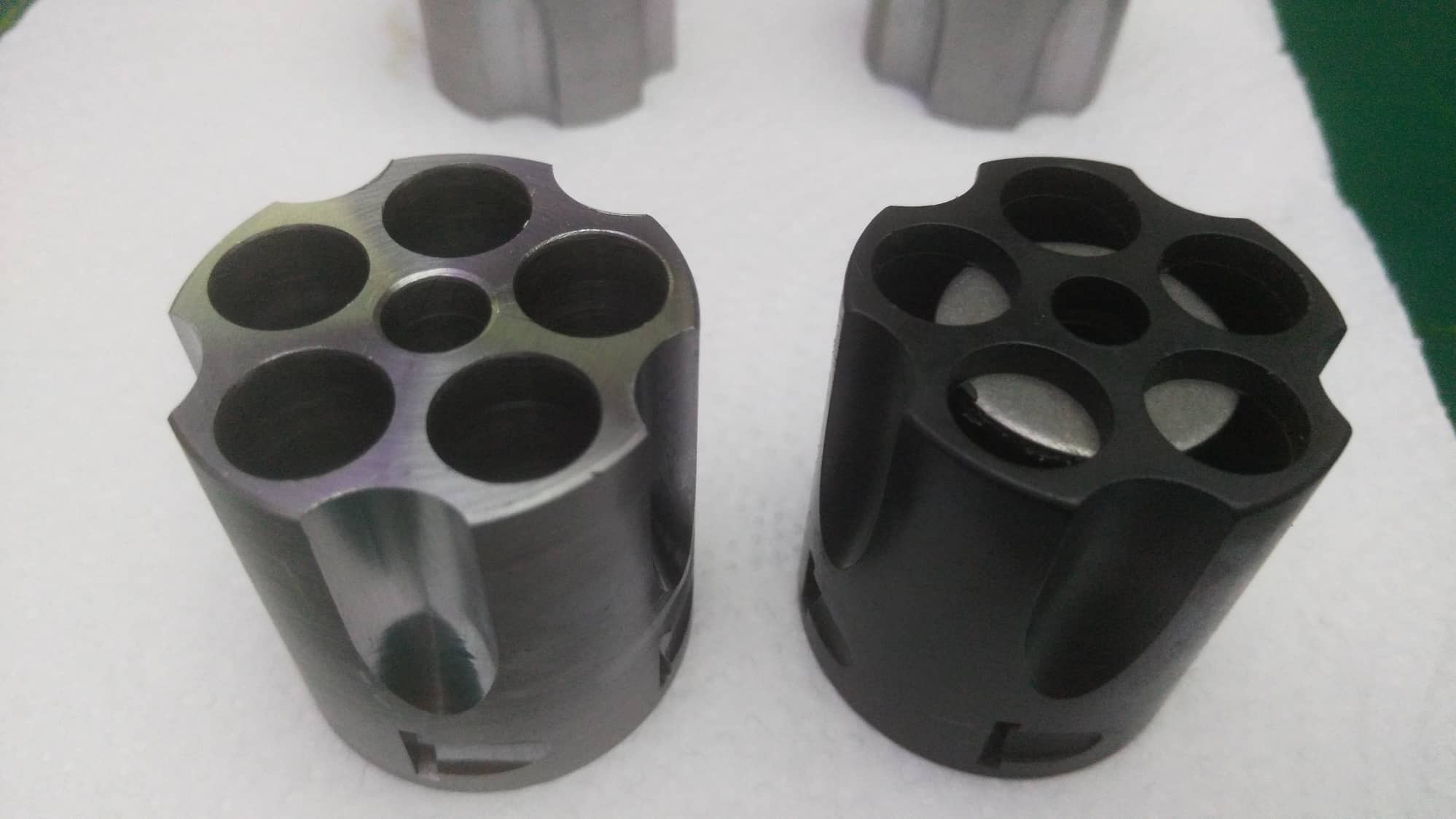

I didn't have a blued cylinder at the time I posted the previous pics and I needed new cold-blue fluid. Got what I needed on Firday and went to work on a cylinder. Here's the side-by-side of my cylinder with the original tomen. These things, though a serious pain to make, are starting to grow on me.
My cylinder is the lower left.
I think it's obvious which is which... but they're pretty close in color.

Thanks for posting. Your cylinder looks fantastic blued. Very close to Tomenosuke's offering, but the more aggressive nature of the metal still comes through. It's great to see a cylinder without that stupid washer as well. The washer actually annoyed me more than the resin. Thanks again!
