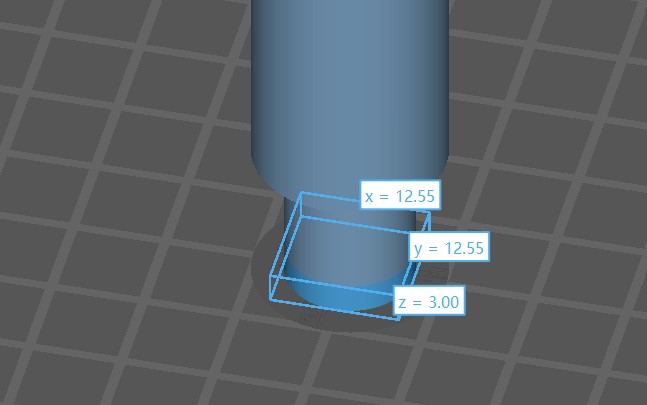

Hey there Dave, I'm traveling at the moment, but there may be...it was pretty loose. Do a quick check on the Ander's barrel files, shows that the insert portion is 12.55mm. But that would explain the difference. I'll have to double check when I get back.

The nub diameter is smaller and would account for the poor fit. I can make a barrel with the correct diameter for the nub. Just get me a fairly accurate measurement of the diameter, preferably with a caliper and I'll send you one to make sure it's all good.

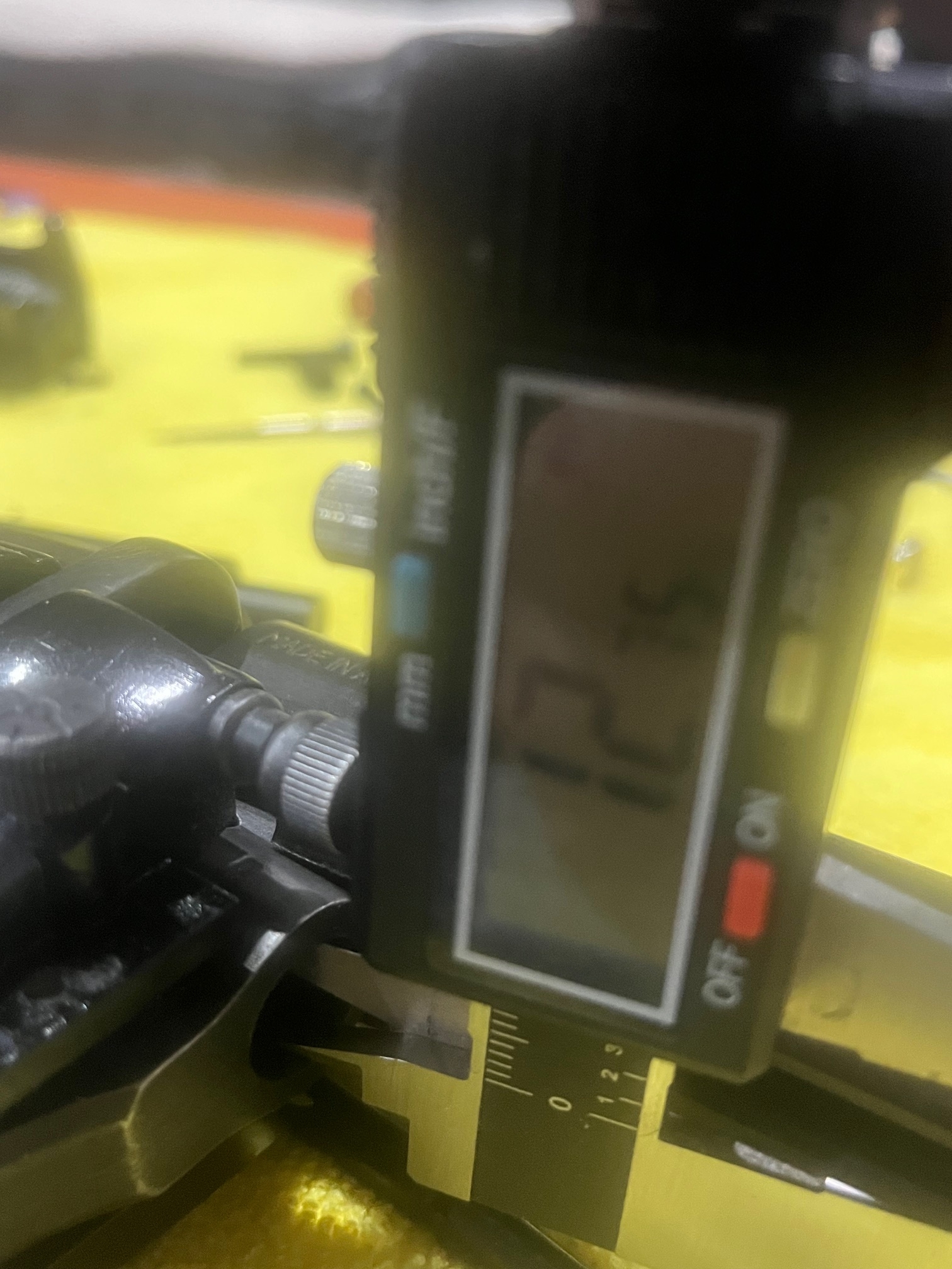

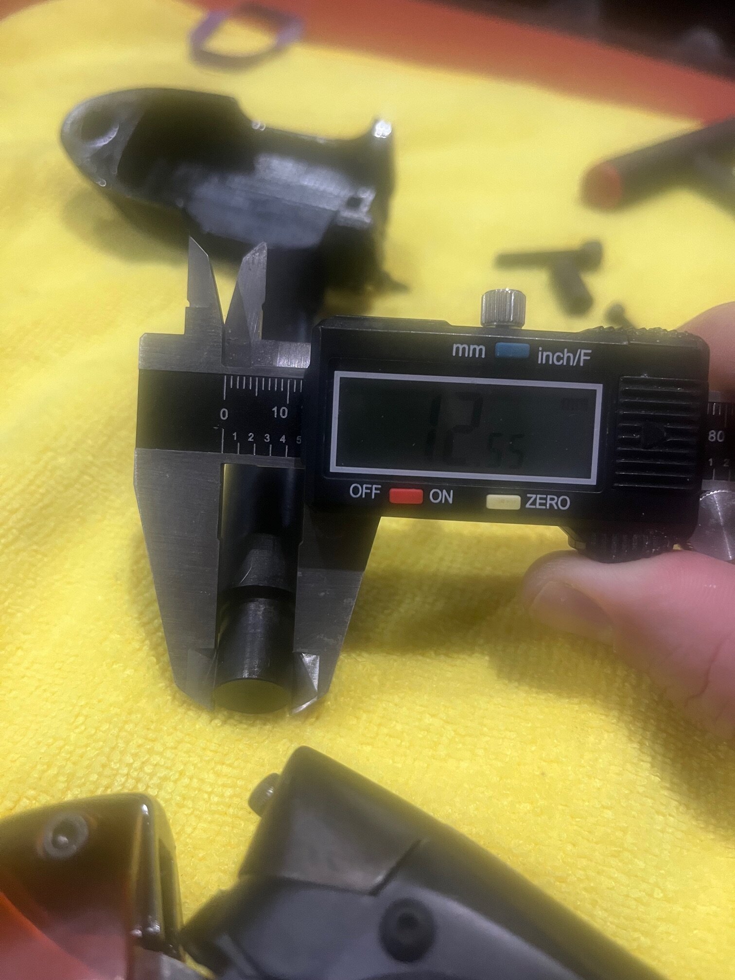

Hi Ted, I was able to take a couple of measurements, and it looks like the metal chassis for the Anders build and they were consistently coming out as 12.75mm +/- 0.01 mm , the barrell insert measured at 12.55 mm. I was able to snug it up by wrapping some electrical tape around the insert portion.
ok, I can send you one with a correct nub. Good choice on the electrical tape.
