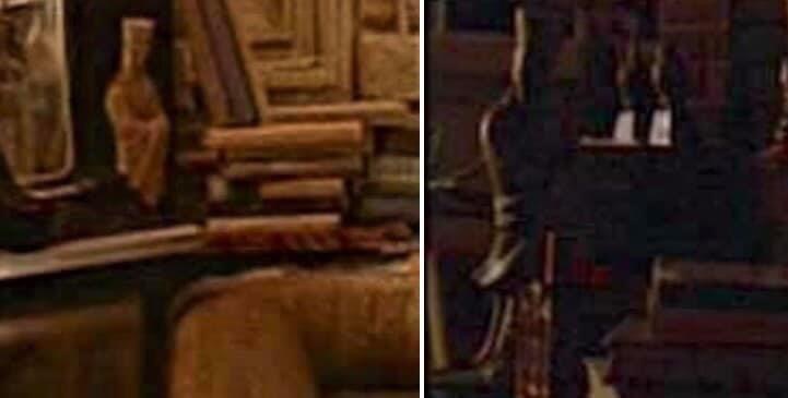

I’m sure many of you will have heard of or seen the mysterious ‘Asian man’ statuette in Blade Runner. It appears in Deckard’s apartment in several locations including the bedroom (because Ridley Scott loved moving props around the set between takes). It’s a 12 inch high ceramic figurine of a Chinese ‘wise-man’ with a tall hat and flowing robes. The one in the film appears to be a light tan / cream colour (difficult to be accurate because the film uses moody lighting and strong post-production colour grading);

While waiting for the mold to arrive from overseas I looked into replicating the light tan coloured glaze and after looking carefully at all the available pictures of the original my own feeling is that the glaze on the piece used in the Deckard apartment scenes is not a high gloss but a more silk finish. I found a pretty good match and this one is a Spectrum earthenware glaze which fires at 1,060 degrees C. It has the nice silky finish and shows some variation in colour depth on detailed pieces. I like this one a lot and I think it will look very accurate.
