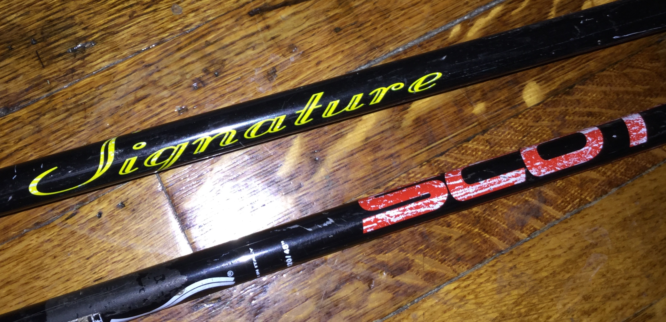

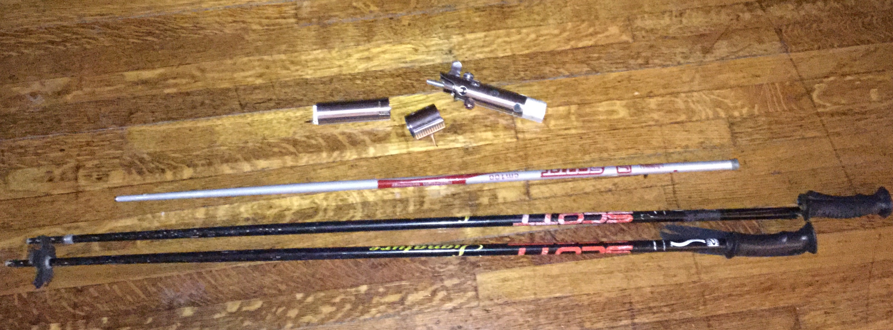

Here’s some more material for the discussion. Got the new ski poles. They are Series 2 shafts, and called Scott Signature.
View attachment 986871 View attachment 986875 View attachment 986876
Scott makes a lot of weirdly named styles, as do other brands. For example the first accurately thick kind I found were called stovepipe or something.

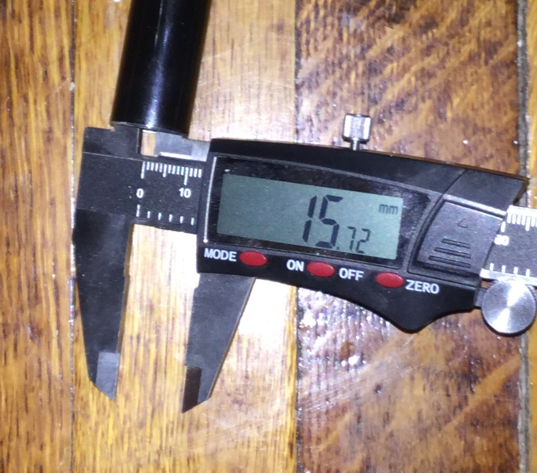

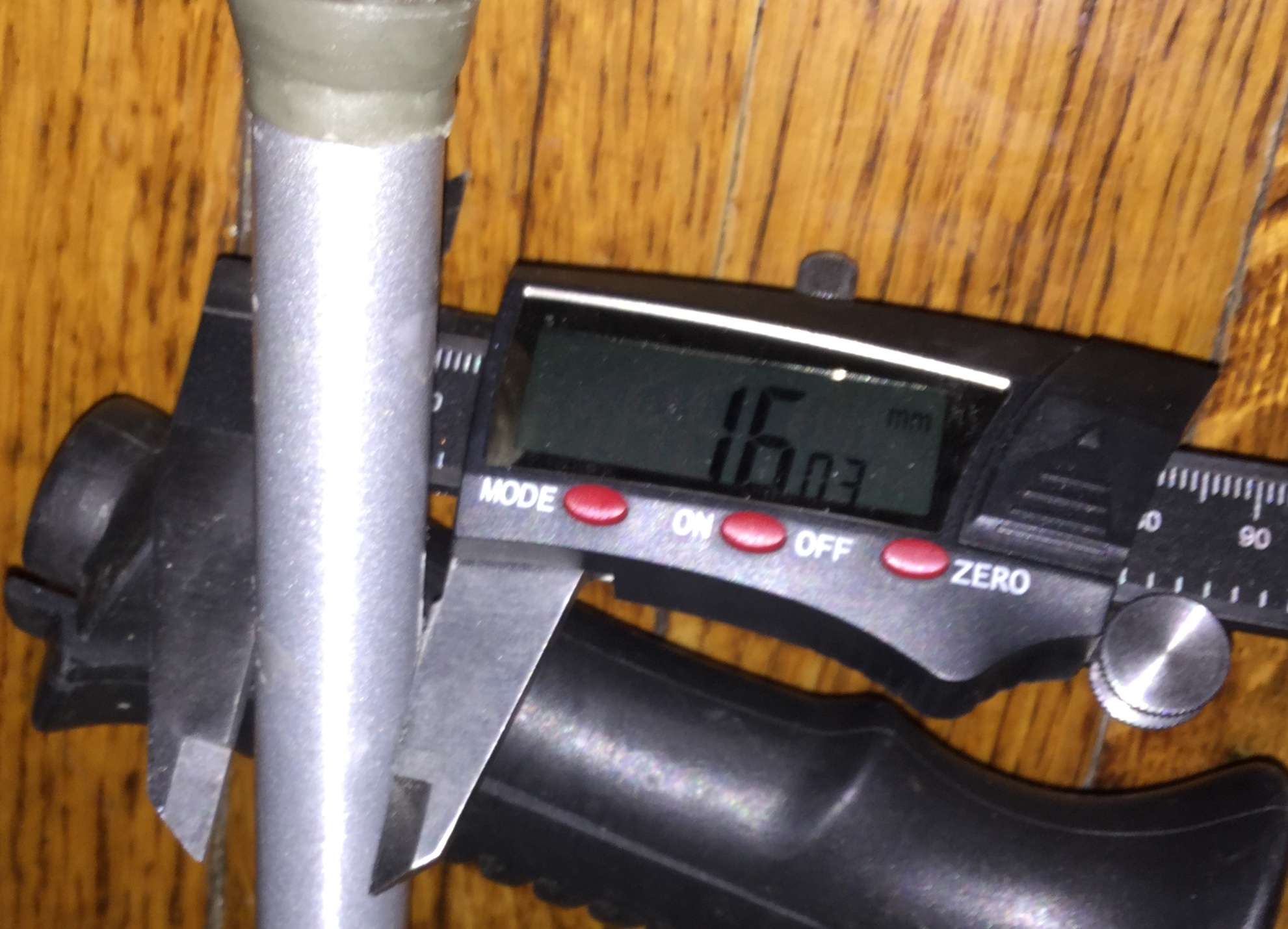

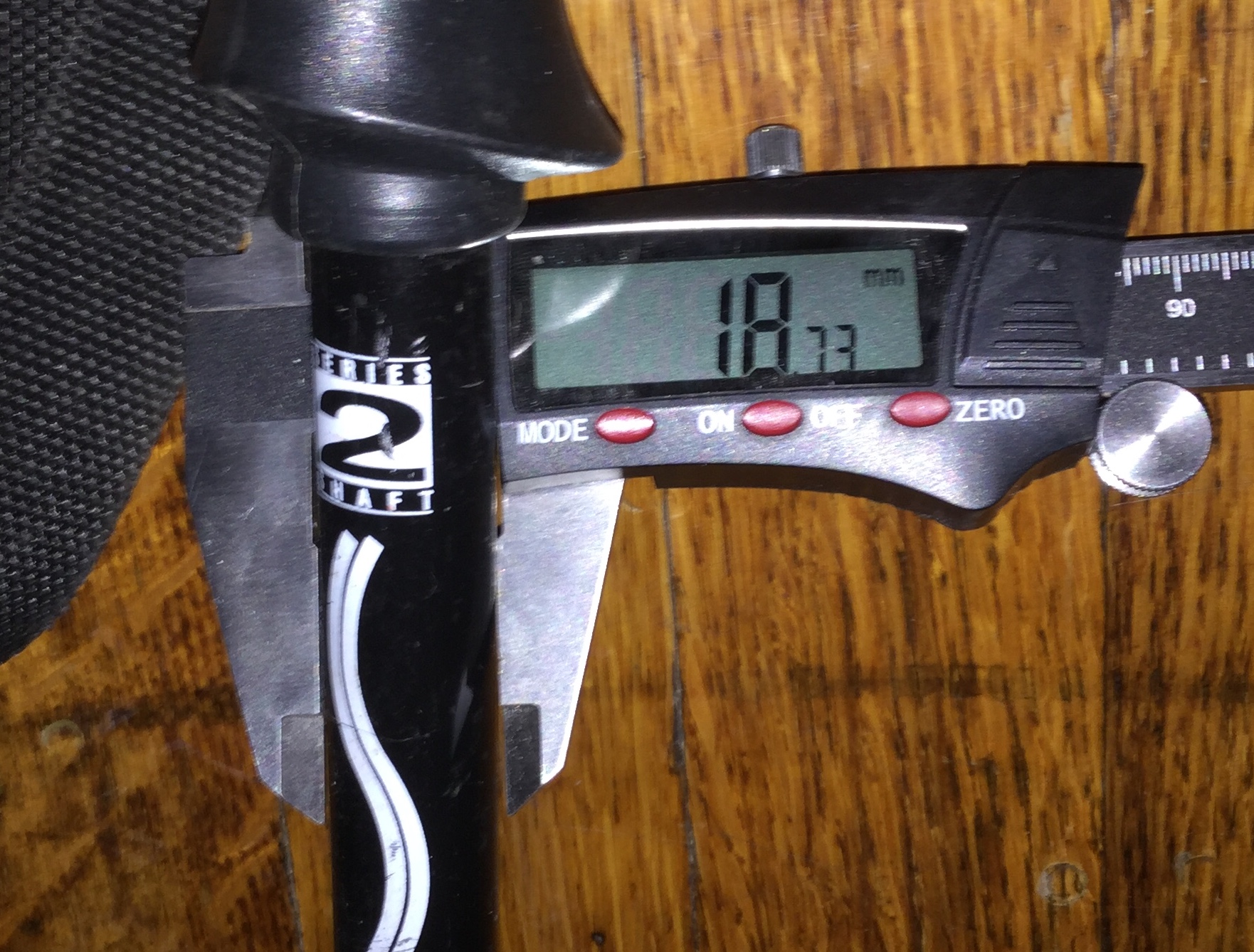

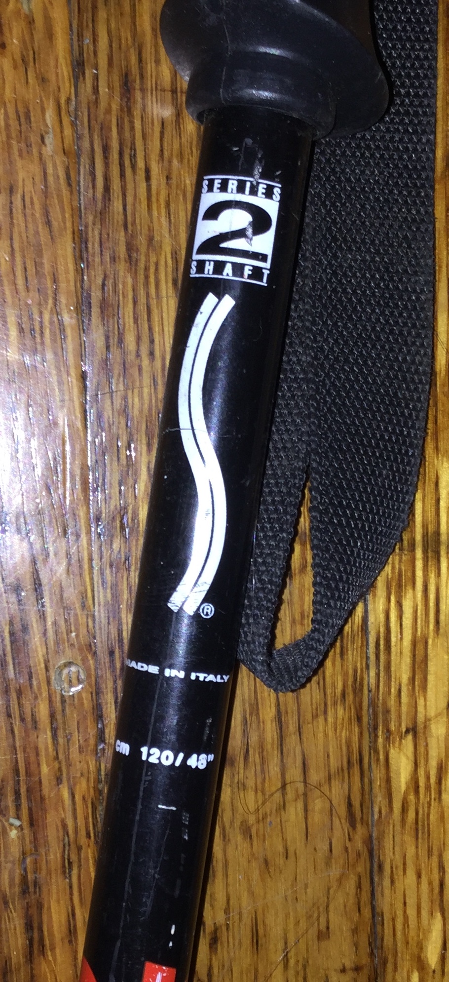

Here are the dimensions.
View attachment 986873 View attachment 986872 View attachment 986874

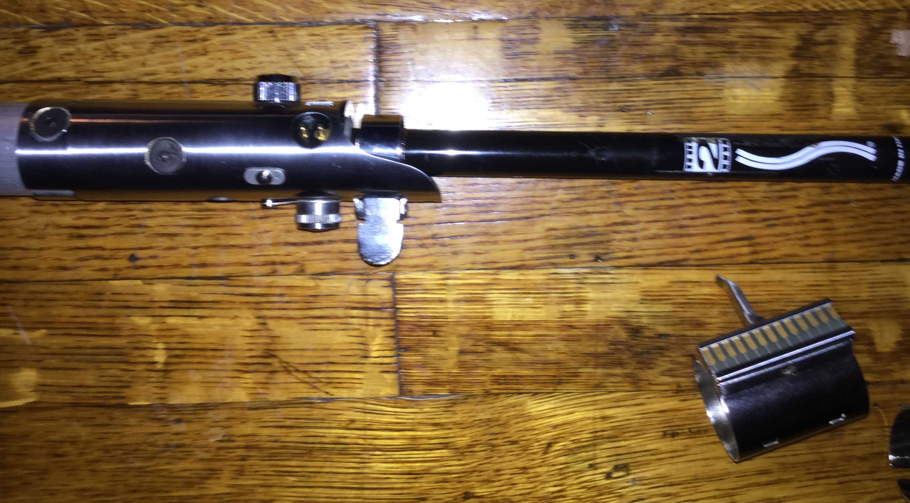

I think the 15 or so mm inside translates to near 5/8 which will make it easier finding a spacer. In order to thread this on I need to tighten the pole to the spacer so they both will spin together. Wall thickness is 1.87 mm to tap a set screw in
Looks decent on a graflex, but I think some blades might have been thicker? I’m mulling this over. I like where it tapers.

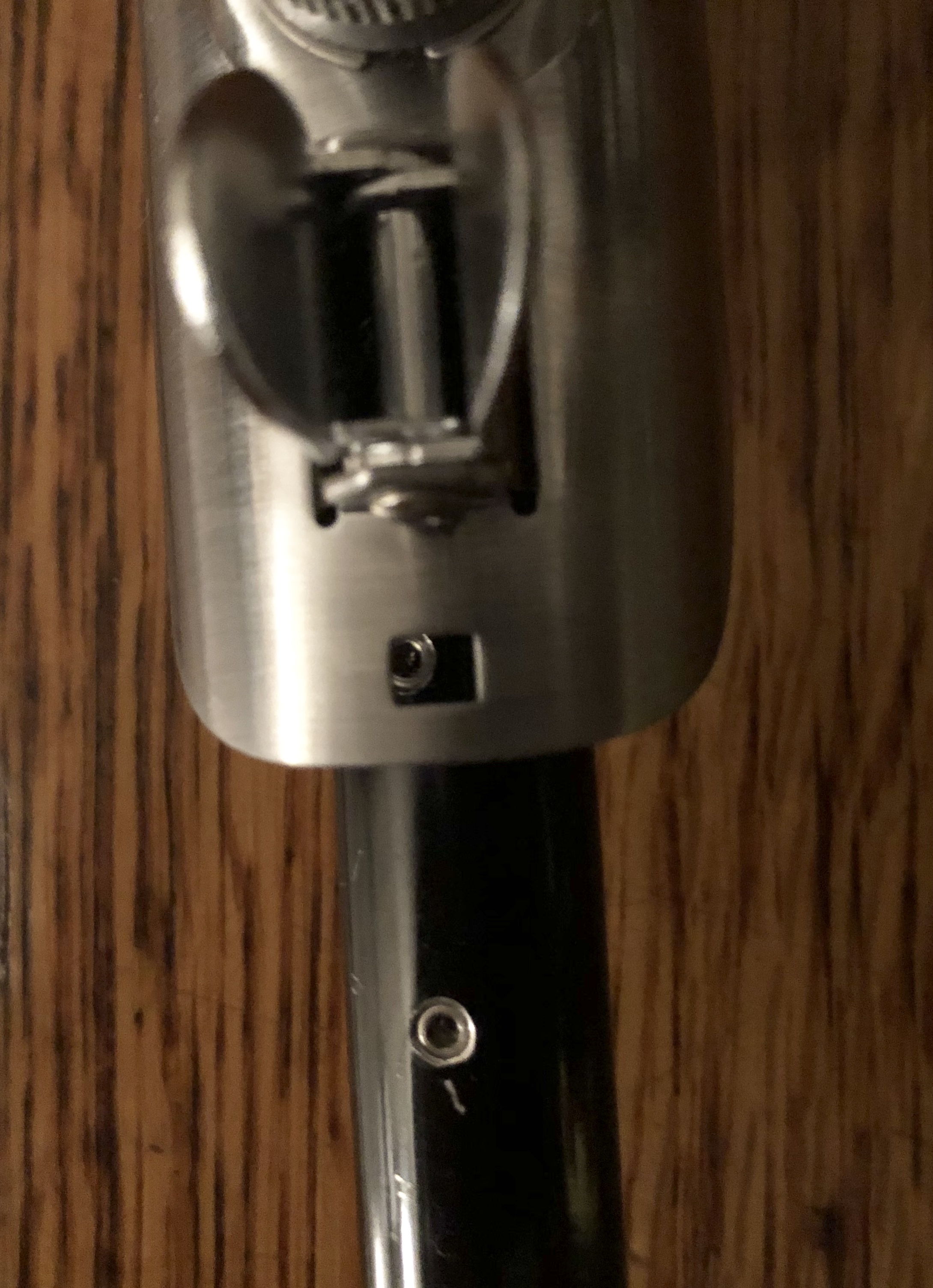

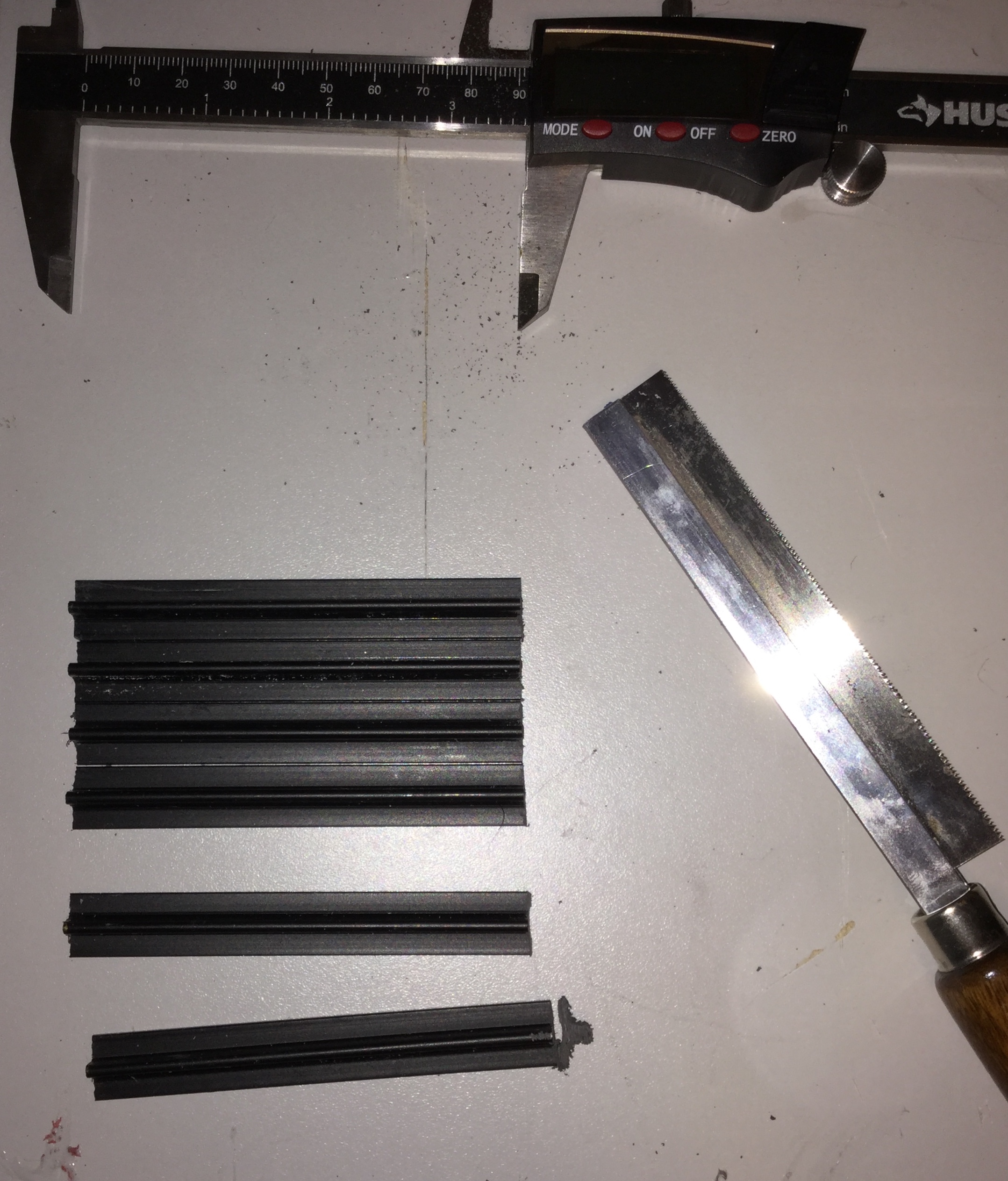

I also tried my hand at notching grips without a dremel, using a ******* file, saw, and calipers as a guide. I’m cleaning them up with a dremel before I drill them out, the file was rough on them Epoxy? 3m mounting tape? E6000? That last one takes like 24 hours to cure but it’s stronger, what do you use?

So, I thought I would be slick and CA/superglue track on temporarily, drill them out, and put e6000 on when they popped off. I learned the CA glue trick from a Star Trek Phaser kit Anakin Starkiller encouraged me to build once.
Everything was working out well. Until the screws I had .. basically these but with a more accurate head..
They wouldn't screw into the flash bottom. I know they're not self-tapping technically, but I thought they were similar to Roy's screws. Maybe I didn't force them hard enough, but what I ended up doing was widening the holes little by little... and then they popped through. I feel like this was a pretty rookie mistake. Roman's bottom looked a tad thicker than the real flashes I've drilled. Maybe I should have tapped a machine screw... but I remember doing the exactra screws with no problem.
regardless, I swabbed putty in the holes... but the holes were so exact there was no room for putty and it just pushed through. Then I used E6000 in the screw holes and under the track. Should be good for now..
Also, that superglue I used as prop-makers trick for temporary hold.... dripped onto the clamp. and I superglued the clamp bars to the clamp! What! Anyway, that was yesterday. Today I'm going to check the silicone glue and clean the CA glue off of everything.

The E6000 is holding the grips and screws in place, since I had to open up the holes instead of the screws tapping themselves :(
eh, it's a hell of a glue, so I think were good. I always prefer hardware attachments but Halliqwaxes tip on this glue has changed my mind.

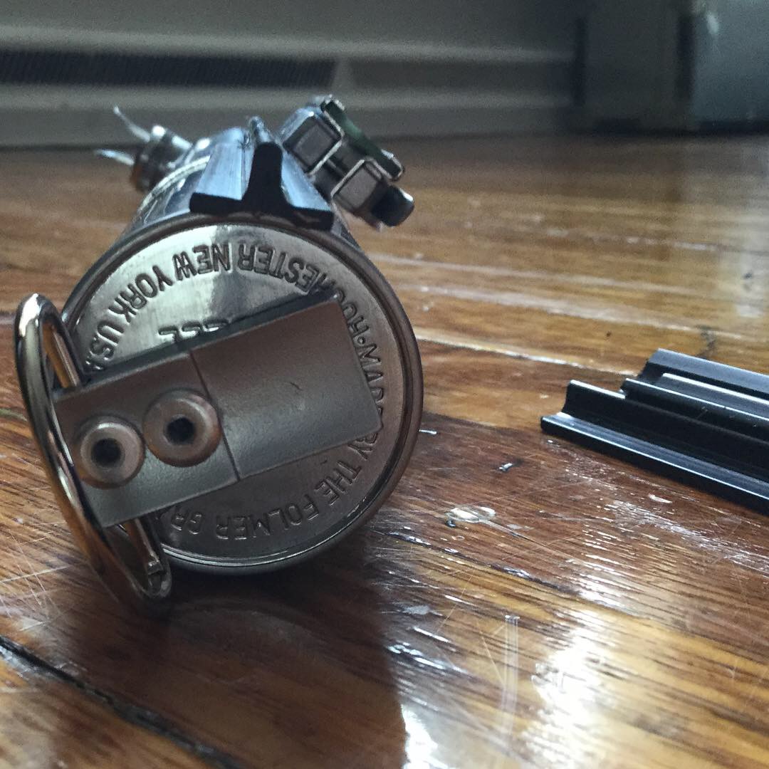

Instead of finding a bushing, my girlfriend and I decided to DRILL OUT a 4.25 inch piece of aluminum. We got a drill press vice just for this, and had to drill from both ends. ***** ******, the guys at my metal supplier asked if I had access to a lathe... and I said I have a small drill press? They laughed. I did it, nearly centered, and I'm never doing this again without better equipment. I am proud however. I used wd 40 and stopped when it started smoking. My finger shows how long the bushing is.
I will eventually tap 2 or 3 set screws along the shaft, and I took a pair of pliers and hammered this into place. Vadermania is right, ski poles are a hair smaller than 5/8 or whatever, so the spacer can be press fit into place.
The hilt is pretty hefty and very pleasing to hold. The plastic track is great. My Hero ESB has painted Malaysian track and the paint didn't quite cure so I hate holding it. I may decorate another bottom for it, and figure out my screw problem.. for the life of me I've never had screws refuse to twist into a graflex

Hey here’s a screw trick for ya! You can remove the screws. Then find a wooden dowel
Sand the wooden dowel until it fits inside the bottom tube of the graflex, stand the tube on its end , and the dowel beside it
Mark the dowel just 1/4” or so higher then where the screws are on the graflex
Cut the dowel, then put that wooden “disc” now in the bottom of the graflex. The screws will now screw into the wood, locking them in place
Of course you don’t have to do this because the e6000 works amazing
But if you want a true mechanical attachment that is a option for you
The screws roy supply’s with his kit isn’t a machine screw, nor do I have taps for that. Those screws are more for wood or plastic
So I always drill a very small hole in the graflex and screw his screws into that. I forgot what exact bit I use, but it’s very tiny
I wouldn’t stress it though man, that stuff will hold car panels together!!
Thats a great tip! Actually I may do that for the next saber bottom I do. You're right though, thanks for the reassurance on this glue, if it holds car panels together this will be just fine :)
I may go back to using a threaded rod. it fits in the hole I drilled better than this cast bolt.

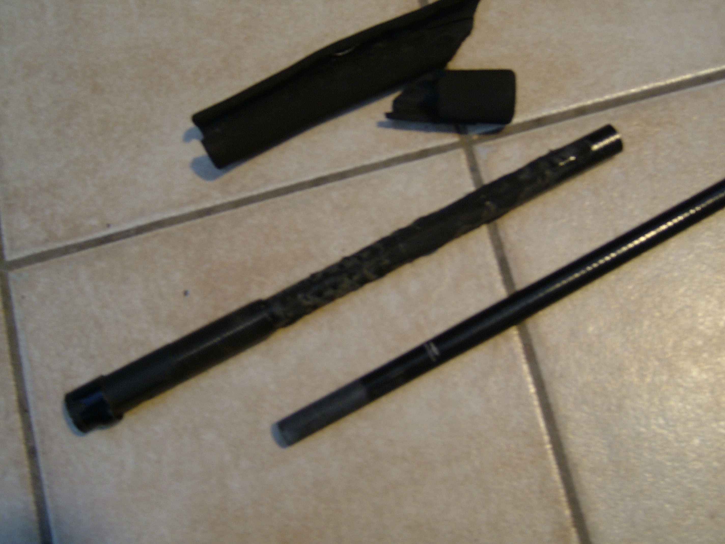

Glad the acetone did the job. As Halliwax says heat also decomposes superglue (I think it starts about 100 C) but also melts plastic so it's good to know both methods. Got me fishing rod & also managed to get a graphite shafted golfclub for £2 at a charity shop.
The rod is not as one piece as I thought as it is a push fit into the handle. here it is sans foam grip. handle section is 16mm od carbon fiber. rod is 14mm at base, again a woven carbon fiber - 6mm at the tip & about 8mm at 36". It's much more flexible than the club shaft as you might have guessed. feels like it may be more resistant to strikes but I'm not after a combat blade.
Club has yielded as 36" blade 15mm at the base 8.8mm at the tip. It's much more like what I was after. Both are very light. From the research I've been doing it's very close dim's wise to ANH stunt graflex or will be once the scotchlite is on it. So close I think it stands a chance of being what was used in the film though I know this is a very controversial subject. It was actually looking for more info on the mythical triangular blade that brought me to RPF.

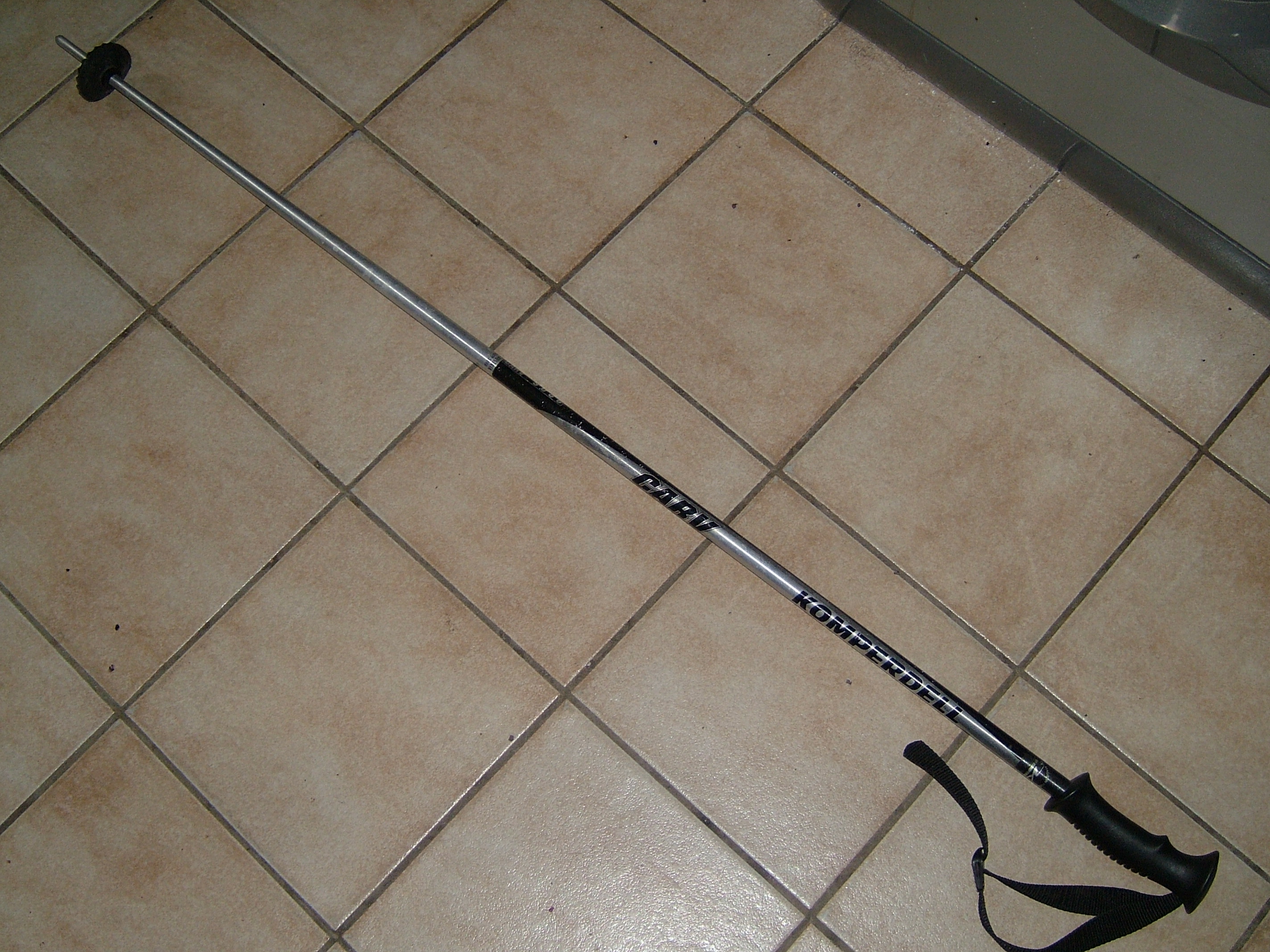

If you are still dead set on ski poles I remembered I have a pair of Komerdell carv juniors I bought for a dif project (charity shop again) 1.25m long 18mm od 'aircraft' (aluminium) alloy ? I looked them up on fleabay & they're about £12-15 new the pair. I would think they're available in the USA too.

Another thing I remembered that might be of use for combat is fiberglass ramrods (muzzle loading guns). I bought some way back from Dixie gunworks ( Canada if I recall correctly) I have 3/8 & 1/2" diam x 49" long but straight not tapered, can't recall if they did 5/8. These are very flexible & strong but return to straight well. For the mo I think I'll be sticking (pun not intended) to golf clubs as they're cheap & readily available & may well be pukka for ANH. Don't know when I'll get around to making any of this up, it was only at xmas that I decided I'd get myself a LS. I now have 5, the last one a solo's hold v2 which is the one that has really given me the bug bad. I'm looking to build a motorised ANH graflex stunt. (last pic didn't go full size for some reason - thumbnail below)

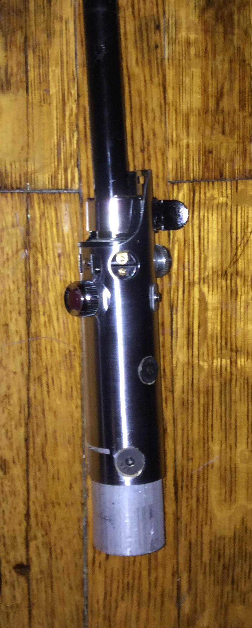

Going to take more beauty shots soon, but I shortened the blade, finished the end and drilled/tapped three set screws along the adapter. I opted to use a threaded rod
Okay here of some beauty shots of the raw piece.
Here is the spacer I made with a drill press, it’s like 4 inches long. I actually hammered it in deeper and sliced the rod shorter.
Once I metal filed it all smooth, I installed 3 set screws and made dimples in a steel threaded rod. The last set screw drifted a little bit...
I did a lot of measuring. I used a found part, this weird brass plate that had countersink screws on it, as a washer to protect the plastic socket, just in case. I dusted it black with grill paint.
Now the rod is stuck into the ski pole and I can twist it into the Graflex. It’s almost 3.5 Graflexes long which is a bit longer than I had anticipated.
