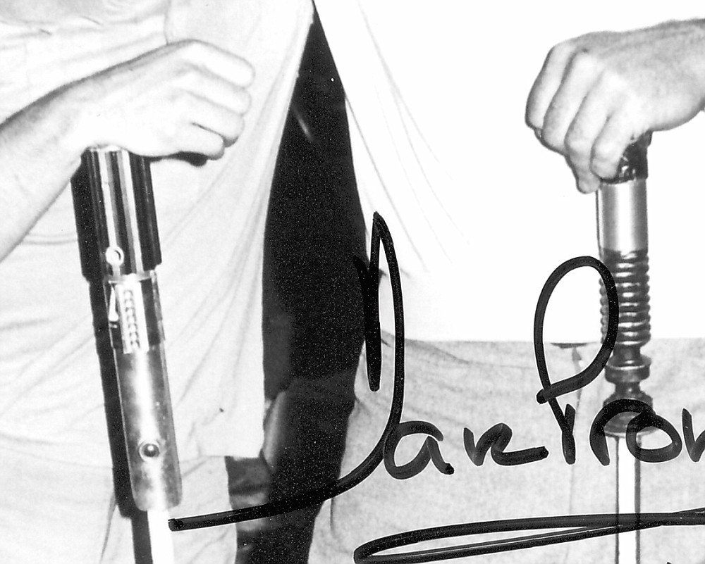

I'm basing my measures on these pic's & I mean measurements & not guestimates (remember I'm on ANH).
As we know actual dim's for a graflex tube (or whatever fits in a graflex clamp) as well as the length of same clamp we can use this to calculate the blade dim's. Works like this: measure the tube width (aka diam) in mm with a ruler on the picture, we know the real diam is 38mm so if you divide the picture measurement by 38 this gives a scale factor. Next measure the width of the blade (base) in mm on the pic same way as you did before. If you now divide this new measure by the scale factor you find out what the actual blade width ( diam ) is. Simple... using this method I get blade dims of; 15.7mm for the 1st pic; 16.5mm for the 2nd & 15.7 for the 3rd. The 2nd pic also yields length of 936mm (36.8") & tip diam of 8.8mm (oh yes & is clearly tapered all the way). Given that the reflective material is adding to diam (by app 1mm?) gives cores in the region of 14.7 - 15.5mm. (5/8" is 15.6mm) Remarkably close to the size of my (modern) golf stick...
View attachment 988963 View attachment 988964 View attachment 988965
That seems to work for the square dowels from ANH..
