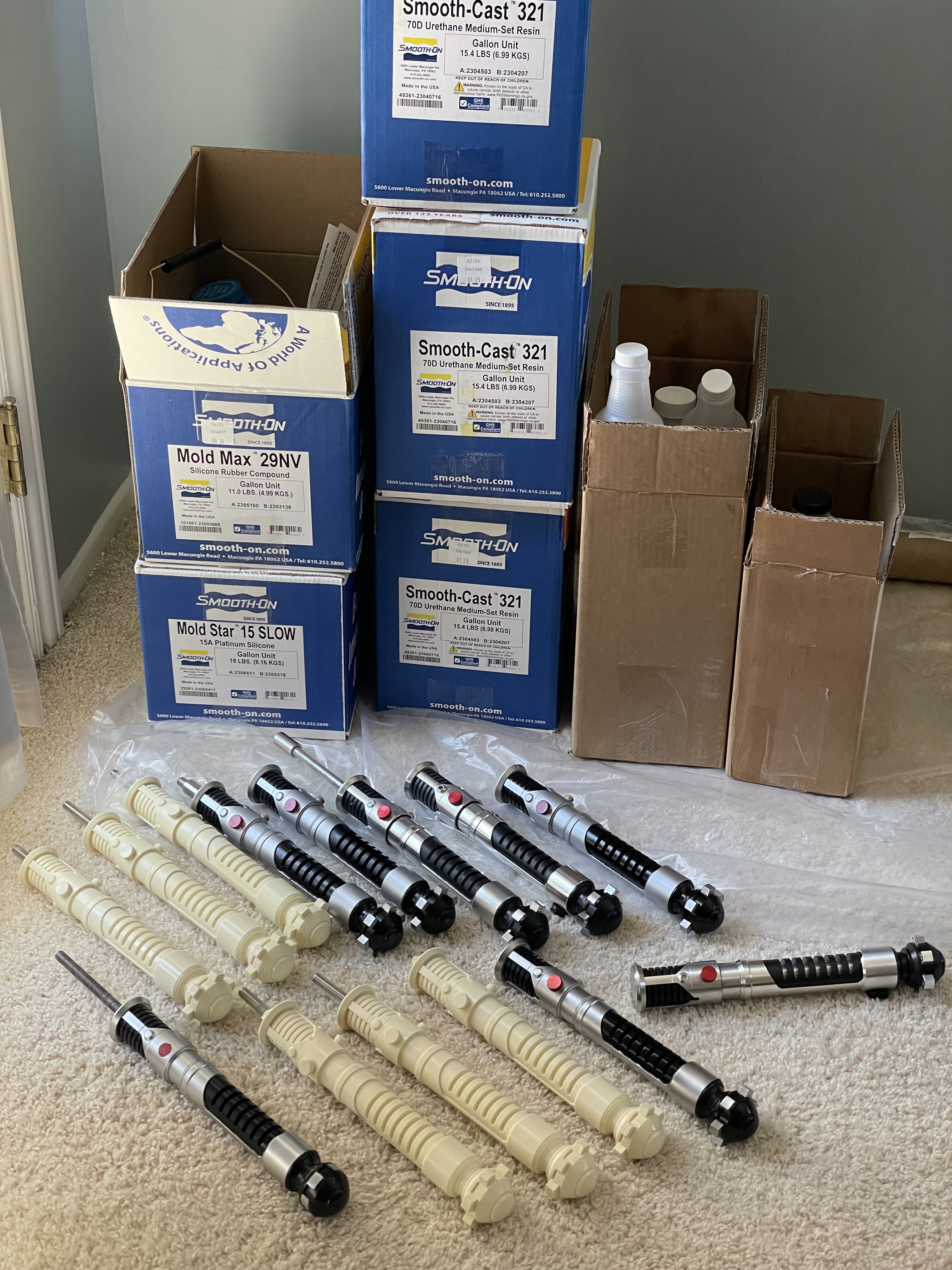

I have been busy doing some house projects since my last update, but just because I’m not posting doesn’t mean I’m not working:

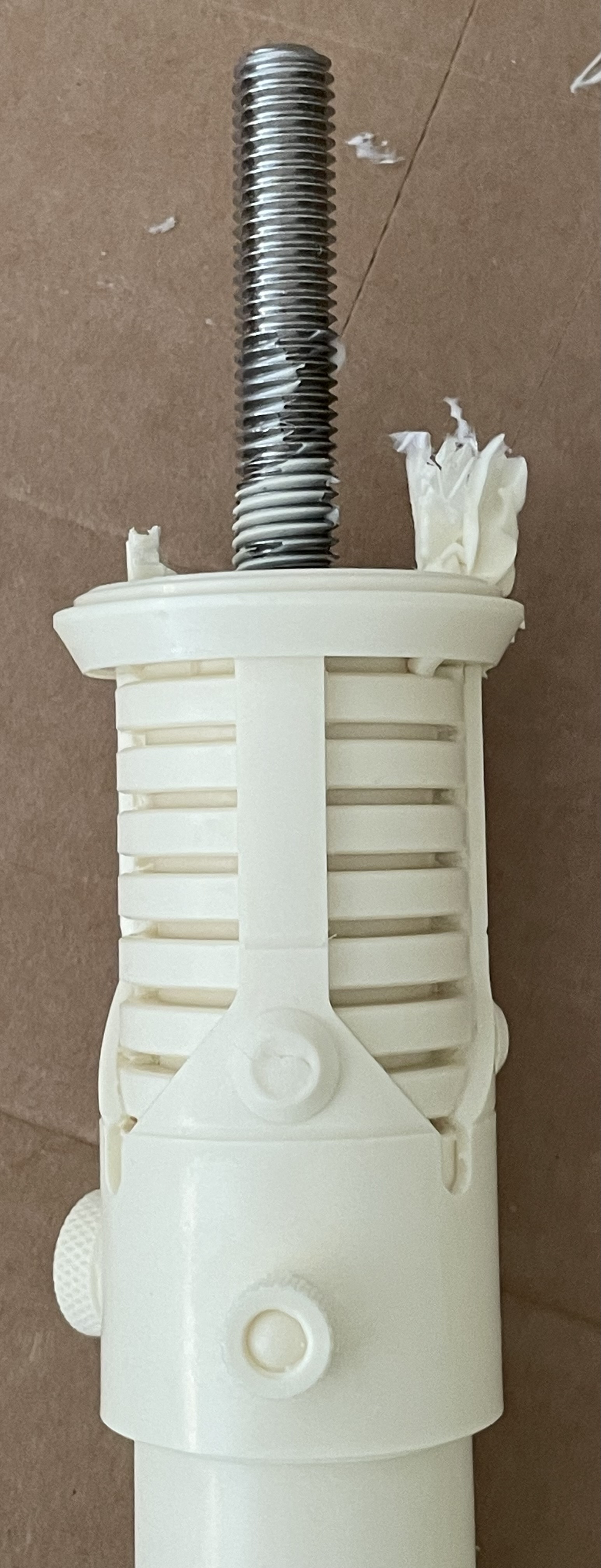

Just realized I am curious about this - do you stick the rod in after the pour? If there's only 1 opening up top, I'm wondering how this process works
There’s three openings at the top of the mold. One for the threaded rod, one pour spout, and a small vent. They each intersect with the saber on the fender washer. The vent and the pour spout are 180° opposed, with the threaded rod hole dead center obviously.
I took great care to make sure the mold was made on a perfectly flat and level surface. I built a fixture and hung the saber down into the mold by the threaded rod. It was a loose connection so the whole saber could swing by the threaded rod. This ensured that the saber was perfectly vertical in the mold. The benefit of all these precautions is now I can install the threaded rod before closing the mold. As long as I pour and cure the mold on a flat and level surface, the threaded rod will be self centering (since gravity will pull it straight down) and aligned with the axis of the saber.
