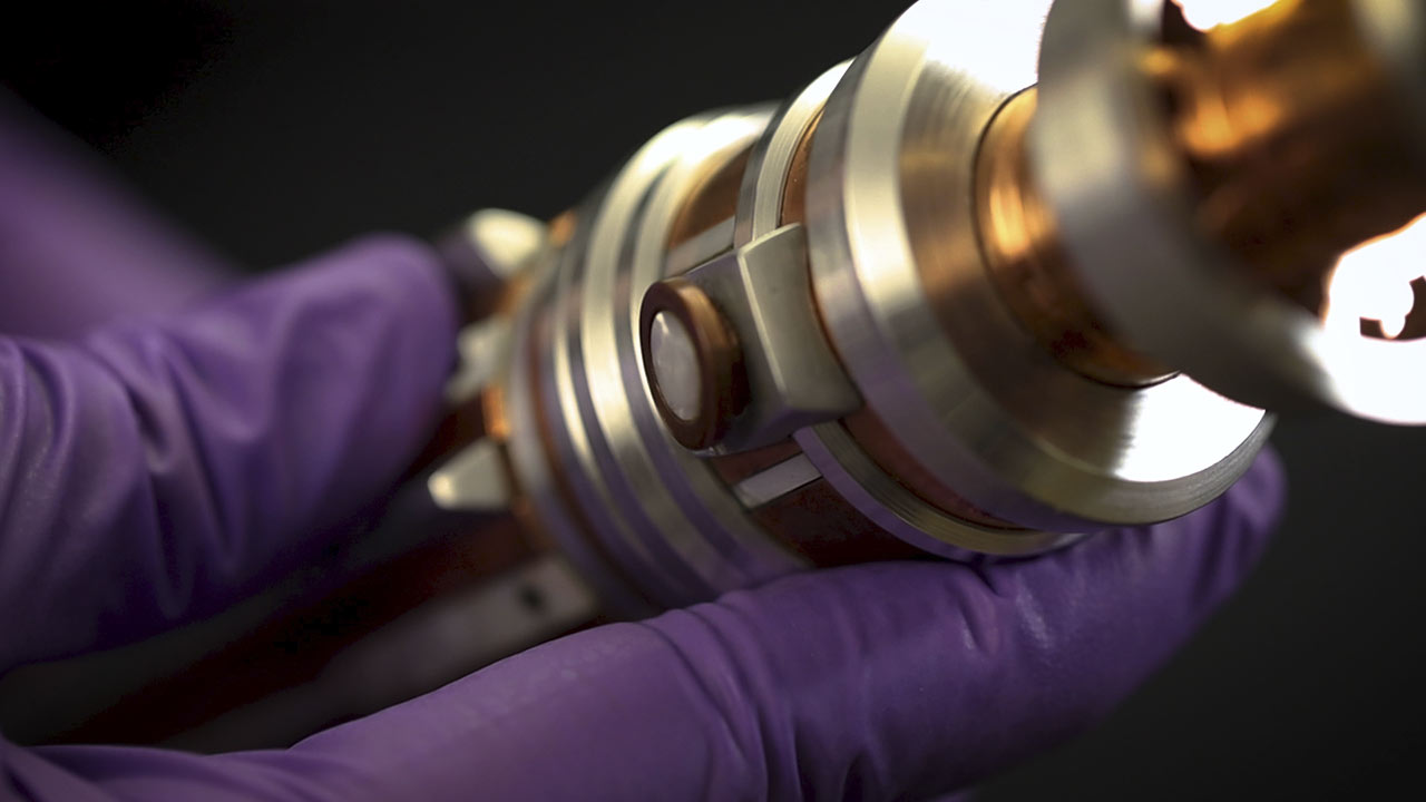

Almost impossible to tell whether it is plated or actual copper.
there are definitely some tells on breaks (and I am using those as for sure breaks in the assembly). There are other spots that are less sure.

As an example of such "tells"... you can clearly see the ring in the middle of the switch sits over the copper here, and that the switch has a cutout to sit on the ring vs the ring being cut:

I disagree. Simply do to the fact the tarnishing of the copper between the scenes and the archives is obvious. It has a copper surface that is getting patina.
Thank you for pointing out those 'breaks'!
I definitely notice breaks / gaps between aluminum sections and copper sections.
Thus, I believe copper parts are actual copper, rather than plated.

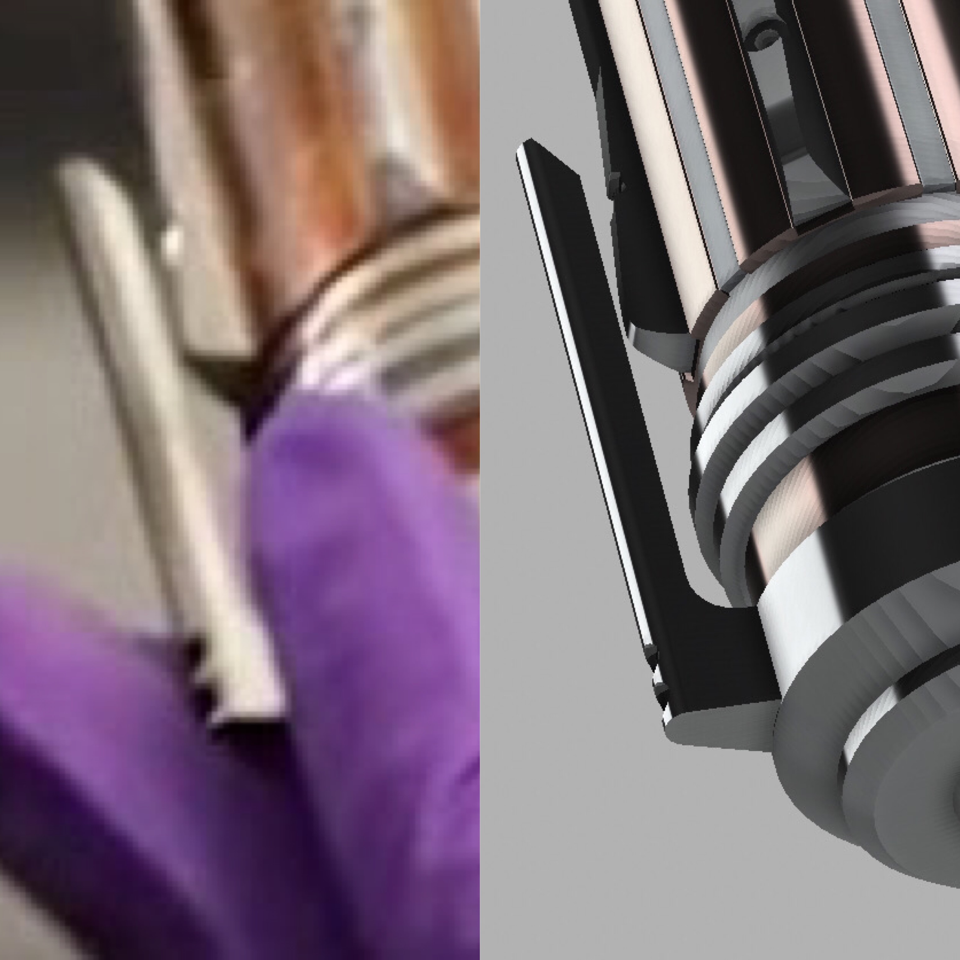

Alright. So I need to make adjustments and overlays but rough cut of belt clip. It is NOT there yet so don't fret everyone. But it's rough shaped and I have a sense of the core geometry of it, I just need to adjust it all for accuracy.
I don't think that's a double groove at the base of the grip/clip. I think its a rivet or screw but blends in because of the low resolution.
