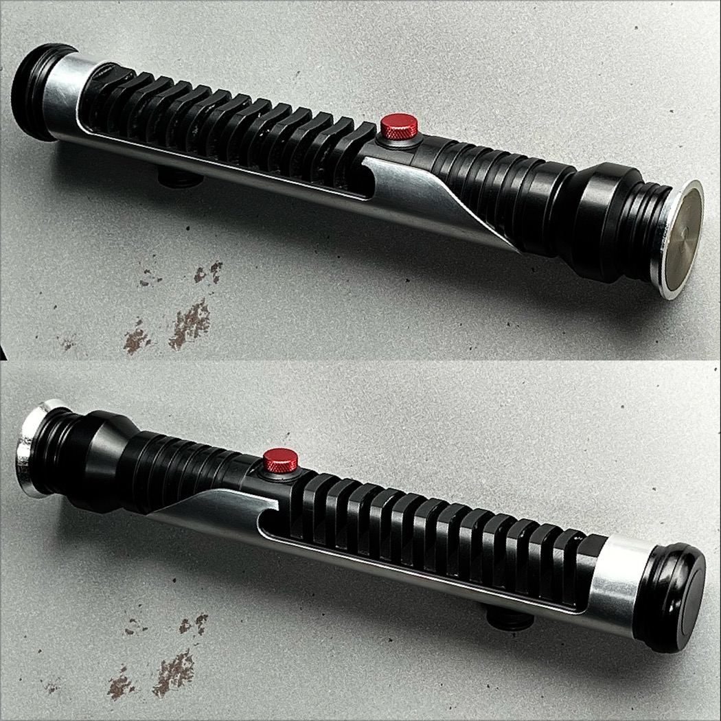

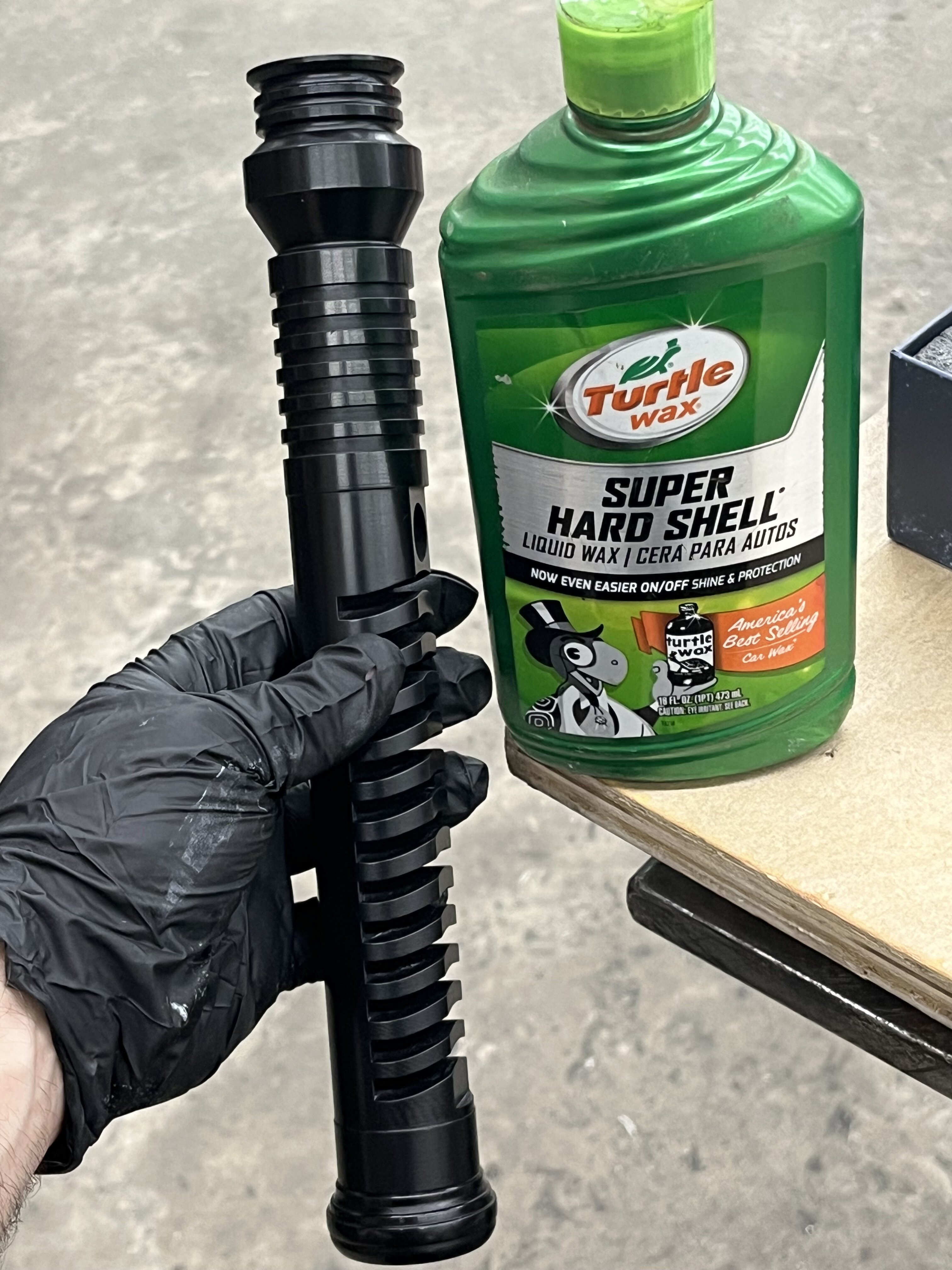

It should be reiterated that the one and only reason I’m even considering a repaint is because the difference between this and my Obi-Wan when placed side-by-side is pretty noticeable. My Obi-Wan has the satin sheen of a well-handled prop that’s been polished by wear and hand oils (as simulated by the recommended black paint, back during that run), whereas the Qui-Gon is very matte and factory-fresh in appearance.
But, in isolation, the Qui-Gon looks great, and I wouldn’t be running to tell anyone that they should repaint theirs. A light buffing with steel wool or a soft cloth would probably give it a nice sheen, if so desired.

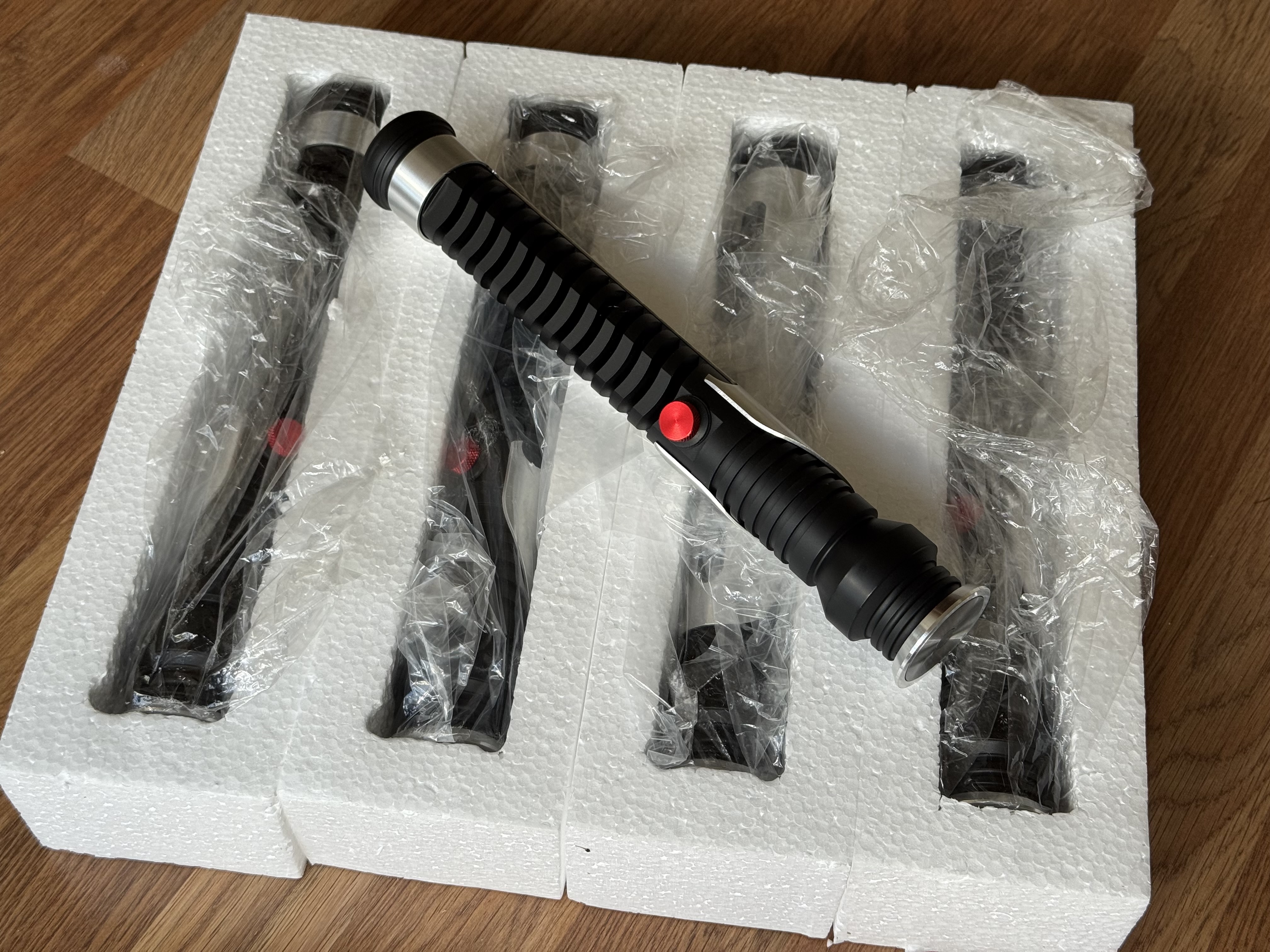

Whew. Okay, stand down everyone. All of my sabers have now been delivered!

Why did you decide to paint your TPM, out of curiosity? Chatted with Dewy about buffing out some spots on mine, and then I may put a little sand on it and coat it up. Haven’t decided. Would likely do the same with this one.

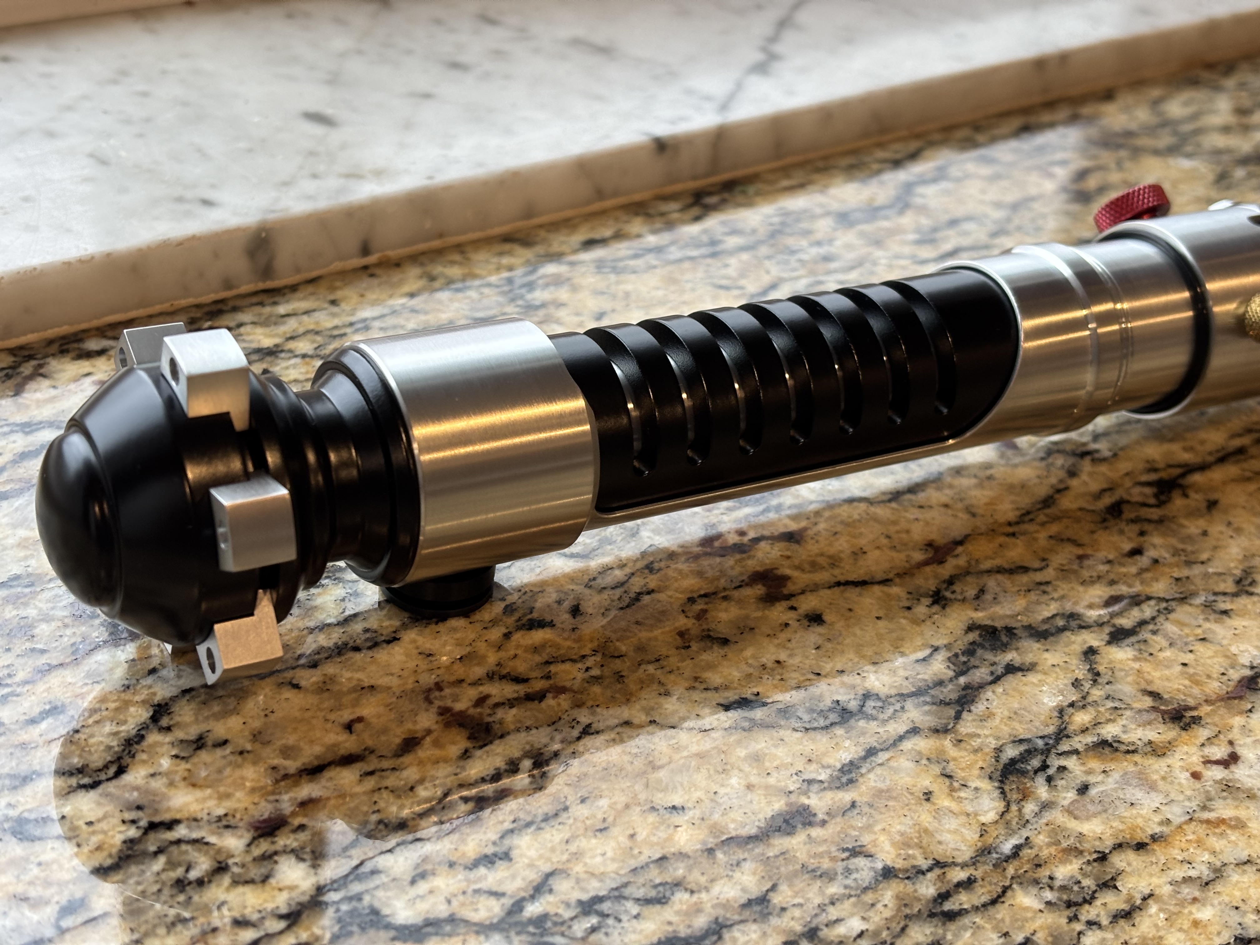

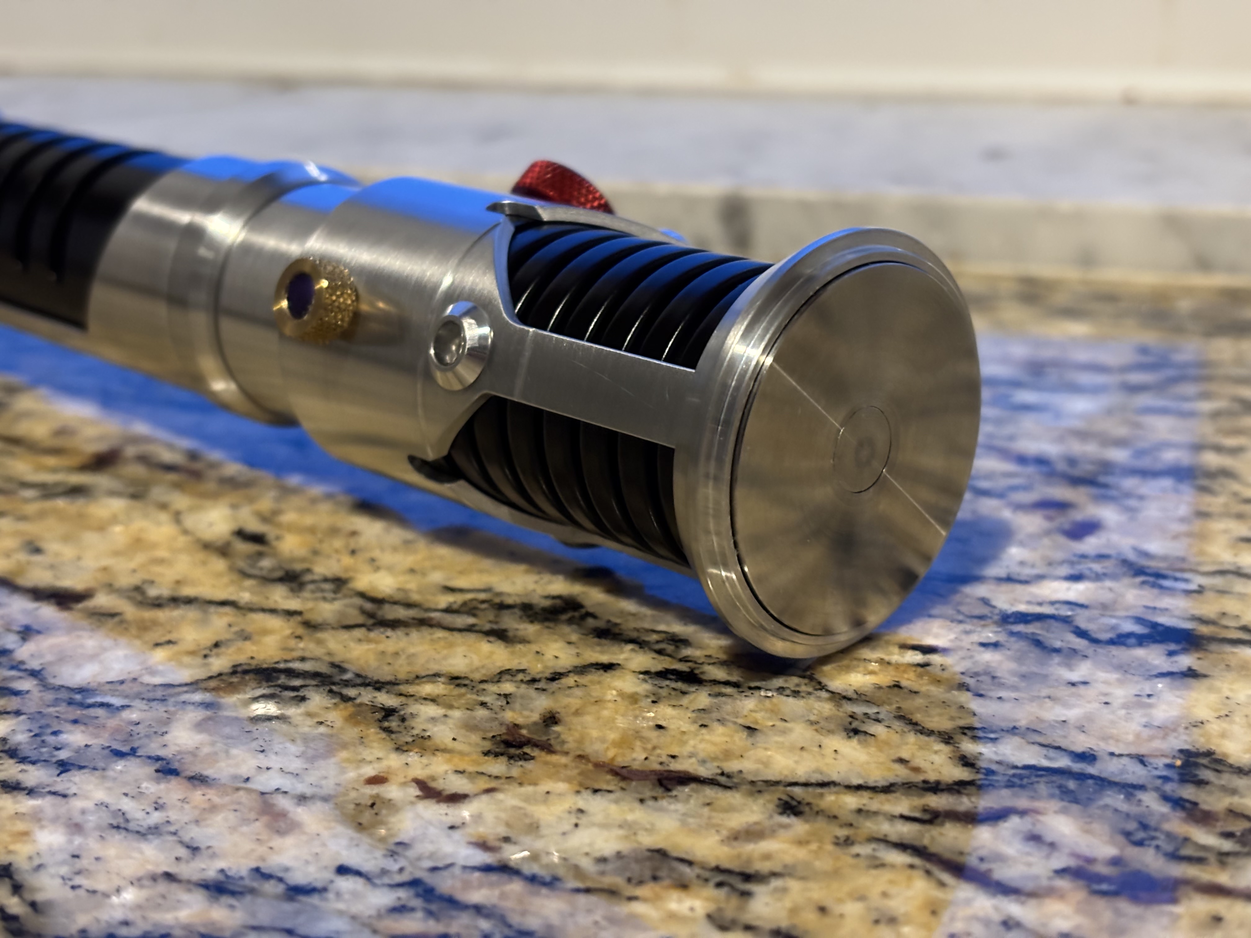

So the reason I painted my OWK saber is because the original prop has a thick enough coat of paint that it dulls the sharp edges of each groove and angle on the black sections. It also had that slight satin sheen. I used about 3 coats of paint on mine and it gave me those nice soft edges.
You did really well, I very much like this, and it's encouraging for doing mine maybe. As mentioned, Dewy gave me some tips to maybe "polish" it up and maybe get a slightly better look for my taste, but your paint looks really good. Thanks for sharing :) I just may do this.
Thank you. With the obiwan hilt it was just the delrin which didn’t have paint on it. I used a universal bonding primer first and then satin black. My main concern with the Qui-Gon is that I don’t want to have an issue with whatever paint was already applied, as some of them don’t play nice with each other.
Yeah for sure I have that concern as well, but want them to match.
I have additional concerns because of the finishing marks on my QGJ as well. There are some machine markings, and bit of wrinkling in the fin grooves. Certainly want an accurate appearance, and I’m concerned I may not have the skills to even out all the surfaces in order to paint it cleanly. I also have some deep scratches and grooves in the ABS that I’ll have to try and smoothen out without impacting the shape of the ABS core.
Thanks for sharing the paint choices and such as well, very helpful and I do really like the final look you achieved. Lots of stuff to YouTube coming up lol.

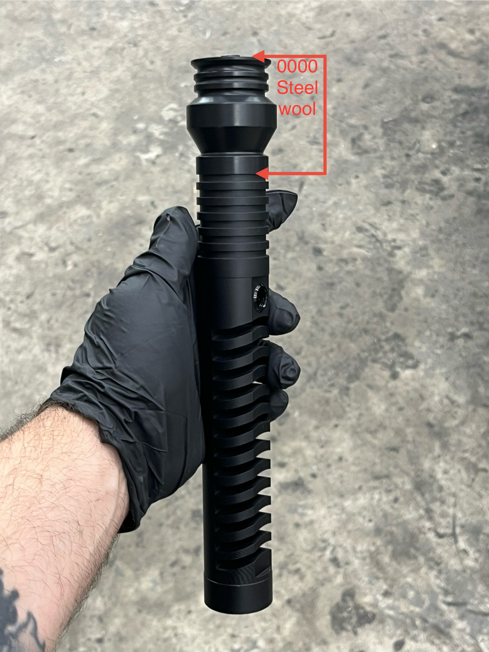

Finishing off with 0000 steel wool on the shroud to randomize and matte it a bit (also used a dynamic file to blend a scratch along the side- but not everyone will have that issue)
Chemical coctail left to sit only a few minutes…
that looks awesome!!
