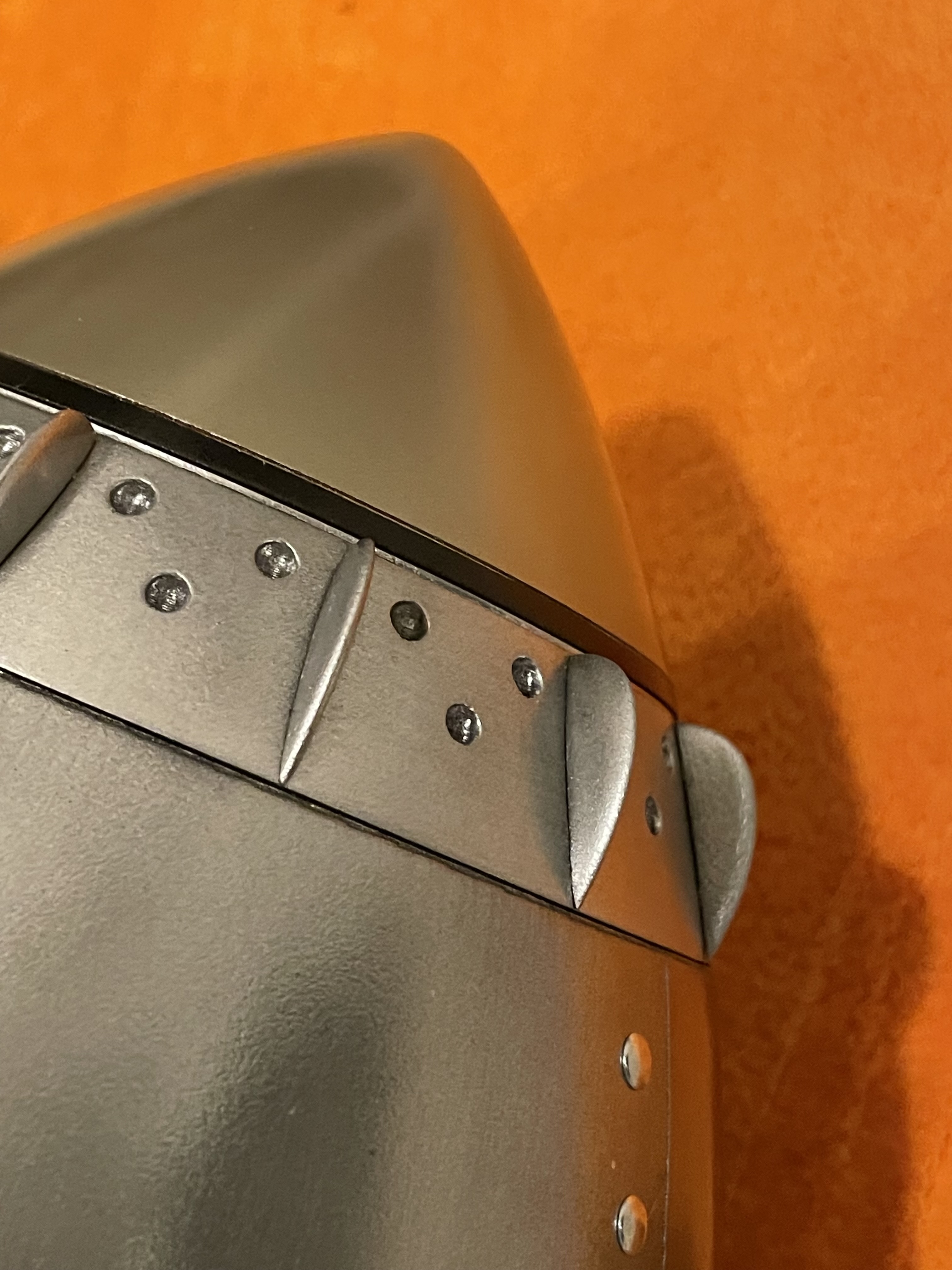

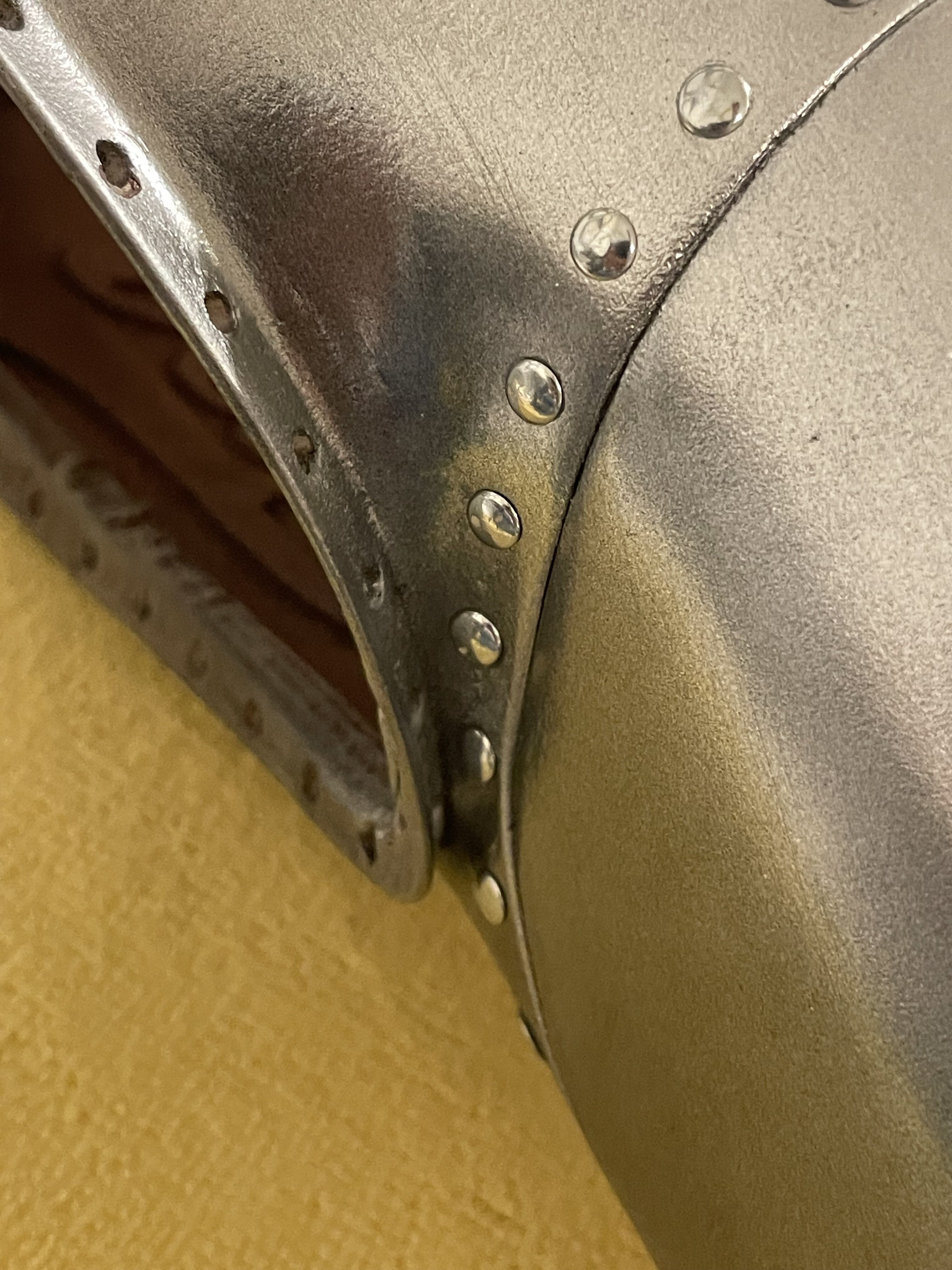

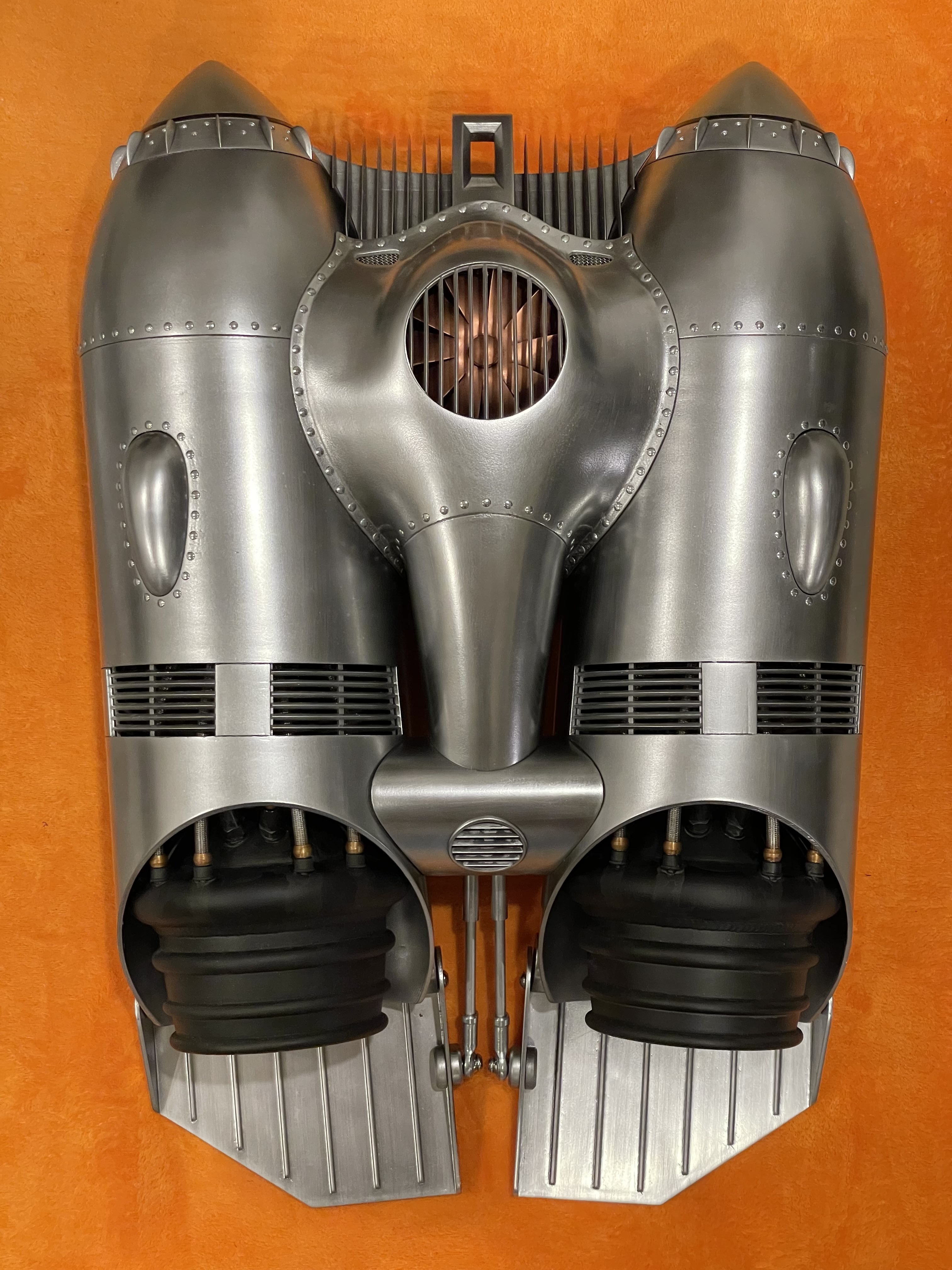

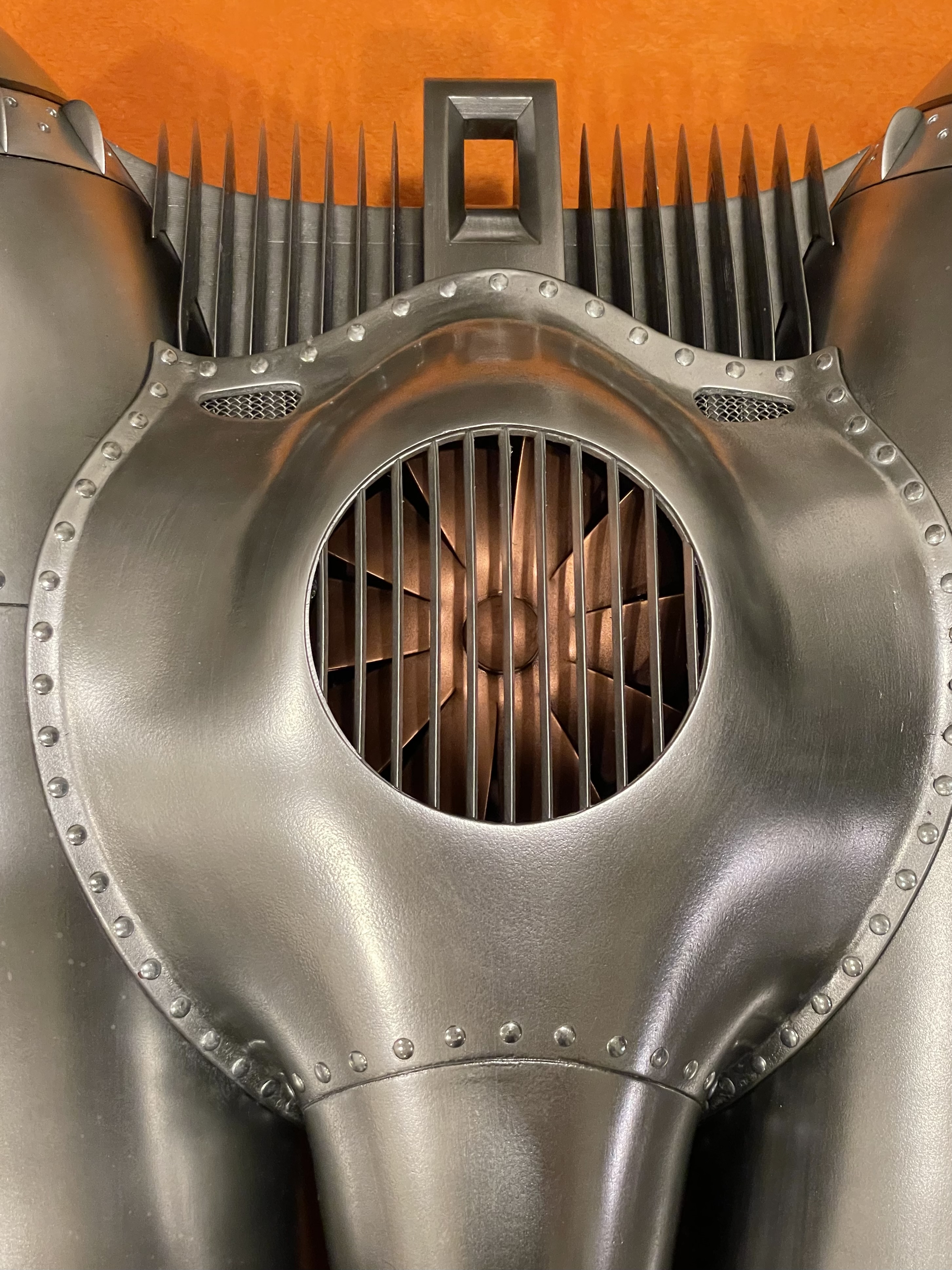

Rocketeer “Veepy” Jetpack 3D printable kit project.

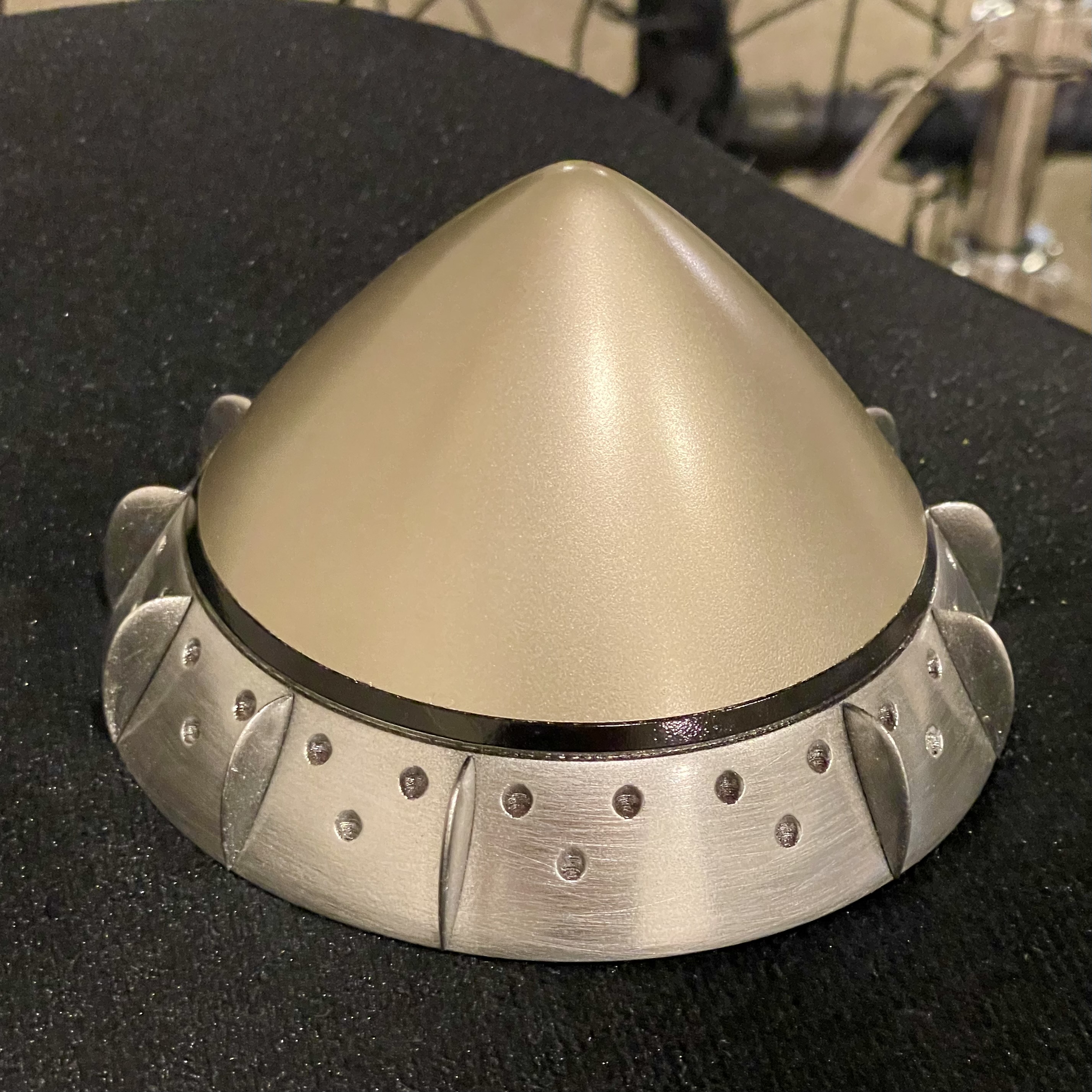

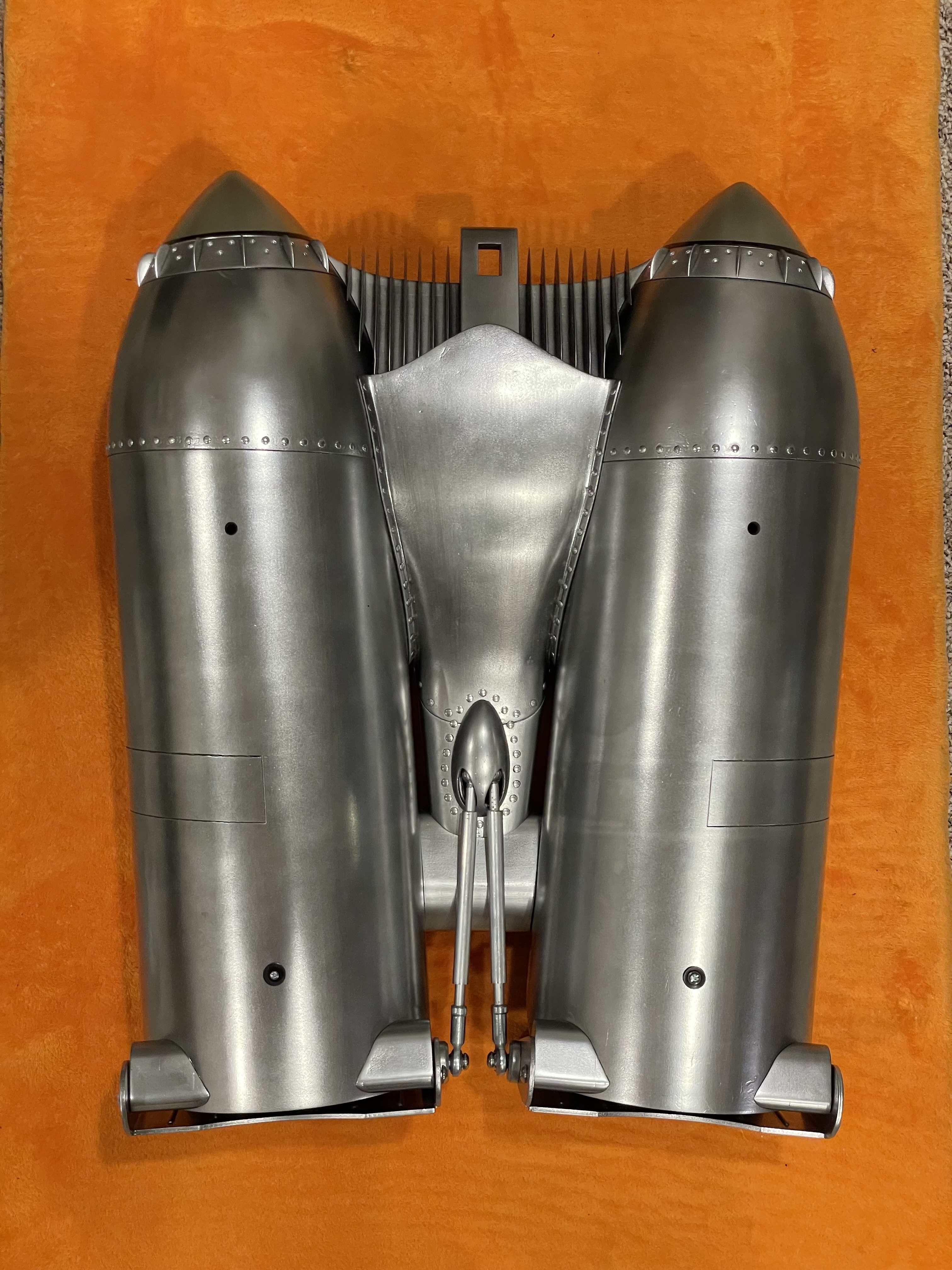

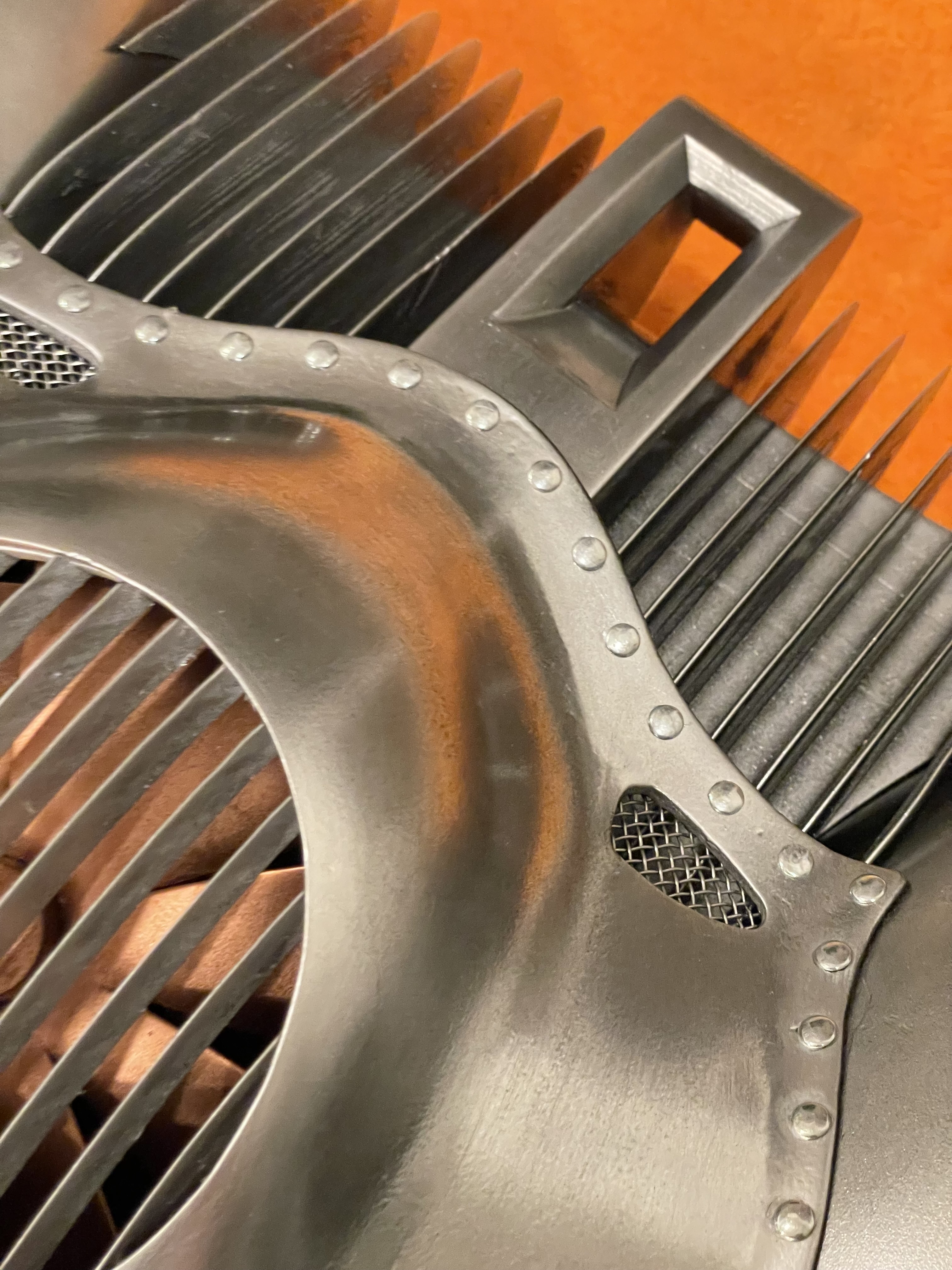

Last test fit before moving forward.
that’s a *really* nice finish, gnolivos.
Have you applied any kind of seal coat?
I’ve been going crazy trying to find a way to seal metallic paint without losing the luster.
Also, what did you end up using for the flared nuts?
I use Spaz Stix chrome paint. They also carry a special chrome paint clear coat that barely dulls the finish at all. It doesn't however give a glass like coating like many other clear coats I've used. It just seals and protects.
Flare nuts? They carry them everywhere. I think I bought online. Very common part.

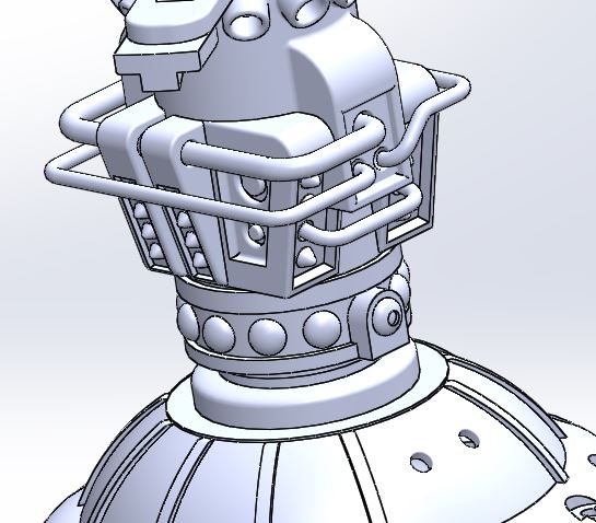

New update with minor tweaks.
V 1.22 (October 24, 2023)
  • Tweaked radiator fins to make them slightly stronger.
  • Tweaked main circular vent fins to make them slightly stronger.
  • Tweaked small circular vent fins to make them slightly stronger.
  • Tweaked the radiator center piece very slightly. No dimensional changes here.
  • Included a version of the hull pieces that have an opening behind the rear egg to facilitate flap rod mechanism movement.
  • Included information on how to create a functioning flap rod mechanism.
