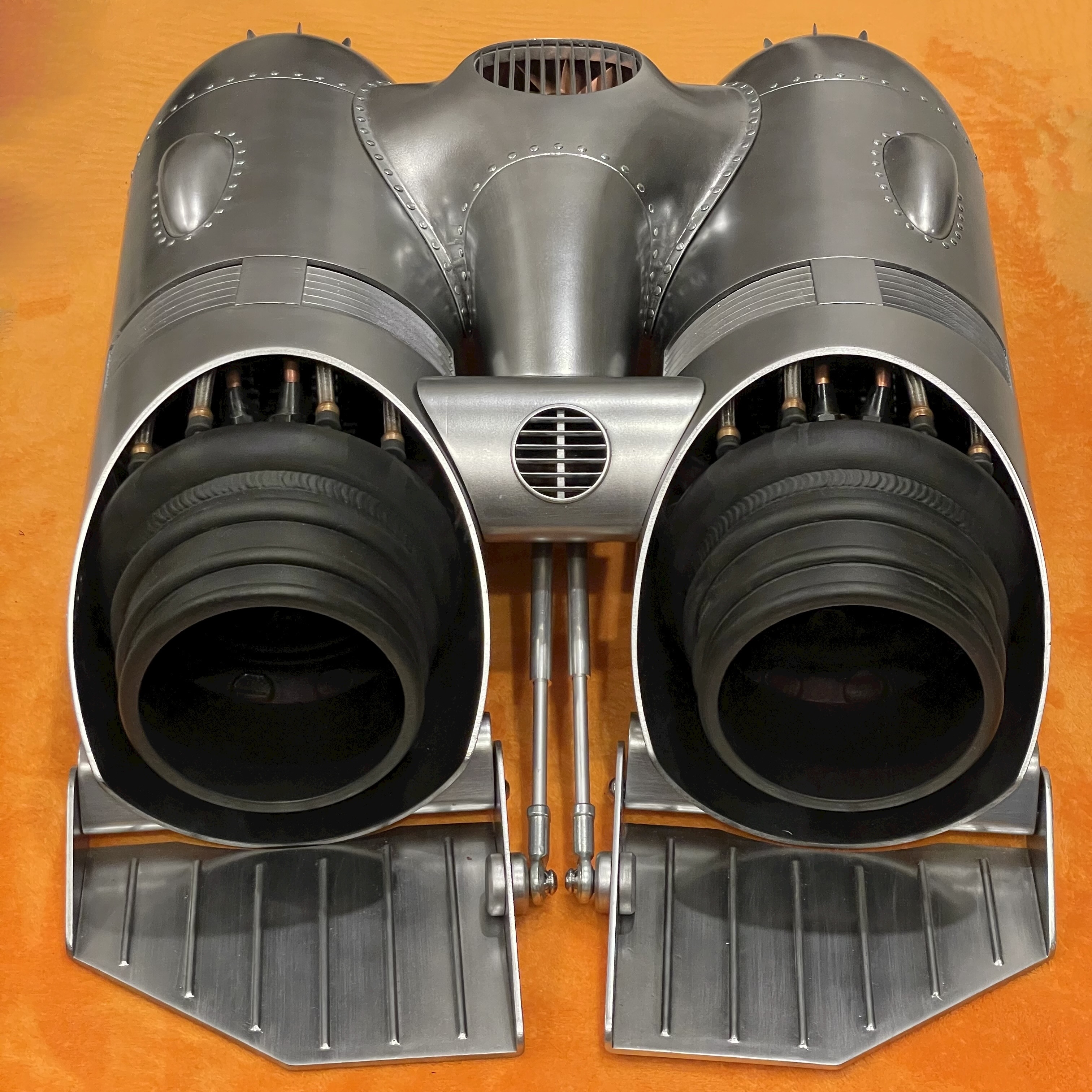

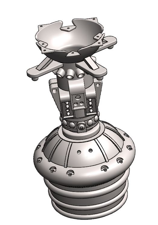

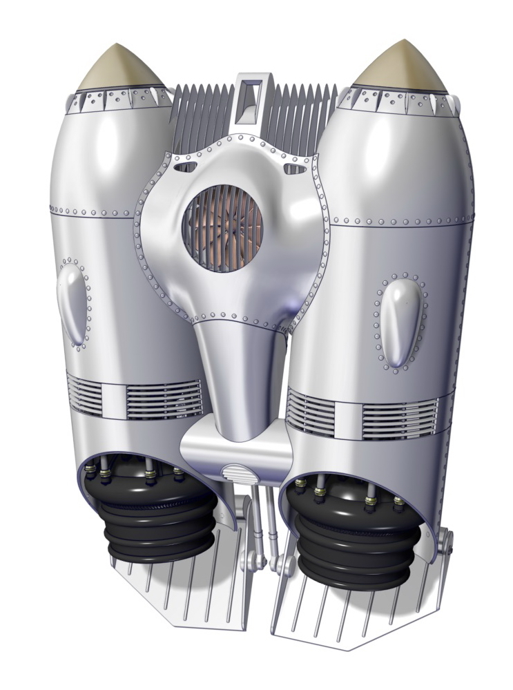

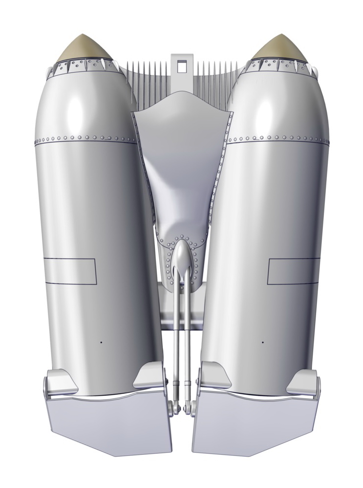

Objective:

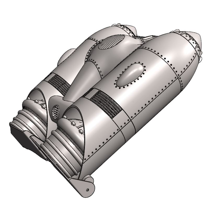

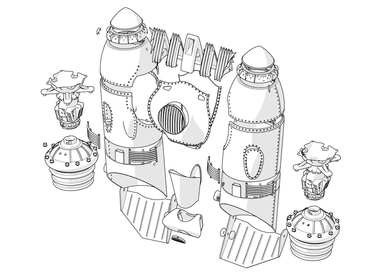

Create a highly detailed and accurate 3D printable file for The Cirrus X3 Jetpack.
Requirements I set:
  • MUST BE ACCURATE
  • Must take into account original dimensions, down to the millimeter accuracy.
  • Must be 3D printable at home, hence, must be split into multiple parts.
  • Parts must join together seamlessly.
  • Lip and Groove joints wherever possible.
  • Alignment notches wherever possible ensure proper positioning on assembly.
  • Rivet holes, so its easier to sand, and real rivets can be put in place.
  • Flaps must be fold-able, with proper clearance.
  • Magnet pockets in cones for easy cone removal and access to internals.
  • Assembly features to attach real hardware for assembly (holes, pockets, etc.)

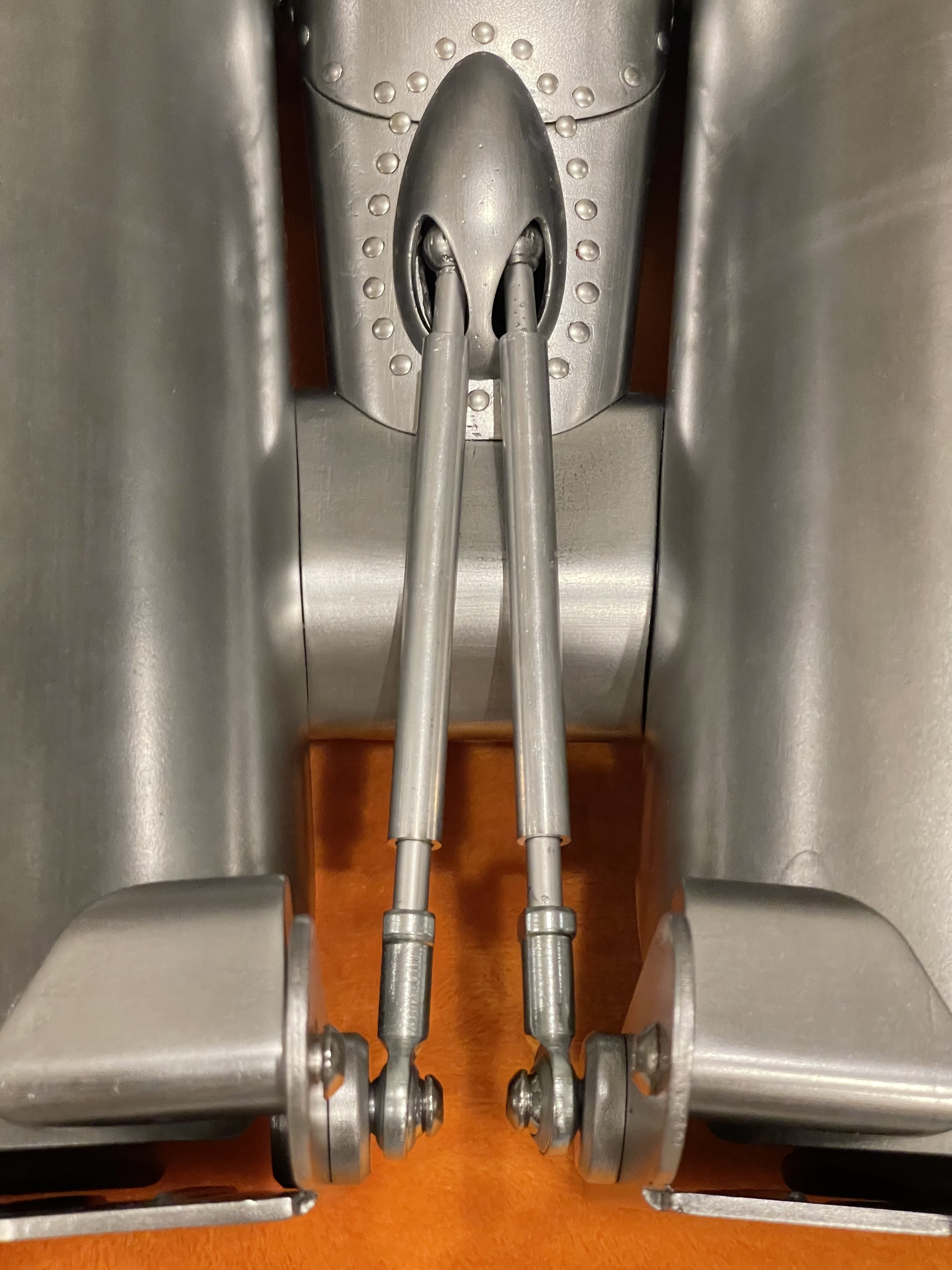

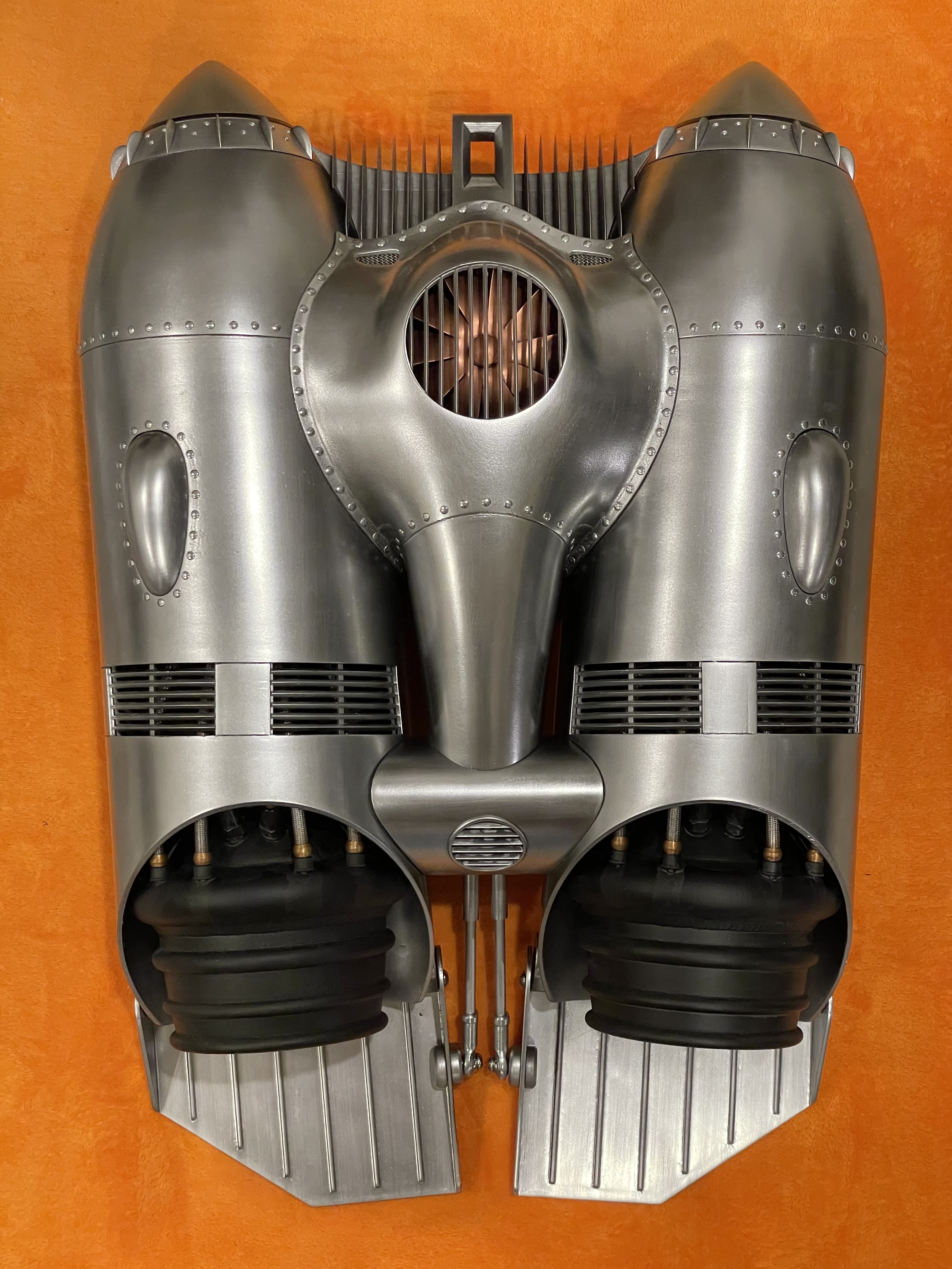

Status October 24, 2023:
Version 1.22 Released. Some minor tweaks only, and added information on how to create a working flap rod mechanism.
Status February 24, 2021:
Version 1.20 Released, with final refinements. V1.21 a few days later with updated documentation but no geometry changes).

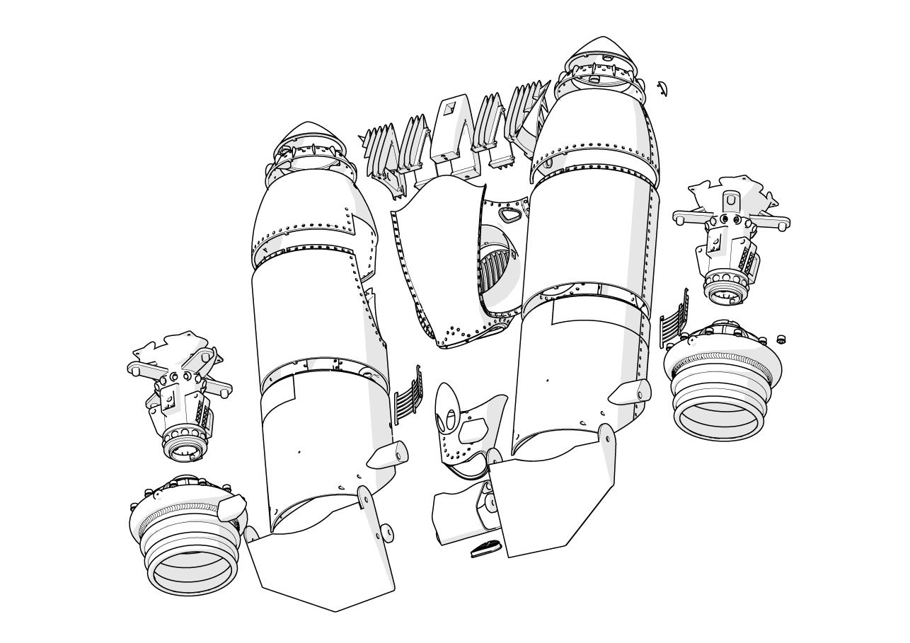

Download Link: Assembly manual:
Illustrations:

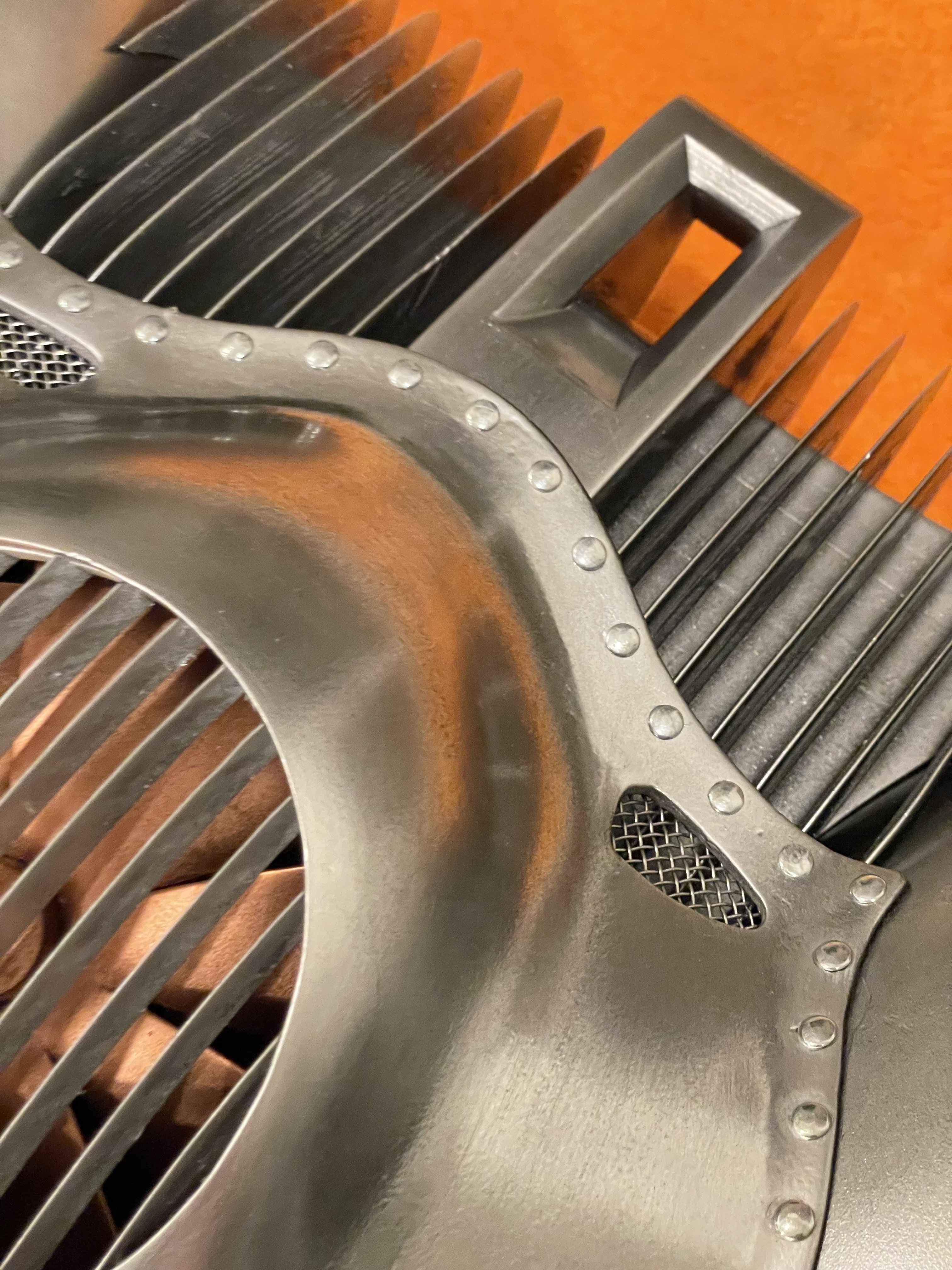

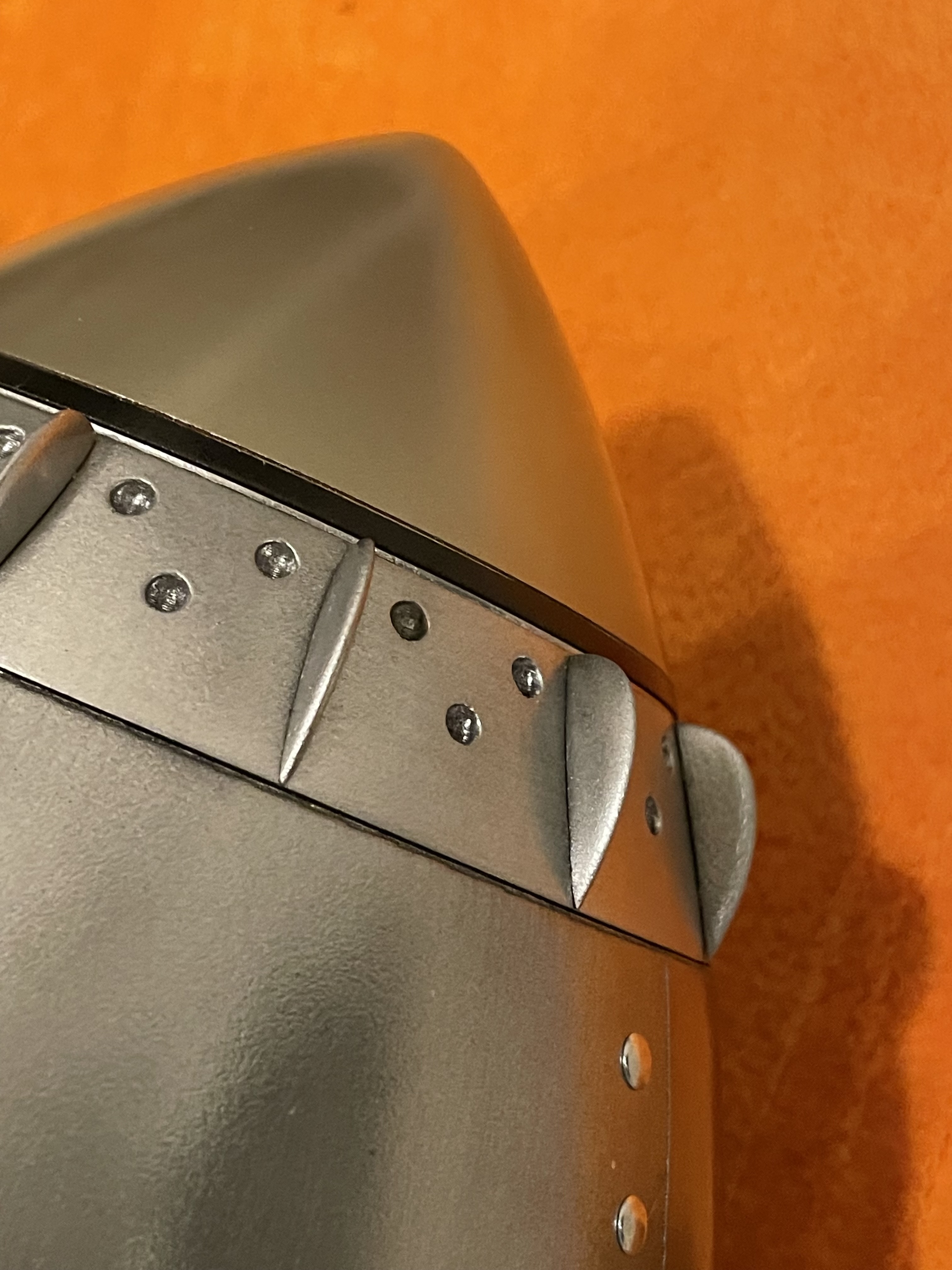

Actual printed Veepy model...

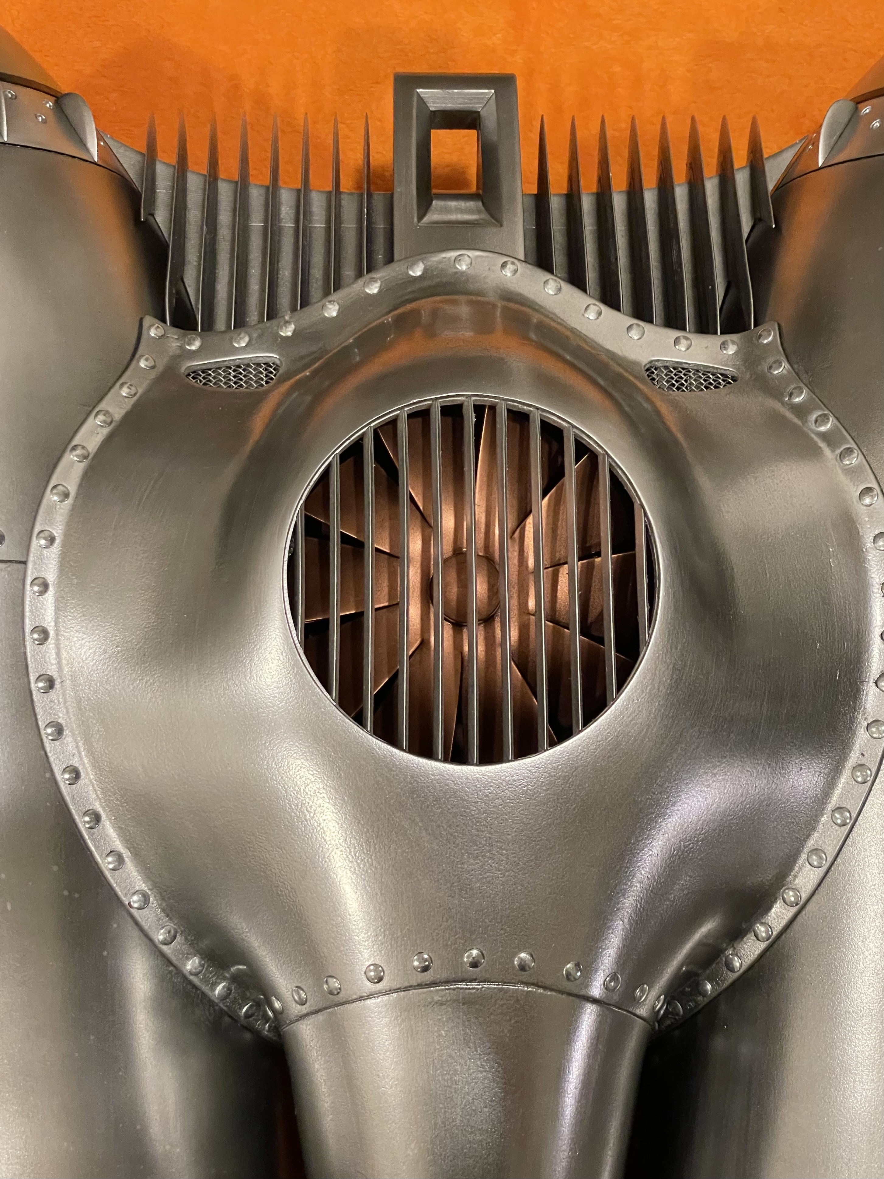

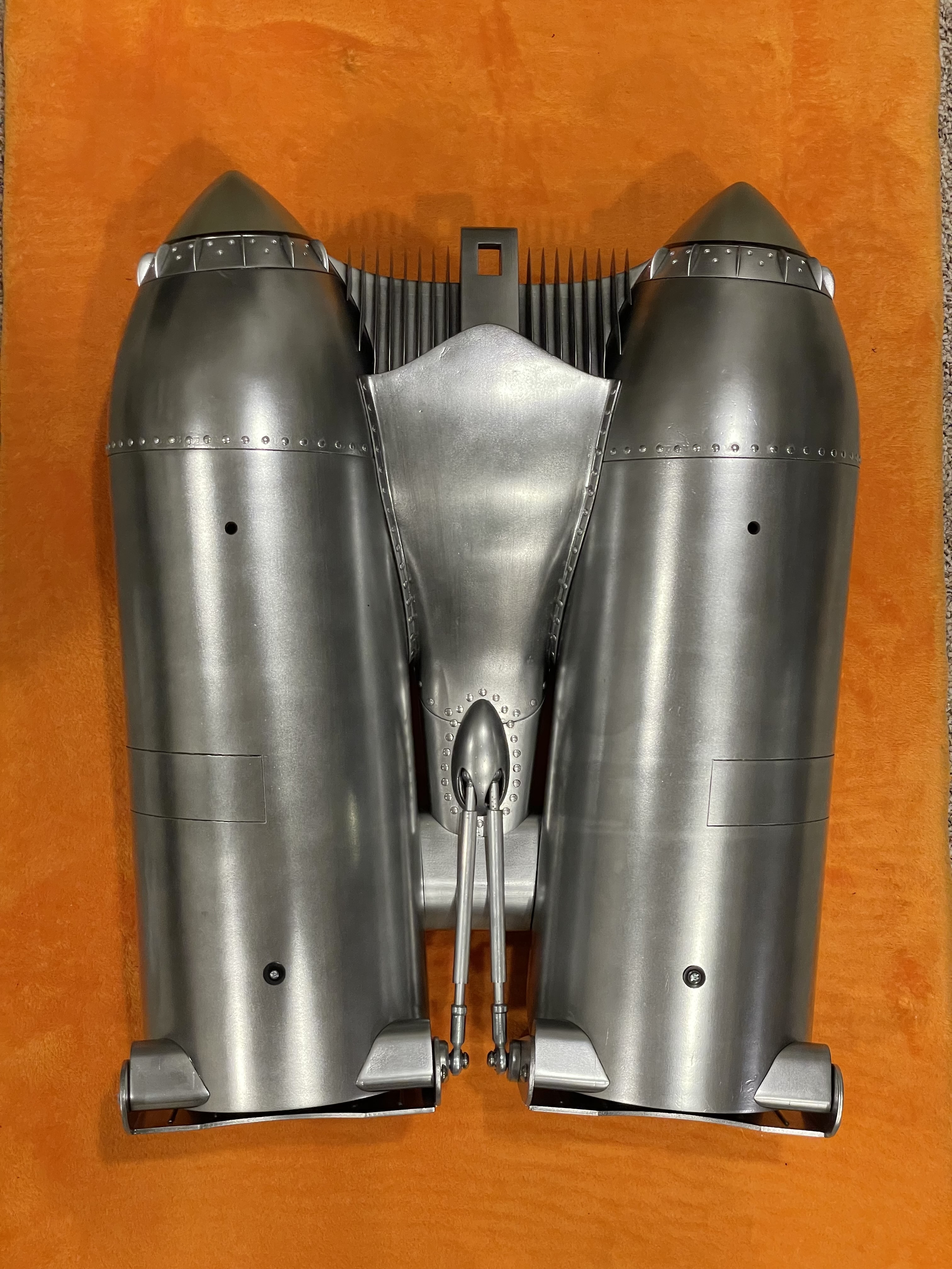

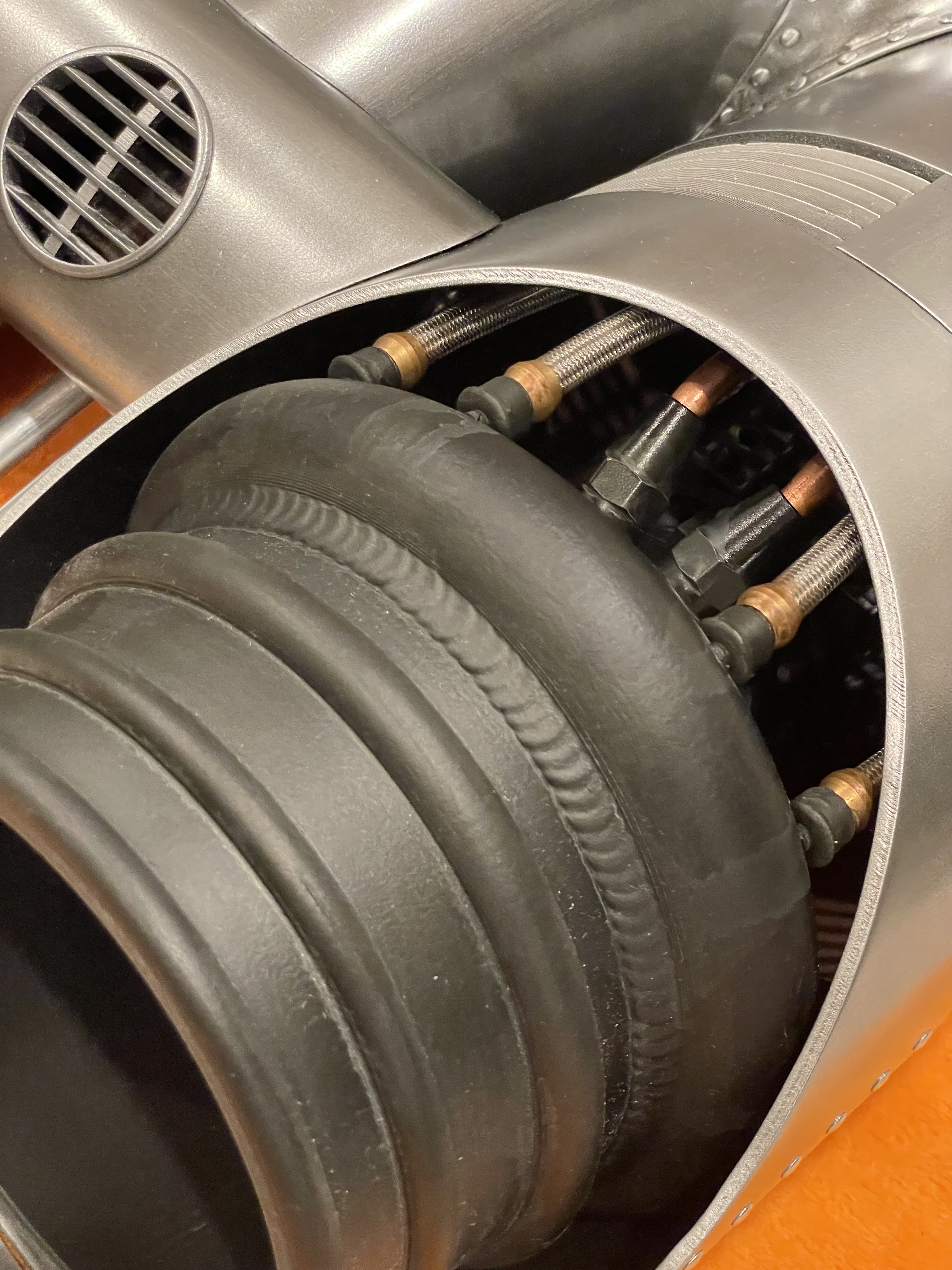

Looking forward to the progress. Seems you're off to a great start, and I love that you're thinking about the finishing process in your design.
The largest piece measures approximately 7in x 7in x 8 in.
I think the best approach would be print largest pieces in a rough large format printer, and the smaller pieces in a detailed high quality unit.
Any plans to model things like the hand control/trigger and helmet?
I know there are various helmets floating around out there but they all seem to vary a bit in terms of accuracy
