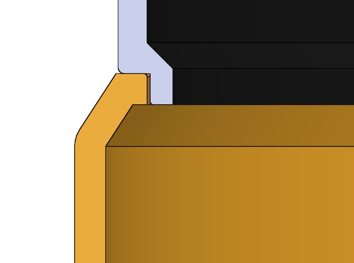

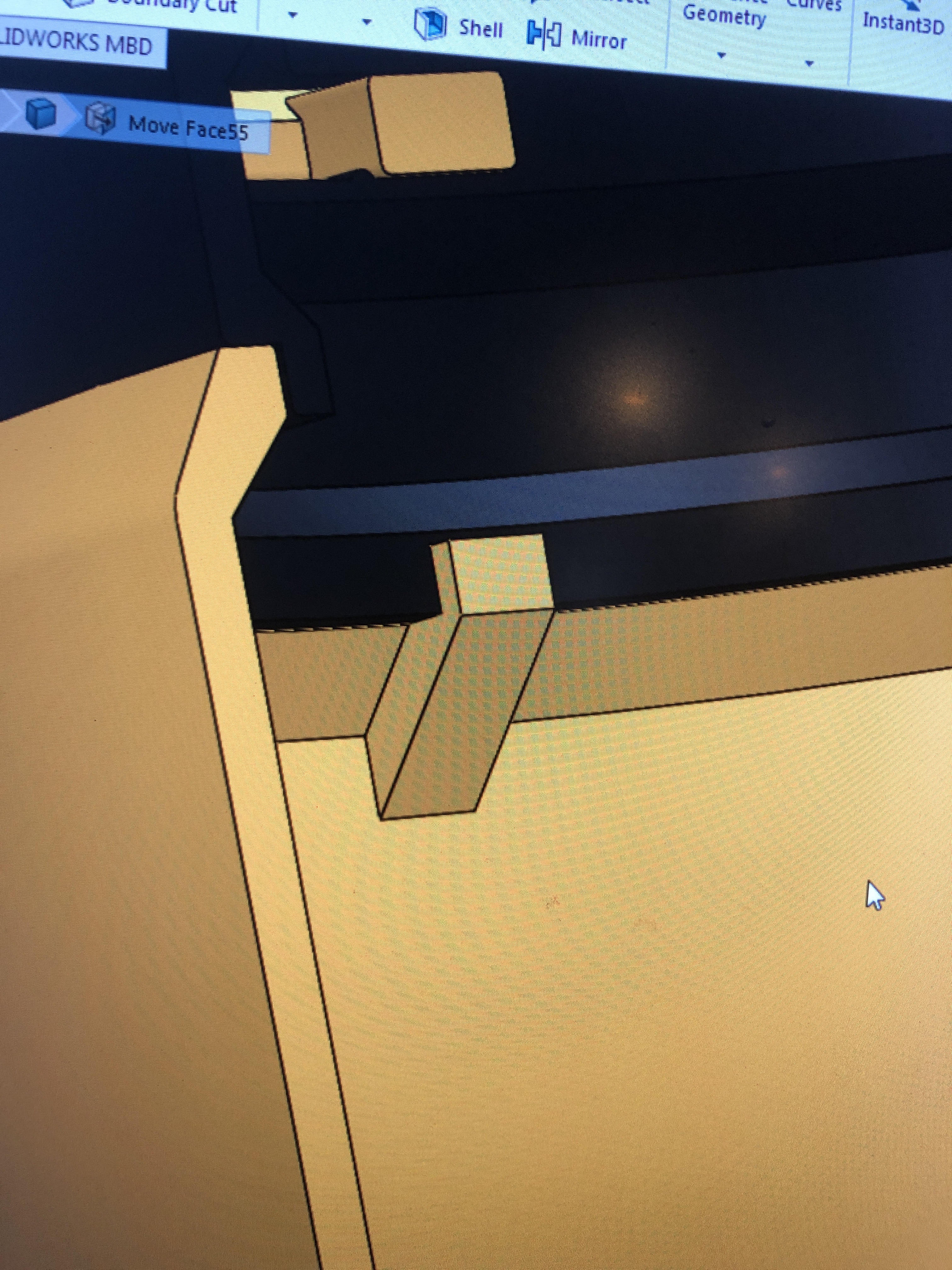

This is really good Input! I will make some changes and make screenshots to see if this works better.
Incidentally, shouldn’t the slicer be smart enough to add supports mimicking those 45 degree angles? Just wondering !
gnolivos

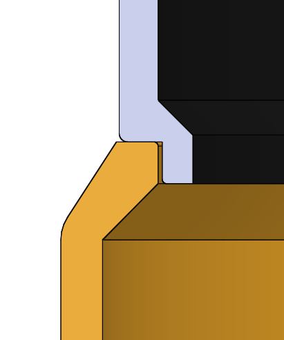

OK I only found one region where this can be optimized on this mode based on your feedback. Does this look correct?
NORMAL:
OPTIMIZED
Mr.Spider
Yes that is exactly correct.
You can I theory make your own 45 degree angle supports but it involves turning the object in the slicer to do it and then turning it back.
Essentially a slicer will only build supports straight up either from the bed or in objects as well.
There are tree supports too but those are good for smaller pieces. Not an internal flat ring. More like supporting fingertips or other small features.

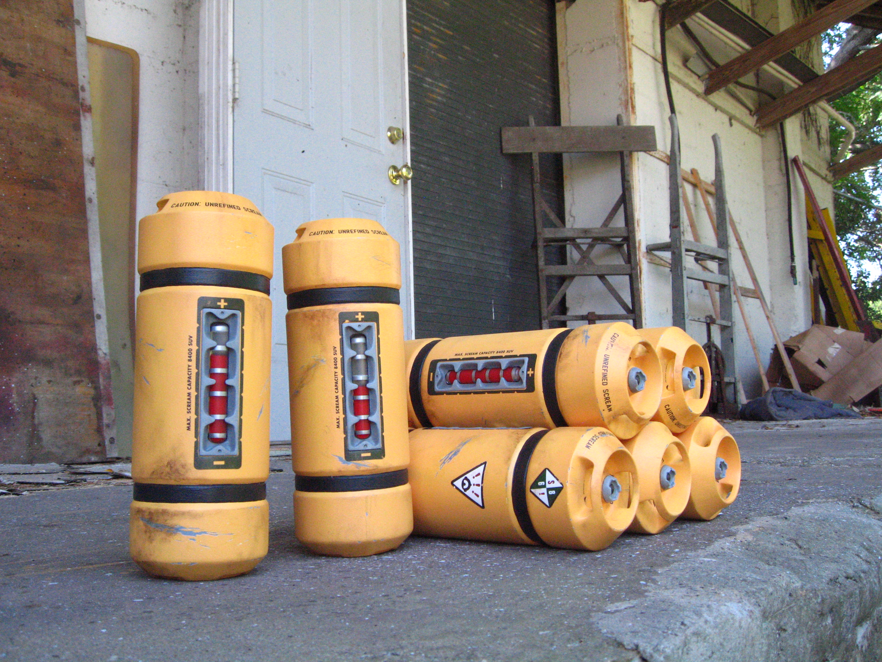

Here are some pictures of Scream Canisters I've built in the past where I also strove for screen accuracy. They are roughly 1/3rd scale versions that were 3D modeled, then 3D printed a master, and then molded and roto-cast the final canister. All of the gauges are clear resin with an insert to show a different "fill" level. They were a lot of fun to make.
