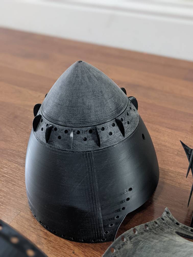

I have printed all but the upper engine and the right engine flap. I have the lower engine printing now and it should be done in about an hour and a half.
I printed everything on my Anycubic Predator printer. It will end up taking just over 3 rolls of filament. I like to use minimal supports, as you can see from the engine pic, so your results may very. I'm slicing with simplified 3D so I can place the supports where I want them.
I have started the best part of any 3d print....sanding! I tried to sand parts as others were printing to save time but kinda fell off it. I have decided on the colors yet but I will be airbrushing the whole thing. I don't think I'll add the electronics but I will be adding the fan and having it operational.

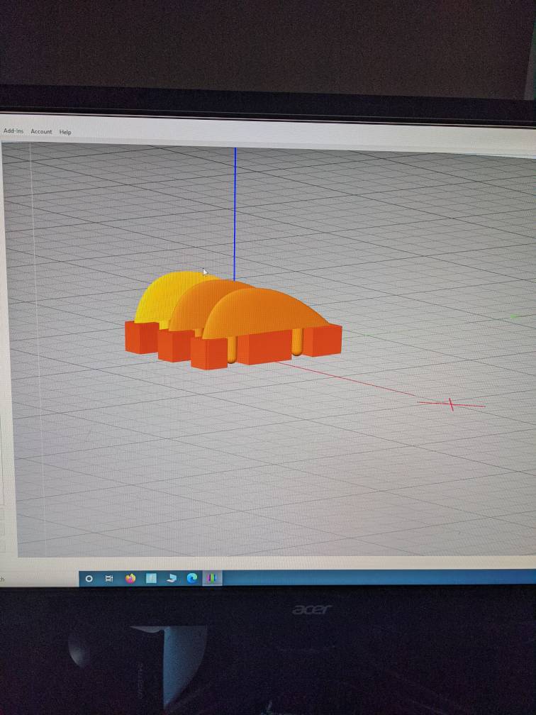

How did you orient the top fins ? I'm struggling to find the best way in S3D
I found that 3 was the most effective without the pegs breaking off during the print.
I printed at 60mm/s and moved my extruder closer than normal to the build plate.

I apologize, I meant the radiator fins , but I will def print the smaller fins that way.
Fair warning, as the manual indicates, the radiator should best be printed on a resin printer. I believed we managed to fit every smaller part of this model in a $200 Mars Elegoo! The print quality is incredible.
Yeah, I figured as much when I went to orient it. I'm looking into mars here in the new year, so I'll just focus on the FDM parts I can print for now.

I print everything at a .2 layer height and 10% infill. My speeds very, larger parts like the tanks at 100mm/s and the really small parts like the vents and the engine hose connectors 30mm/s
My longest print was the tanks as I printed them in one piece, they were 27 hours each. The hull was about 14 hours. I printed the hull in sperate pieces (as you can see in the pics) because the seams them make are really nice when they come together.
I print them like this. Just make sure your supports are running perpendicular to the part it's holding. You may have to rotate some parts to avoid this. That way the part will print across the supports not between them.
