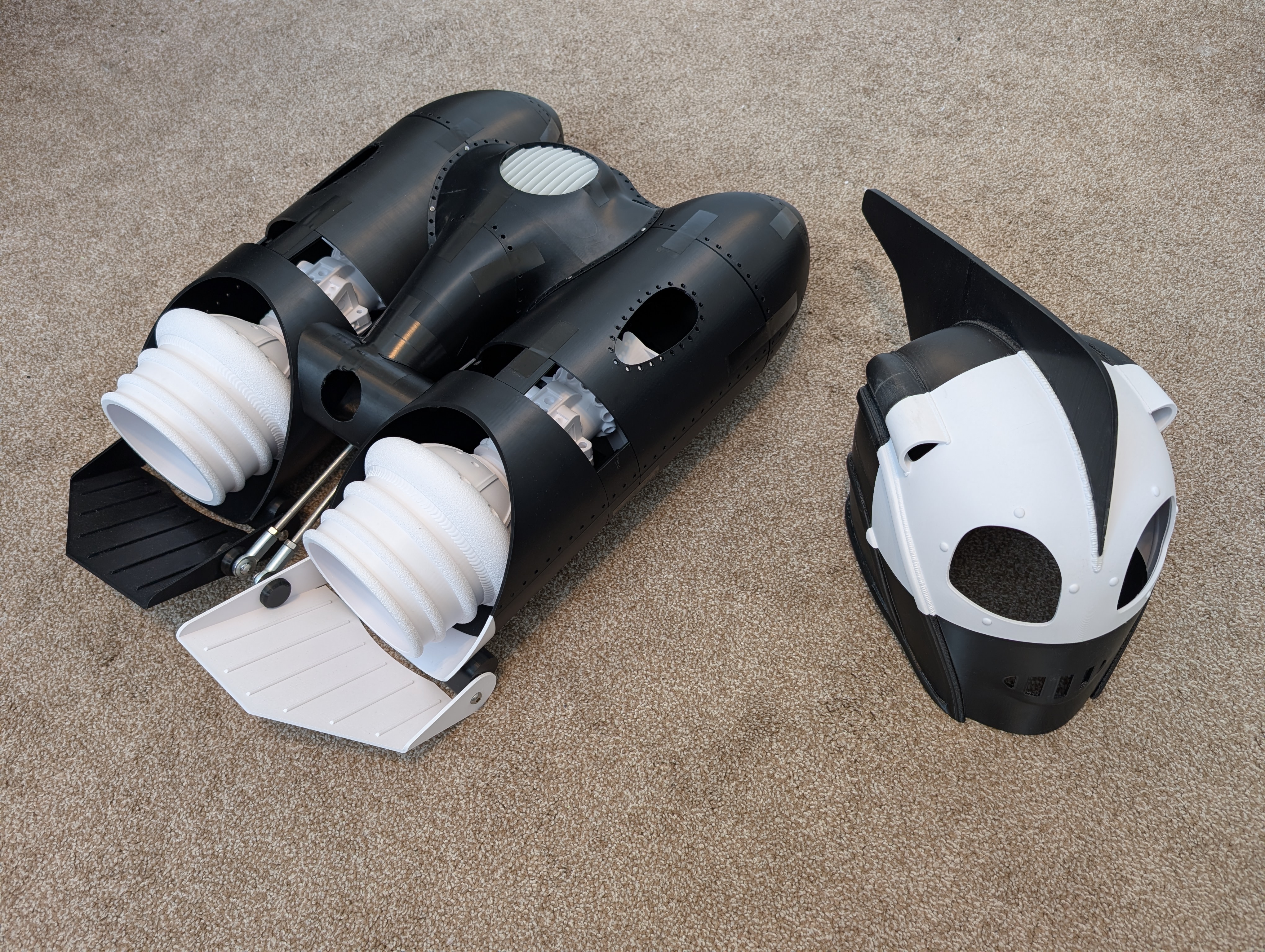

I ran out of black PETG part way :) I'm currently waiting on my friend with a resin printer to print some of the smaller pieces for me. Hopefully going to start sanding and priming this weekend. All the (FDM printed) parts were printed in PETG using my 2 Bambu P1S's.

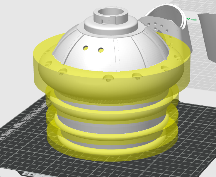

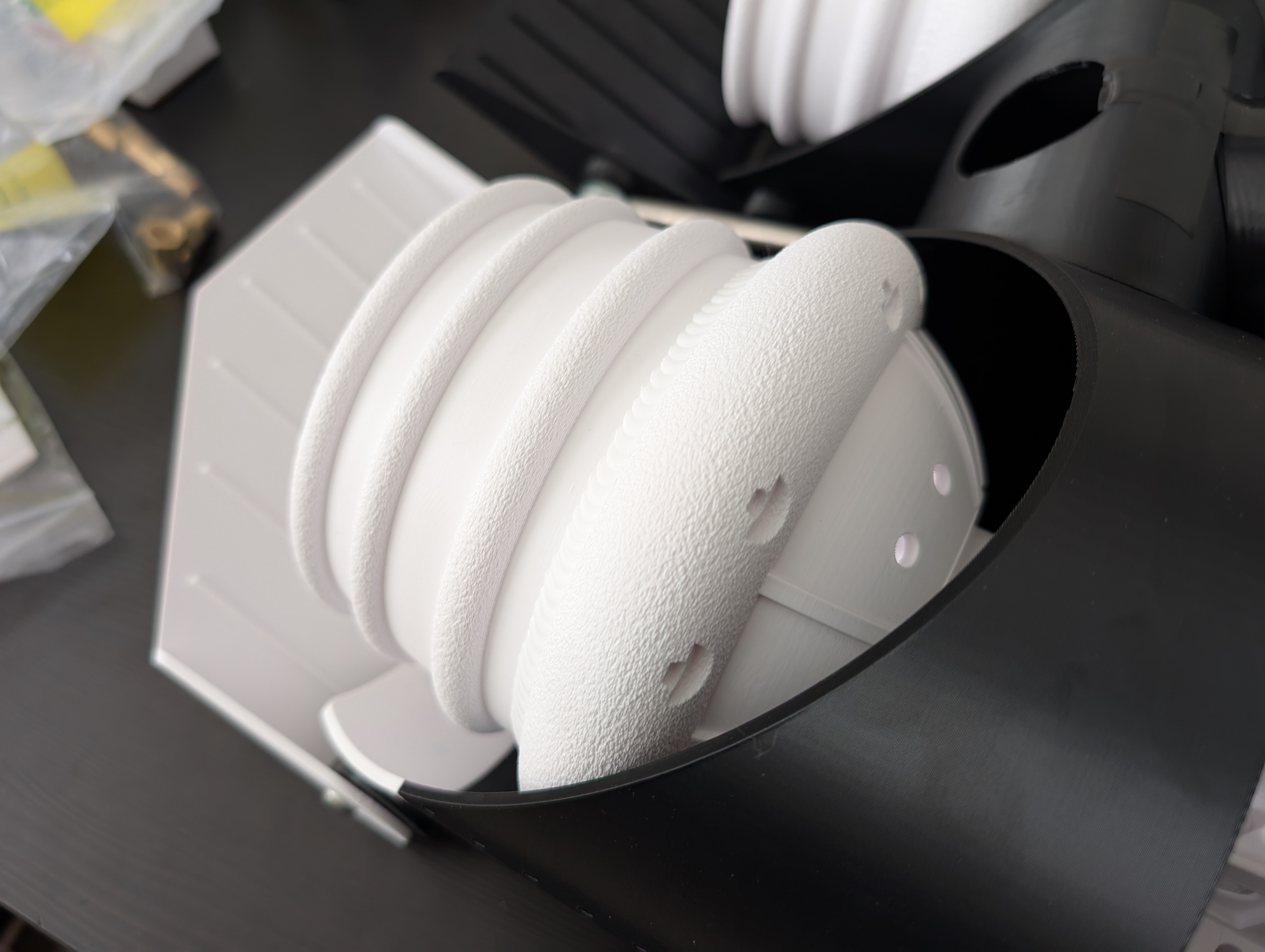

Cast look on bell housing​
I noticed after looking at some reference photos of the real rocket pack that the taurus shapes on the booster bell housing look cast, while the cylindrical parts in between look machined. Almost like a crankshaft in a call. I really liked this look so I wanted to try and replicate it. I saw a bunch of people (Adam savage included) uses a painting technique that gave the booster a cast look. But, I had an idea... I decided to try using a feature built into most 3D printing slicer softwares called "Fuzzy Skin". So, I used modifiers to only apply the fuzzy skin where I wanted it. And after a little tuning of how aggressive I wanted the fuzzy skin to be, I think this turned out really nice!

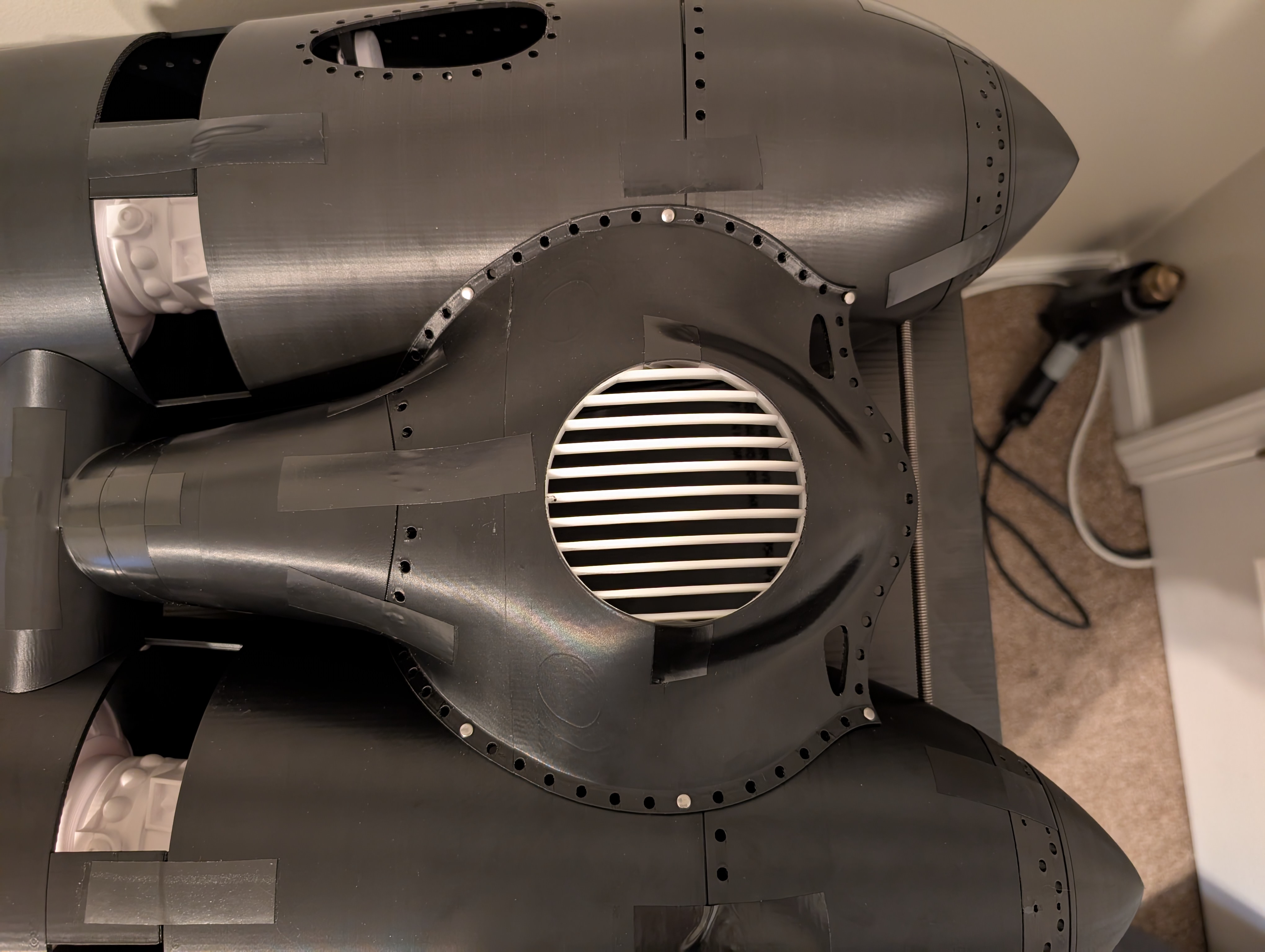

Alignment pins​
I really wanted to not glue in the center hull piece in case I needed to take this pack apart for maintenance or upgrades. But I didn't want it just sitting there loosely either. So I think I've come up with a good idea, but time will tell. What I've decided to do is go with extra long rivets in key locations shown below (6 on top, and 4 on bottom). This way, the extra long rivets can be used as alignment pins when attaching the side tanks. That should be enough that when you squeeze the tanks together with the threaded rod, that nothing moves around.

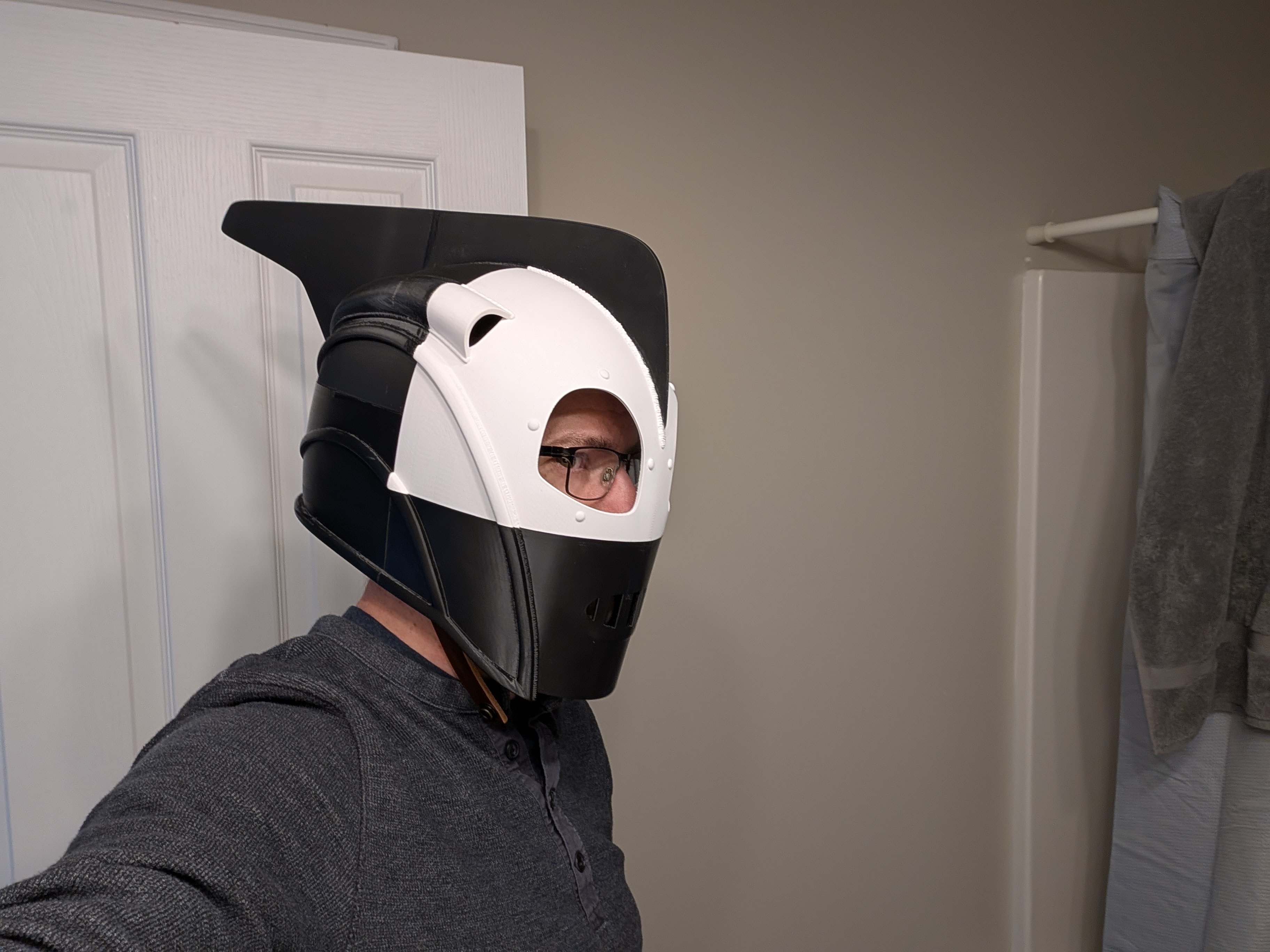

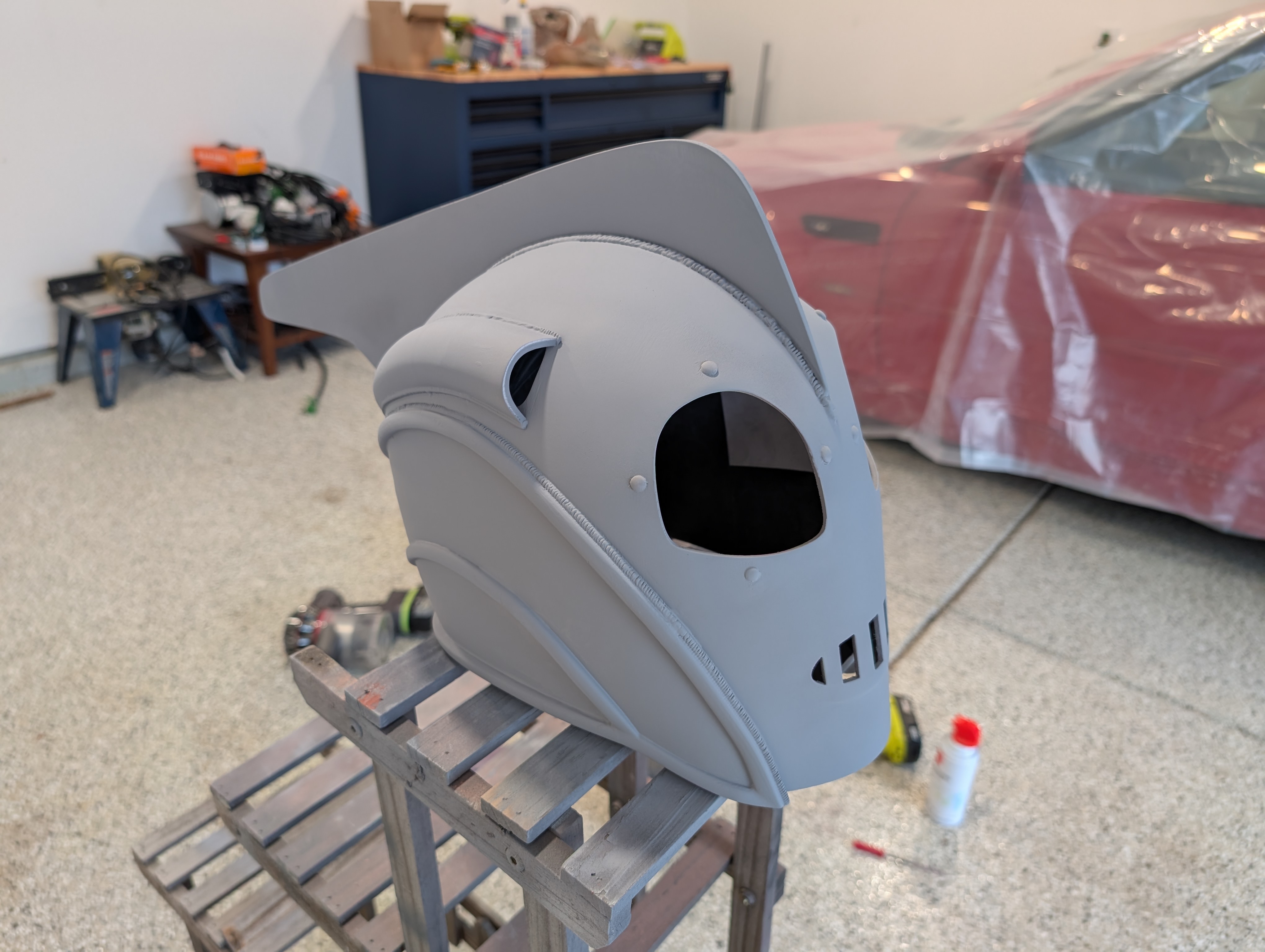

The liner from Valor Replicas arrived! It's fits perfectly inside the helmet. And makes the helmet fit my head easily and comfortably! Thanks so much, Valor!
Test fitting...

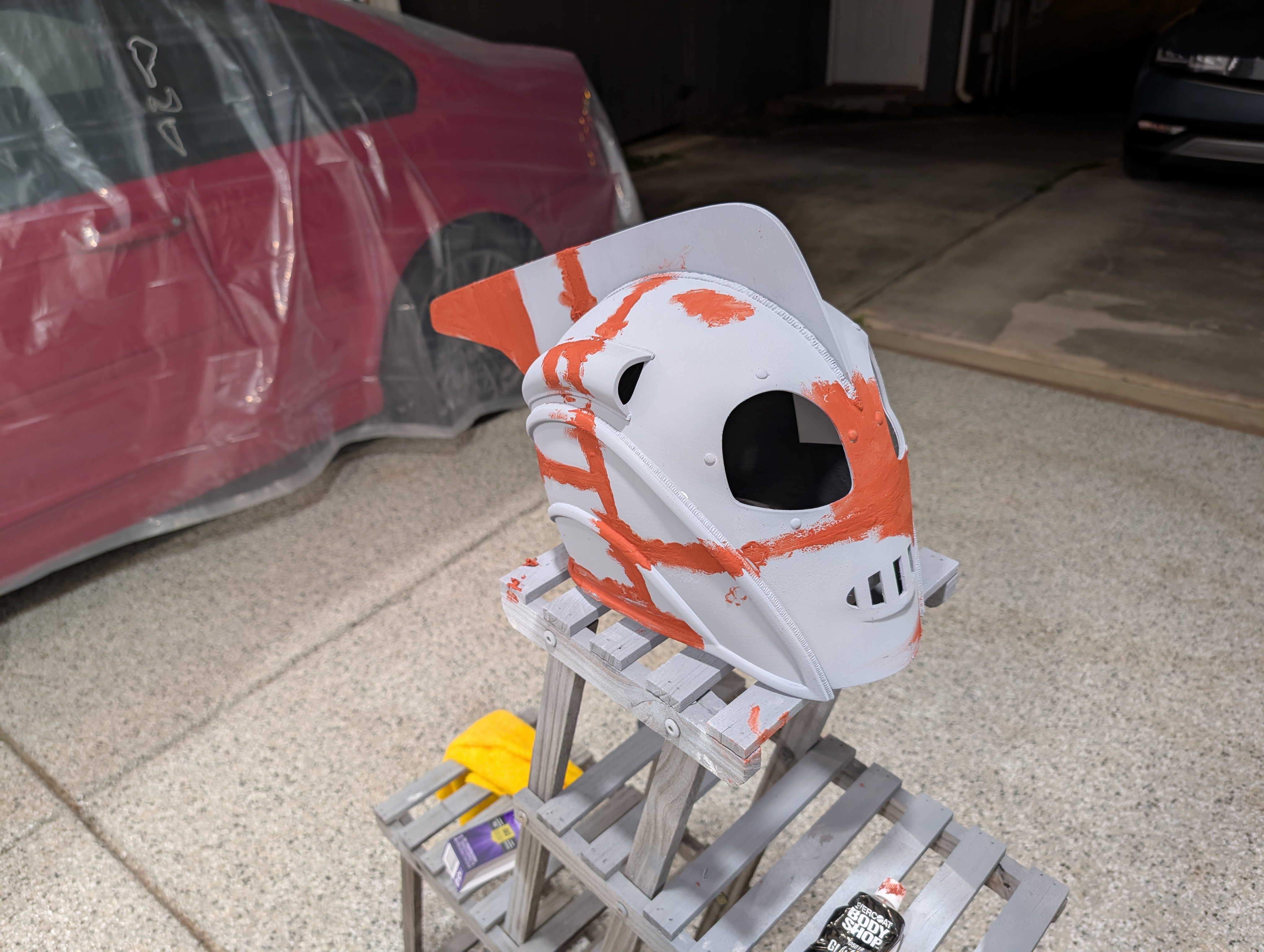

First paint tests. Turned out pretty good! Unfortunately it also revealed a lot of defects in my prints. So I'm going to sand it down and fix them, and repaint.
I followed the same process as others on this site. Really couldn't have done it without the help if the community.
It’s looking great! I’m actually making the same thing right now out of PETG as well, but you’re ahead of me. I’m still on the assembly and sanding, but I’m following your progress with great interest!
I love the idea of the fuzzy texture on the engine bells, so I’ll probably reprint mine.
