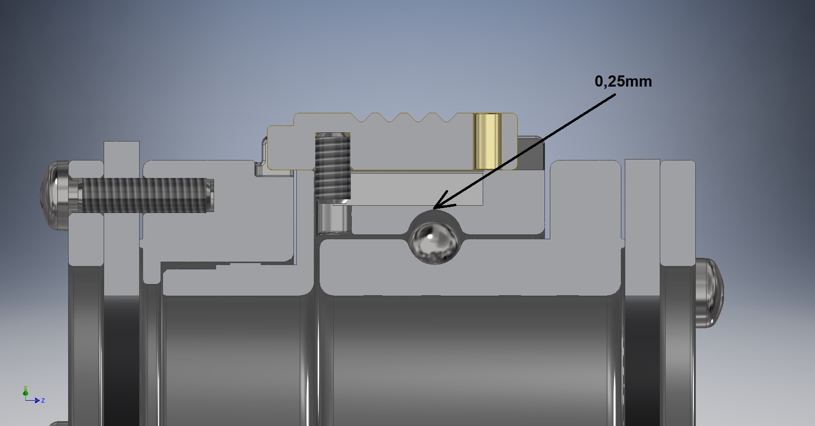

There is still one thing I'm not comfortable with and that is, how close is the bearing groove to the locking spring groove. It's only 0,25mm.
I am going to make some design changes to solve this problem.
Given you have two cylindrical radii perpendicular to one another, it's only .25mm at about .25 mm in surface area. So it probably doesn't need to change.

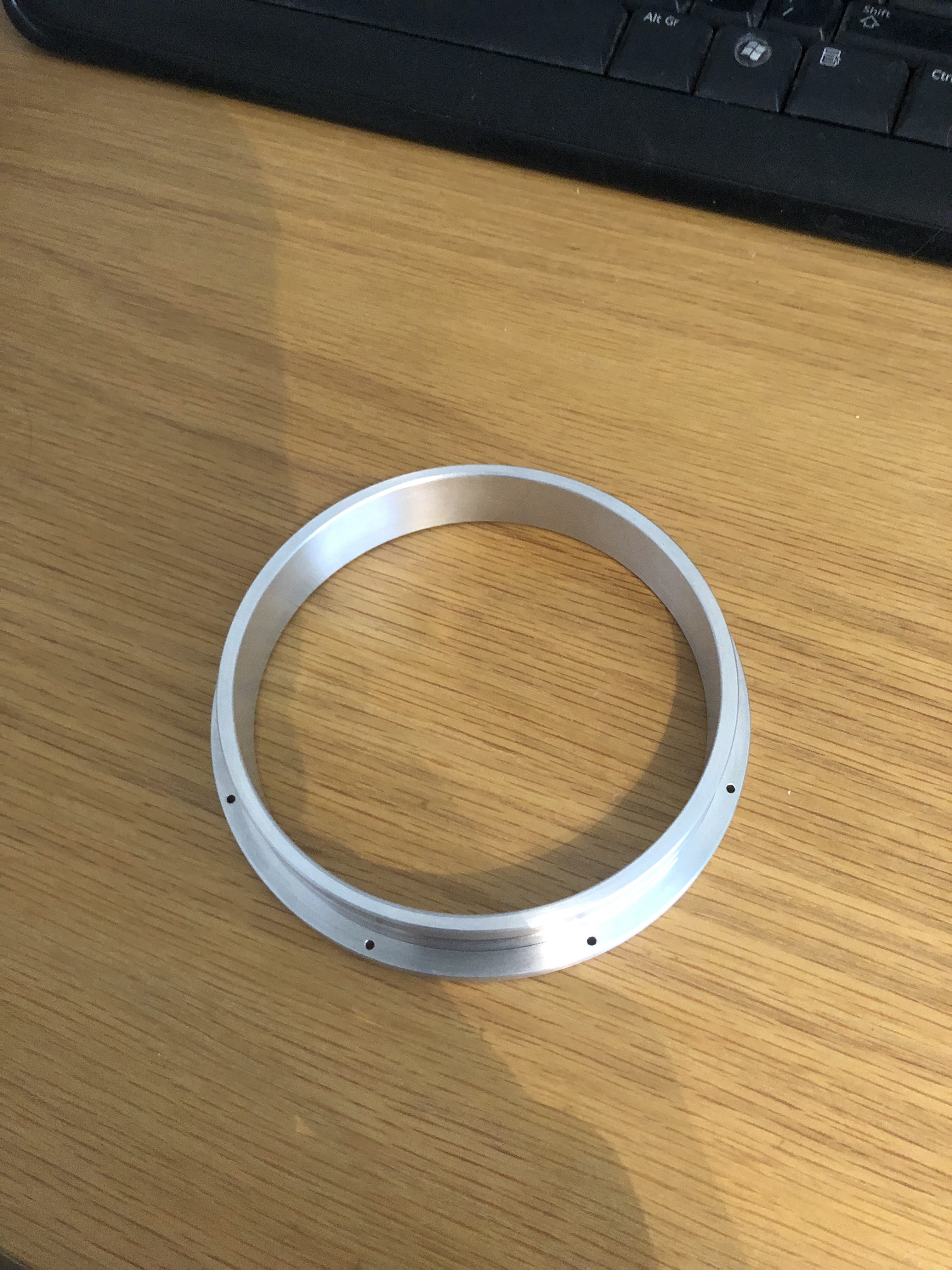

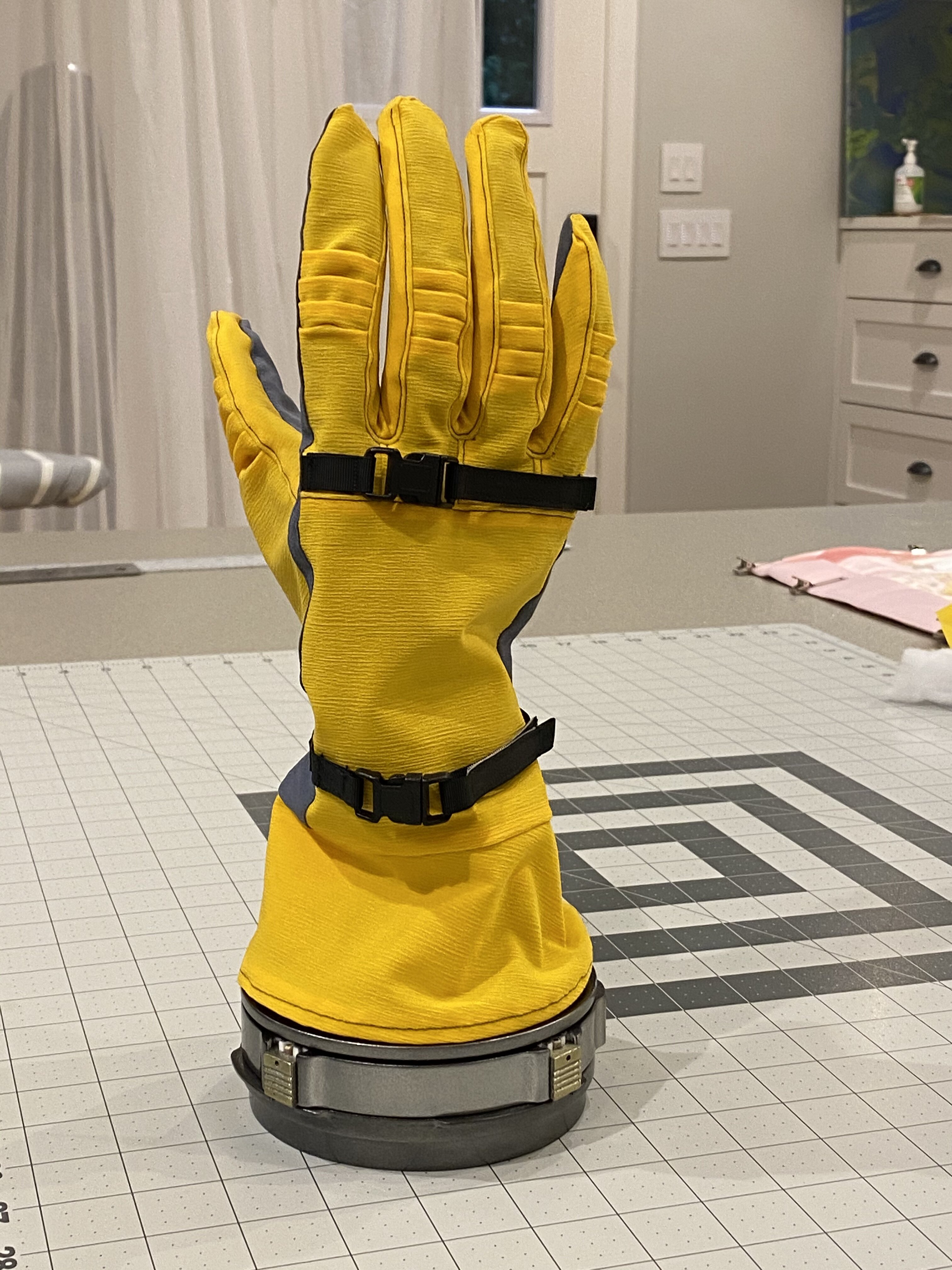

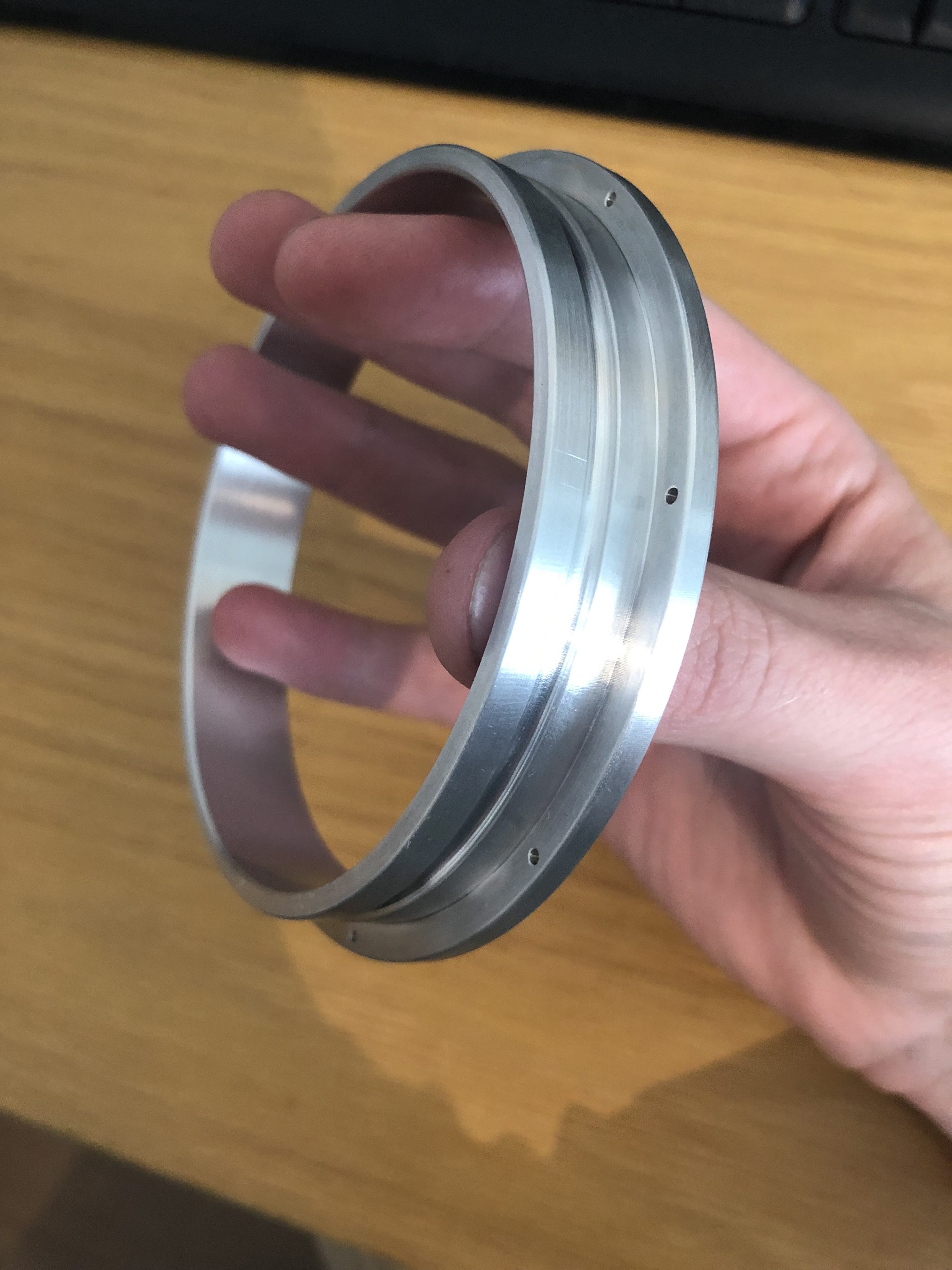

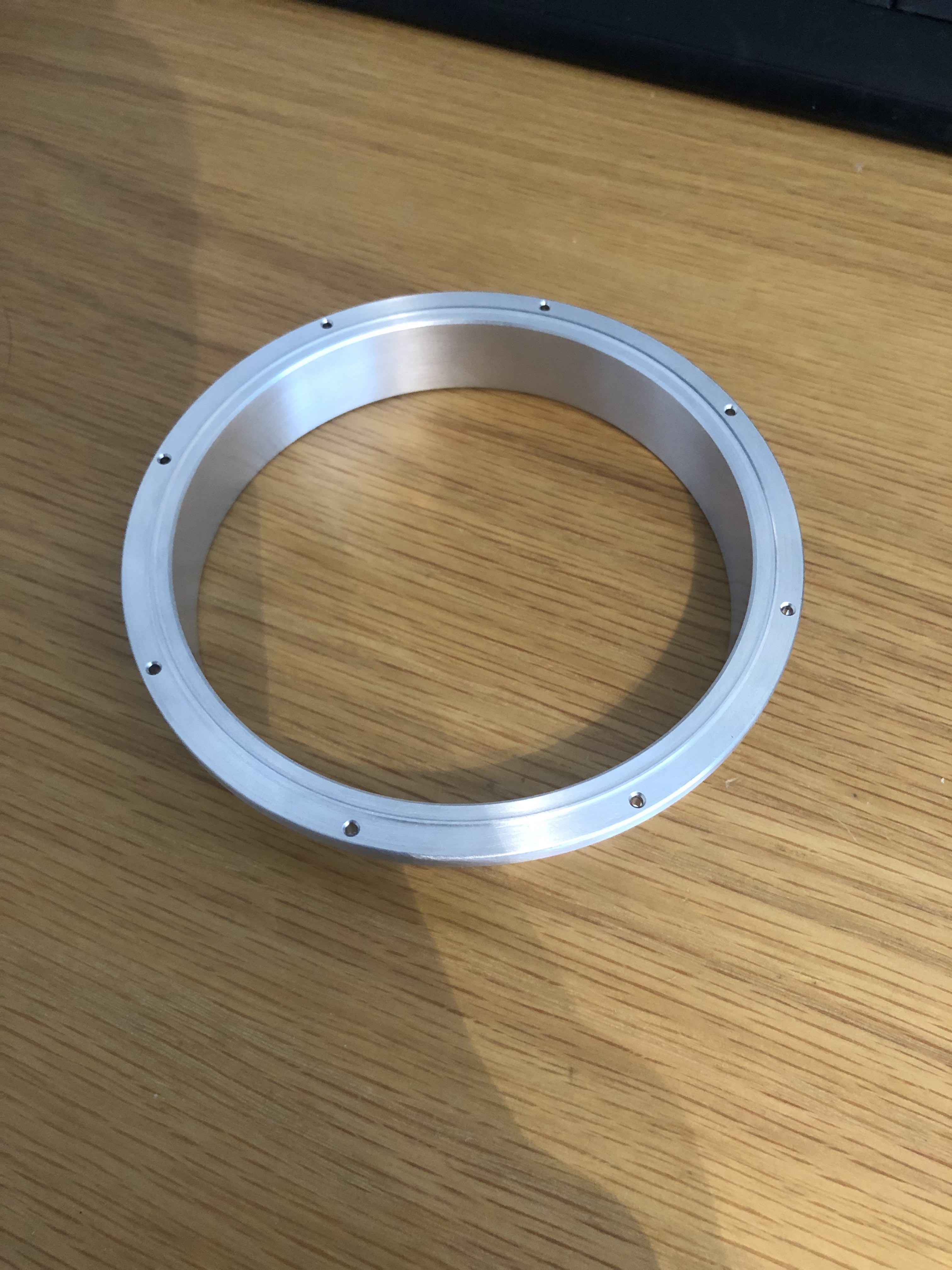

I've been following this thread for a few years now and I'd like to thank everyone that's contributed reference images and mechanical advice. I've finally finished a set after a few months of work on breaks between semesters. There's certainly a few changes I'll be making on my next set and I haven't put the Open/Lock on it yet but I'm happy with them. These will be going on my S1034 U2 suit and hopefully on an ACES when I get around to sewing one those.
Great work on the disconnects
