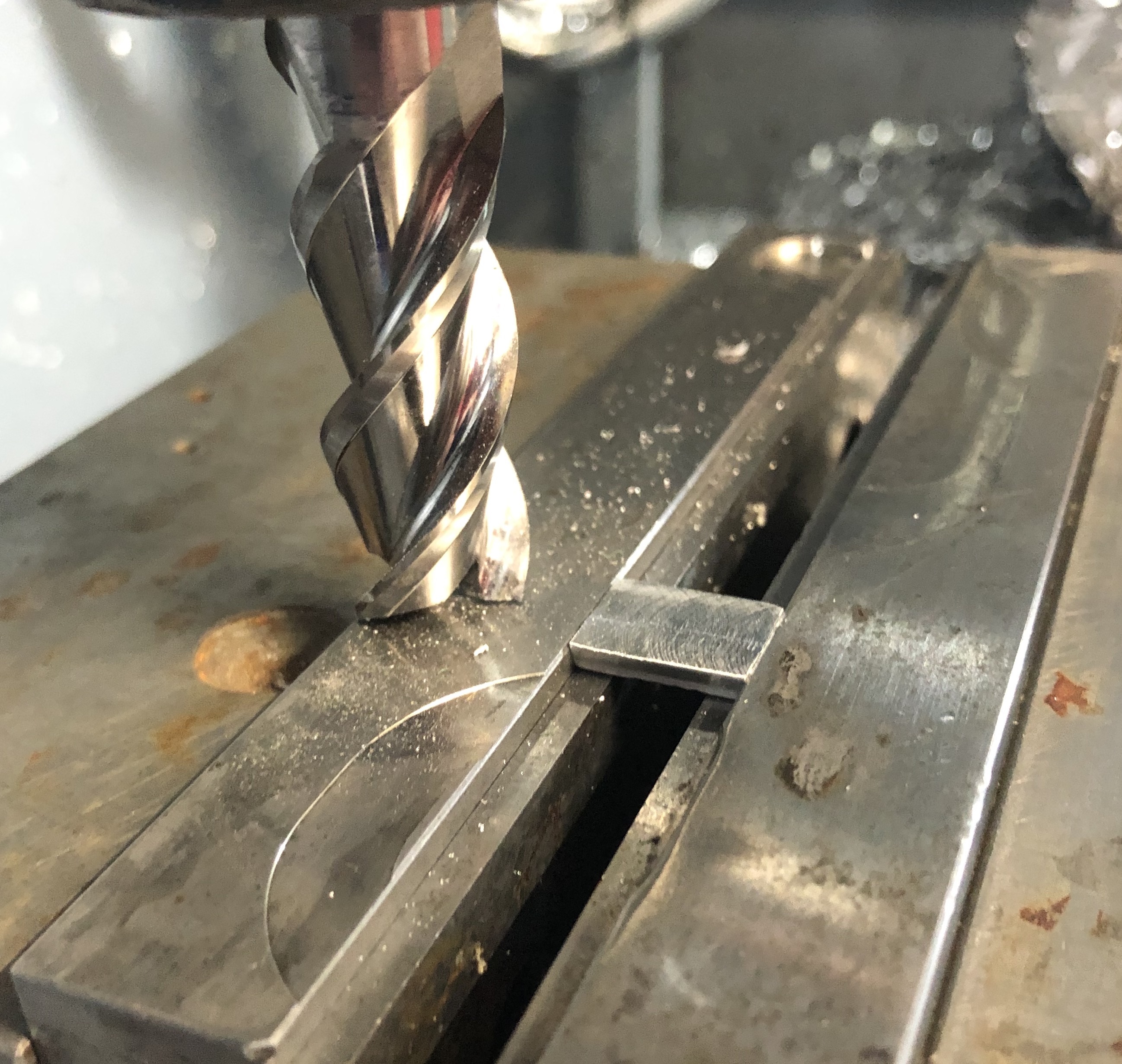

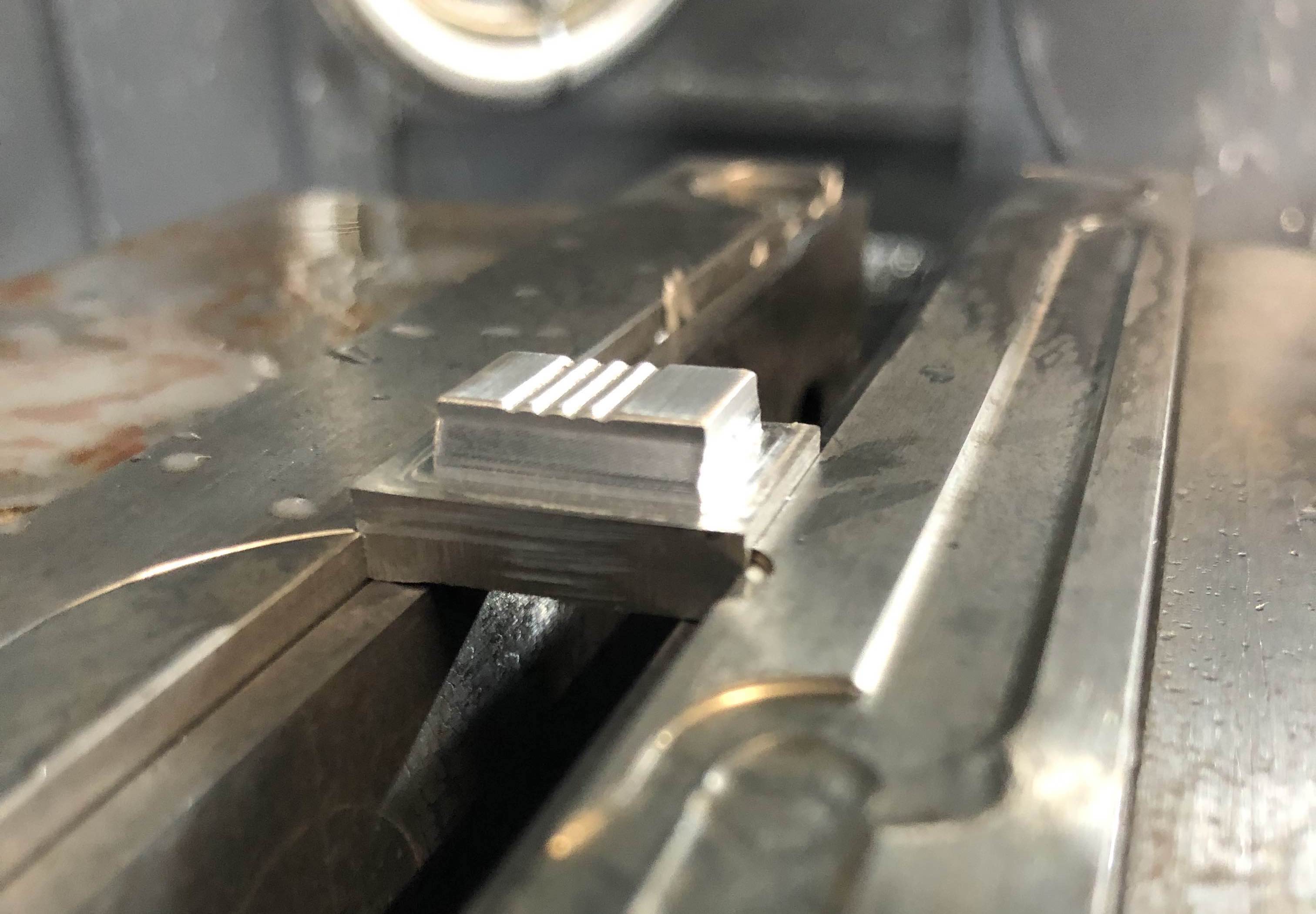

Started on the locking tabs, not finished yet just the first machining operation for now, tab at the top and holes next. To ensure that it fits in the dovetail on the locking ring. Getting the tolerances correct was a little tricky.
The machining itself isn't too difficult, but holding the part securely require a bit of work.

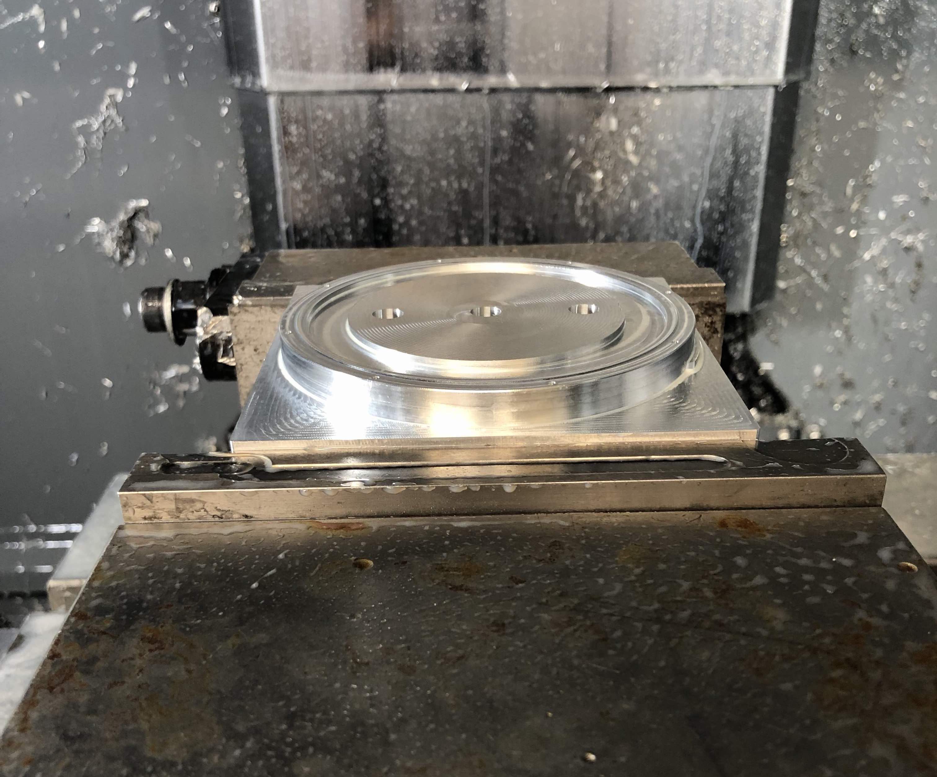

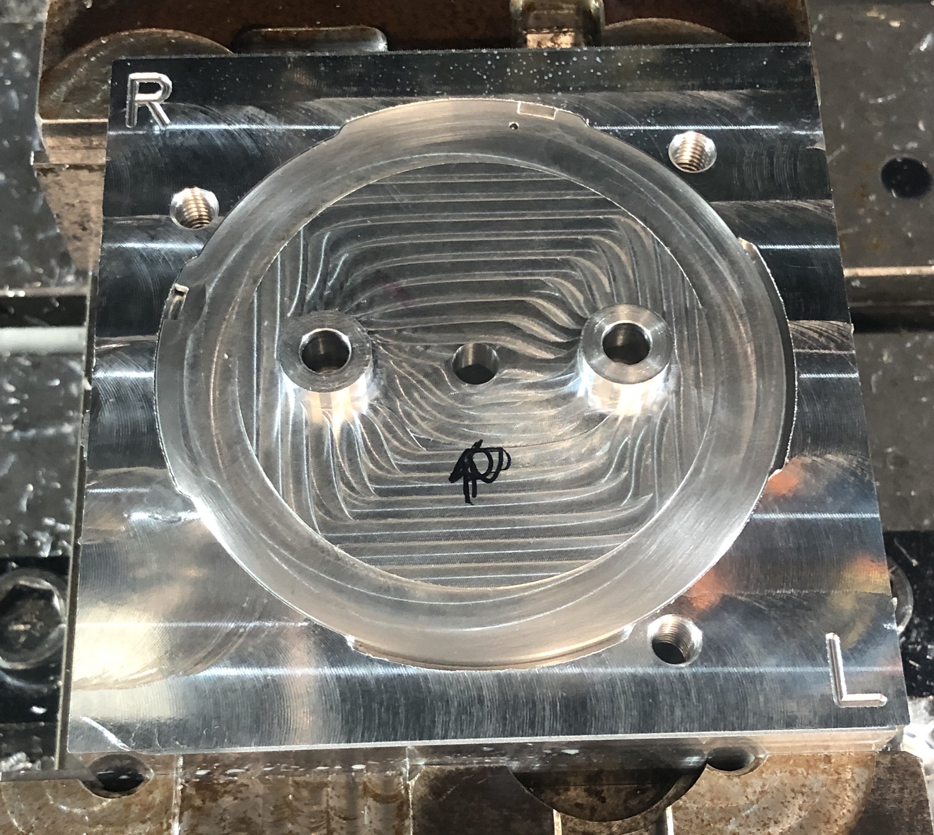

Started on the cuff rings the last major component, first 2 ops completed, 2 to go. Including the most complicated one with all the internal slots. Next these parts go back on the fixture, this time on a rotary axis to complete the radial feature - the 2 cutouts for the tabs and the yellow markings. I have made both left and righthand version, didn't take picture of both its exactly the same process just mirrored.
After OP10
After OP20
And the part off the fixture.

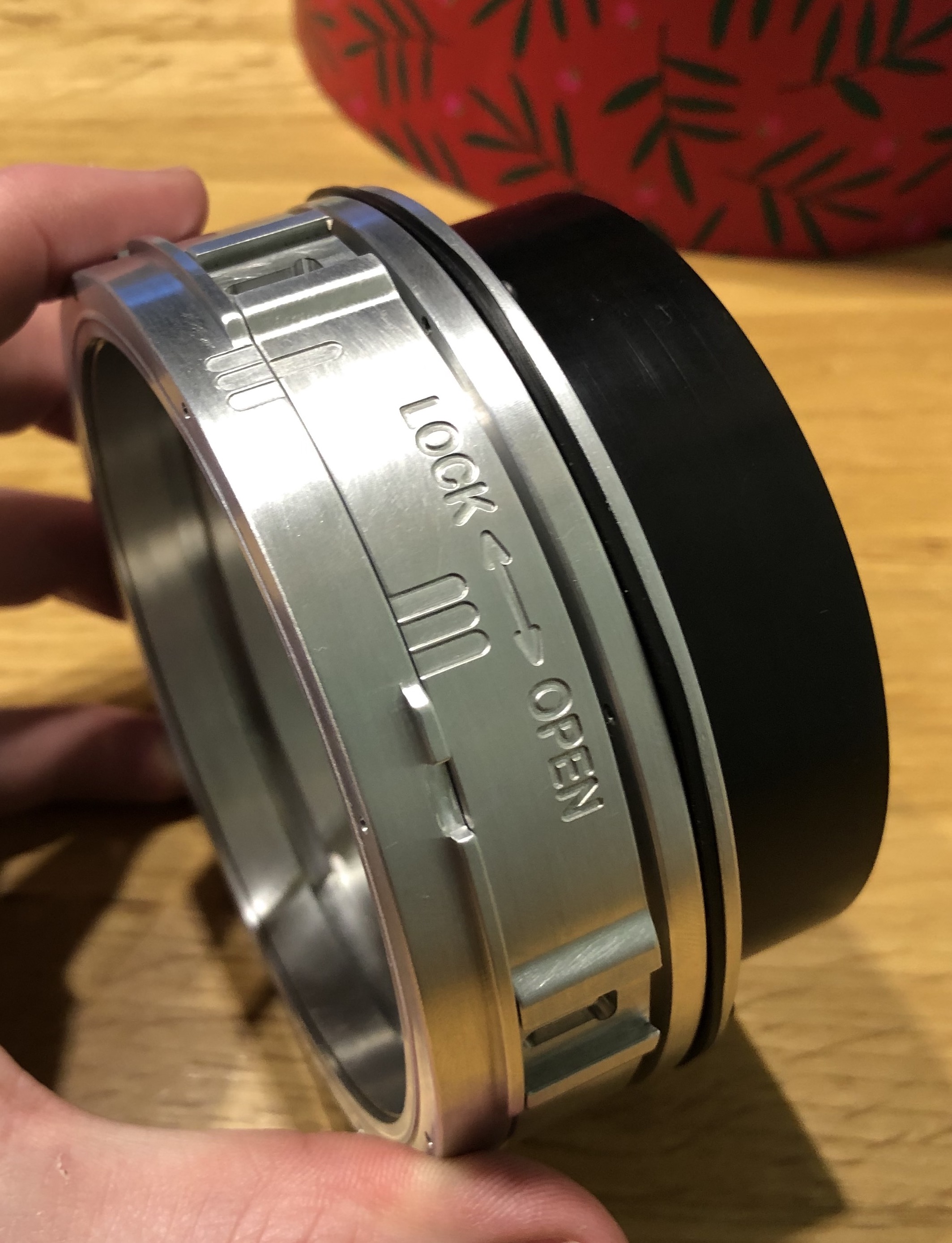

I have now finished machine the right hand cuff ring, the internal feature are now machined. the locking mechanism, minus the tabs now works. Getting pretty close to completing the first set. I was concerned that it would be really tricky to get the system to work correctly. I programmed the machine to CAD data, assuming I would have to make some offsets and adjustments, this is very normal. Somewhat to my surprise it worked first time without any adjusts being required. All credit for must go to antarusfree for his great work on the CAD data.
Here it is the in unlocked position, followed by the locked position. I try and get a video to show it working, it's nice and smooth and a snug fit when locked. I don't think the O ring will be required, however I plan to keep it as an option in case I just got lucky with this part a others may not fit as well.
