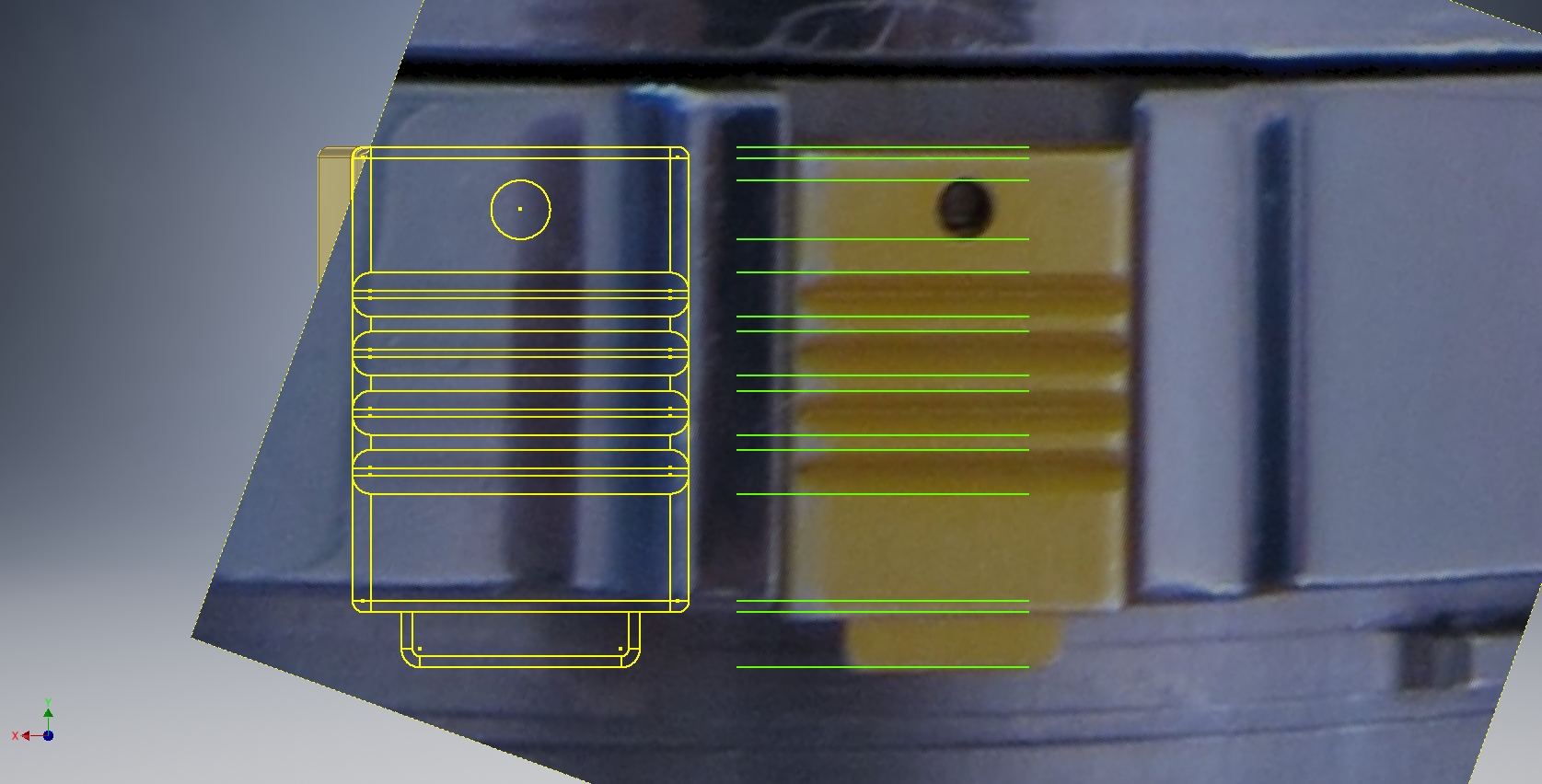

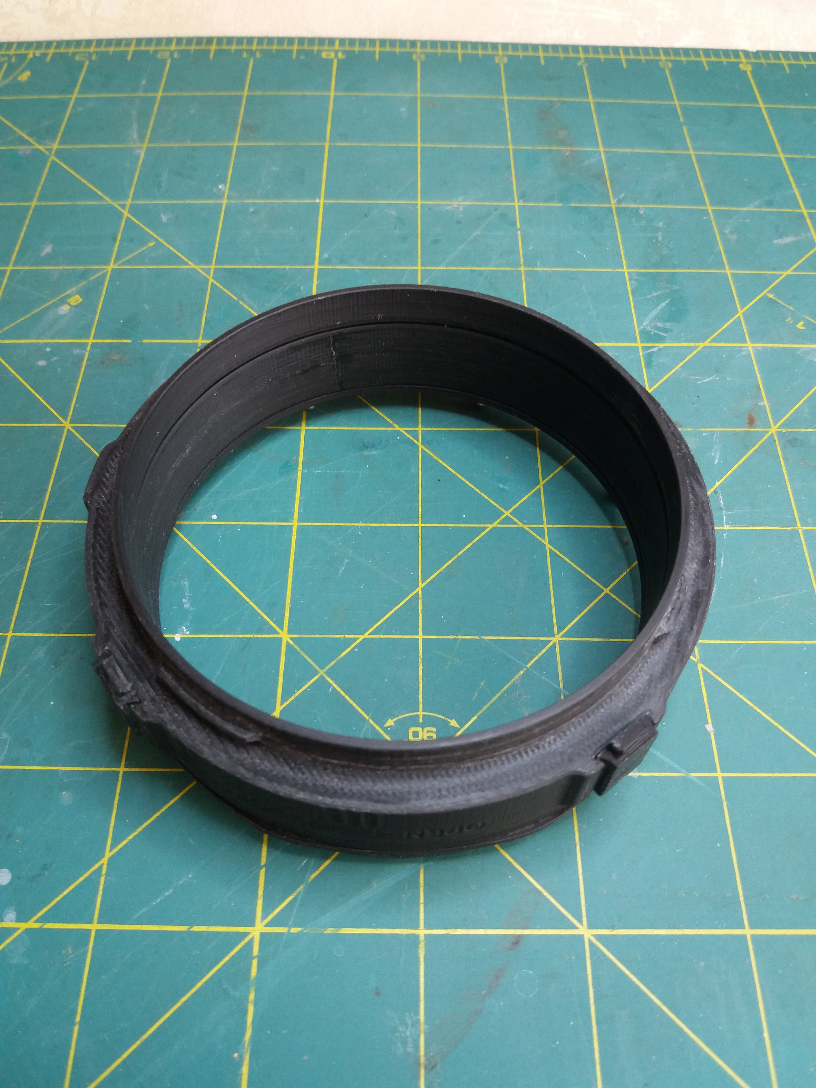

I think your side by side is a bit off. The area indicated as the top of the tab is actually the top of the radius, the tab ends higher.
I keep recommending larger radii, because I have handled real pieces and have made the same mistake, of making edges to sharp. I also have a original blueprint which indicates the required radius on the ring edges, and that is 1/32". The lock tabs are clearly more rounded than the rings.

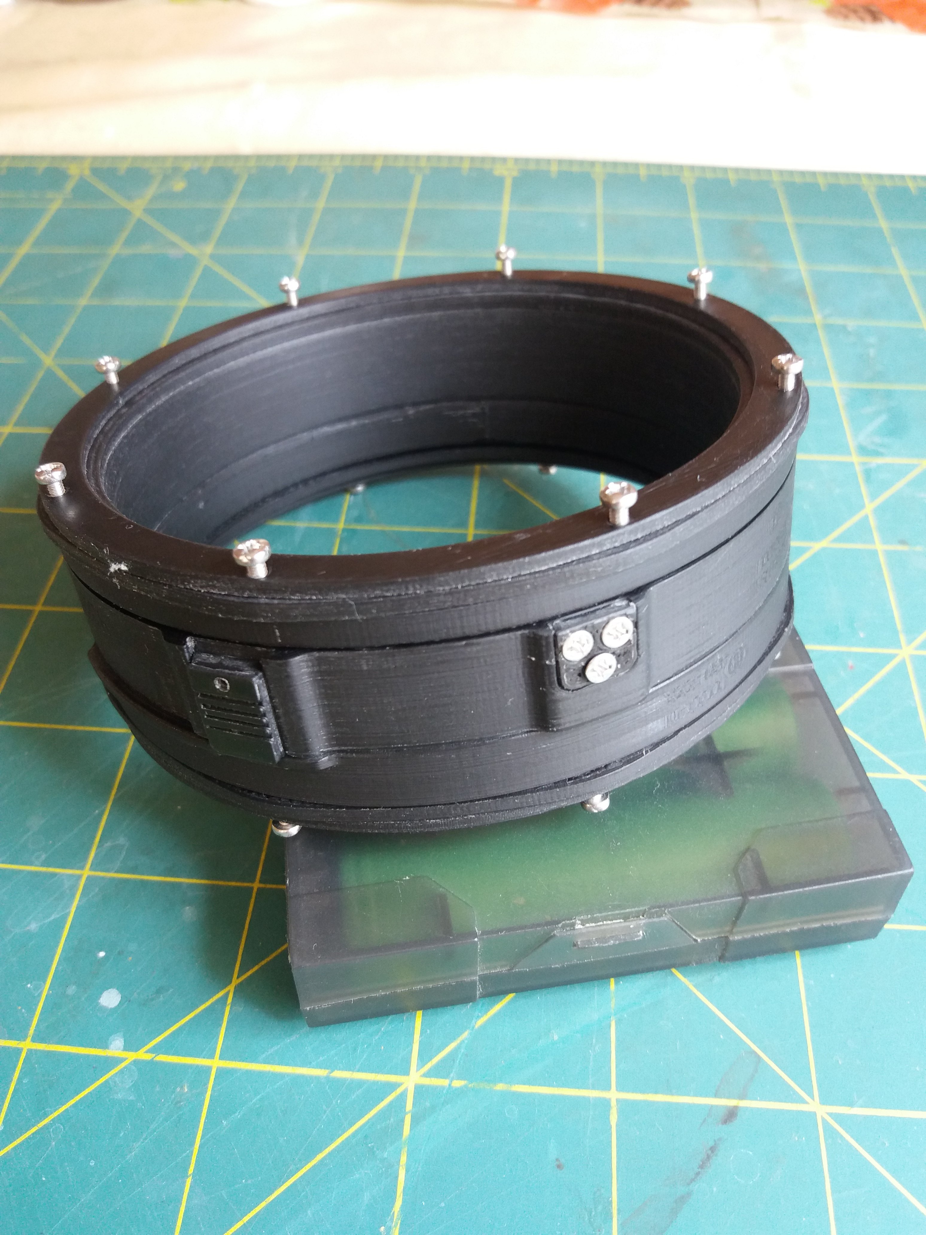

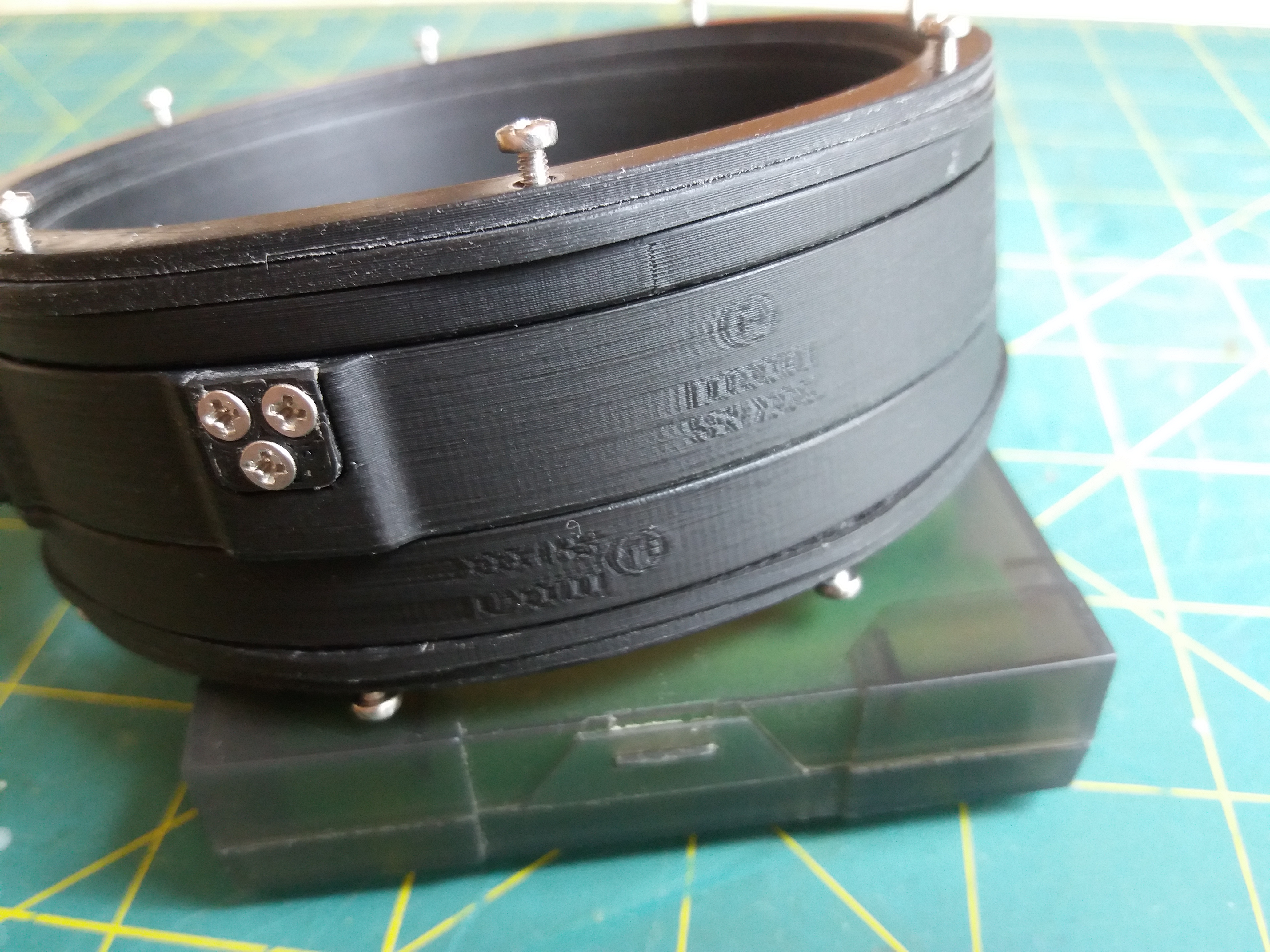

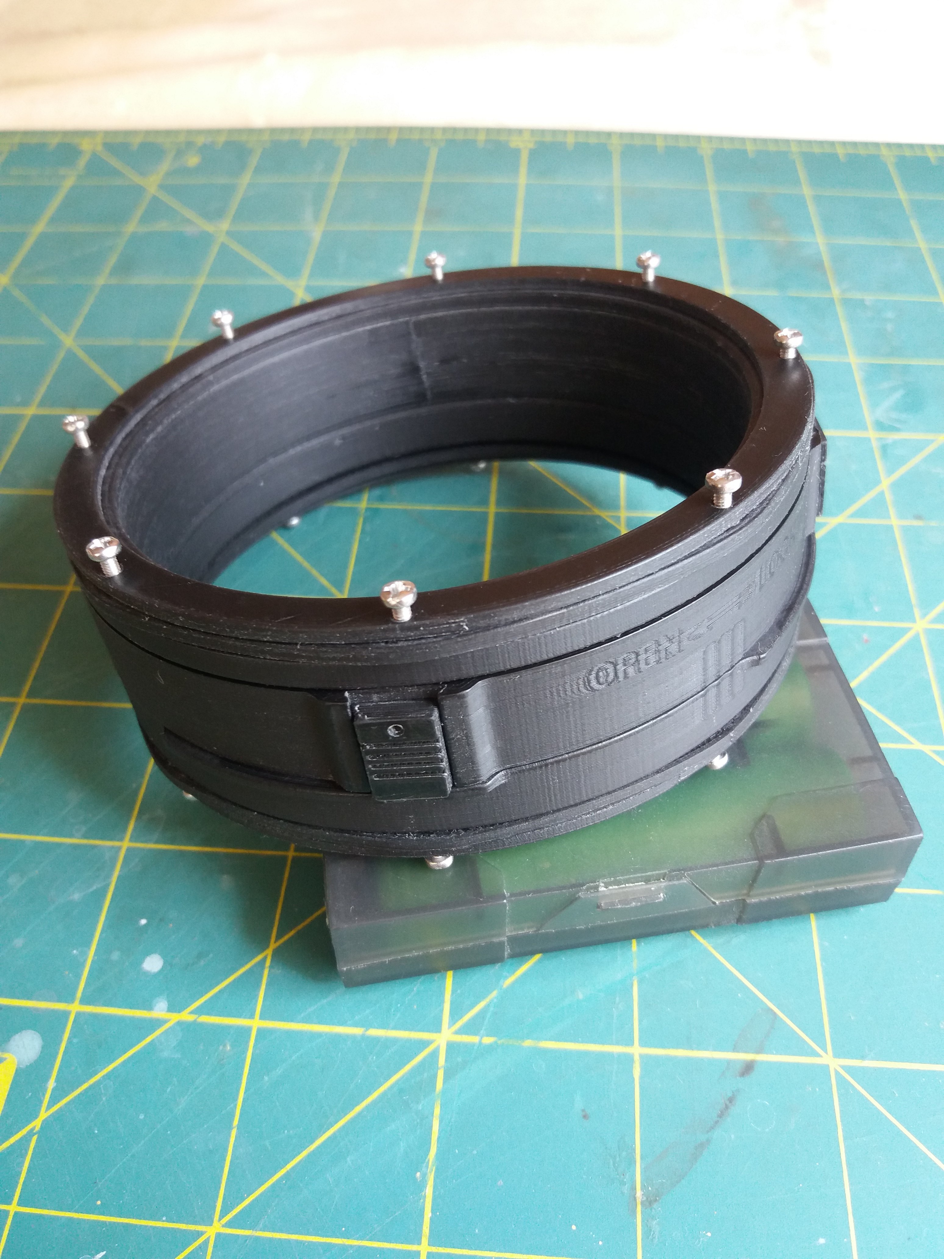

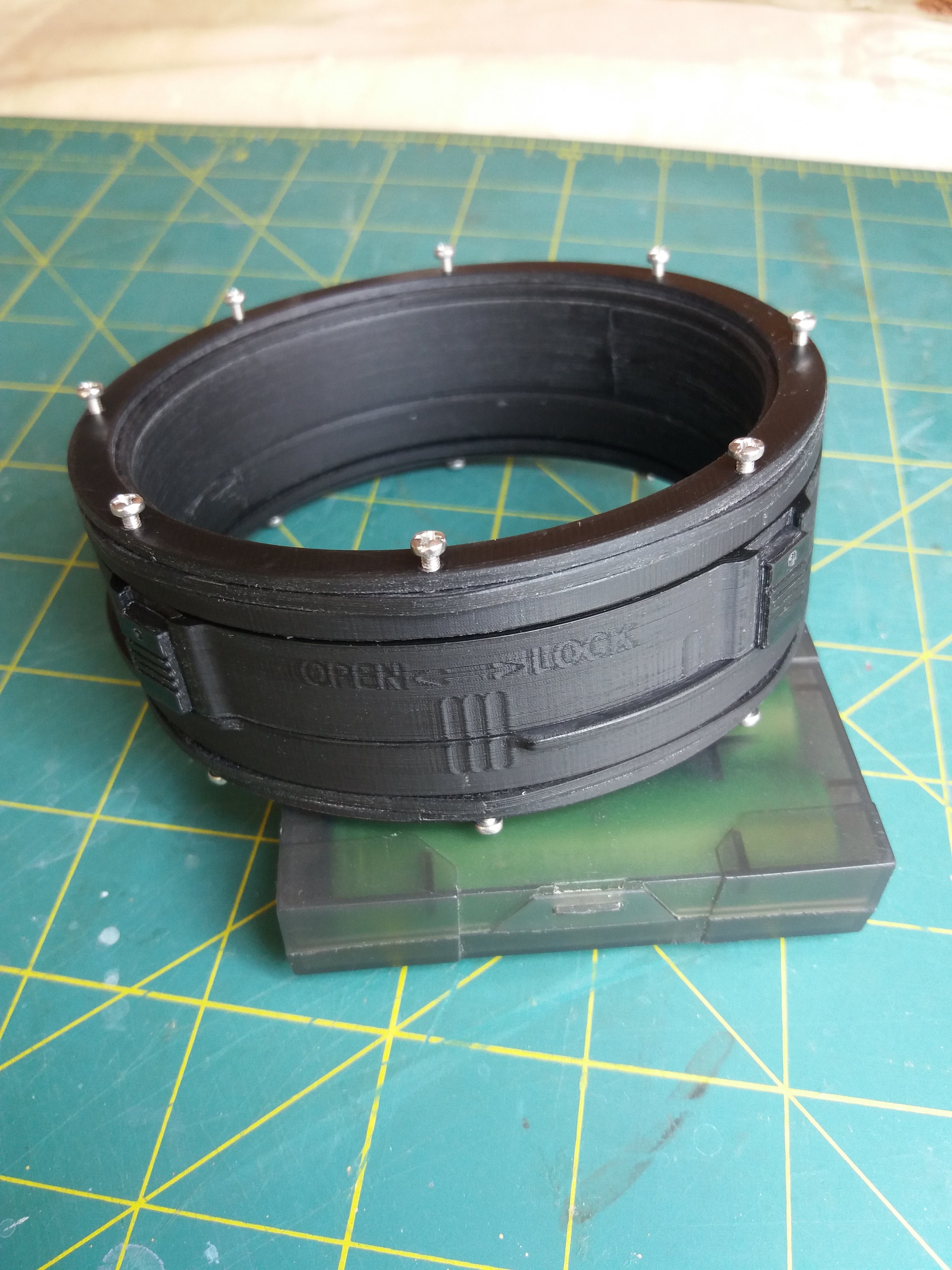

Video isn't working for me but the initial prints are promising! Would be cool to see it printed on an SLA printer. Great work so far!

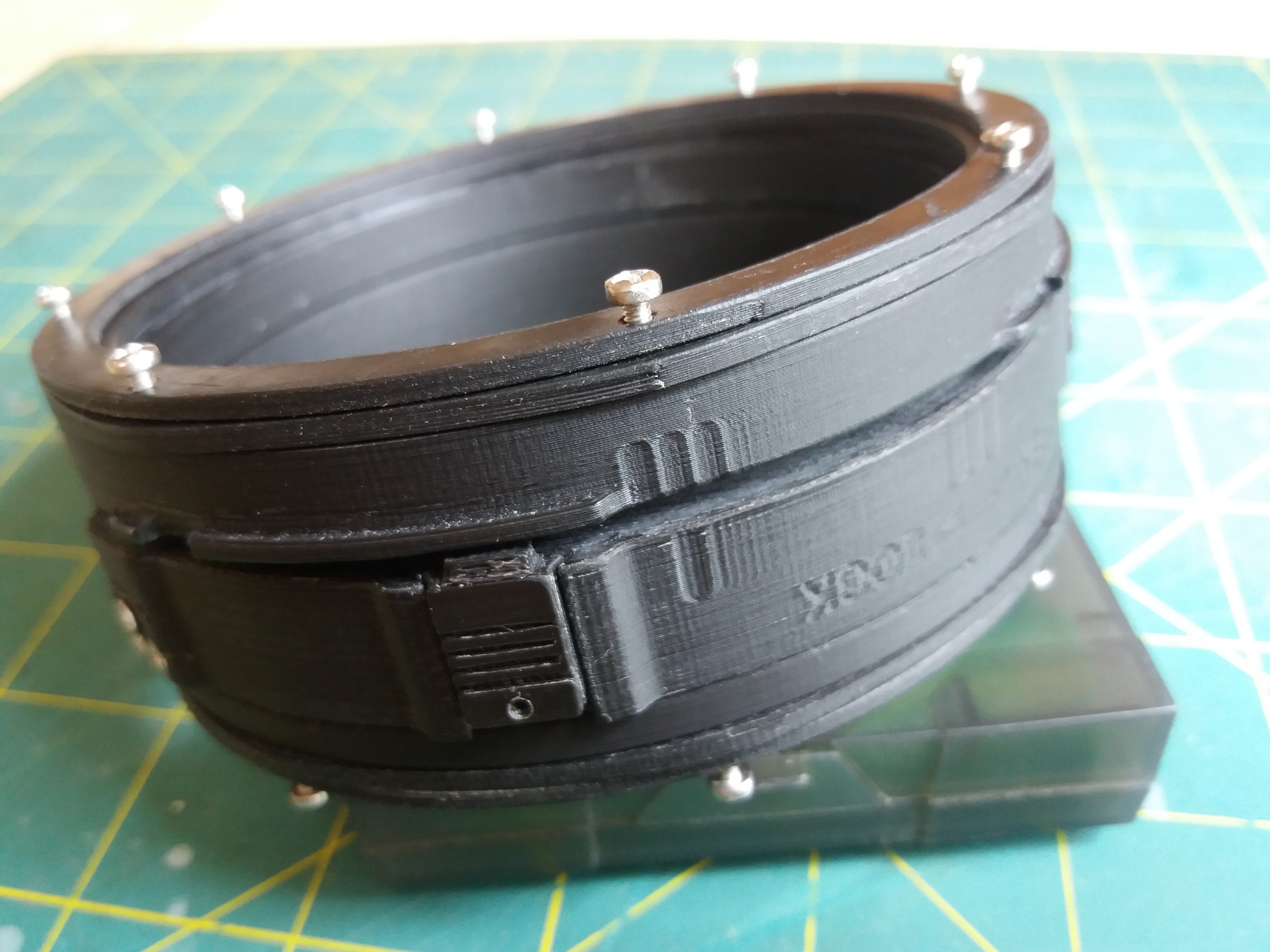

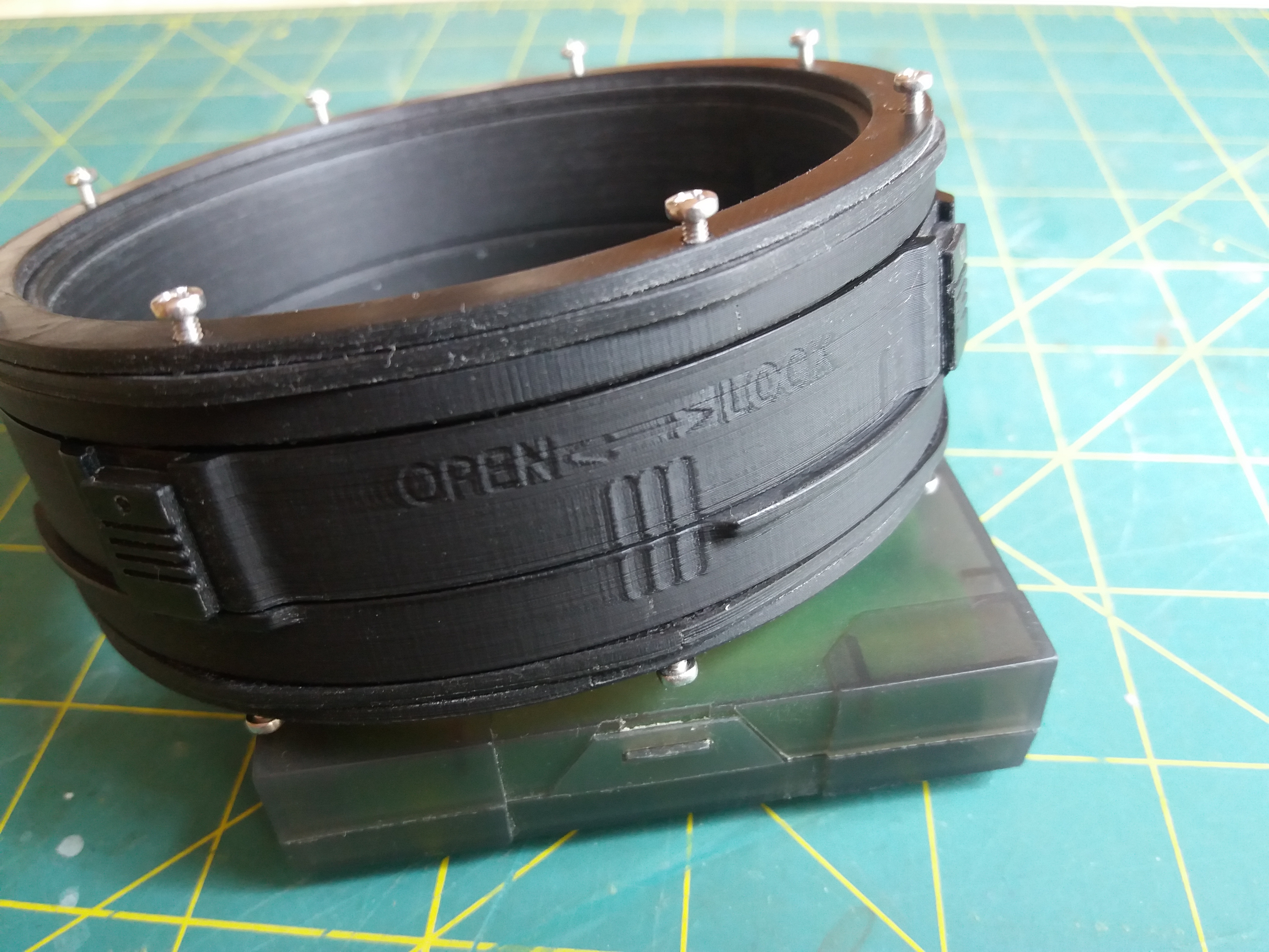

I have to say, the sound made when the rings lock is VERY satisfactory
. That is the coolest thing I have seen on the RPF in a long time...FANTASTIC!!!!!!!Short video showing functional glove disconnect
