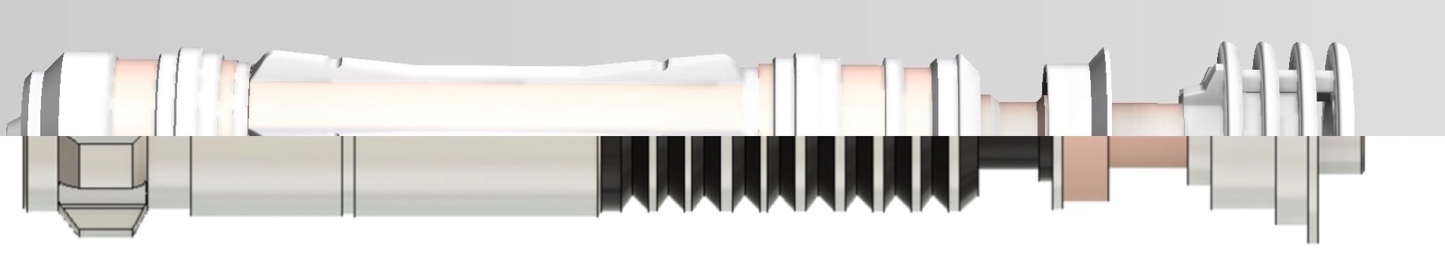

myself (and Valor) and a few others have determined a core "anchor" measurement being the pommel cap is the diameter of a Graflex body. So my entire set of dimensions has been based on this anchor and also photogrammetry, overlays and image mirroring.
now that I have what I feel is awful close on the primary body sizes. I wanted to try some stuff out... here is what brother and sister look like mm for mm matched:
right away you can see the length marker matches up to the emitter plate of the RotJ Hero.
buuuuut the plot thickens... if you SCALE things just a bit (about that of a 2-3rd generation CASTING)... something VERY interesting happens:
whaaaaaaa.....????
What does this all mean.....?o_O:lol:

well so... is Leia's saber thinner and validating the pommel cap as the Graflex 1.5" or are many of us wrong and we've scaled Leia too small?
that is the puzzle
that is the puzzle
I trust your research skills more than my guess, but from a production standpoint, it would make sense that there is some commonality between similar items that they have to make. In the case of lightsabers, I'd say the internal arrangements for electronics are universal, meaning the ID of them would be all the same. They could build up to anything from there, but I feel like that would be their sacrosanct core measurement.
