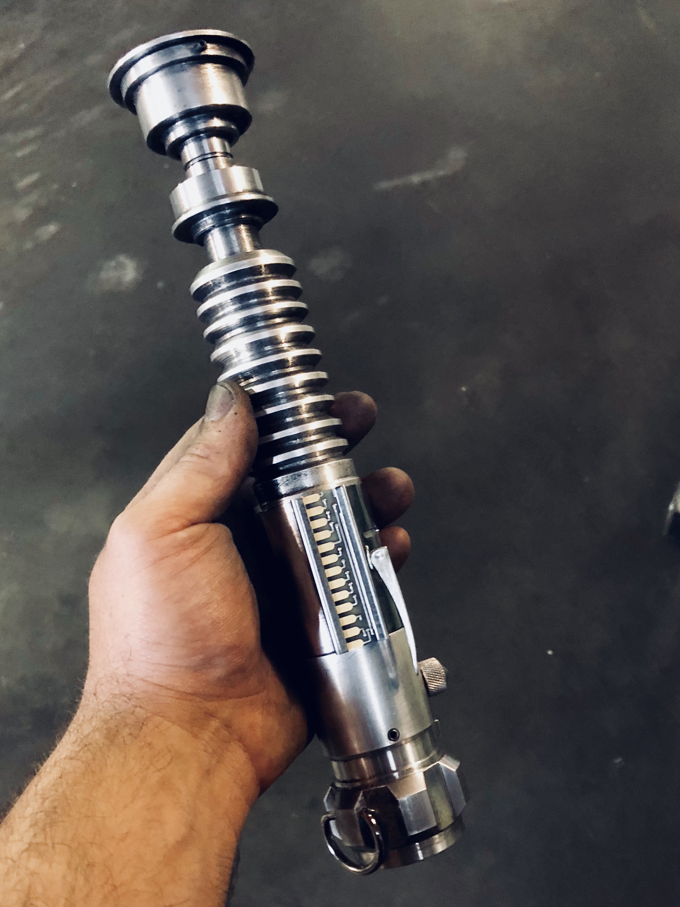

View attachment 812359Base layer commencing:
For one the machine lines are extremely easy to pull out with a fine steel wool or scotch pad if anyone gets theirs and is concerned.
The details put into this gain SO much depth once some darkness is added. The pommel cubes especially: really the primary reason I jumped on this run-look SO good once cleaned up and given some grimey love.
i just use a very basic matte black rattle can misting and quickly buff it off with steel wool in the high zones. If it’s too bright I spray again and use a one-step coarser steel wool (0000 to 000 for instance). Its not meant to be final just a step on the road to Trent’s stencils where I’ll use satin black enamels
Looks awesome! I love this thread!
