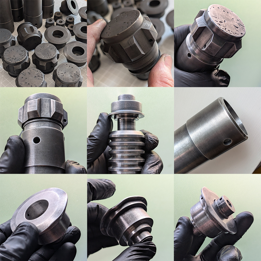

Since getting the clamps sent out I've been mainly concentrating on getting the aluminium parts detailed, ready for chemical darkening. Aside from the addition of a small "ding" to the booster, the majority of this work revolves around the pommel section.

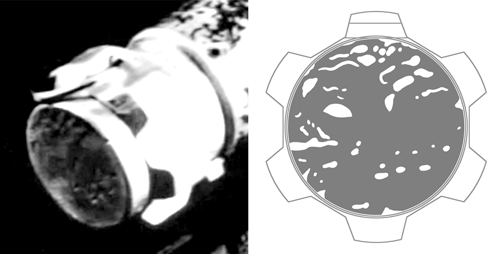

My interpretation of the V2 Pommel damage is based on this reference:

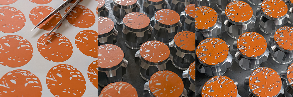

To my eyes it is fairly heavily pitted. In order to replicate the pattern of the damage, I stretched out the oval shape in the reference photo across a circle to remove the perspective and then traced out the details. I then cut this pattern as a vinyl stencil to apply to the bottom of each pommel. This helps to keep them as consistent as possible. I use a rotary tool to engrave the details, before softening everything with emery cloth and then wire wool.

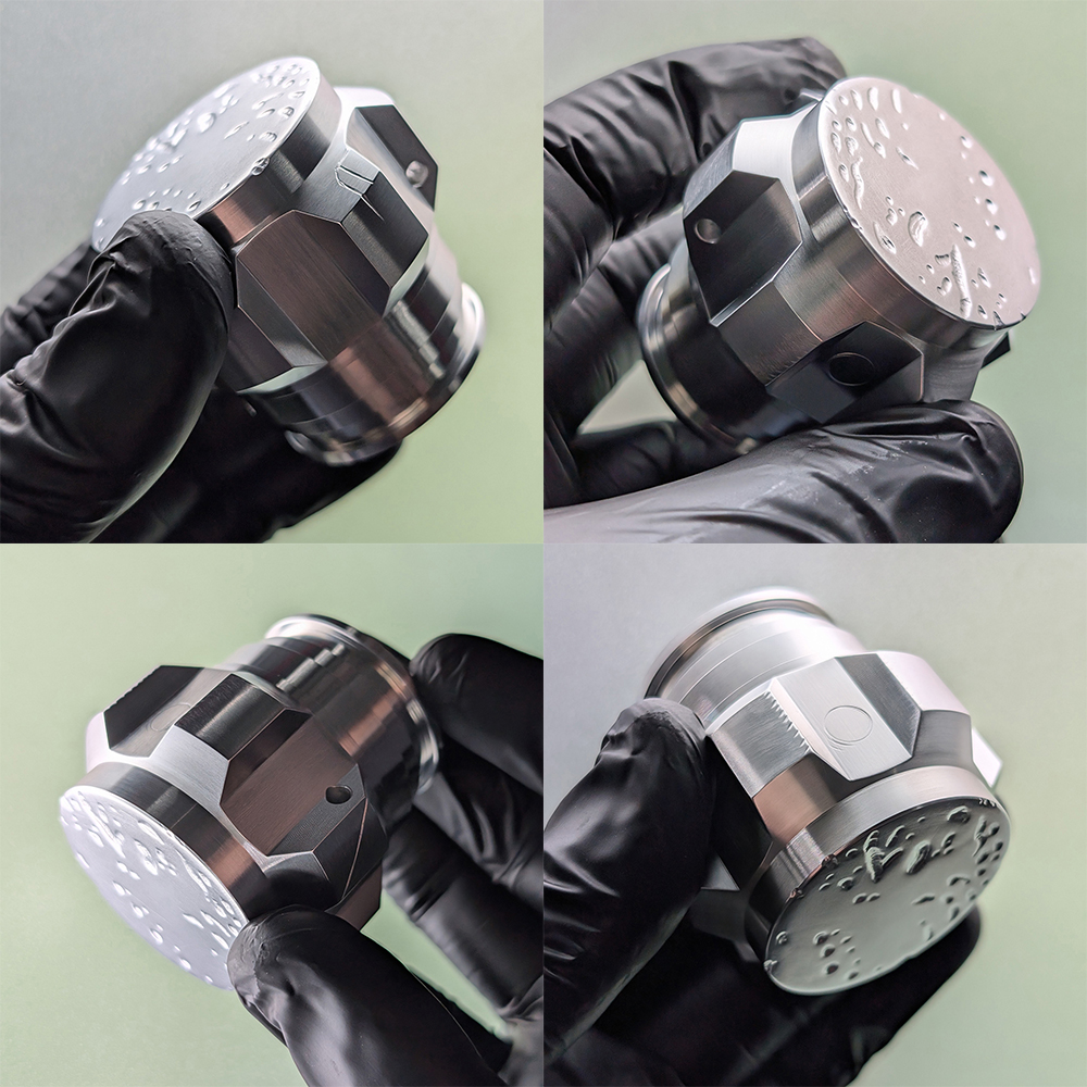

The majority of the work is now complete on these, with all engraving having been done. I am still in the process of softening the edges and adding the smaller details and scratches, including the circular milling marks. Here's a finished one (Before having been darkened):
I expect to have all of these finished tomorrow and hope to apply chemical darkening to the parts that require it on Friday.

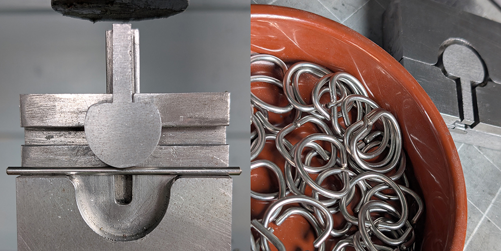

I have made a point of getting several smaller jobs completed this week too. D-Rings are done! Whilst these are one of the last things to be installed, I needed to get some made for the DIY kits. I figured I would just power through and get them all done to save me from having to come back to them later. So, these are all made up and ready to install. (y)
They may be small, but they can be quite time consuming in large numbers. Each one is cut to length by hand, deburred and formed, with multiple operations for each one.

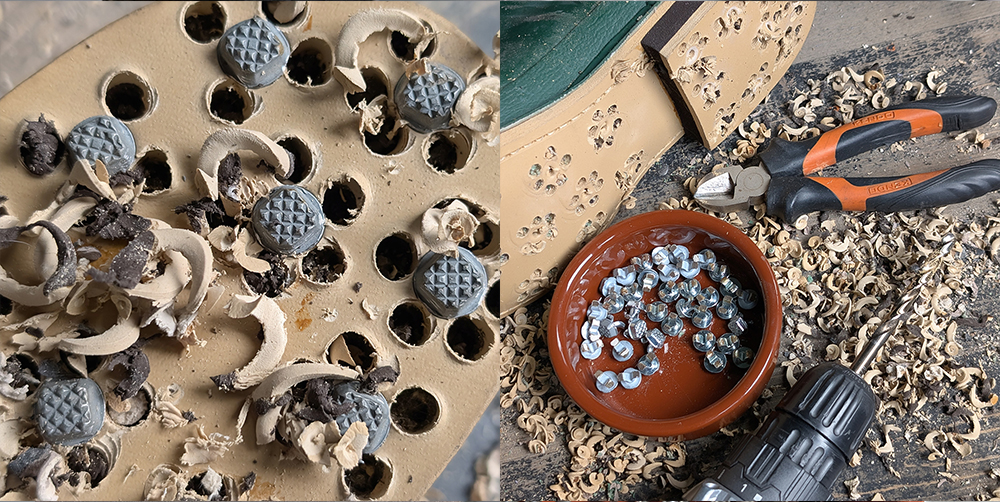

I also took the time to extract the boot studs for the "mystery chunks" too. I've tried various methods to extract these in the past. My new favourite is to drill holes around each stud, before pulling them out with a pair of snips. The soles on these are incredibly tough, so the holes make extracting them much easier!
These are now soaking in white vinegar to remove the zinc plating. Once this is stripped I'll get each one trimmed down ready to be installed.

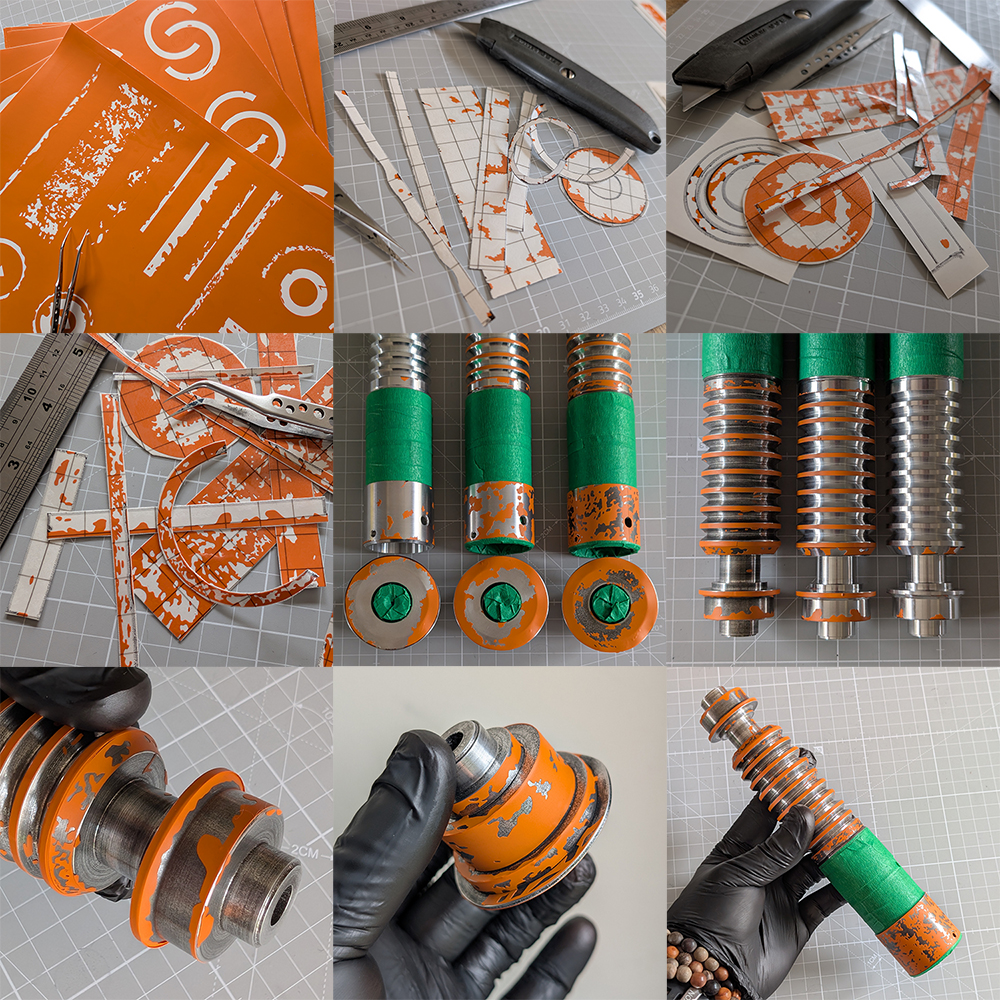

Stencils are all cut and I have been weeding these out in between jobs too. In fact, I'll be returning to these this evening, once I have this update posted.
I am still very much aiming to have this batch finished by the end of next week! There's certainly a lot left to do, but if I can keep to the deadlines I've set for myself between now and then, I believe that it can be done! (y)

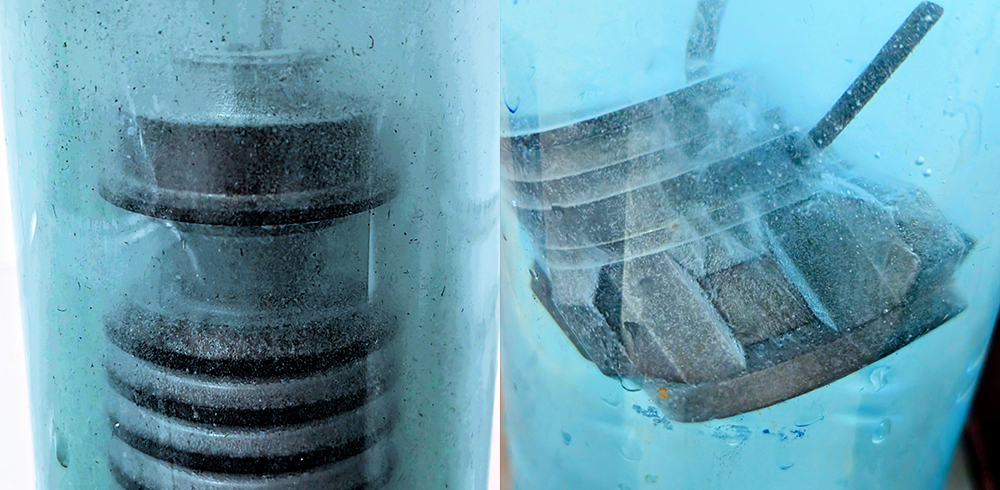

Just a quick update today....
I'll try to keep it brief and concise, so that everyone knows where things are up to.
With regards to the V2s, I DID manage to get Aluminium parts ready for chemical darkening on Friday. The darkening itself did not happen though unfortunately. The time that was left on Friday would not have been enough to get set up, darken everything, and then get cleared away in time.
It's important that I have a child free environment to do this particular job. This will now be going ahead on Monday. I have a full day to commandeer the bathroom, with children out of the house!
This is just a minor re-jigging of the schedule and I still plan on having painting done by the end of this coming week. (y)
I'll be documenting the process and will drop another update towards the end of the week to demonstrate how this has gone and to share the results.
