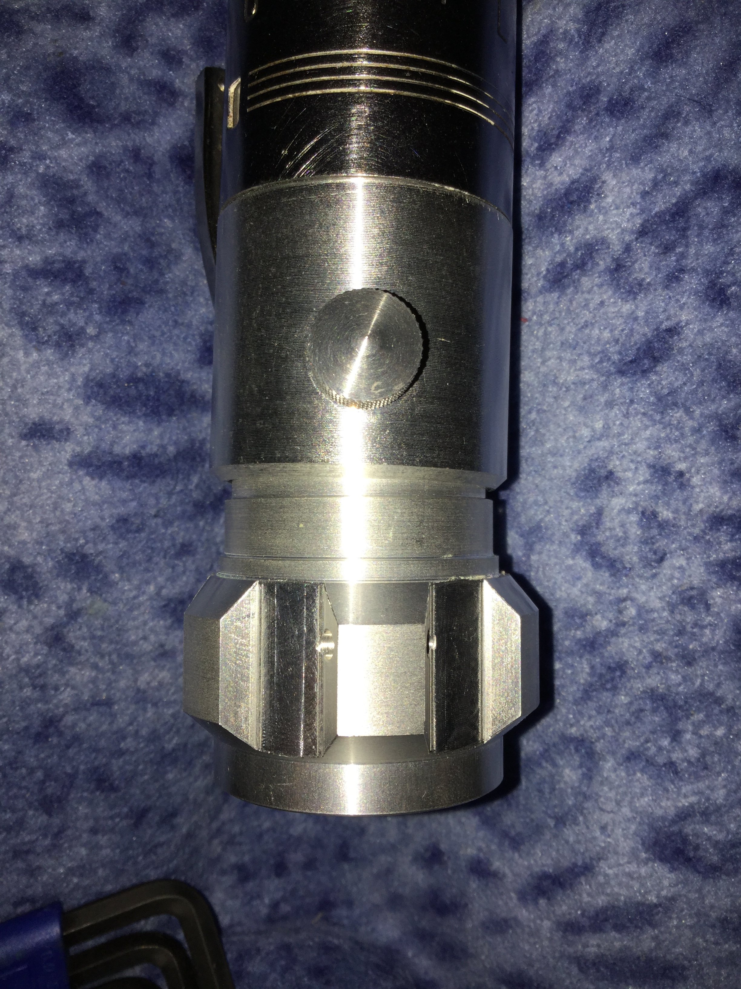

Careful screwing in the pommel guys. It shouldn’t go all the way in. I kept repositioning it because something ddnt feel right. All the way in ...it lines up with the ridge of the flange, not the depression.

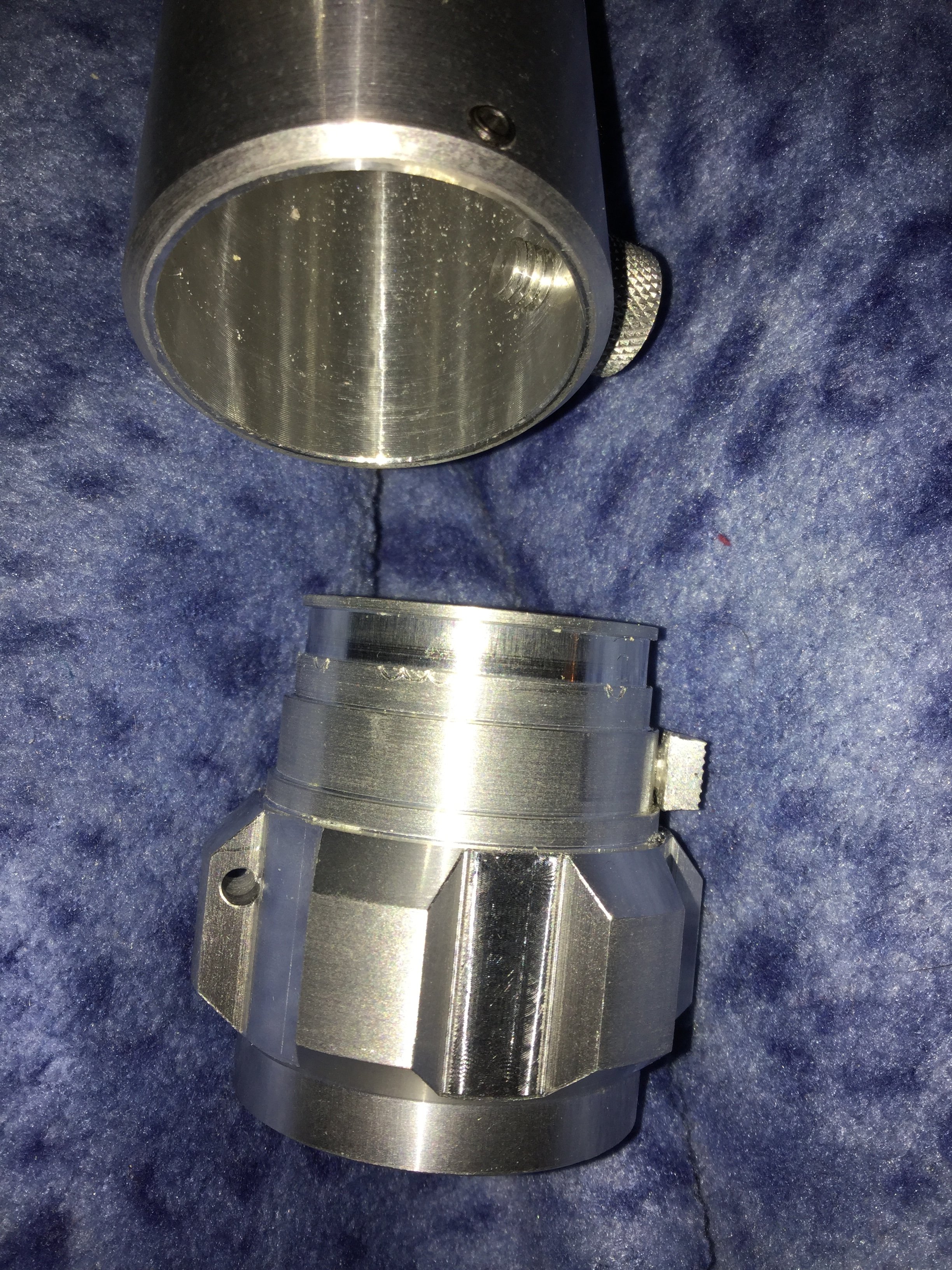

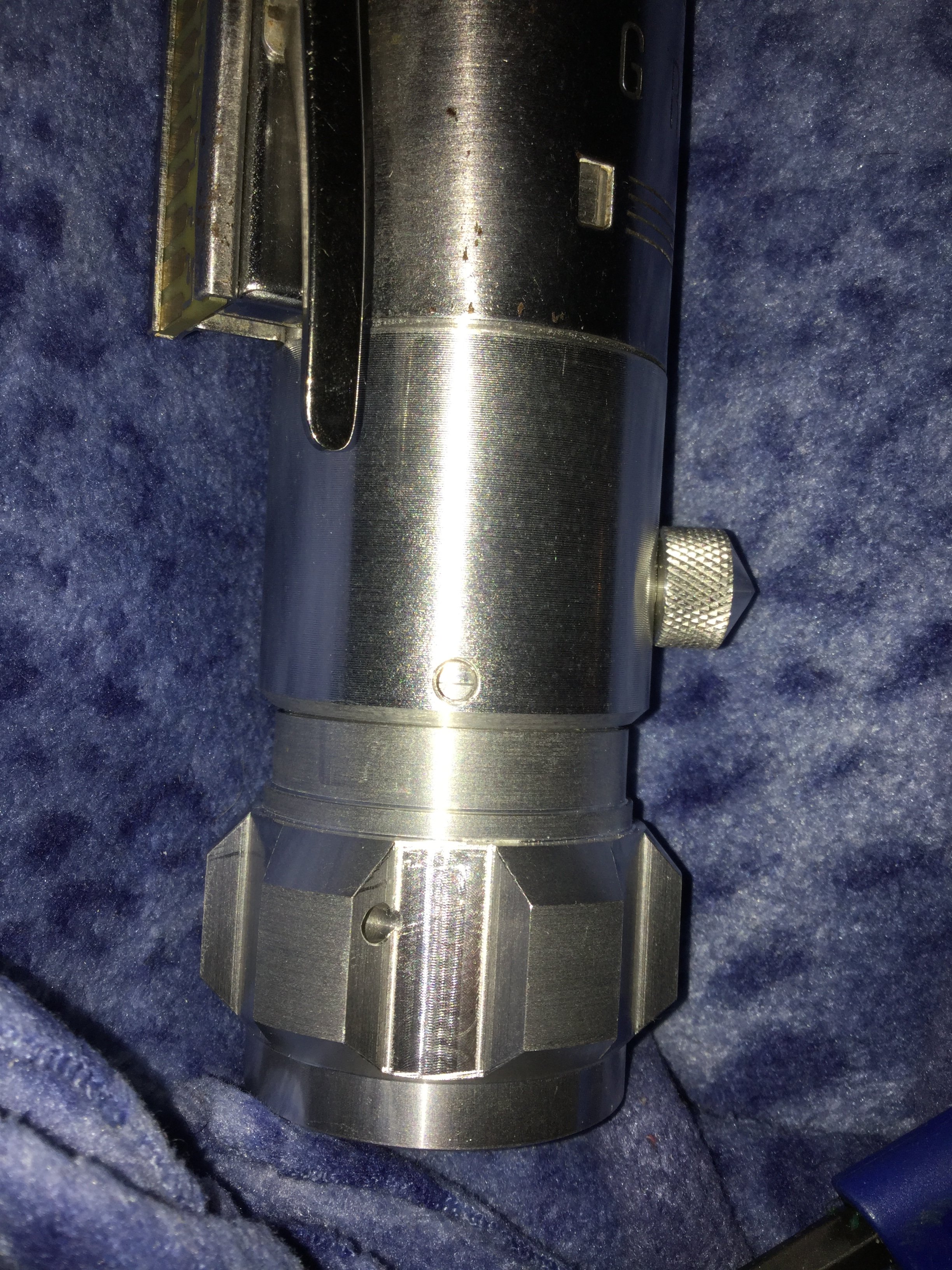

I think I figured it out. The space where the set screw can go is very large compared to the set screw, and the flanges above and below are not tight inside the handle. This means you have a lot of wiggle room and the single set screw can easily tighten and leave the pommel crooked. I had to roll it around and rest it on my knee to try and level it.
It feels tight when slid all the way in - but as you can see - it does not line up with anything solid for the set screw to grip to. I found a bunch of half circle marks all over the lower flange of mine from tightening the pommel.

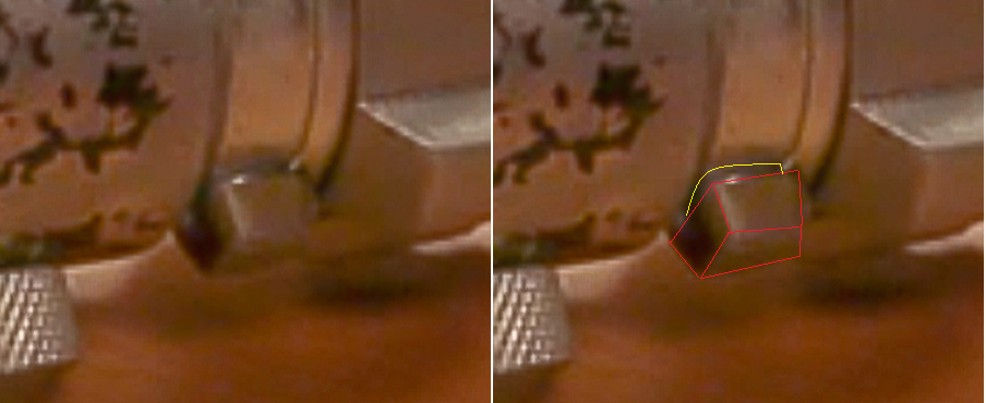

Is everyone screwing the mystery chunk in just this far or has anyone gotten theirs to sit flush?
https://farm1.staticflickr.com/863/40713419915_7ac7295c27_c.jpg
FYI it's not supposed to sit flush. It's raised on the real prop. Maybe not quite that much (about half to my eye) but it's definitely not flush.
This seems intentional.

I was able to thread it in a bit more and now it sits like this:
