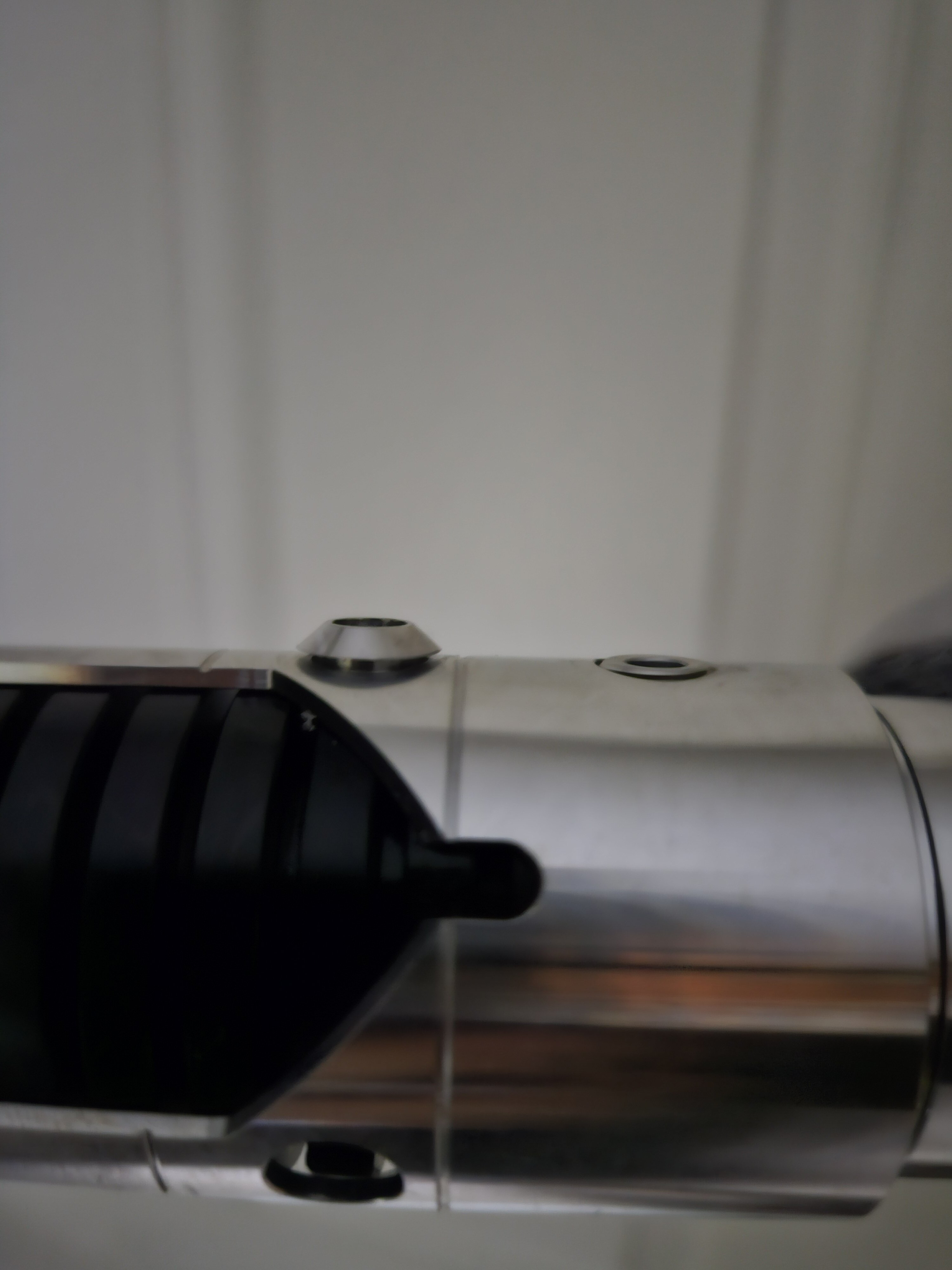

If you could post some pictures of it close up to confirm it’s sitting flush, I find it hard to believe if it’s sitting flush it’s cross threaded..

Here is the photo from side.

Thank you again. I'll find the way to free the bezel and collar.
