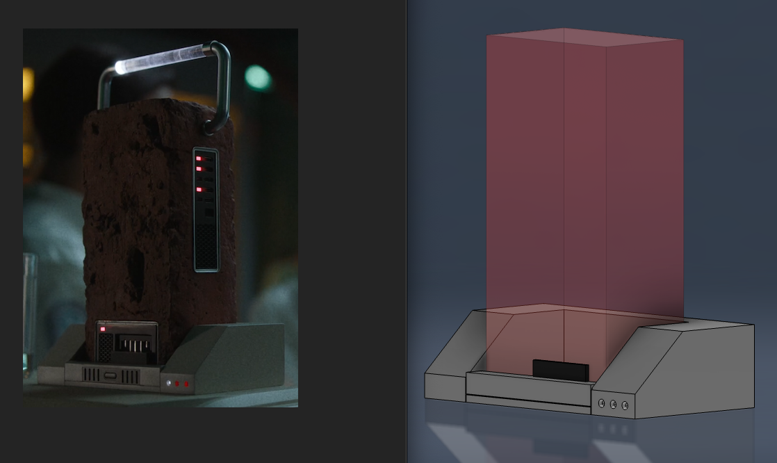

Good point on the filming location - you're probably right. I did some basic RoM sizing estimates with screenshots.
Your estimate for a UK brick is 8.5 x 4 x 2.5 in.
My half-assed-photoshop guestimate gets me to a similar range, 8.07in (215mm) x 4.1in (105mm) x 2.4in (60mm)
Close enough!

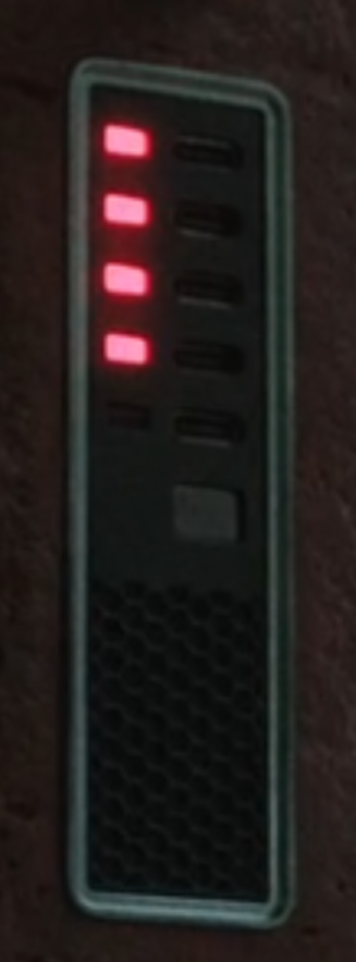

I have not seen the movie and am relying only on the trailers and promotional images. So my ideas are open to correction and improvement. For discussion purposes I put together an illustration of my impression of the panel on the right side of the Memory Core. I believe this to be an output panel. LEDs for visual output, and a grill for possible audio output. There is a rectangular opening in the center with a plain panel behind it. I thought I would make this a sliding panel which could provide access to other internal "output" ports; USB, power. Alternately this might be a rectangular "pushbutton".

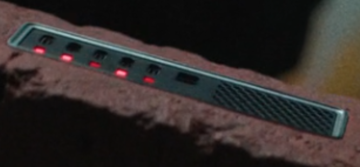

Nice. I have a few close-ups of the two upper rows.
Left side are definitely rectangular LEDs or cutouts with LED.
But the bank on the right isn't LEDs... I'm 99.5% sure they are USB-C ports.
The square port (yellow in your diagram) could very well be a button. This first close-up shows what could be a latching push-button switch in OFF. And second shows ON? (Lights don't seem to coincide)
The more I stare at the first close-up the more I'm convincing myself I'm seeing the USBC hub surface underneath - and that is just a cutout.
Thanks for the close up image. I agree those look like USB ports. The "yellow" port seems to have two states. A plain blank "cover" as in your first image above, and an "open" state with something visible under the cover as in your second image above. I am expecting delivery of "The Art of Mickey 17" in tomorrow's mail. Maybe something new will turn up.

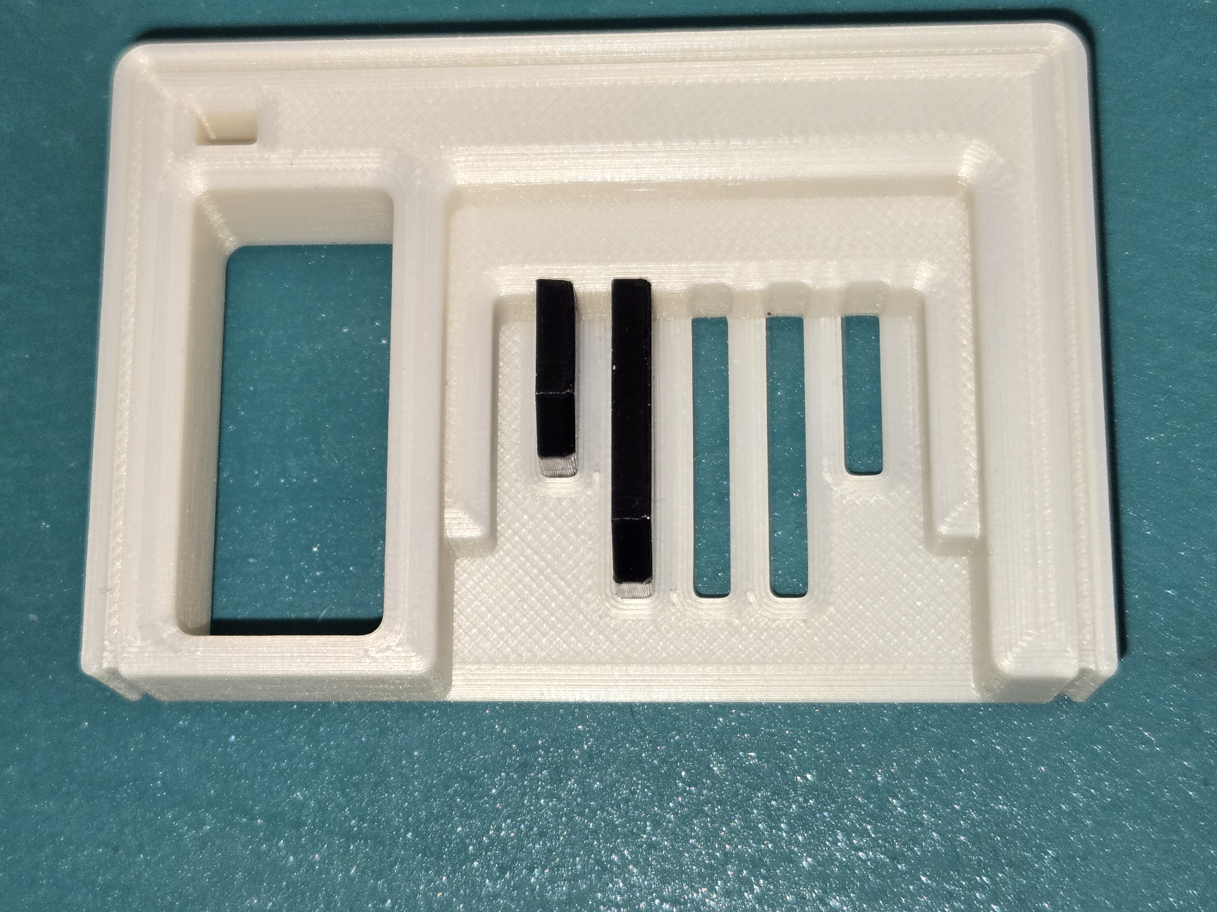

Here is my first 3D print of the Core's Front Interface Panel. White is the interior framework which wraps from the Front to the Bottom of the Core. I plan to cut this design into two parts, the outer bezel will be gray, the interior black. The current black elements are separate "contacts" which slide through from the back. I am happy with the first print, parts go together exactly as I wanted. I think I can improve the objects with some fine-tuning of the design and slicer settings. Ideally the final contacts will be metal not PLA. Again, all critiques are welcome and encouraged. I would rather make correction now instead of later.
