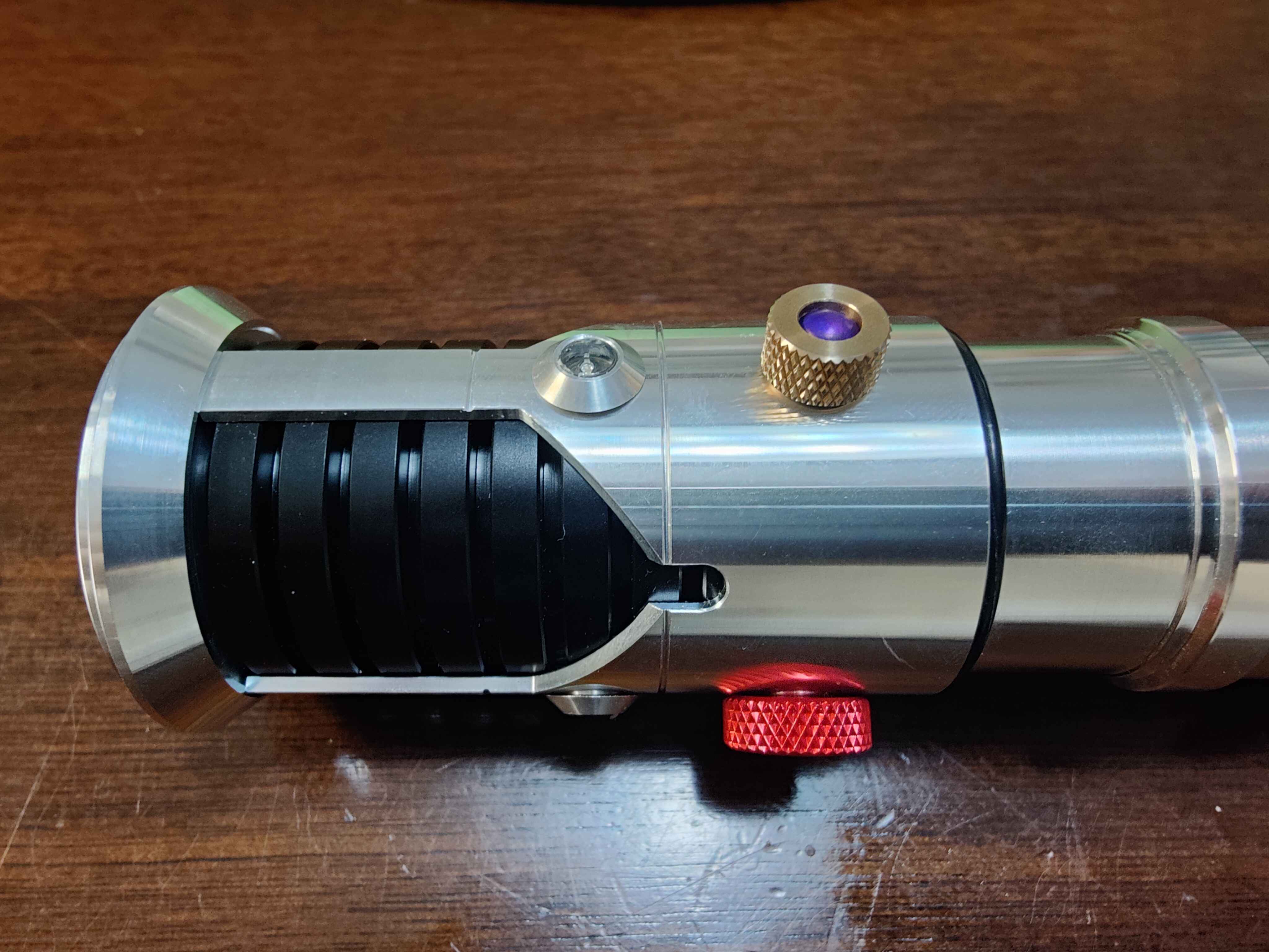

Huge shoutout to guabe for sending me some of his Clan Series Decorative Rivets.
He got them from LAS Aero but it looks like the Round Dome Purples fit the best:
View attachment 1889853View attachment 1889854View attachment 1889855View attachment 1889856
You can get em here:
Decorative rivets [Clan series]
These rivets are original from the United Kingdom and were like those used during the prequels on some of the sabers as decorations. Body diameter is 1/8". Varies in lenght 3 types available For the Clan Fisto (oathkeeper) you need 2, the round purple and round violet For the TPM Obi you need...www.laredosabers.com

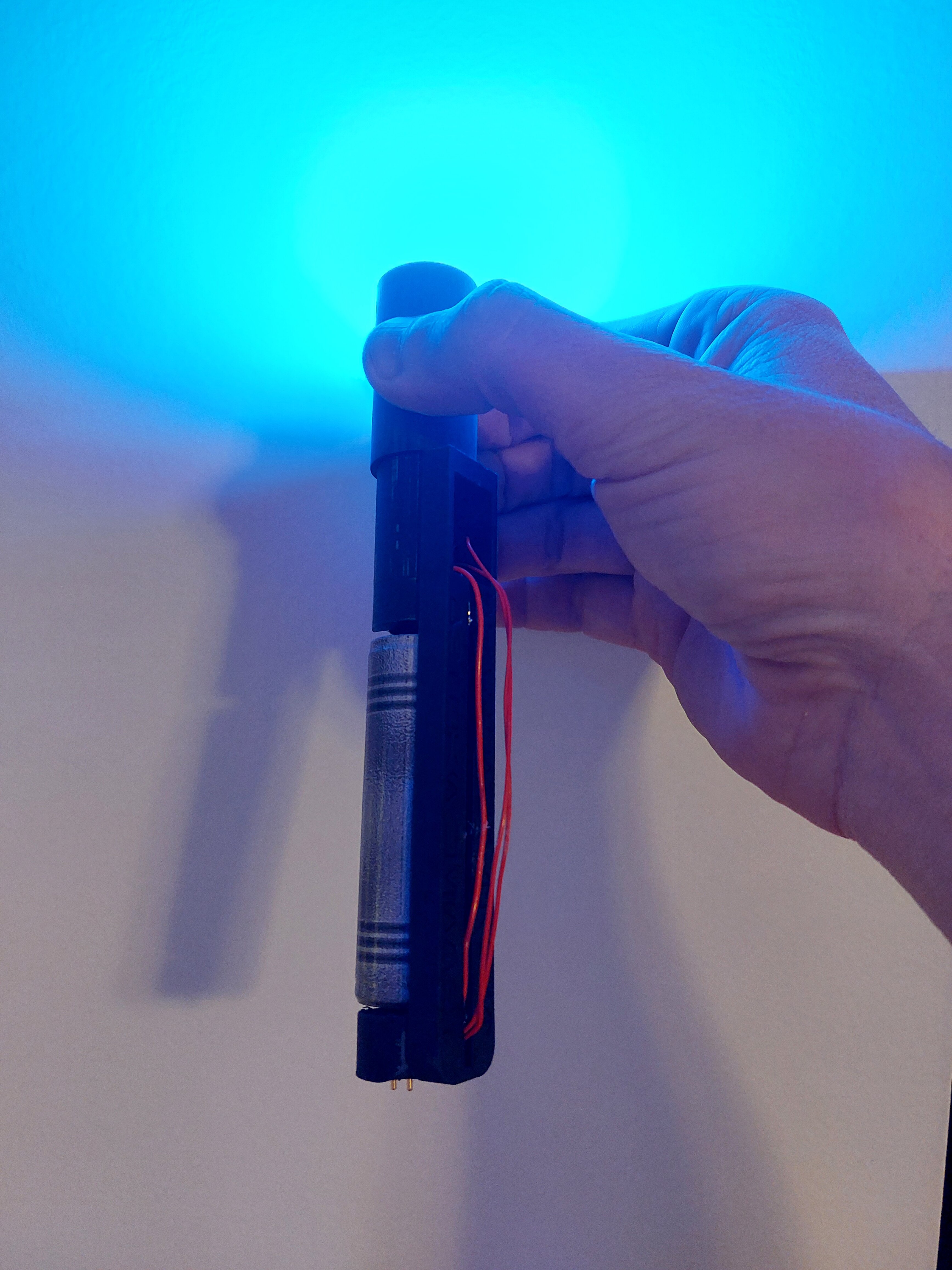

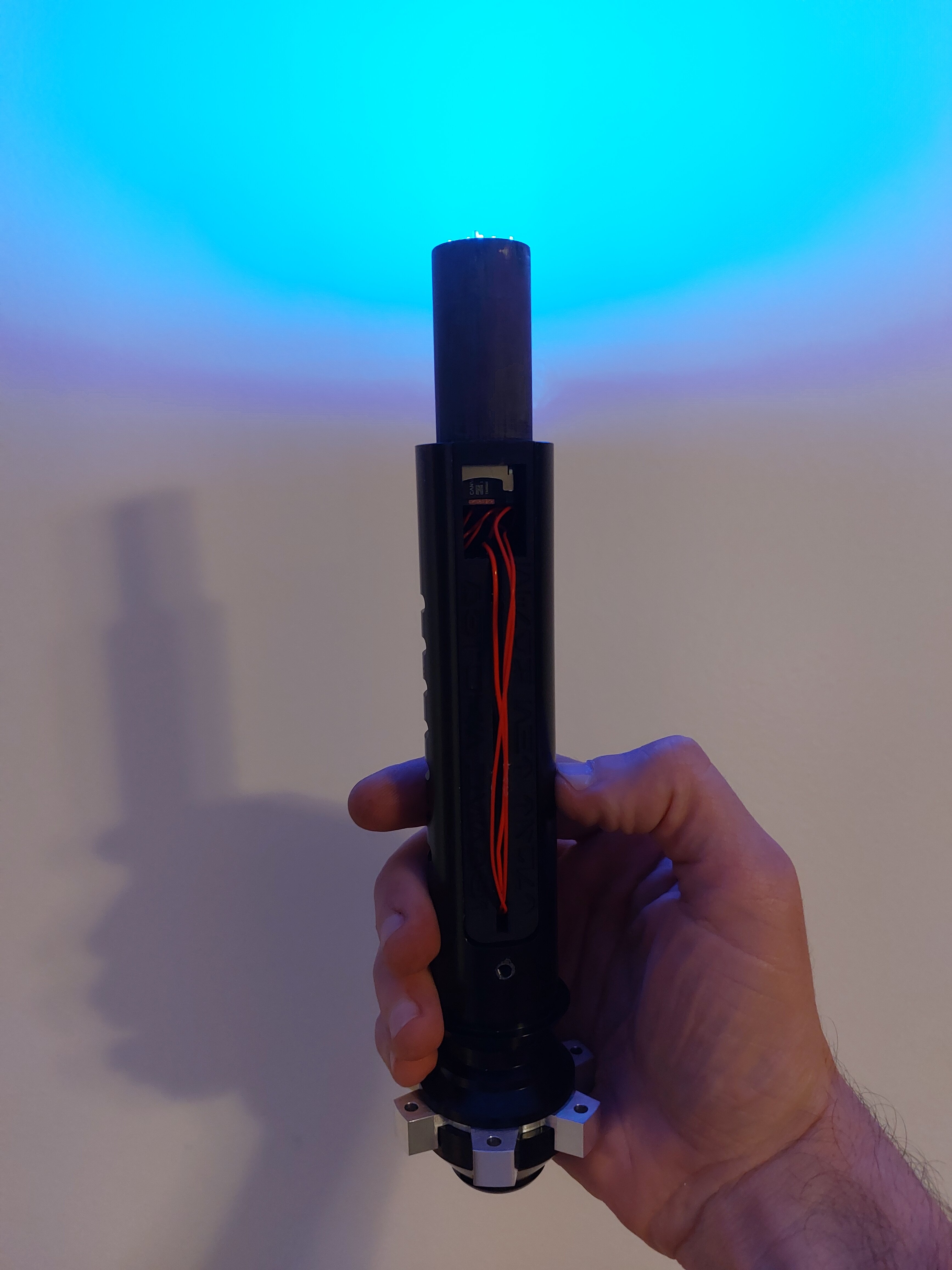

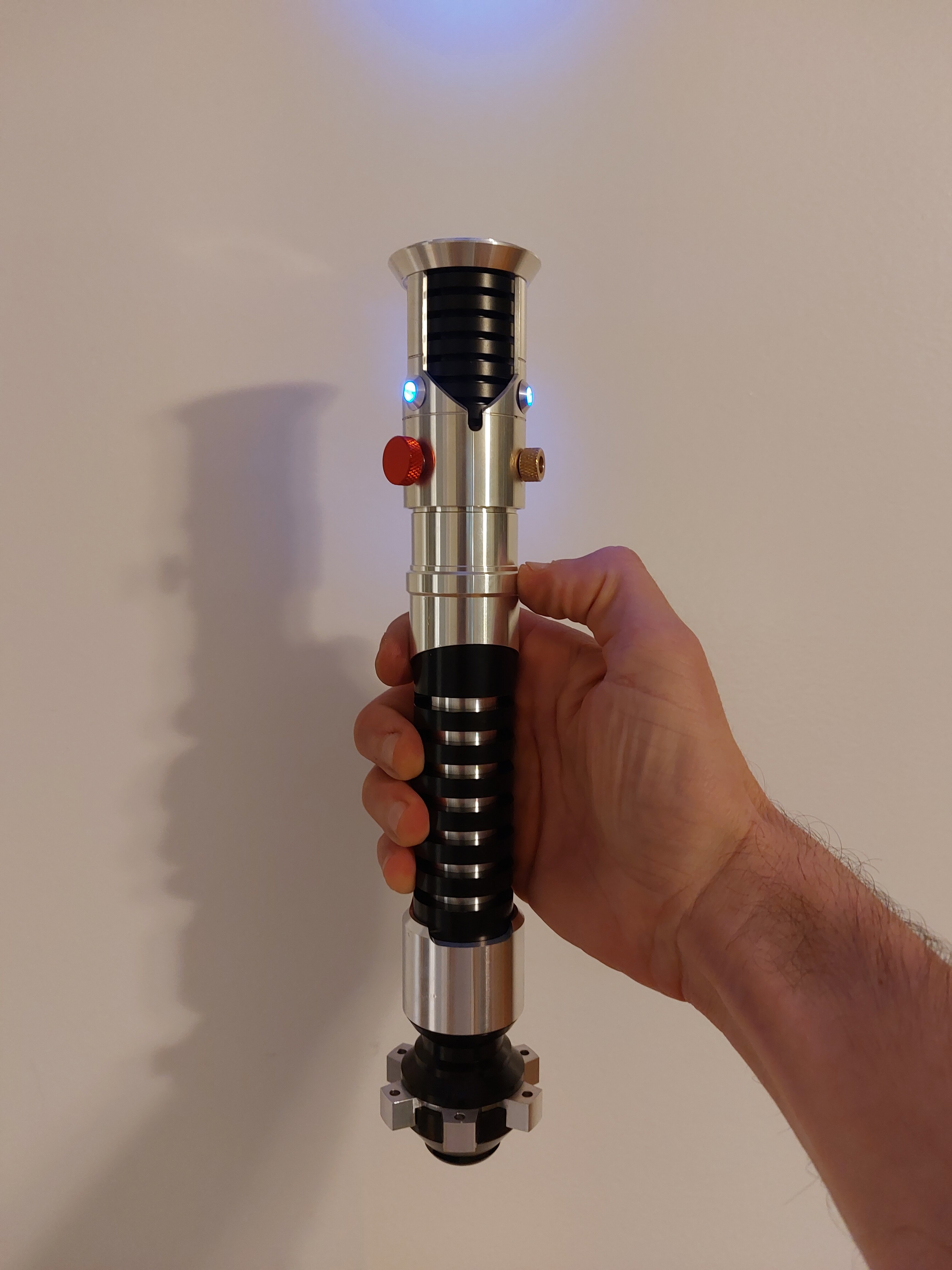

Removable 18650 battery chassis successful.
Shine through only. I honestly hadn't thought about trying to wire them on their own.Nice! With LED shine-through, or did you actually wire them up?
Really nice. I’m waiting on the post office to drop off some parts so I can build mine.Removable 18650 battery chassis successful.
Wicked nice jobRemovable 18650 battery chassis successful.
Thanks dude!Wicked nice job
Love it! Will this chassis be available somewhere soon?Removable 18650 battery chassis successful.
Hey dude! STLs attached here and I can email the Fusion file to anyone who wants to manipulate the design as they see fit.Love it! Will this chassis be available somewhere soon?
Thanks so much! Very generous of you.Hey dude! STLs attached here and I can email the Fusion file to anyone who wants to manipulate the design as they see fit.
This chassis relies on a GHv4, a Shtok NPXL (I used a v3, but a V4 would also work), Shtok 2-pin speaker PCBs, a 28mm bass speaker, and the smaller battery tabs found here: Battery Tabs
I discovered today that I may need to use the spacer for the speaker pod to keep the contacts pressed the pins and will be testing different sized spacers. Thankfully these are easy to design and print quickly, so I should have an update later today when I return home.
I don't mind at all! Here's the list of the parts I used:Thanks so much! Very generous of you.
Do you mind if I list this for download on my website for people who aren't following this thread?
Incredibly generous! I'll throw this up on my website later this week!I don't mind at all! Here's the list of the parts I used:
Golden Harvest V4 (it will not work with a GHv3 as the older board is wider)
NPXL V4 Hiltside Pixel Connector
Newest version of the ShtokCustomWorx hiltside neopixel connector, now in a V4 version. This listing is for one single NPXL connector, with various add ons and variations including short or long pins, assembled or unassembled pins, and various holders and lenses to add. Please note that all...www.saberbay.com
Saberbay 28mm X-BASS 8ohm/3W Speaker
Battery Tabs
The speaker PCB set I used doesn't seem to be listed anywhere online, but it was nearly identical to this: 2 channel 2 Pin Chassis Connector

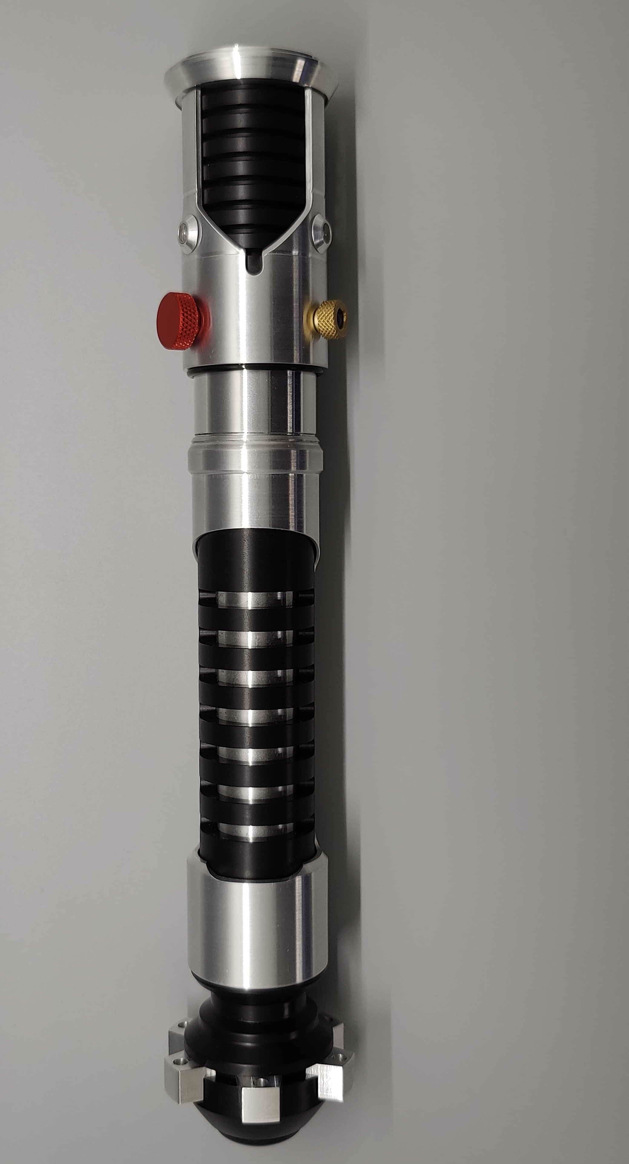

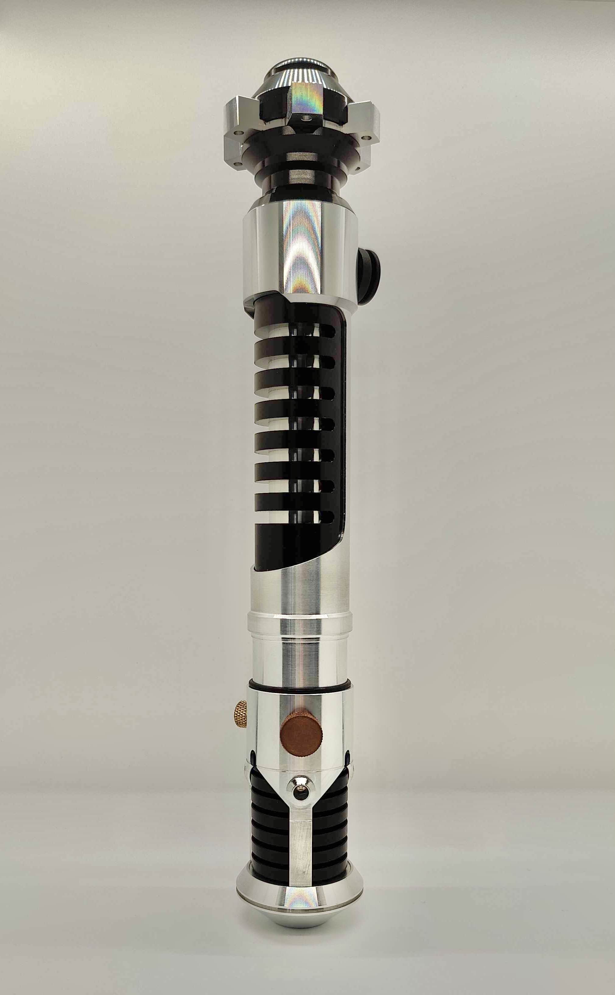

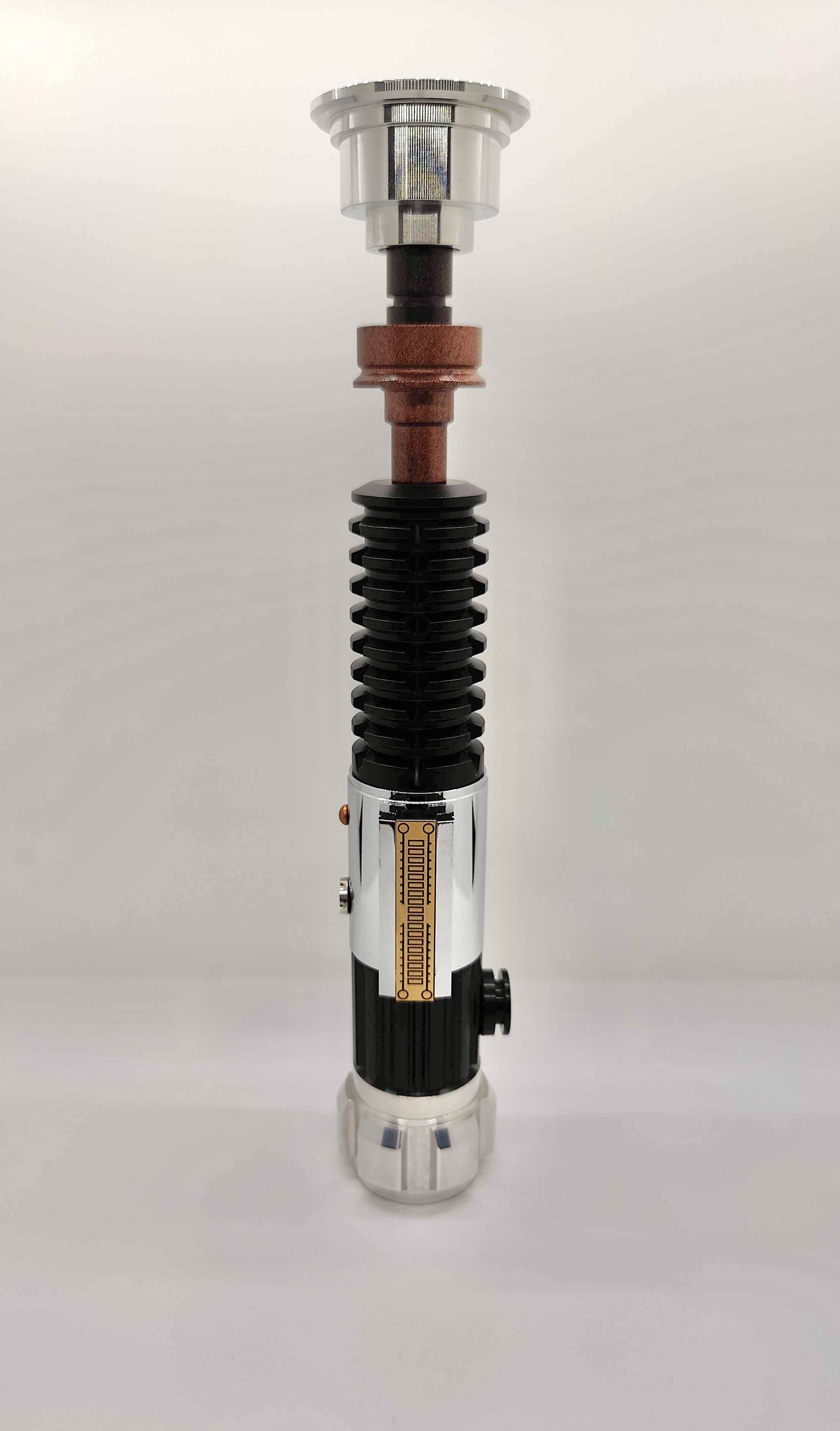

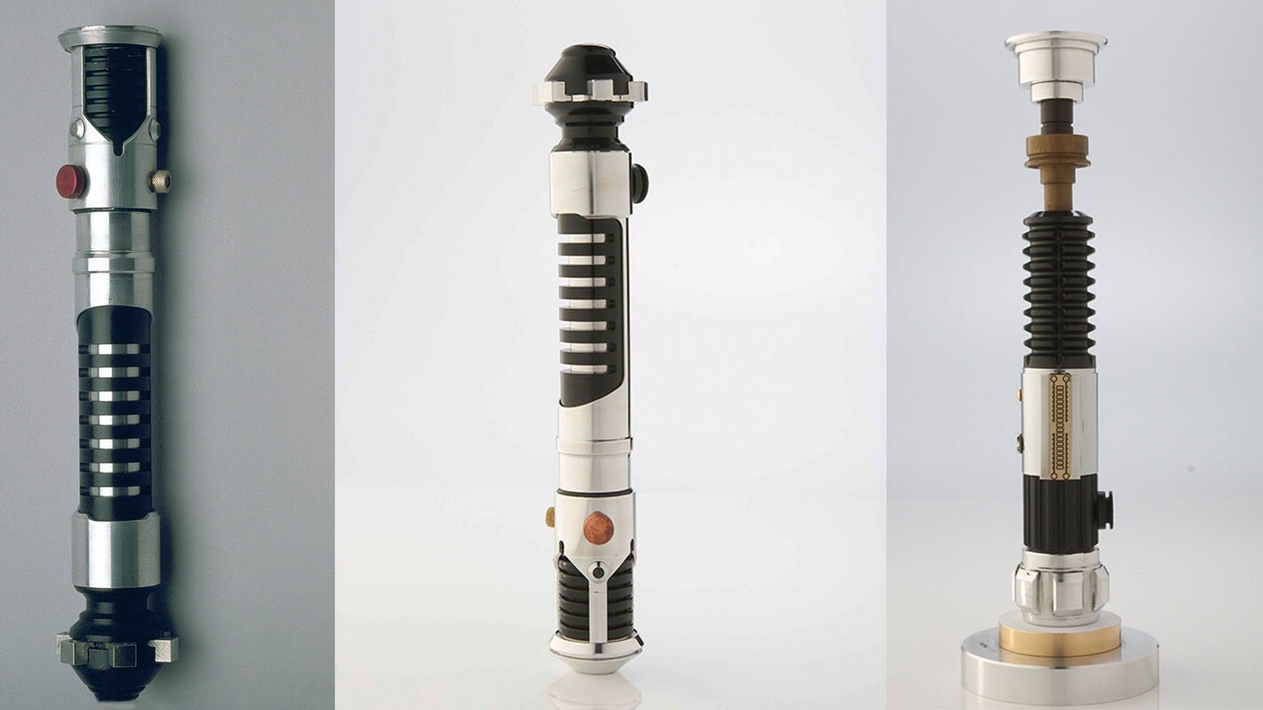

Great side by side pics!!Merry Christmas guys! Thank you Dan (And also Drew for the TPM) for bringing to life these amazing replicas:
View attachment 1890954View attachment 1890955View attachment 1890957View attachment 1890958
Thank you! I definitely don’t have the right lens for my camera to match the perspective of those images, but I tried...Great side by side pics!!
