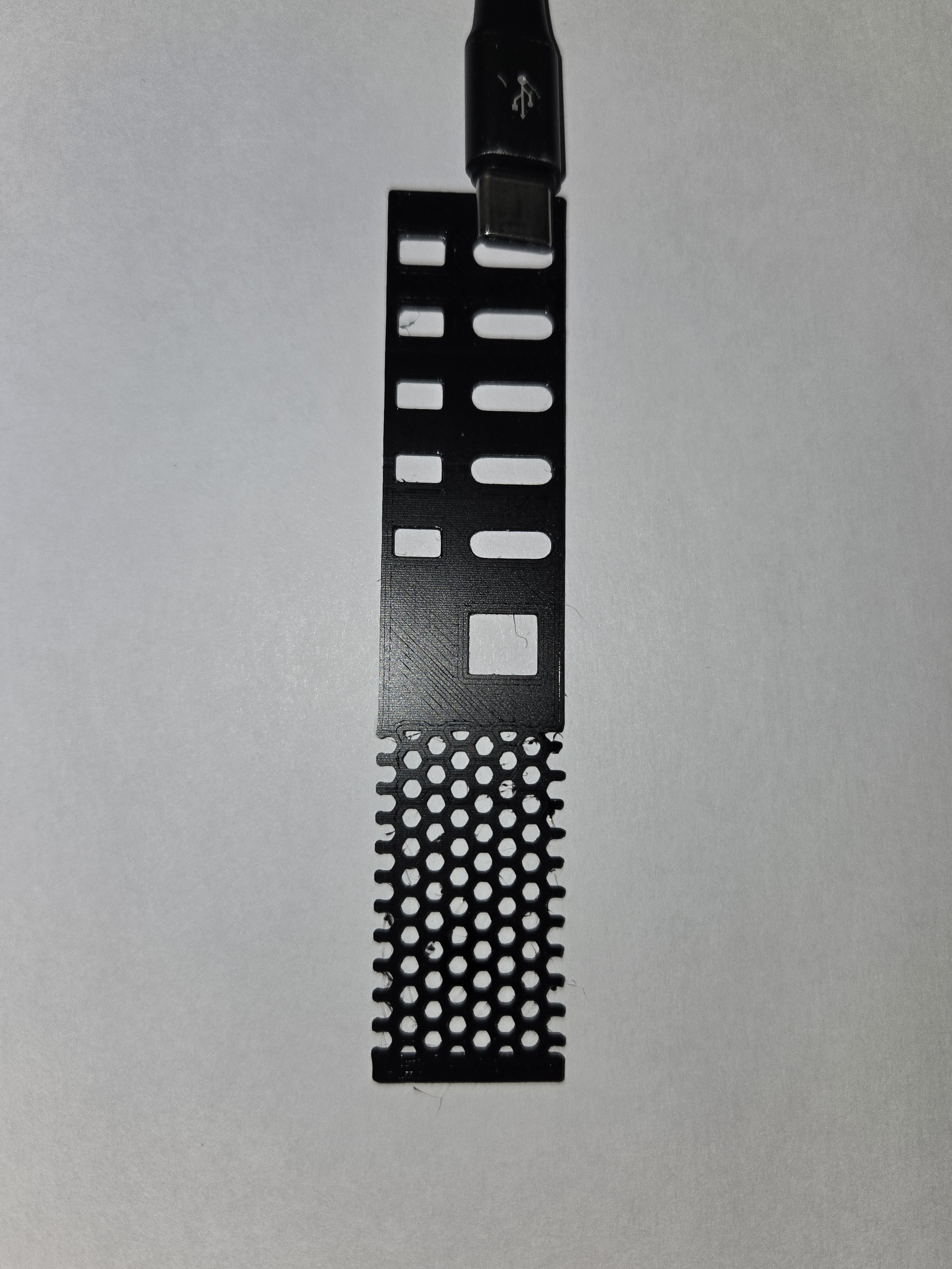

Here is a printed version of the Core Side Panel Grill. I probably should have checked the size earlier than this, but I included a USB-C cable as a reference. Again I am happy with the way the print turned out. Only a few stray "whiskers" on the back side. I printed this upside down to get the smoothest surface on the front. Of course, since things WERE going well, when I went to change filaments one of the printed parts which supports the extrude operations broke and I cannot unload the old filament. Since I built the printer from a kit I am comfortable with making the repair but now both of my 3D printers are down for different reasons. So members will not be pestered with any new prints in the near future - but I am working on some additional models. Just a fair warning. "If you do not want to see something - say something" - NOT New York Metropolitan Transportation Authority.

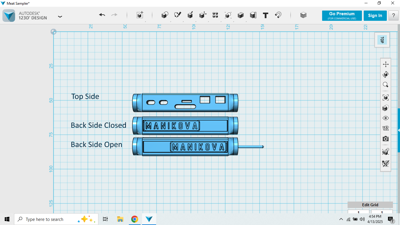

This model is my own extrapolation of the device contained at the top of the Core Storage Case. Only the top side is visible so I took liberties with the rest of the device. I have named this the Manikova "Meat" Sampler. Since even Mickey is concerned his "meat" might go bad after several prints, I thought there should be some quality control checks on the final product. The top side provides the output display. The back provides the sampling control. This is a slide which projects the sampling needle from it's protective housing and into the product. When the needle is retracted, the device provides its analysis. The movement of the slide will also change the appearance of the top side displays.
I have branded the device, with Alan Manikova's name, in a manner consistent with the side of the Print Bed (gurney). The debossed name on the slide surface again matches the gurney and provides a tactile surface to manipulate the slide. For those who want to produce any printed or labeled material, the best free font I found to match the gurney's style is a ttf called Universal Knowledge.
The slider has been sized to use the type of inflation needle for sports equipment such as a football or basketball.

Main printer repaired - now ready to print the broken part for printer #2. I was anxious to see if things were back together properly and I did a test print without any new calibration. Side Grill from before the breakdown fitted perfectly into the new untested bezel print. A new Manikova slider needs more work on my settings. And I will now do the proper calibrations and First Layer Print Test.
