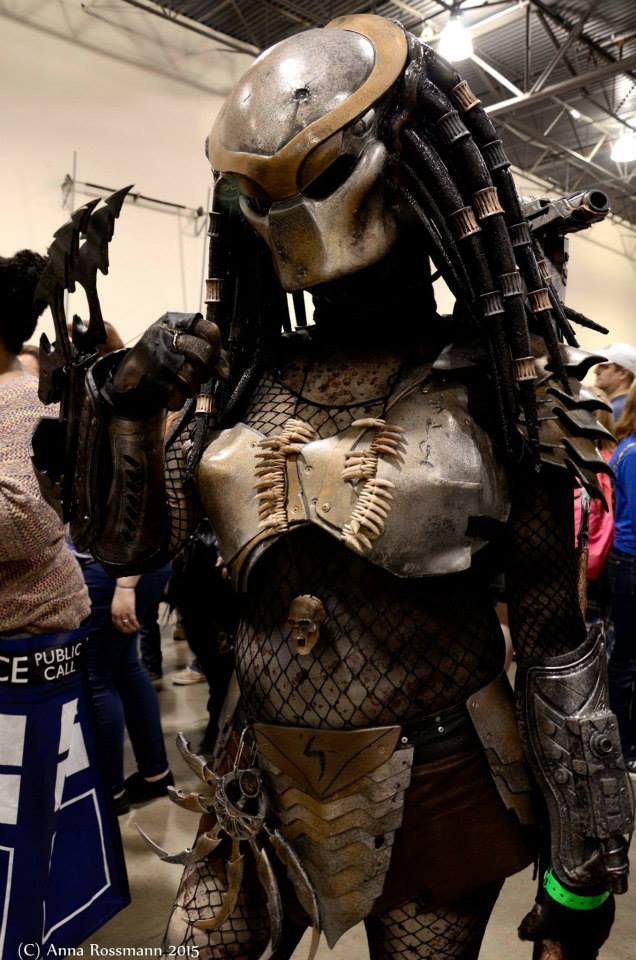

This was my #1 inspiration when I first built my Lady Predator.
There were only one or two things about it I didn't like... overall it was right on with what I wanted to begin with.
it's evolved somewhat from this over time :)

How uncomfortable did it get just during the photo session? It sure looks good, and after seeing the quality of work in the cannon, mine is coming off the suit and getting work now...inspired by the killer job you did on yours.

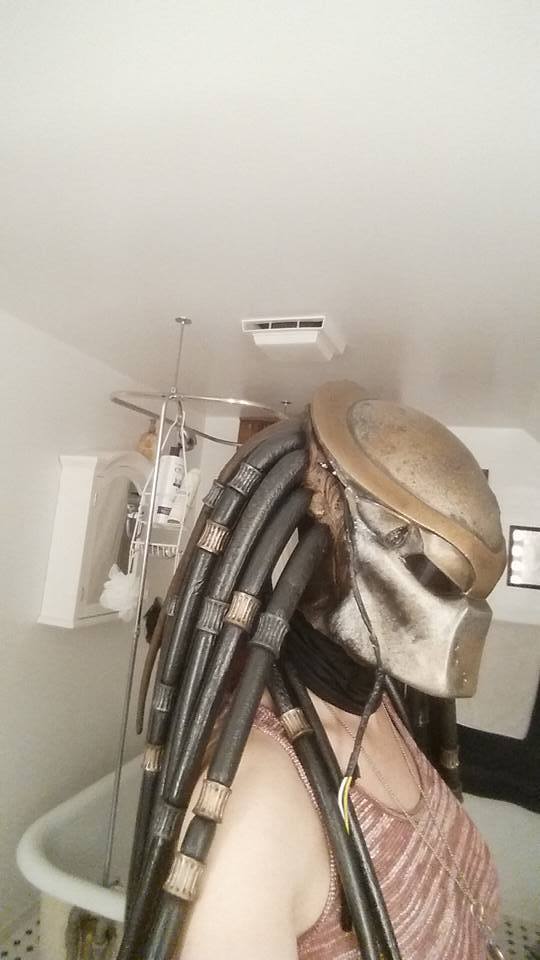

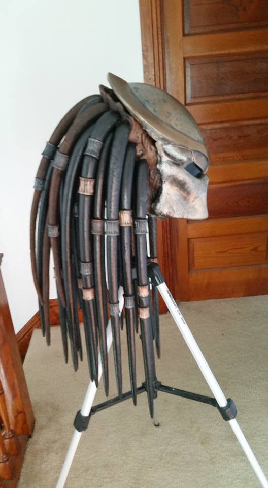

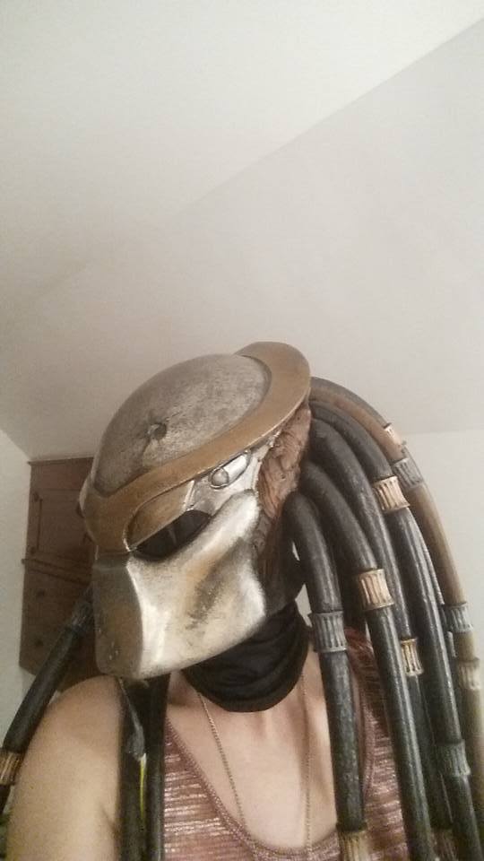

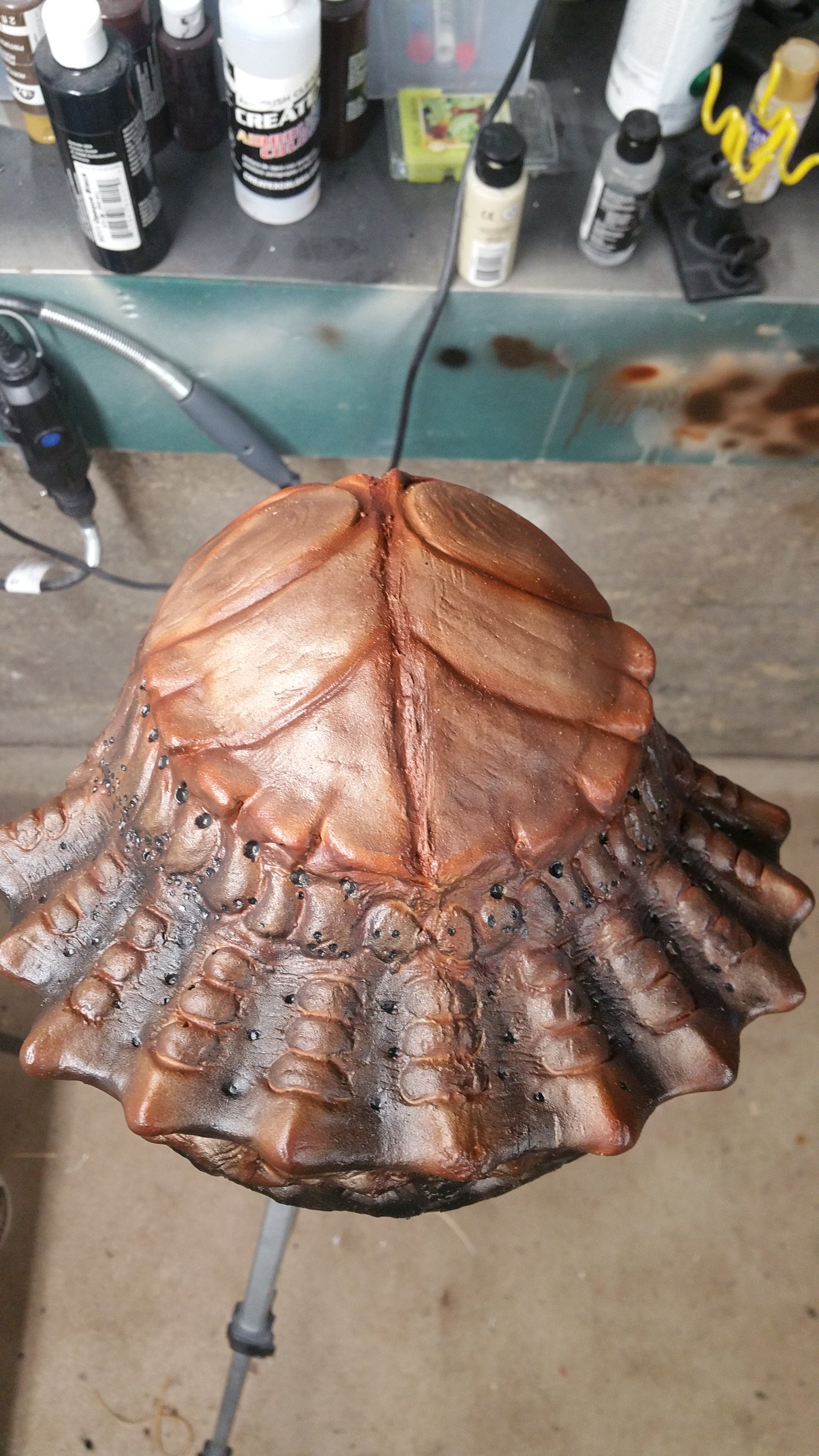

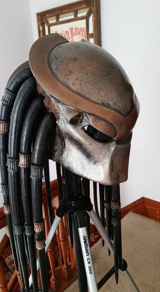

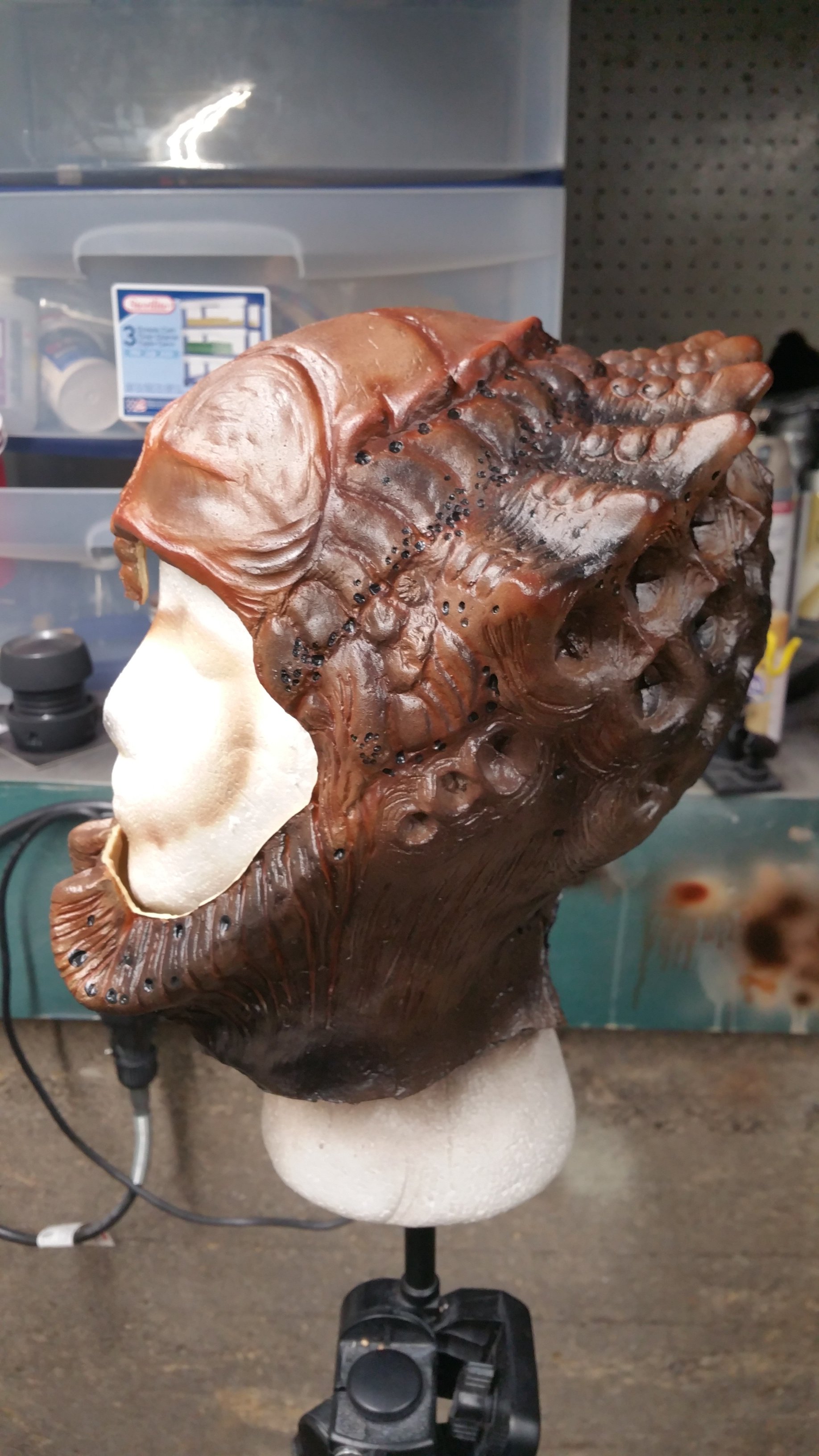

It really wasn't bad to wear at all, other than the fit of the Bio/Dreds wasn't the best. (The pictures where i have the shorter dreds is actually an undermask that I cut up and glued directly to the Bio mask). I have since moved to an entriely new undermask, new longer dreds and will have my Bio mask removable utilising rare earth magnets to hold it on.
The old mask fit uncomfortably, but the new one should improve on this.
The cannon was a happy accident. My husband YOSHIWA1985 has an Uber cannon from Casey. So I just looked at that, and eyeballed this one, scaling it way down to fit my build. I started with two different sized of PVC pipe glued together to form the basic shape, and then went to town with EVA foam making the coverings and details for it based on the Uber cannon. I put it together in about an hour and a half.
Creativity...and working quickly, wow. I will mod the cannon I have and guarantee it take me many hours. Might consider a replacement.

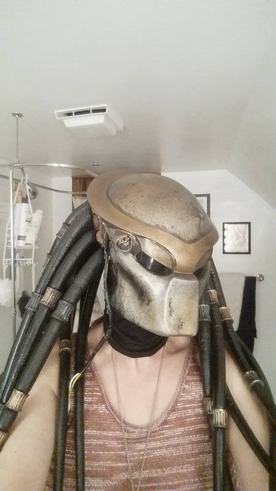

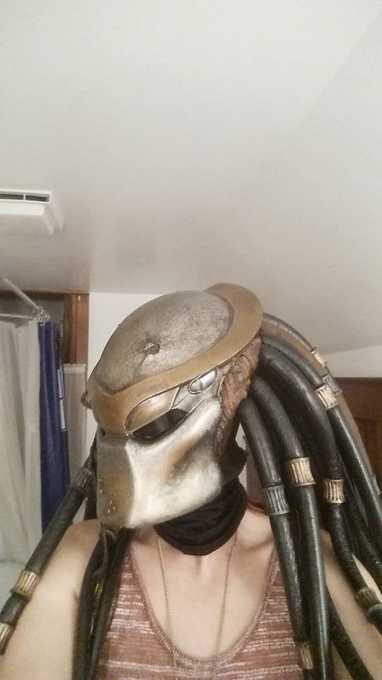

I do not foresee being very comfortable in the mask and still have to address some kind of airflow solution, fans, air pulled through via some tubes, something....

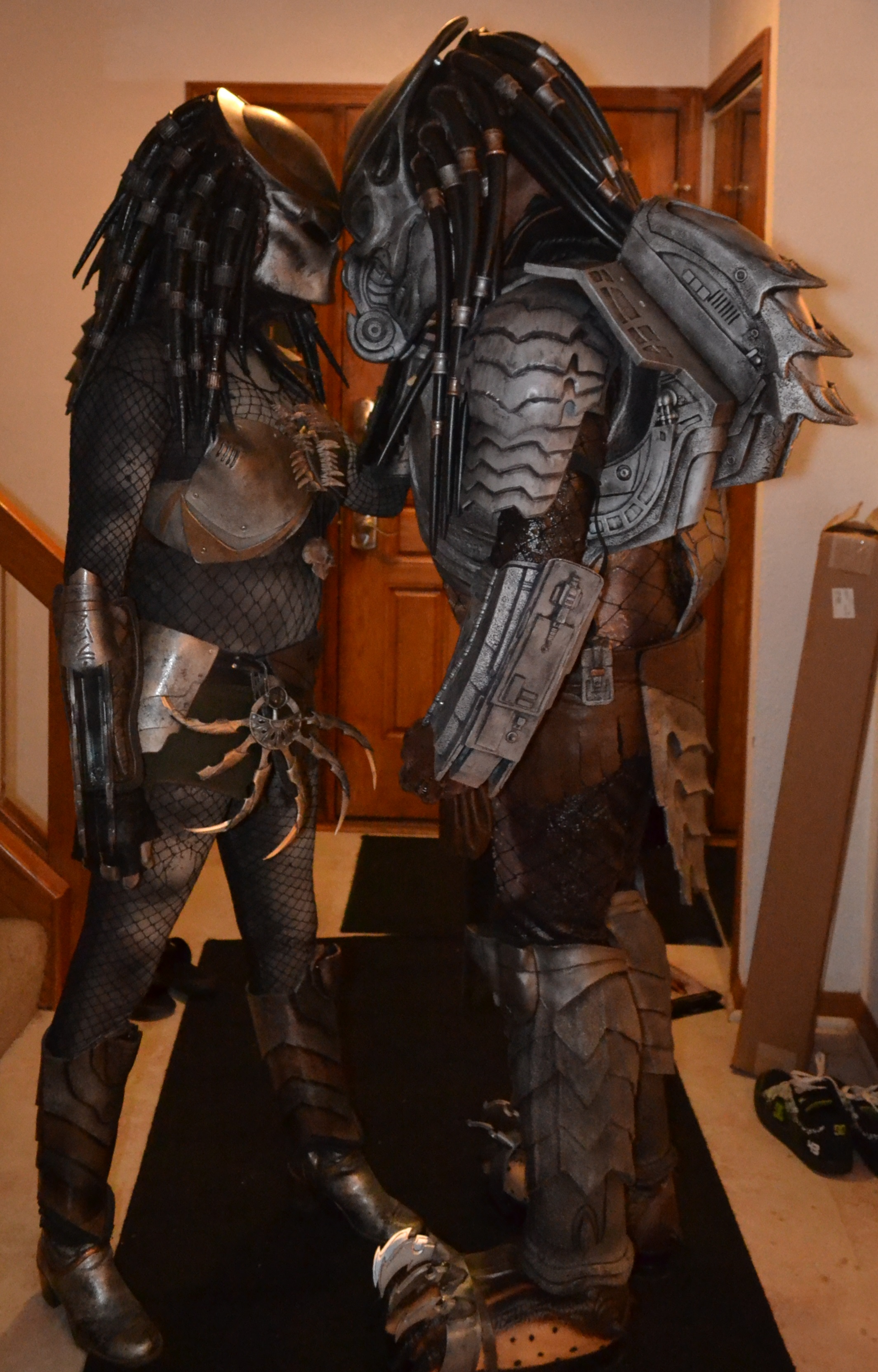

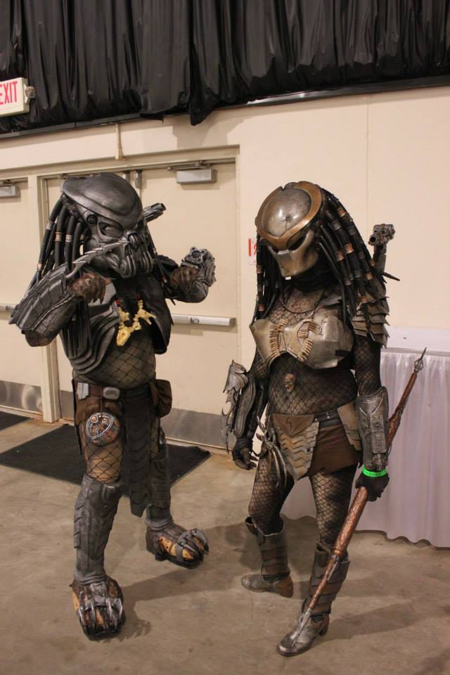

Great pic!
I'm looking at the scale of you two, and then noticed even the dreads on the female are appropriately smaller, spot on.
