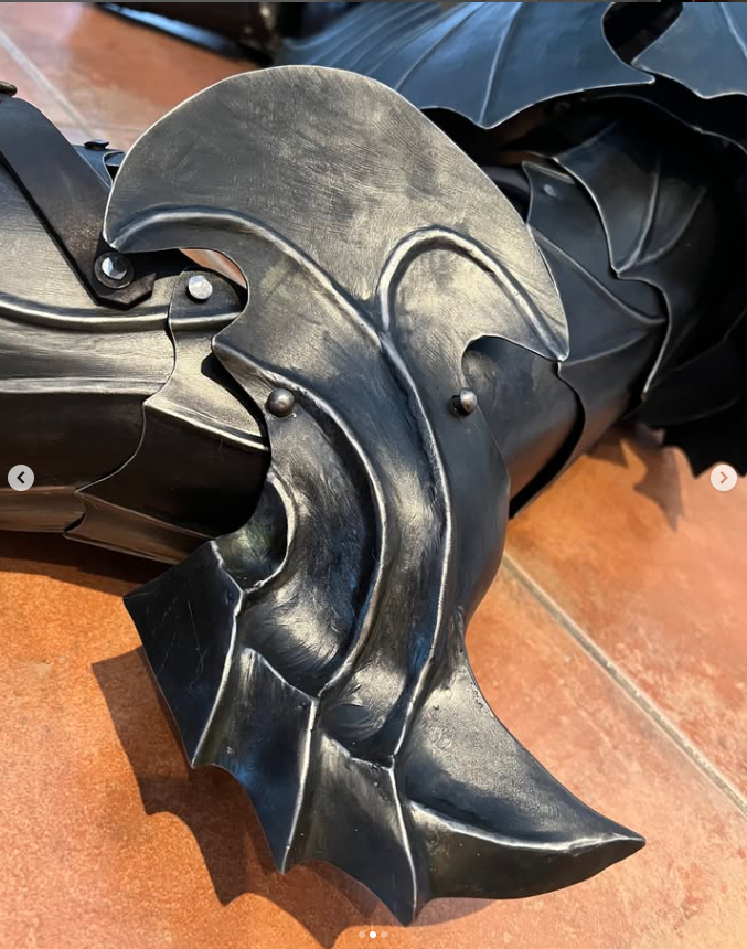

This is what I was using for reference, pulled these off of kropserkel on instagram.
Elbow flare looks a bit bigger here

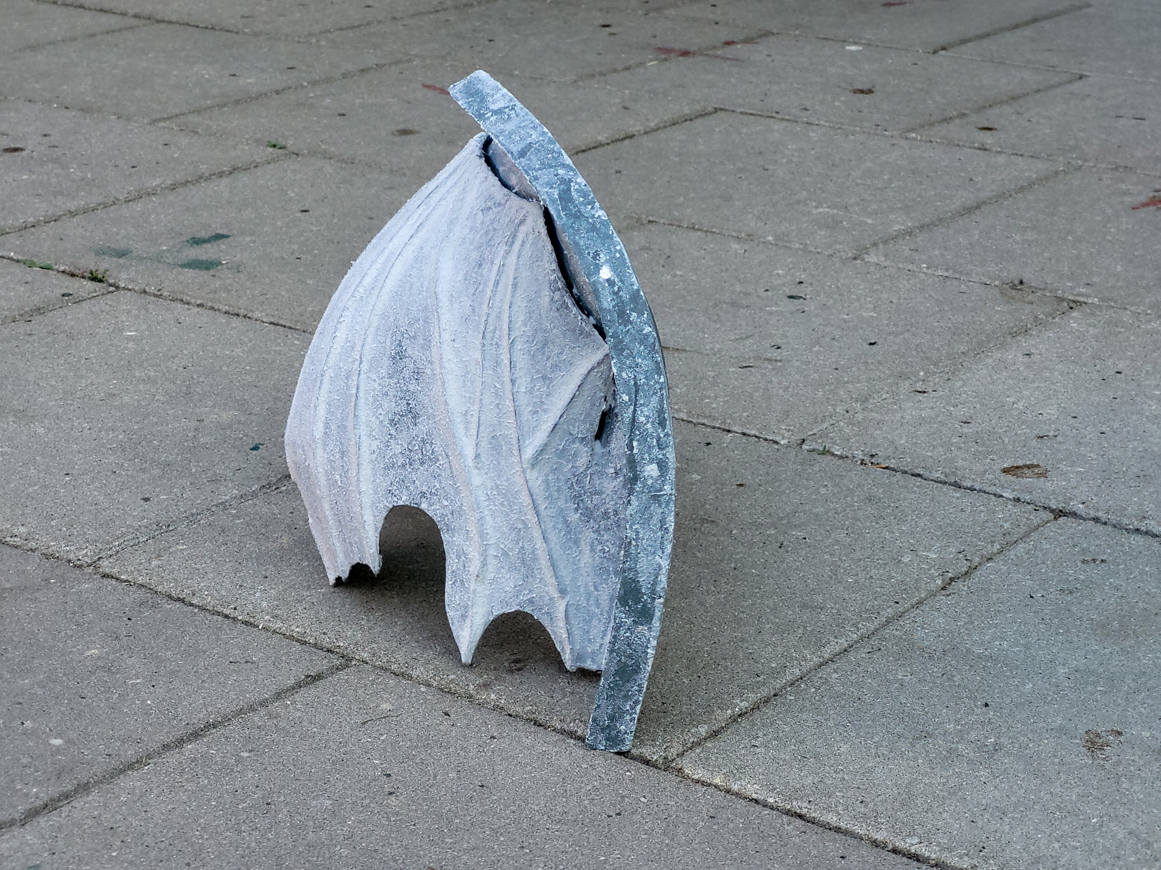

Small update as I have mostly been tweaking the template for the pauldrons, started out with a basic sketch and gradually made changes to make it look like the movie version.
I will make these out of 5mm eva foam as well with glued undercuts for the ridges.

Just one part to go and probably some more tweaking but pretty happy so far.

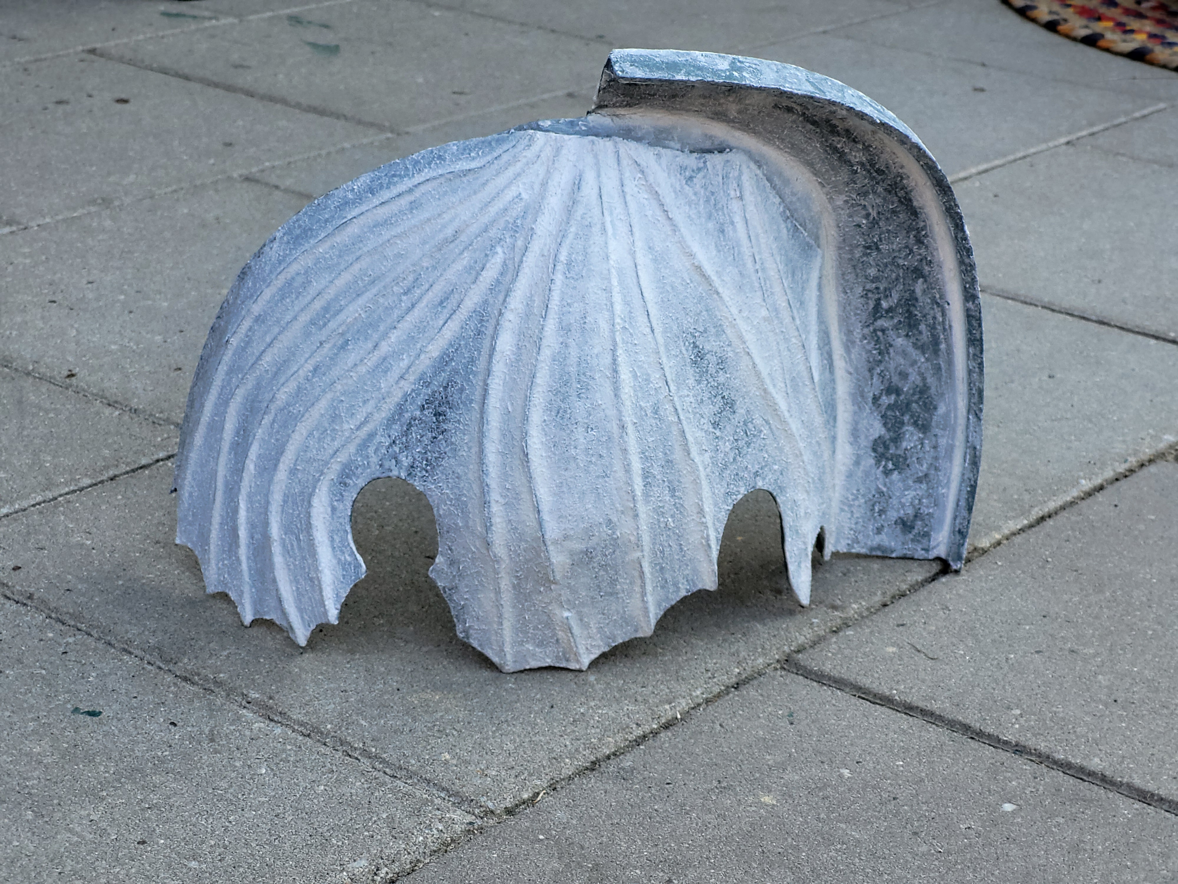

Hi all, today I glued the seam together, drew lines on the bottom for the undercuts and cut them. Then glued with contact glue, heat gun for shaping and added 2 foam strips to hold shape. Think I might need to hide the seam a bit more but I'm happy so far.

I've been doing more work on the pauldrons, some more shape tweaking and I made the segmented plates smaller to fit better. Also added the neck guard and used kwik e filler for the ridges ( need to do the plates still).
I'm very happy with how it's looking so far, honestly didn't expect my own templates to turn out this well.
The duct tape will be replaced with leather strap and probably chicago screws when I have primed and painted the pieces.

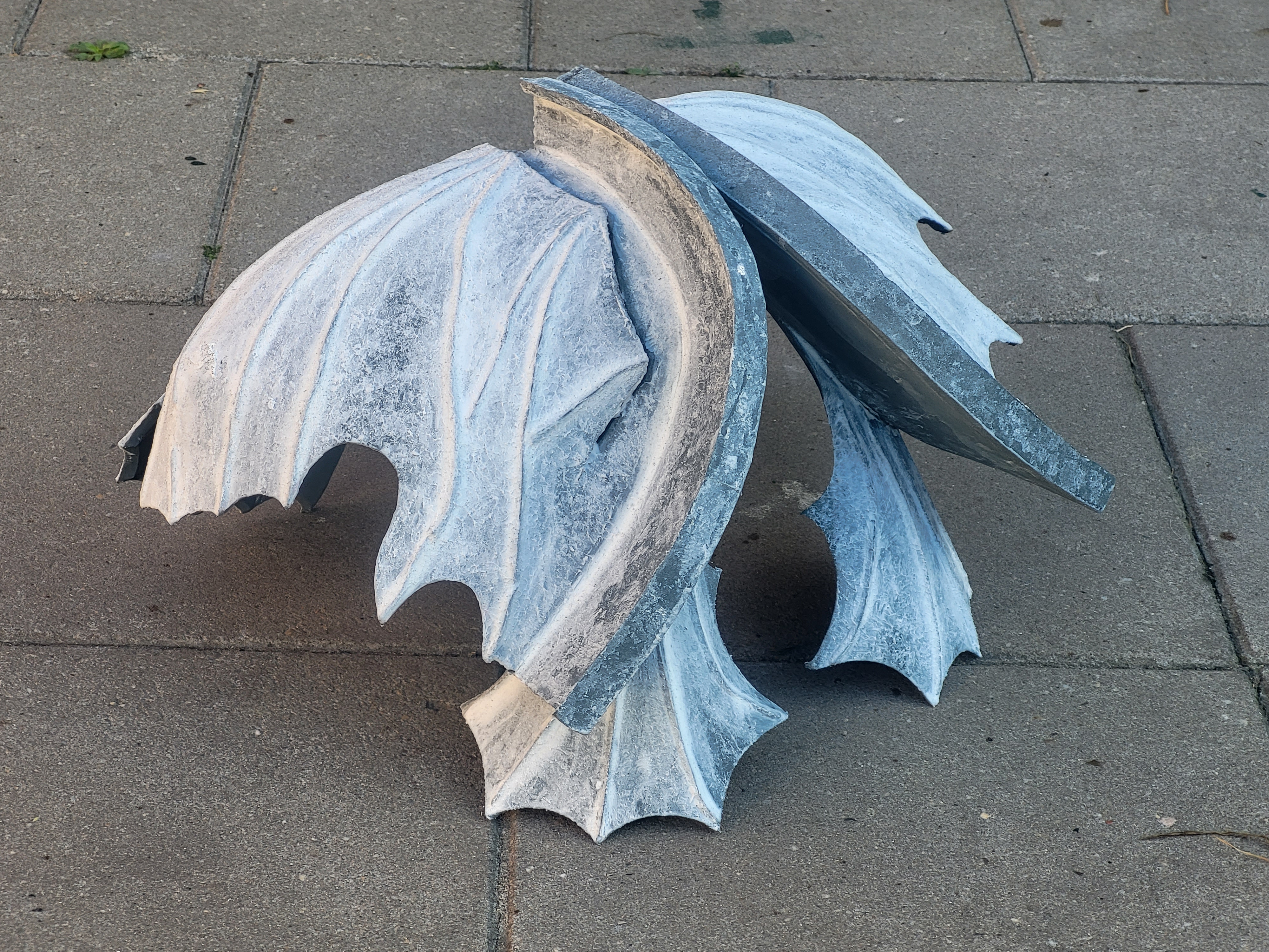

Quick update for the pauldrons. I have started texturing with Liquitex modeling clay, same technique as for the helmet (apply and dab with aluminum foil).
I was kind of doubting the ridges I had applied, since I didn't use any precise measuring or templating for them they are kind of chaotic and uneven compared to some I have seen. But I thought I could get away with it, with the armor supposedly being thousands of years old Mordor forged iron. So I went ahead with the texturing. Lemme know what you guys think!

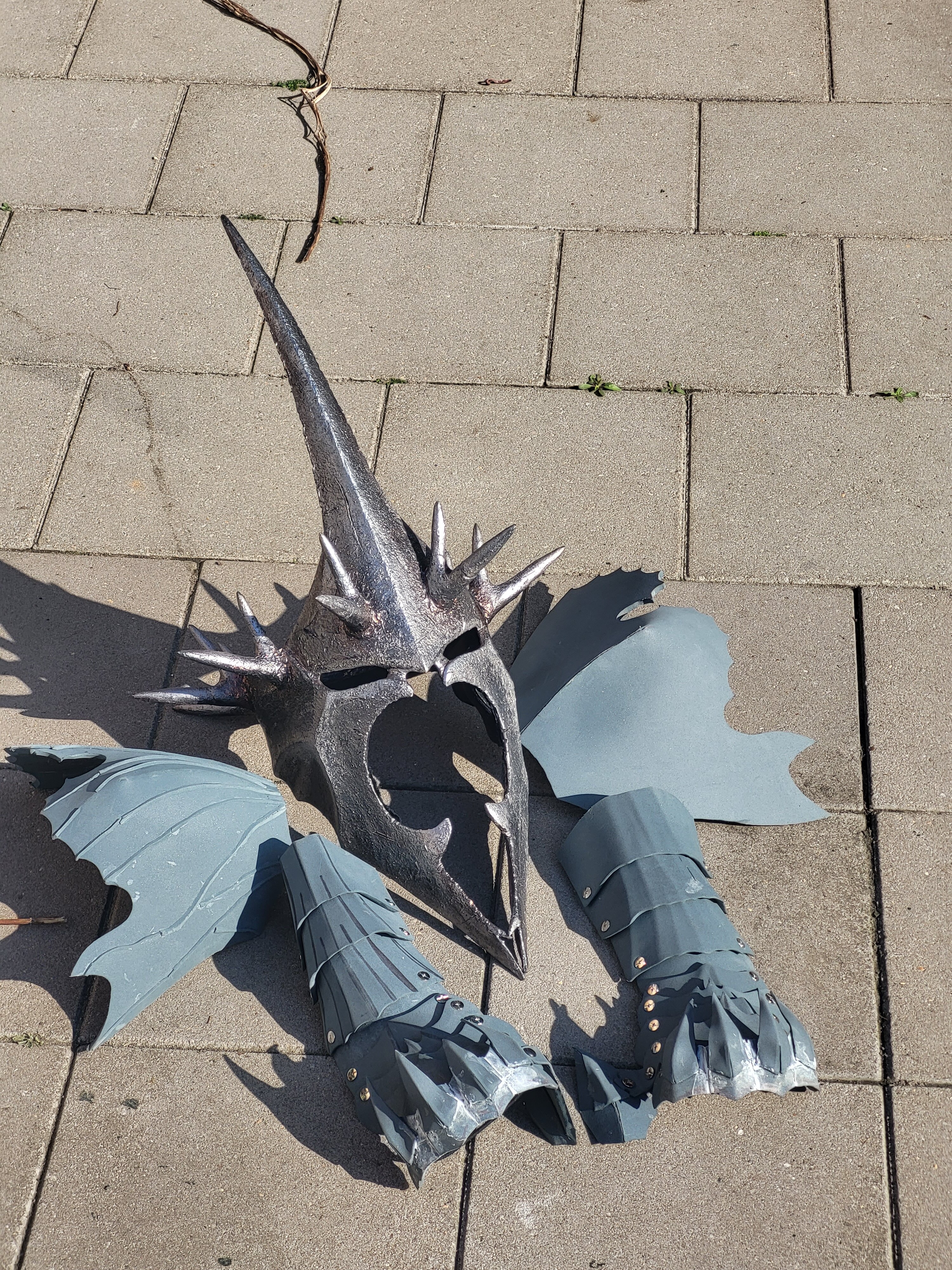

Hi RPF'ers, I assembled all the pieces of the pauldrons today. Before that I decide to glue in some shoulder filling which raises my shoulders a couple of centimeters, so it doesn't look weird with the helmet sitting higher on my head than normal.
I'm very happy with it. I used nylon webbing which I made holes into with a soldering iron for attaching the segmented part to the pauldron, the rest of the parts are attached with only chicago screws.
I'm planning to line the inside with cotton as well for more comfort and moisture absorption.
