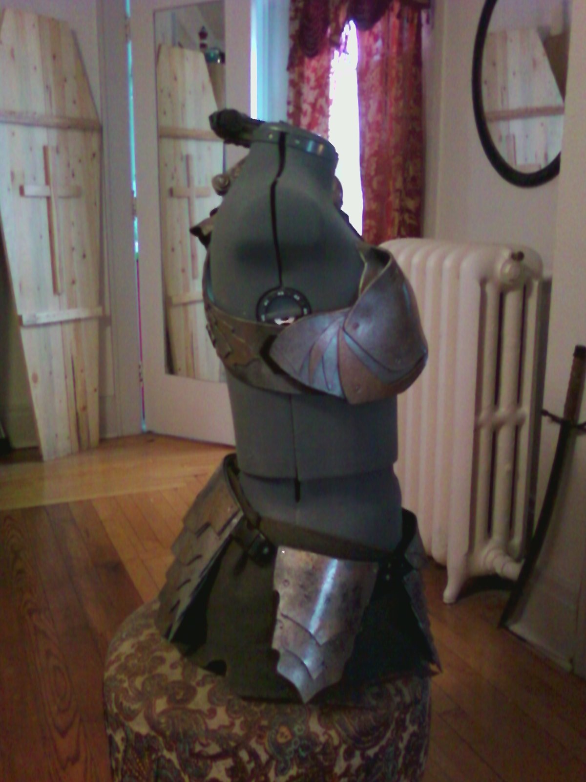

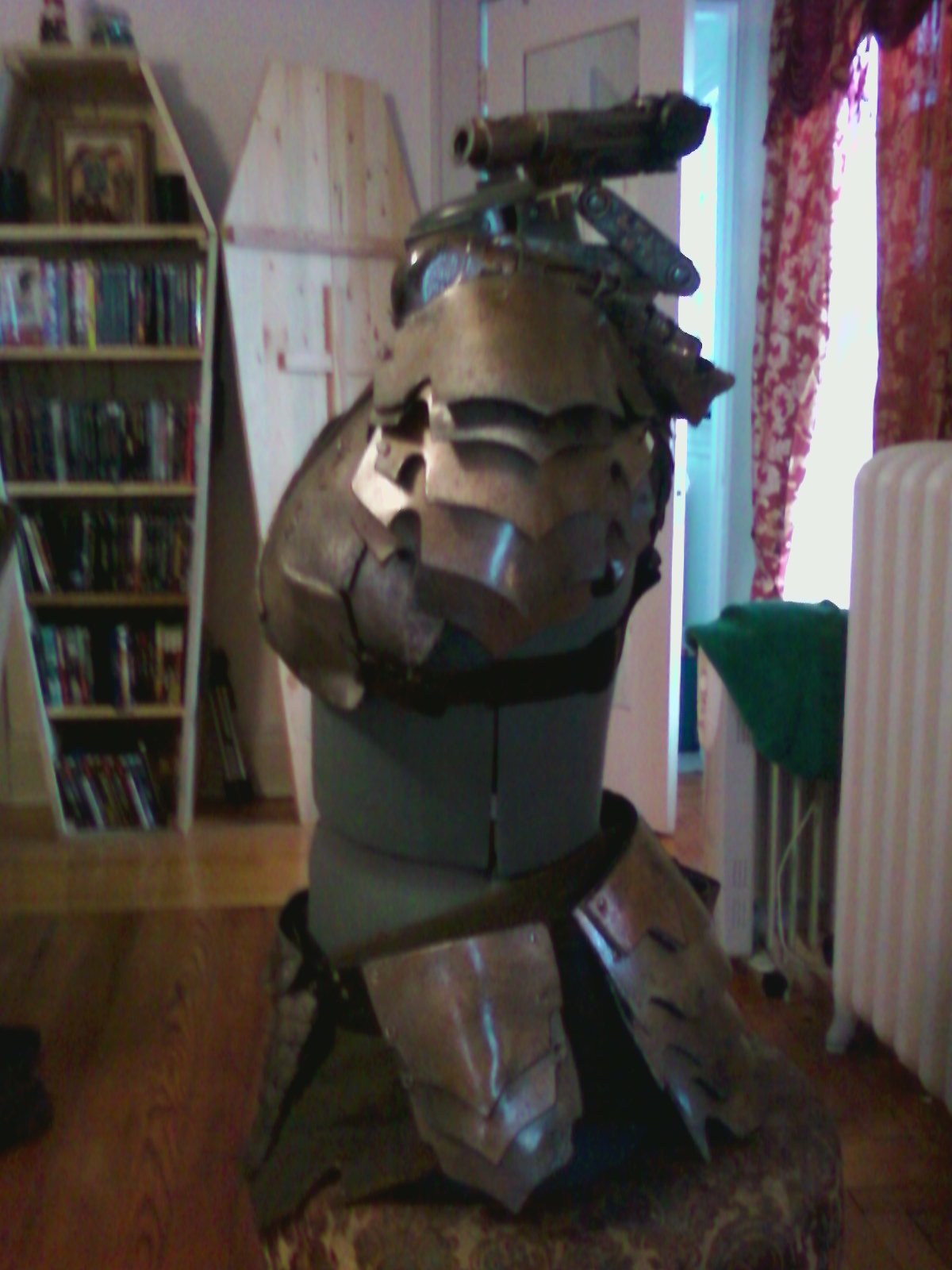

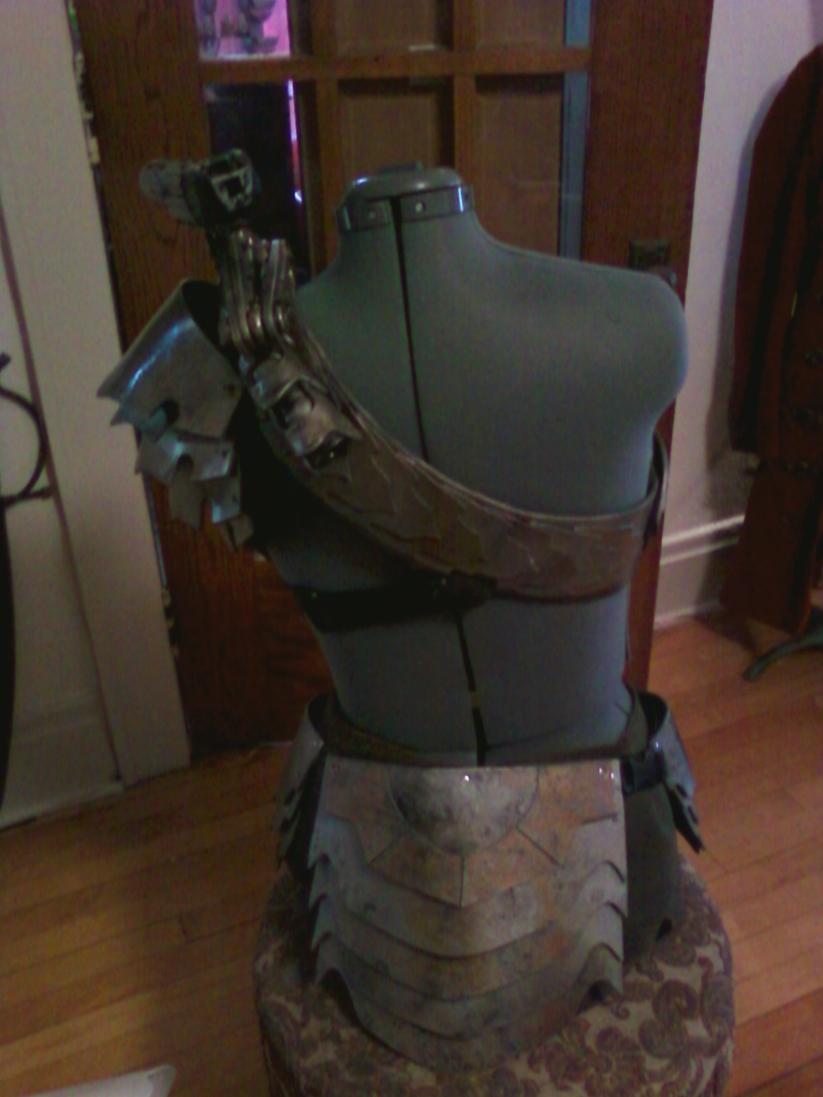

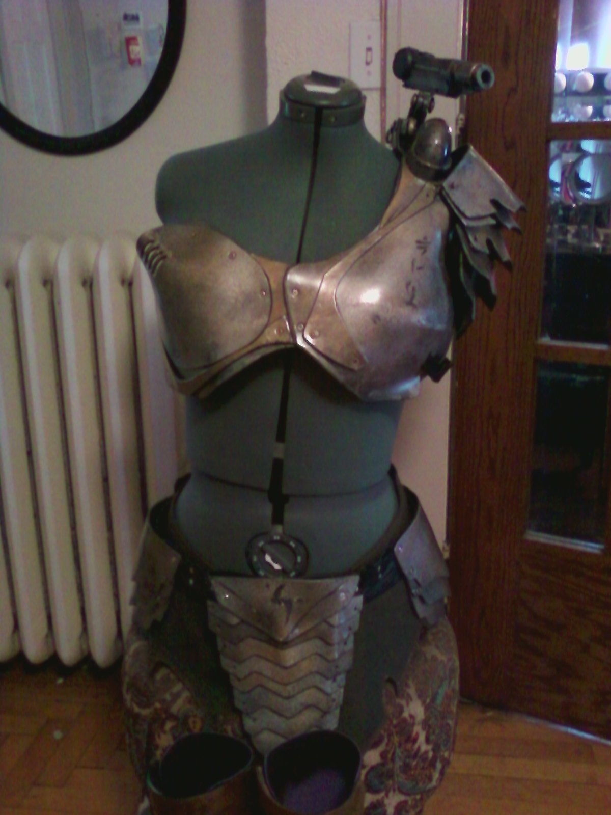

Long time lurker, here. I've been working slowly on a femalr pred costume for myself, and am finally @ the point where I've made enough progress to share.
The armour was made with templates from VinMan (TY!), the bio is from Mysteria. The rest is from scratch. I was inspired by a few of the female preds I've seen here on the forum, but then took it in my own direction.
I'm working @ being a human huntress, so i won't be using a mask, and I've used natural hair instead of dreads due to this. Also, I won't have a "crazy" skin... I'll be using a flesh-coloured lycra body suit, lightly painted for texture, with a body net.

It's a good looking suit you got there, is the armor made out of resin?
Awesome paintjob and thanks for sharing, sharing is caring, and gives the rest of us more ideas :)

The armour is made out of Sintra. I got that tip from VinMan, as well. It is ultra easy to cut and mold, and looks fantastic once painted.

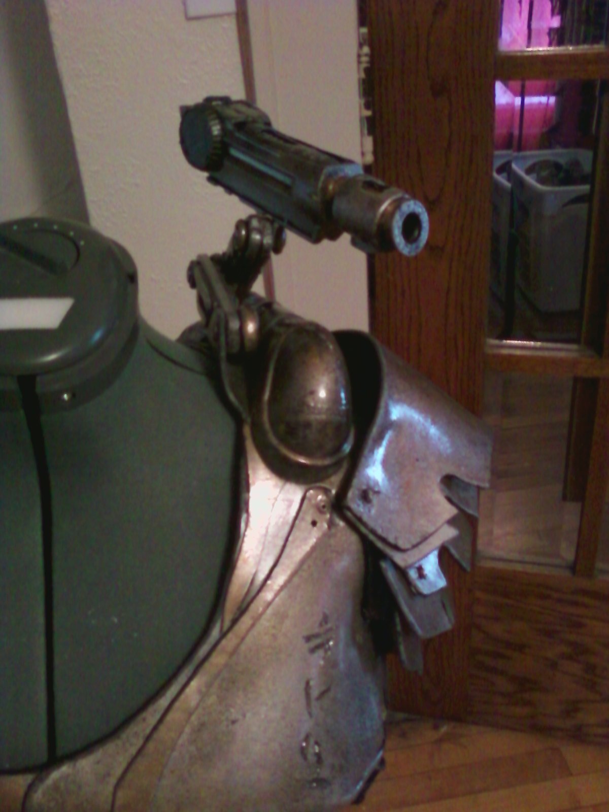

I'm also working on a retractable spear that can fold down to about 14 inches, which will attach to a thigh platform

your paintwork is really nice on that armour. i like how you did your own style for the chest piece. very cool looking.
kudos to you!

The paintup turned out easier than I had thought it would be. I coated all pieces first in black. Then, I lightly sponged on some "hammered metal" silver; not taking much care with it. I wanted a random sponge pattern of the silver. I didn't cover the black completely... Instead, I let areas of it remain.
Then, while it was still tacky, I misted over all with silver. This gave a sort of "flecked" effect, ad the black areas where now dusted with silver, and the sponged areas looked like metal flakes.
Next, I sponged on some hammered metal bronze, in the same manner ad the silver.
Finally, as this layer was tacky, I dprayed VERY lightly with some black; more like small splotches. This gave me a pitted metal effect.
I dry-brushed some black lightly around details for depth, then coated it all with a clear laquer.
