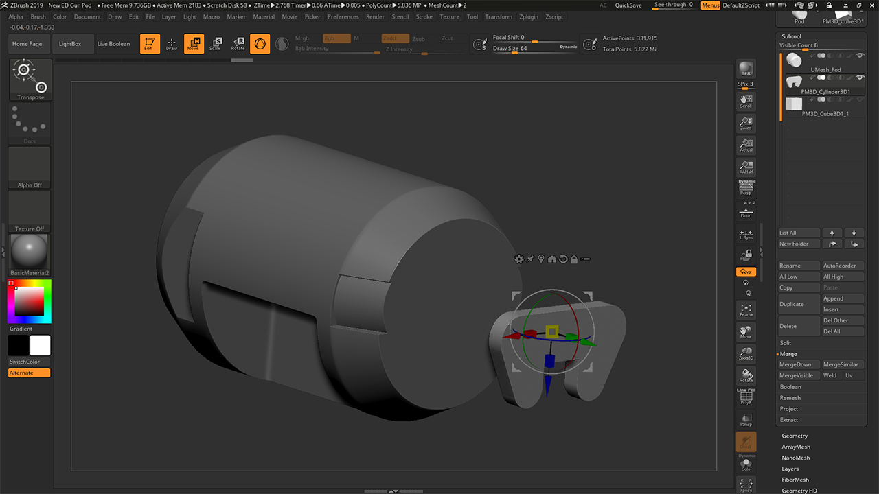

My process for sculpting ED was really quite janky to be honest. I relied on a function called Live Booleans to basically cutaway at geometry to achieve the shapes that I wanted. It was also crucial to look at a part and envision it as a simple shape that I could build upon. So for example, the foundation of the mouth/jaw area is just an elongated sphere (picture an egg laid longways) sliced in half. With just that basic shape you can start to cutaway some of the larger landmarks, like a trapezoid for the mouth, and continue to build from there. Does that make any sense? I'm not very good at teaching!
Attached are some photos of the live boolean feature:
So basically you took an organic approach baa-dumtish (sorry)... No that makes plenty sense. I half expected it to be way more convoluted or involved if you know what I mean? So all the little pistons and moving parts where booleans as well? I don't have Zbrush, only the free version - does it have any sort of assembly mode, like adding joints or rigging?

Yeah, all of the keying and moving parts were achieved through booleans. So another example, for a piston you would take a cylinder, duplicate it but shrink it down maybe 25%, then just subtract/cutaway from the larger cylinder while both shapes are overlapped. That's pretty much the gist of keying in ZBrush. It get slightly more complicated when you account for tolerances (do I want this joint to be super tight or loose?), but you get a feel for it over time. ZBrush does have rigging, but I don't know how to do it yet. There's still a lot for me to learn!

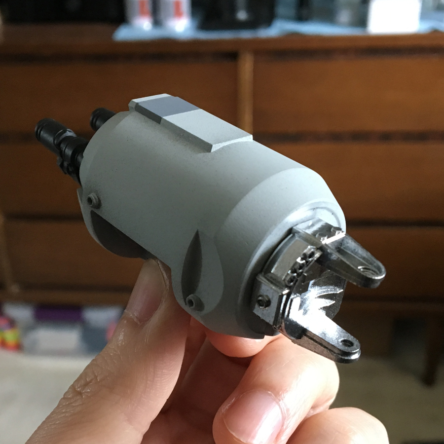

Always loved Ed209... I had a toy ED209 with a capgun snapper in its back... Apart from the snapper, it was prolly the most accurate toy ED going :D

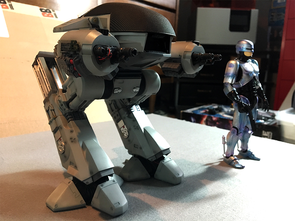

So you have made an exceptional ED-209 and are showing it off on The RPF...... I hope you've made enough for EVERYBODY!?!?
Seriously though this is incredible, I cannot believe the quality and resolution of those prints. Mind blowing.
