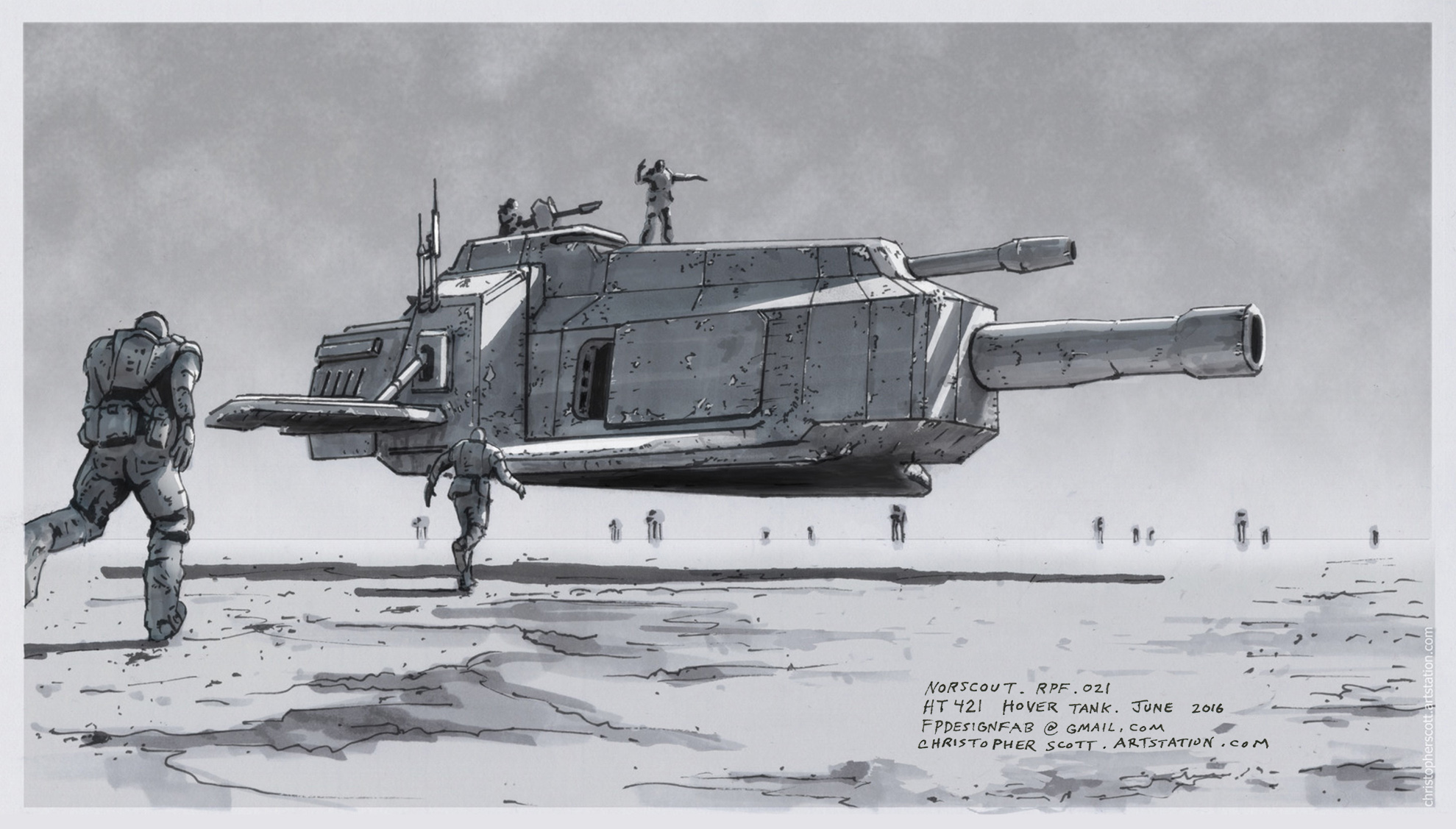

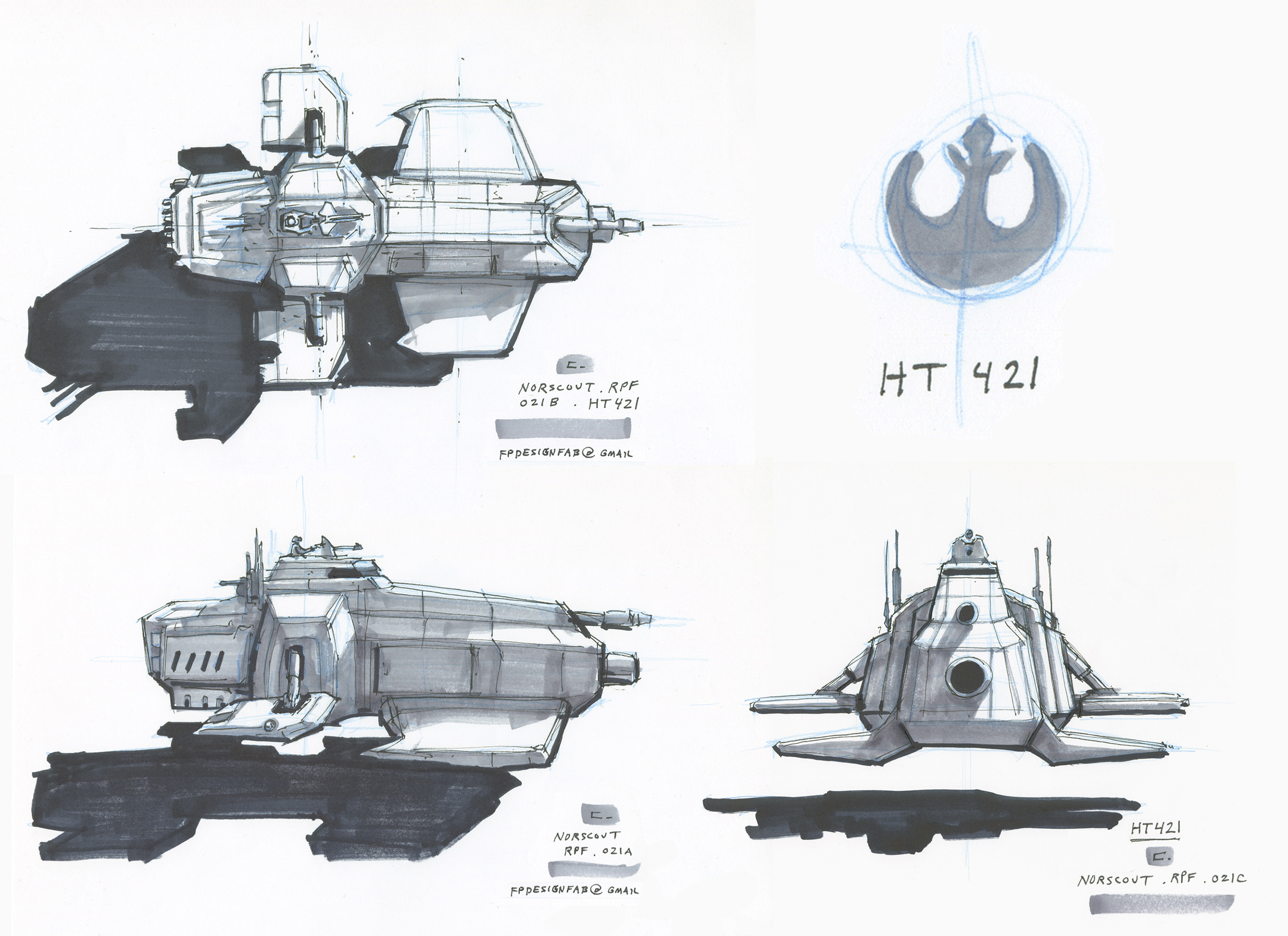

Model makers, I've been wanting to build a model of my HT421 Hover Tank I designed nearly a decade ago. I may have time to start a build this summer and want to see if any of you awesome Star Wars replica model makers may be interested in helping me develop this hover tank concept into a detailed & well defined scale model?
I'm inspired by the amazing SW replica work on here & all the ILM models but I'm more a concept modeler and like building models of my designs. It'd be fun to work on a team build again, it's been awhile. Here's what I'm thinking:

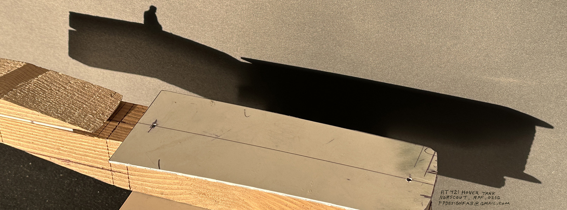

I'm working on blocking out the main shapes, dimensioning and designing the internal structure. I could just 3D model this entire thing and print it all, but that's not as fun. I want and need a freestyle scratch build project to get me off of computers and back hand building in the shop! Plus I don't own a 3D printer yet. Styrene, brass or plastic tube & some kit parts should work well.
I'm looking to keep it simple, loose, fast & fun.

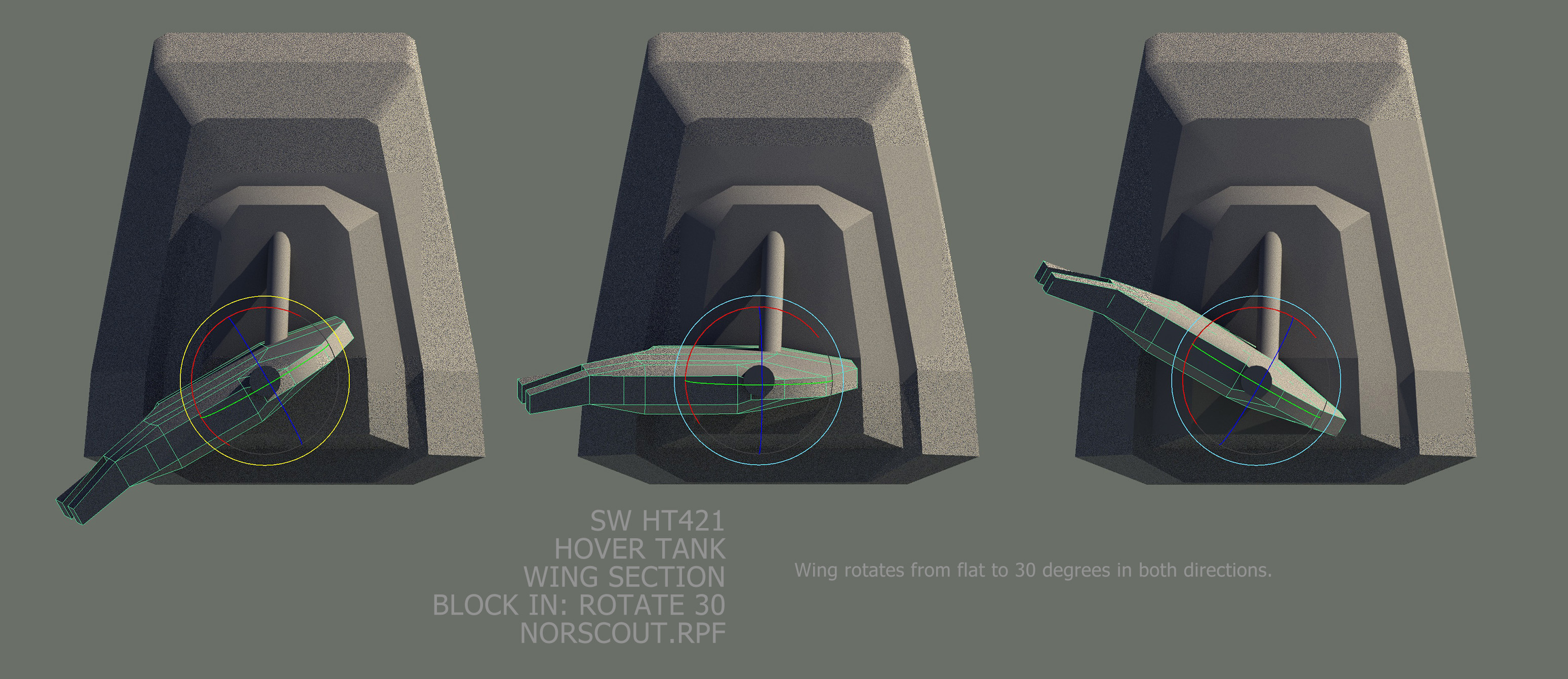

Here are the basic dimensions for the wing section from my block in (in inches with way too many decimal points). The entire wing sub-assembly will be mirrored for the other side.
This is just a rough block in guide, final parts need to fit close to this. Are you up for detail designing this wing assembly section..?

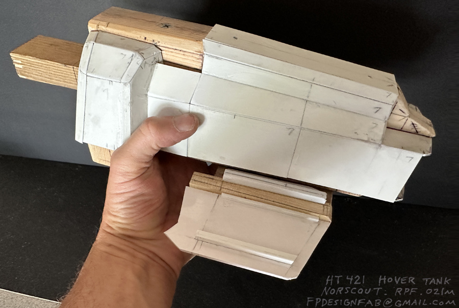

HT WIP: Armature & front wing structure complete. Final ribs, spars and armor plating in the works...
Next up - Armament attachments, top cockpit & rear wing assembly.
HT421's are intended to be hand fabricated vehicles by a few people in a shop, not mass produced factory assembly line machines.
Scratch building using all hand tools only at 1/48th scale can look a bit rough up close but it will all work out after some putty, sanding and battle damage.
Twice the scale might make a better build, but takes up twice the space!

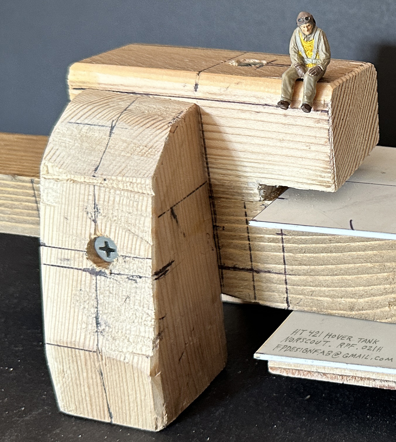

Kinda ridiculous actually: cutting 4” long scrap 2x2’s under foot with a jigsaw. The guide bar was scraping on my shoe on the final cuts.
The jigsaw blade bends on thick material so I made sure to cut them so the slight cut angle goes forward on both sides. I got them a bit flatter on the sanding block and will adjust the plating as needed. They work fine as foundational blocks. Glued & screwed & Done.
