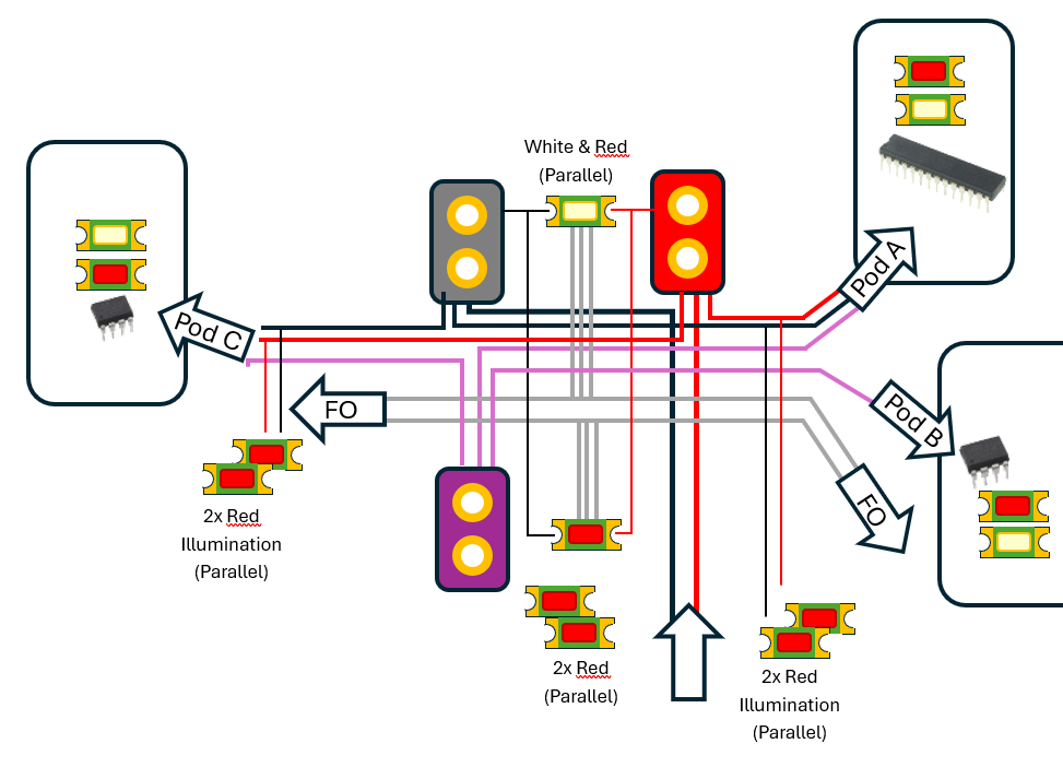

Here the lighting plan for the Habitat Pods and the wiring plan for the Centrifugal section.
Lighting the pods themselves will not be that hard (once (+) and (-) are there), the challenge will be getting the light points that are on the Centrifugal section in the limited amount of space. For this,I pre-printed a couple passageways to route cables through, but I am using my dremmel to channel out little "compartments" to bury the LEDs in and create any channels that are still needed.

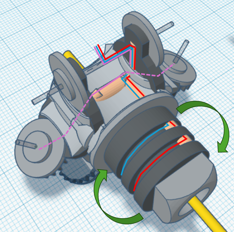

This picture from an earlier post shows the pre-printed channels (skin colored) and a very generic wiring plan
That was the general plan... here is the more complete wiring:
The purple lines are a channel from the ATmega in Pod A for the blinking navigation lights, which needs to be in sync with all three pods. The grey lines are 0.5mm fiber optic for the little red and white lights on the centrifugal section. This is to reduce the amount of LEDs needed (and the power consumption). Lastly the LEDs marked as "Illumination" are LEDs that will be placed in a tiny pipe to direct the red light up onto the centrifugal pivoting mechanism like a spotlight illumination. For these I will need to do a few tests to see where the best placement is.
The purple lines are a channel from the ATmega in Pod A for the blinking navigation lights, which needs to be in sync with all three pods. The grey lines are 0.5mm fiber optic for the little red and white lights on the centrifugal section. This is to reduce the amount of LEDs needed (and the power consumption). Lastly the LEDs marked as "Illumination" are LEDs that will be placed in a tiny pipe to direct the red light up onto the centrifugal pivoting mechanism like a spot light illumination.
That's what I called DETAILLED!:p:p:cool::cool:(y)(y):love::love::notworthy::notworthy:
