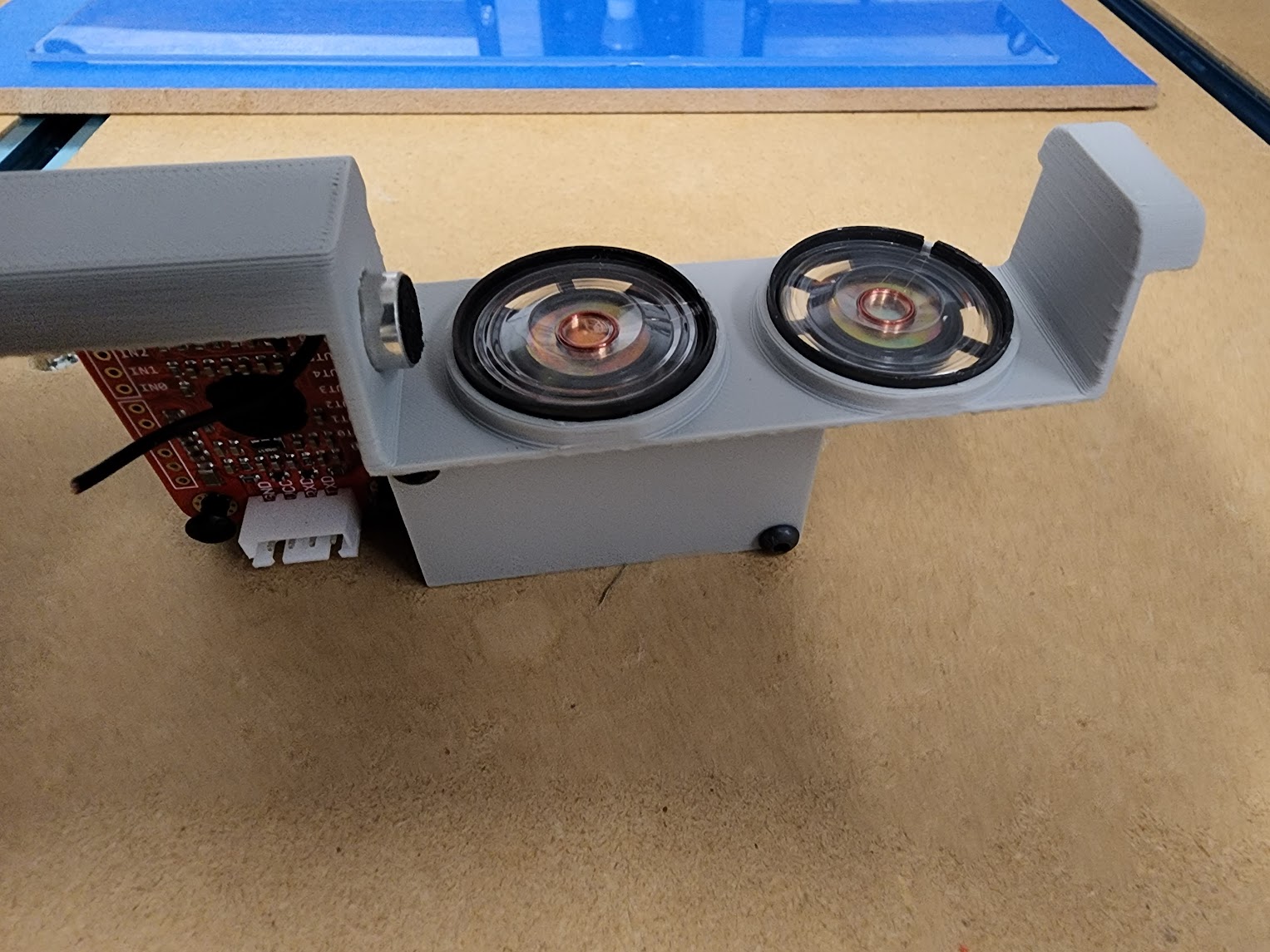

I'm working on some upgrades to the main model and I'm just testing them. The sound is now 10x better and the electronics are easily serviceable. If you've already printed the original model there's 2 cuts under the top cover you'll have to make to fit the new part but they're unnoticeable after the cover is back on. I'll post a pic tomorrow when I have it nailed down, I'm on the 3rd iteration since there's so many little things to get right. It'll also have multiple versions of the new part to accept most common lightsaber speakers so no more goofy top speaker required anymore!

I've added speaker mounts for 3 common speakers in single and dual config 28.5mm, 28mm, 26.5mm
Sure, I made 2 hoslter models. Just have to get some kydex to CNC for the drop leg version since it needs to be flexible.
edit: new speaker mount now has 5 variations uploaded to thingiverse source, if you have any wacky speaker under 28mm you ant to use that's not listed there just DM me and I'll include it, just takes a min.

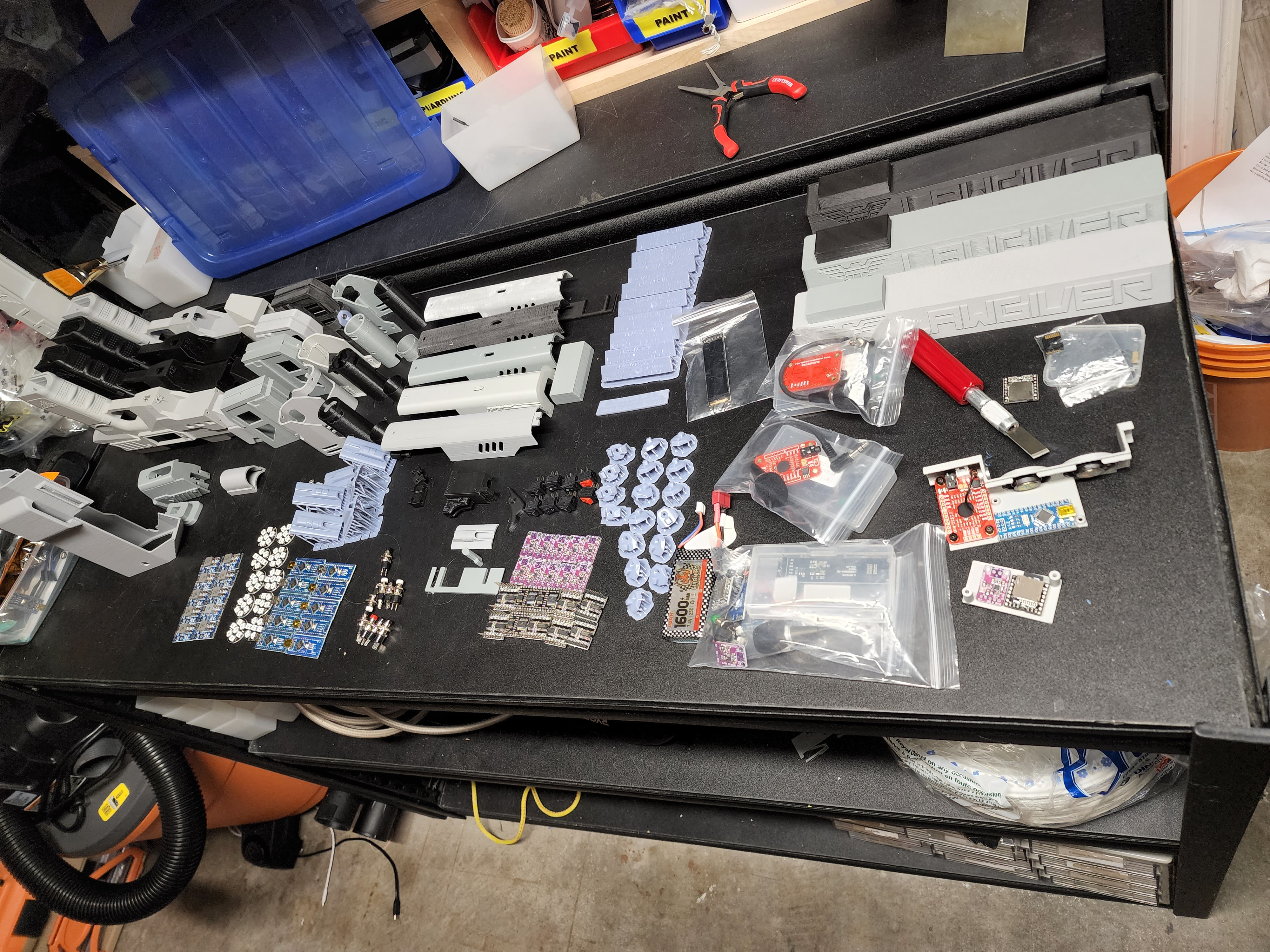

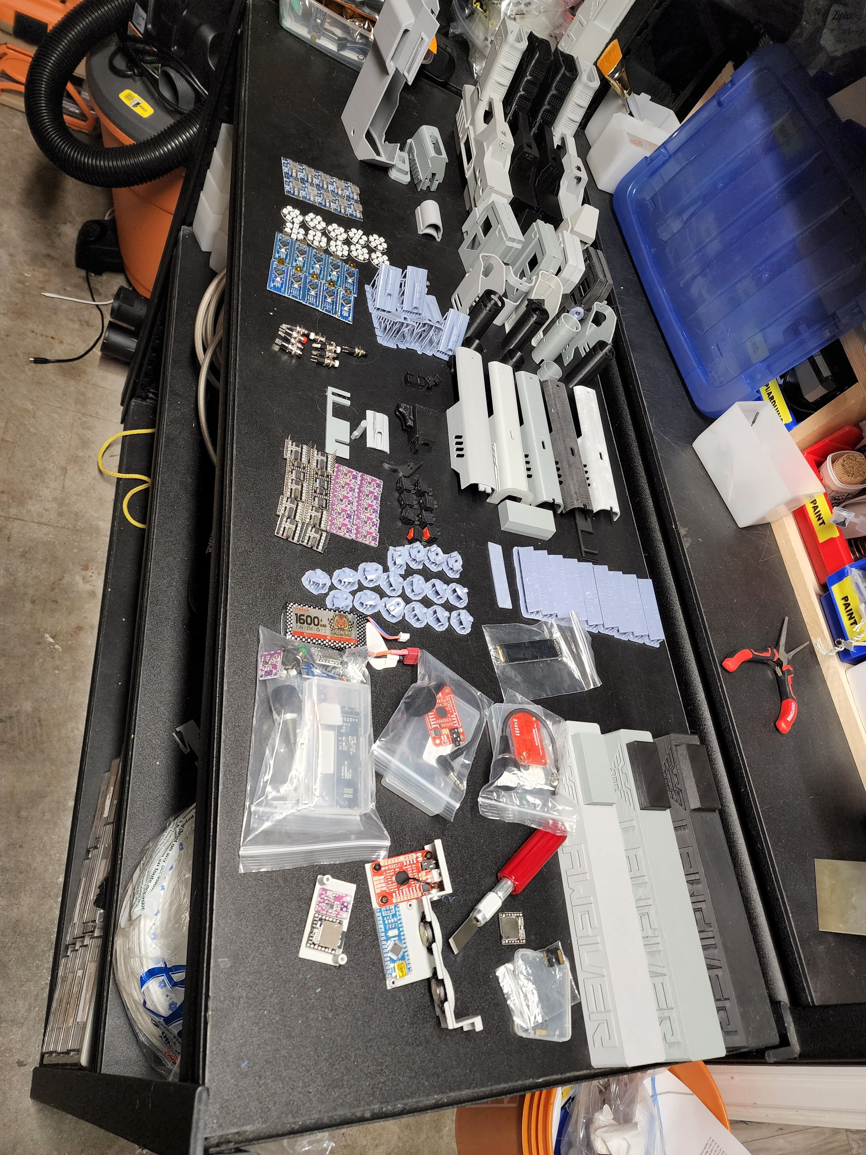

I will be posting a small run AFTER the final build is done. I'm printing it now and configuring the new wiring harness so I'll be posting about it as I go, sorta what this thread is for :p.
When the final demo is done, we'll post a run of 15:
- 8 made by me, the modeler
- 4 made by Spidey74, who wrote the code

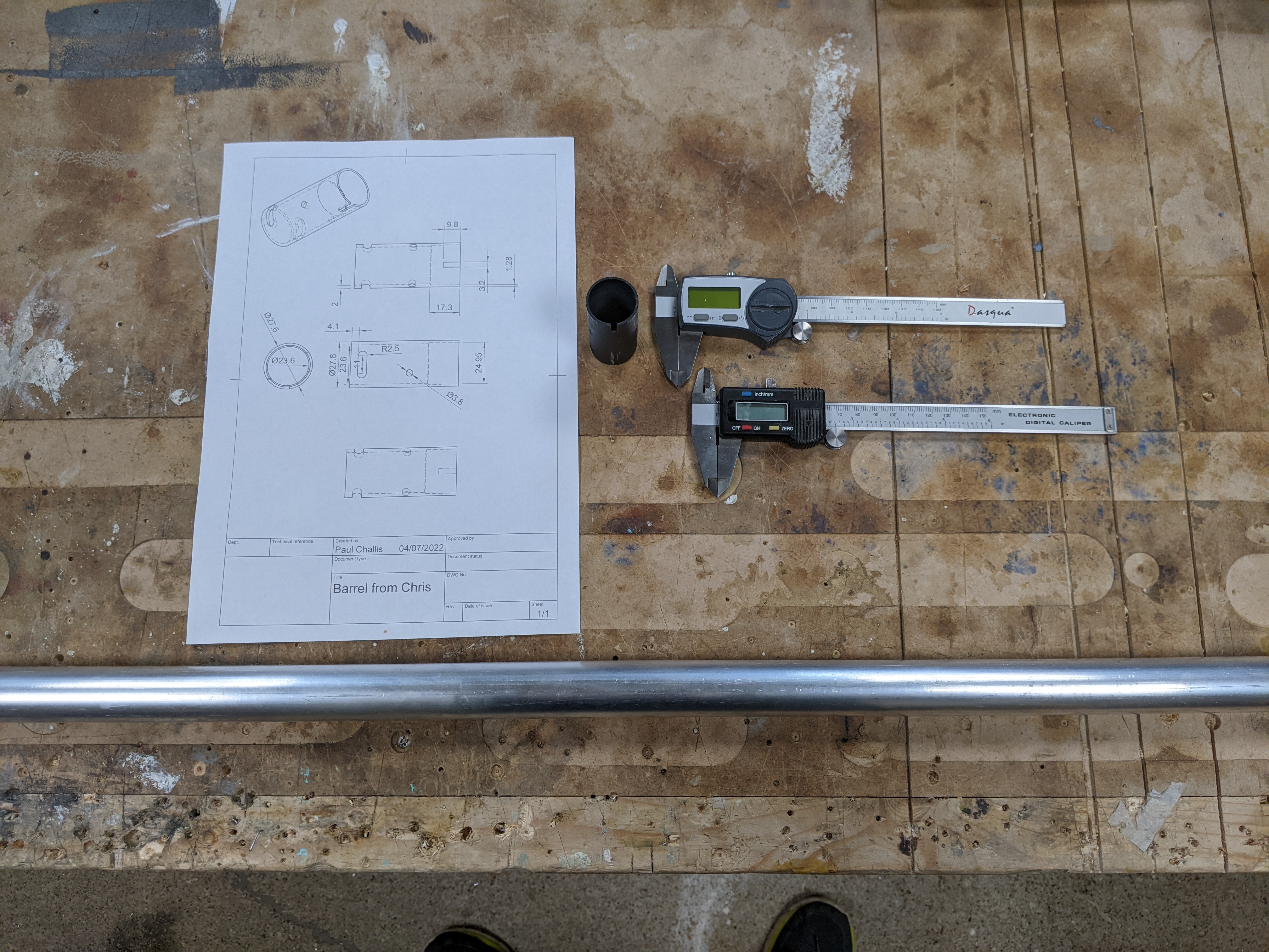

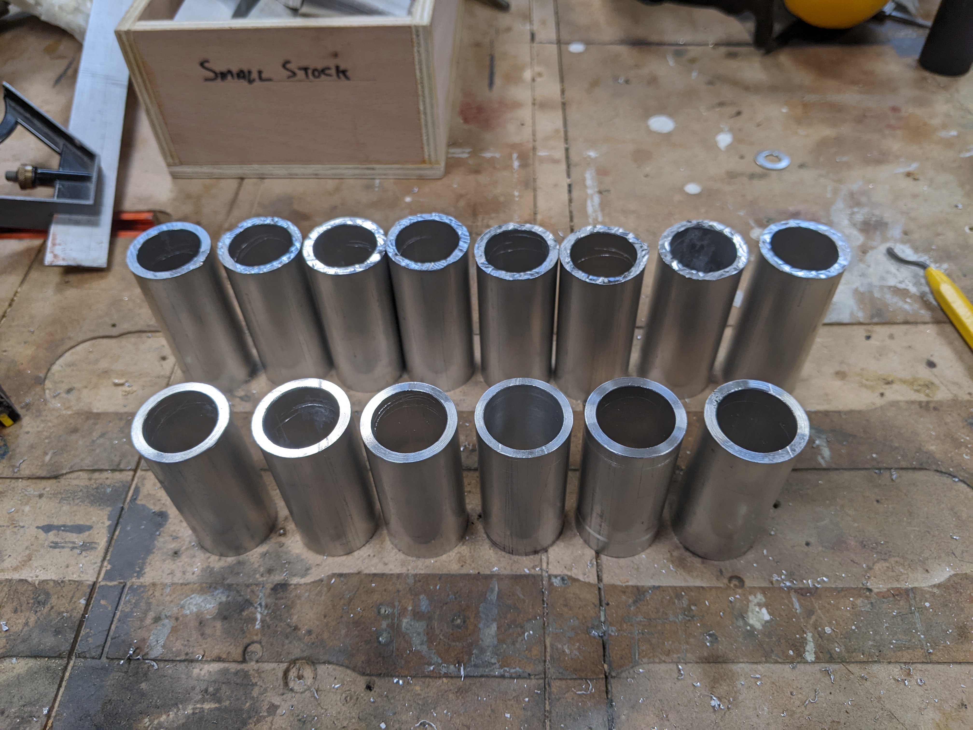

- 3 by beakz who's made contributions to the design of the electronics harness and will be lathing and CNC cutting metal barrels and triggers for our personal ones as well as for all 15 in the run
Anyone who's DM'd has a place in line, please no more DMs. I don't want to turn anyone away so what's received is the queue and will be given dibs.
I'm making 2 Lawgivers to finalize this model and make sure it's all 100%, they're printing now and I'll start build pics in a few days. When that's done I'm going to release a set of 3 videos on my youtube channel https://www.youtube.com/c/Props3D:
1. Intro/overview/features/assembly
2. Coding the VR with your voice, soldering the components
3. Paint and finish
Since all the files can be printed FDM and can be soldered without any wacky gear, anyone with a printer and a soldering iron should be able to follow the guides and successfully build one from the videos.

This is the new caddy pre-soldering, it's 100X easier to deal with:
