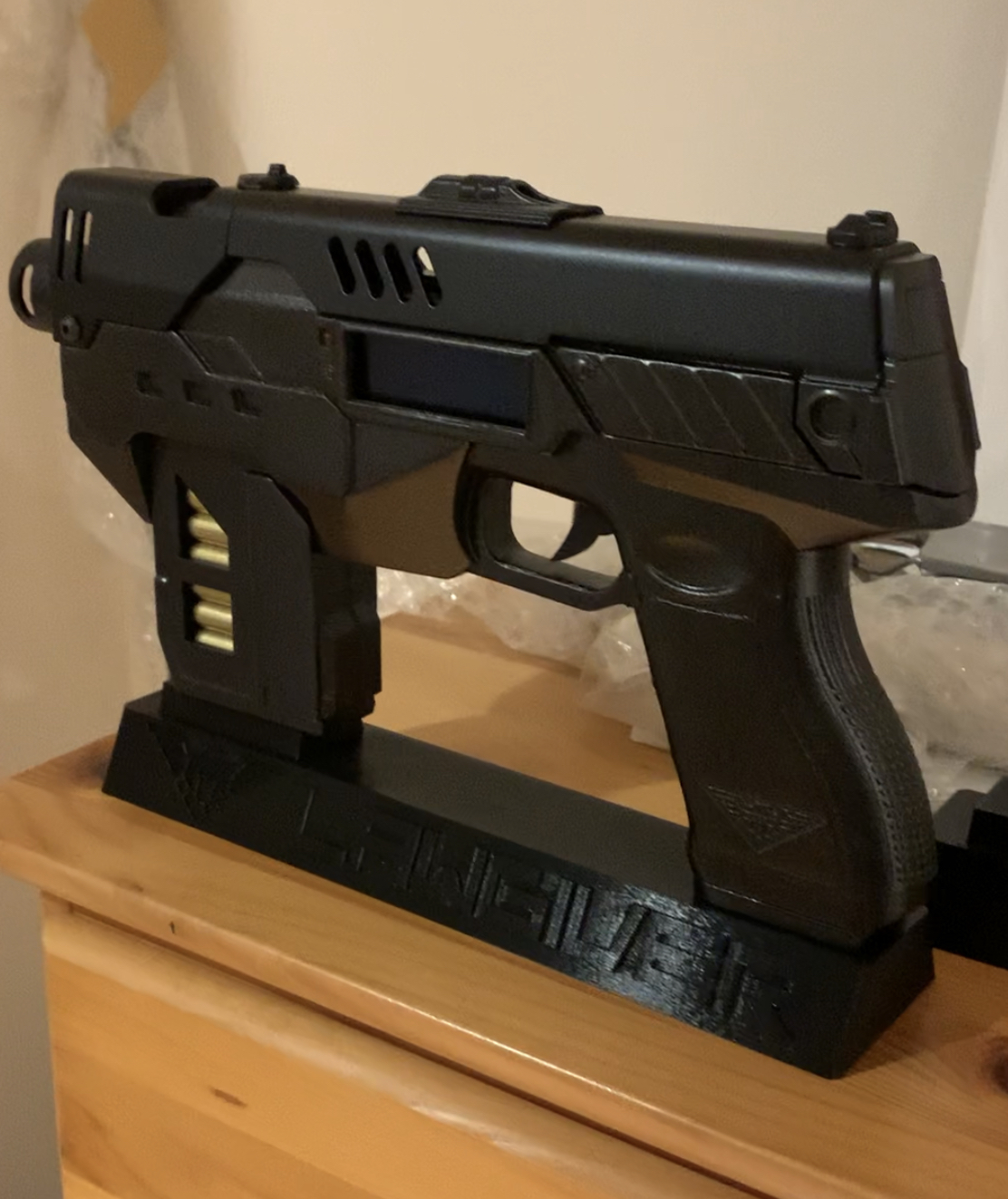

Finally assembled the whole thing. Made a few modifications to the wiring, removing two connectors to make a little extra room to fit everything.

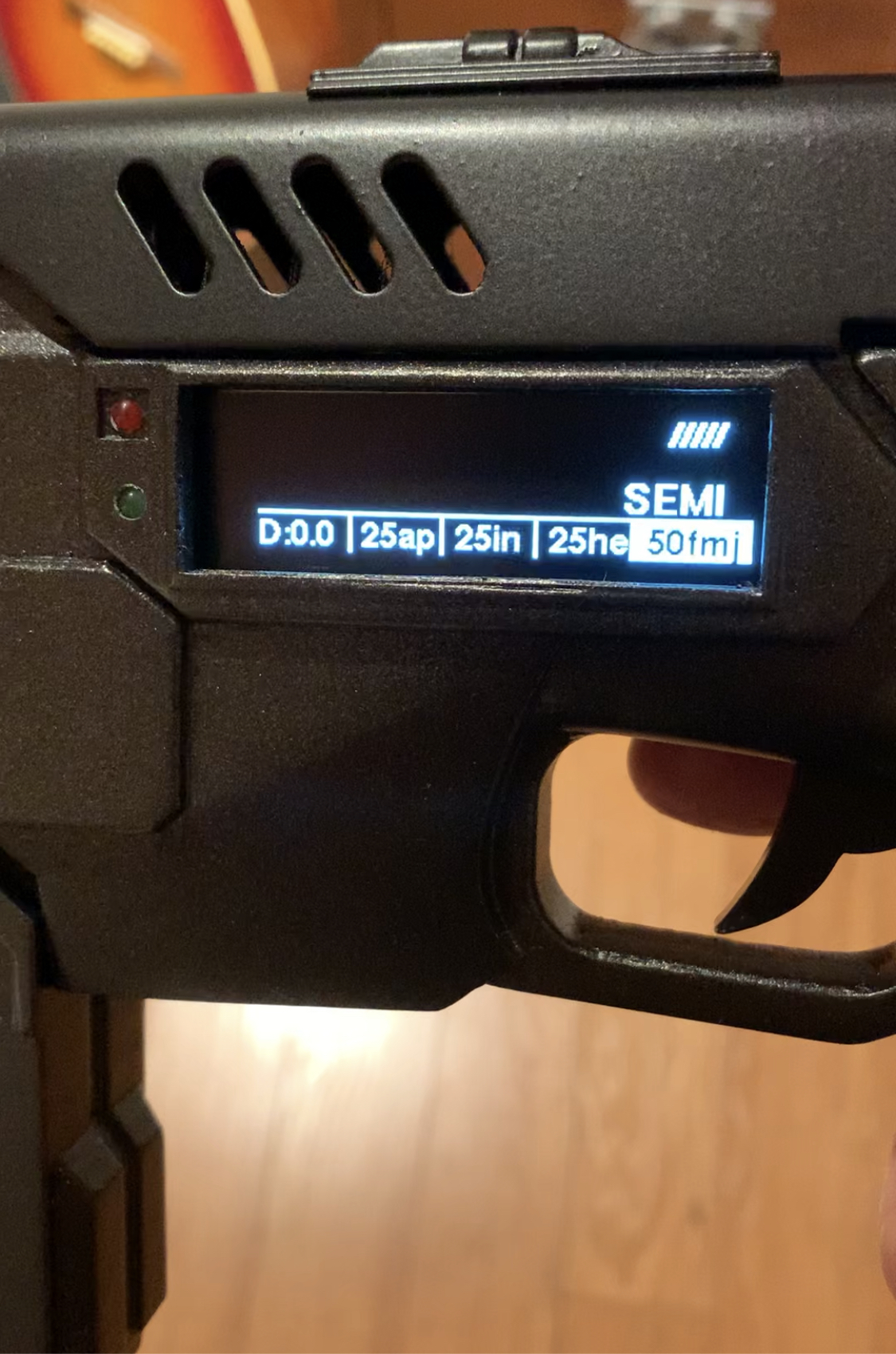

I’ve found that the voice recognition does not work as well as I want once it was assembled. Some commands always work, where some not at all.
I believe it’s the noisy OLED interfering with the VR processing. I’m spending more time to try and reduce or dampen the interference. Have some ideas I’m still testing out. When I get some results I’ll post back here.
