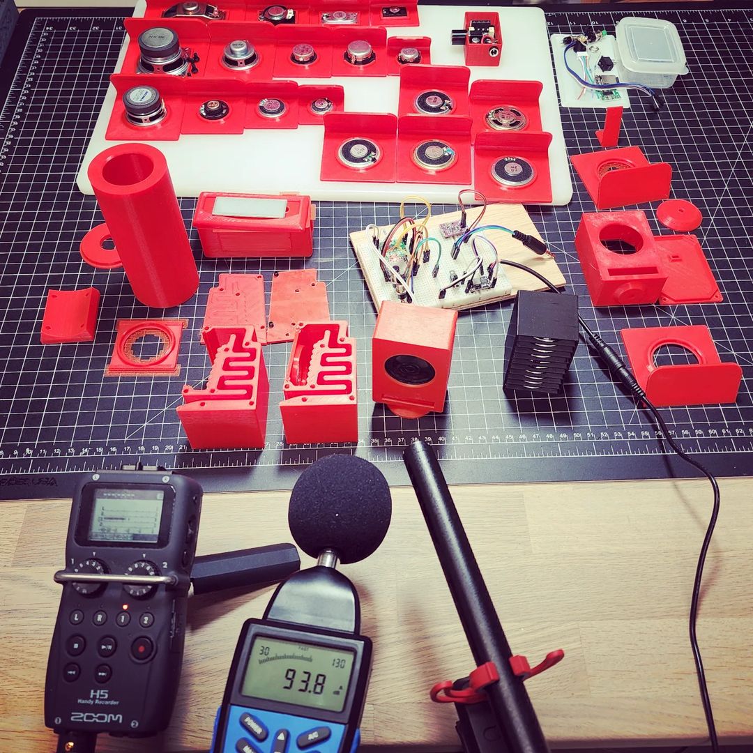

The hang up right now is audio. Everything works great, there's 4 community builds on the Props 3D discord that all seem to have gone smoothly, but the audio is really quiet on all of them.
It's using the same amp and mp3 as my other props that reach 100db+ so it's either the speaker or goofy speaker mounting. This has cropped up on a few models and I'm tired of guessing. The DFplayermini and pam8302 have been tested and are not the issue, they max out all of these speakers. So it's the enclosure, the speaker I picked, or a combo of the two.
So I'm testing all the potential speakers and some demo enclosures I made separately first:
After this is solved I'll do the run along with the video, but right now sounding in at 73db and that's pfffttt ;)

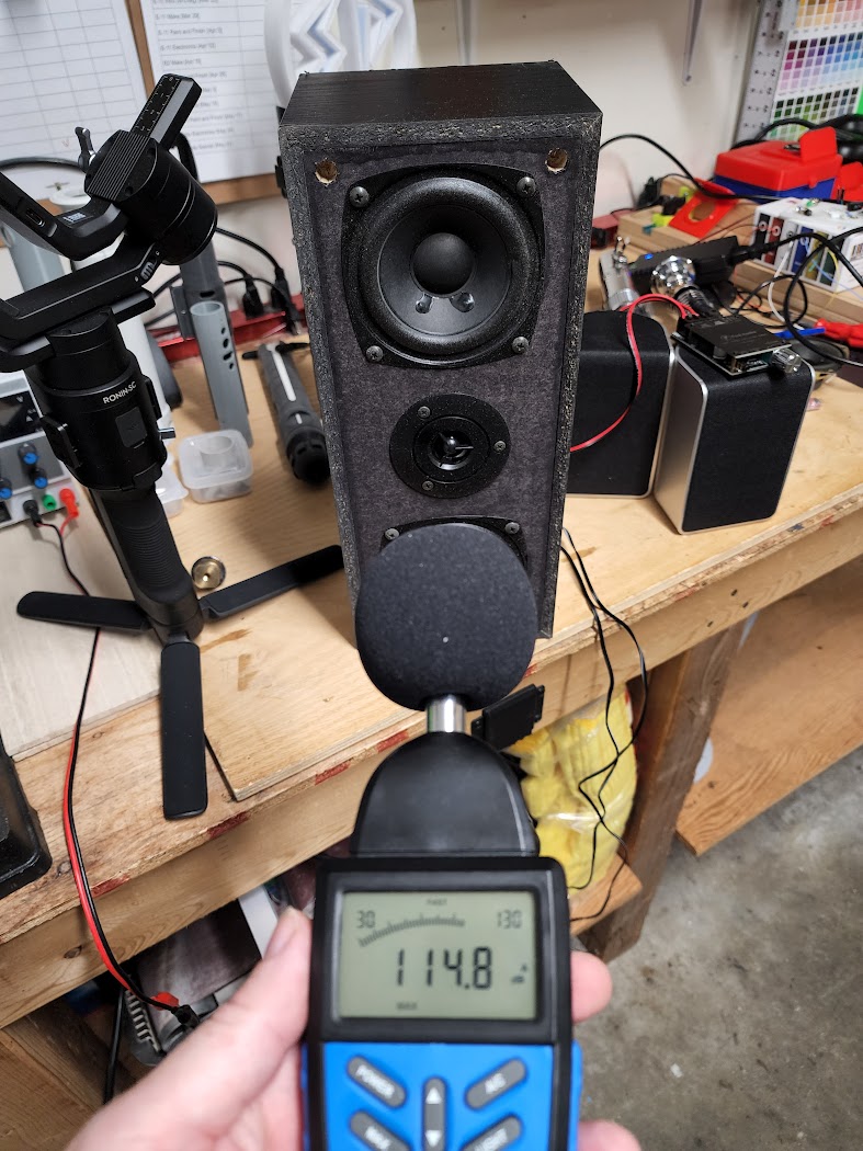

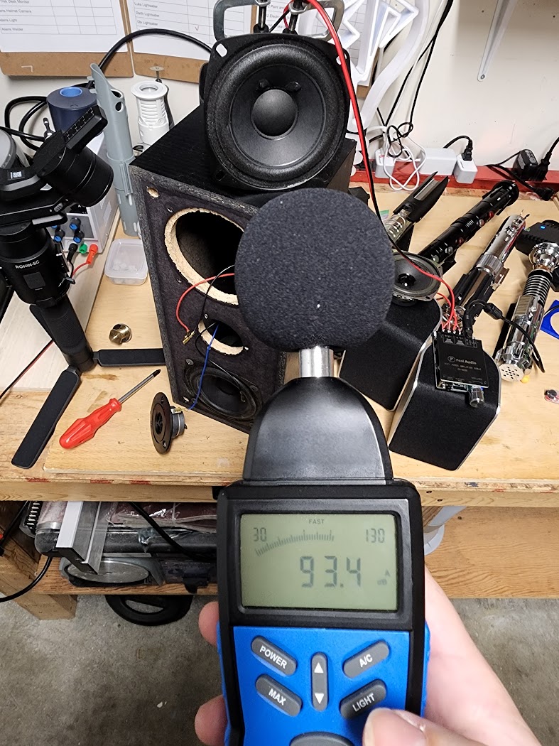

Here's an interesting shot over the bow of this problem: Took the same Kenwood and tested the sound level put together and with the speaker out. 20db change. That's a factor of 100 on the db scale!
So it looks like the enclosure may matter more than the speaker itself, can't wait to dig into this proper...
