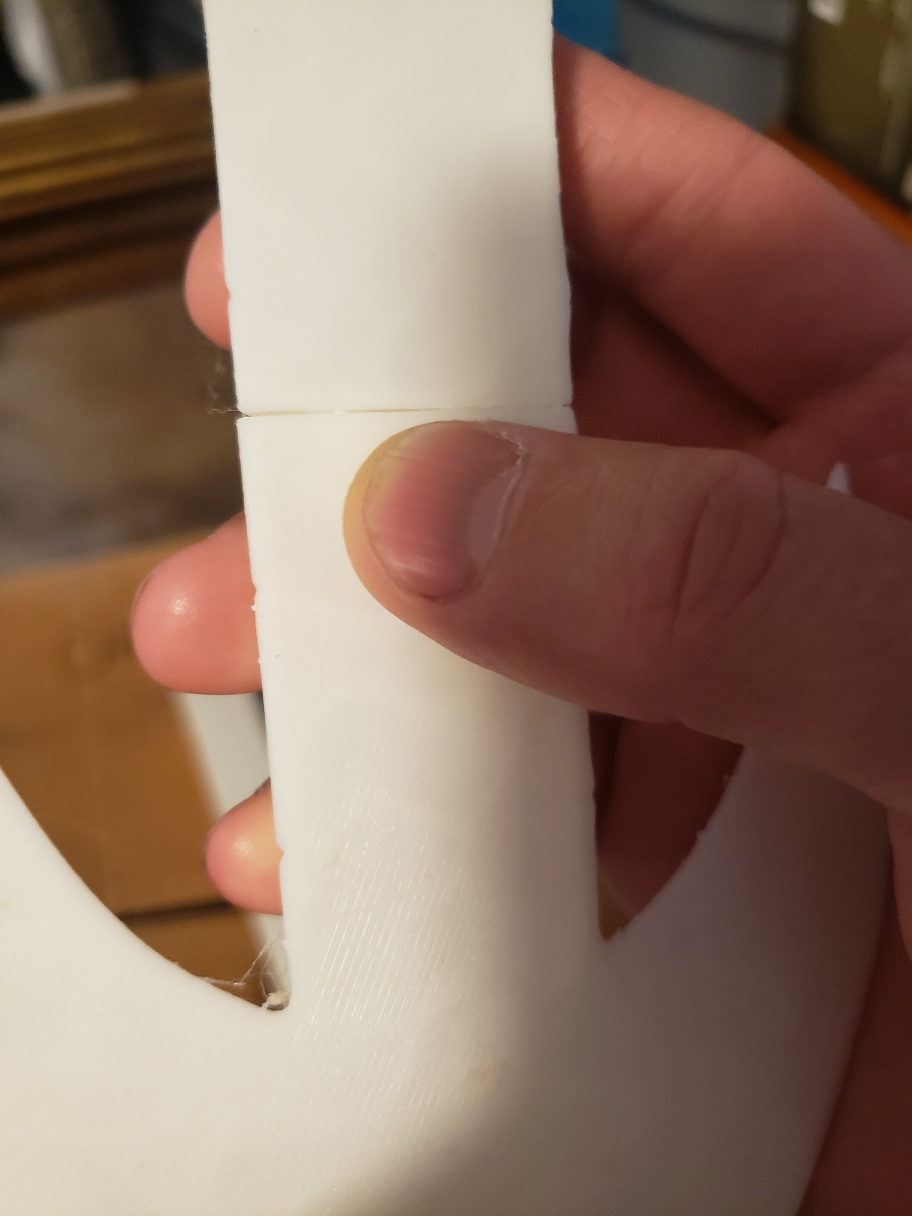

Looking nifty greenmachines...saying that, I don't like large surfaces to be glued together (especially with CA glue). You really need to come sharp and clean putting those two parts together:eek:
I feel the same way. My plan is to make the edges negative and back fill the gap that results. The centers will be touching but not the hair thin edges. These are the locations (bottom first, then edges) that elephant foot / mushroom and cause uneven matching. Removing that little hair thickness line on all matching edges will allow a tight fit.
I have plenty to practice with so I may very well try adding vertical splines (threaded plastic rod or filament). I am going to use this one as my test bed for long print objects.

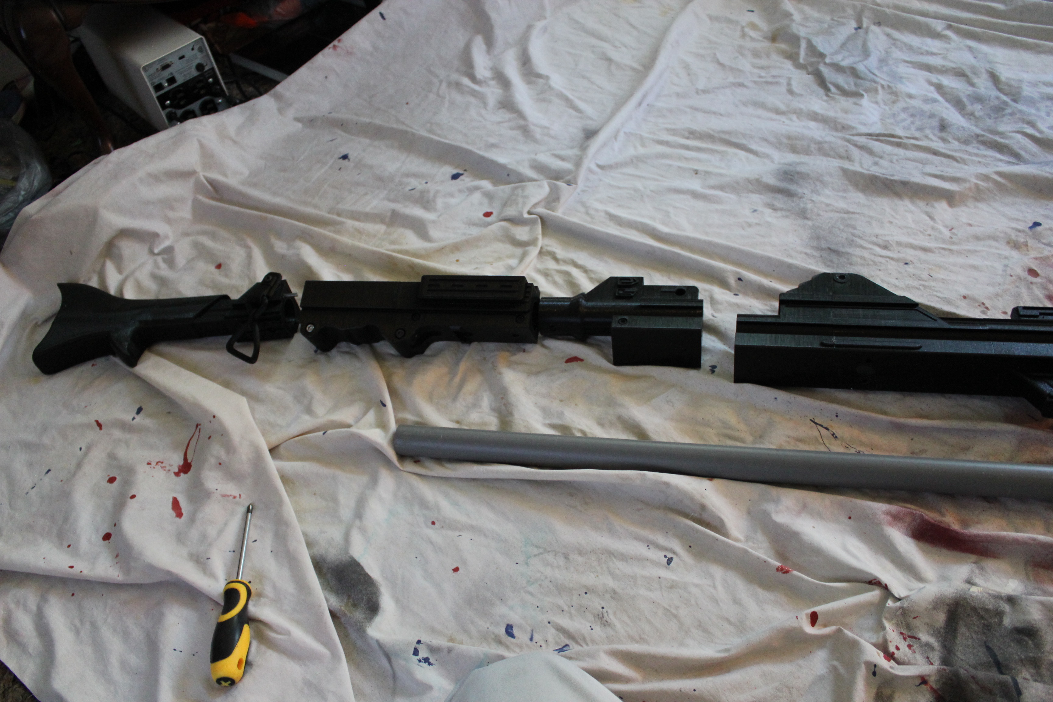

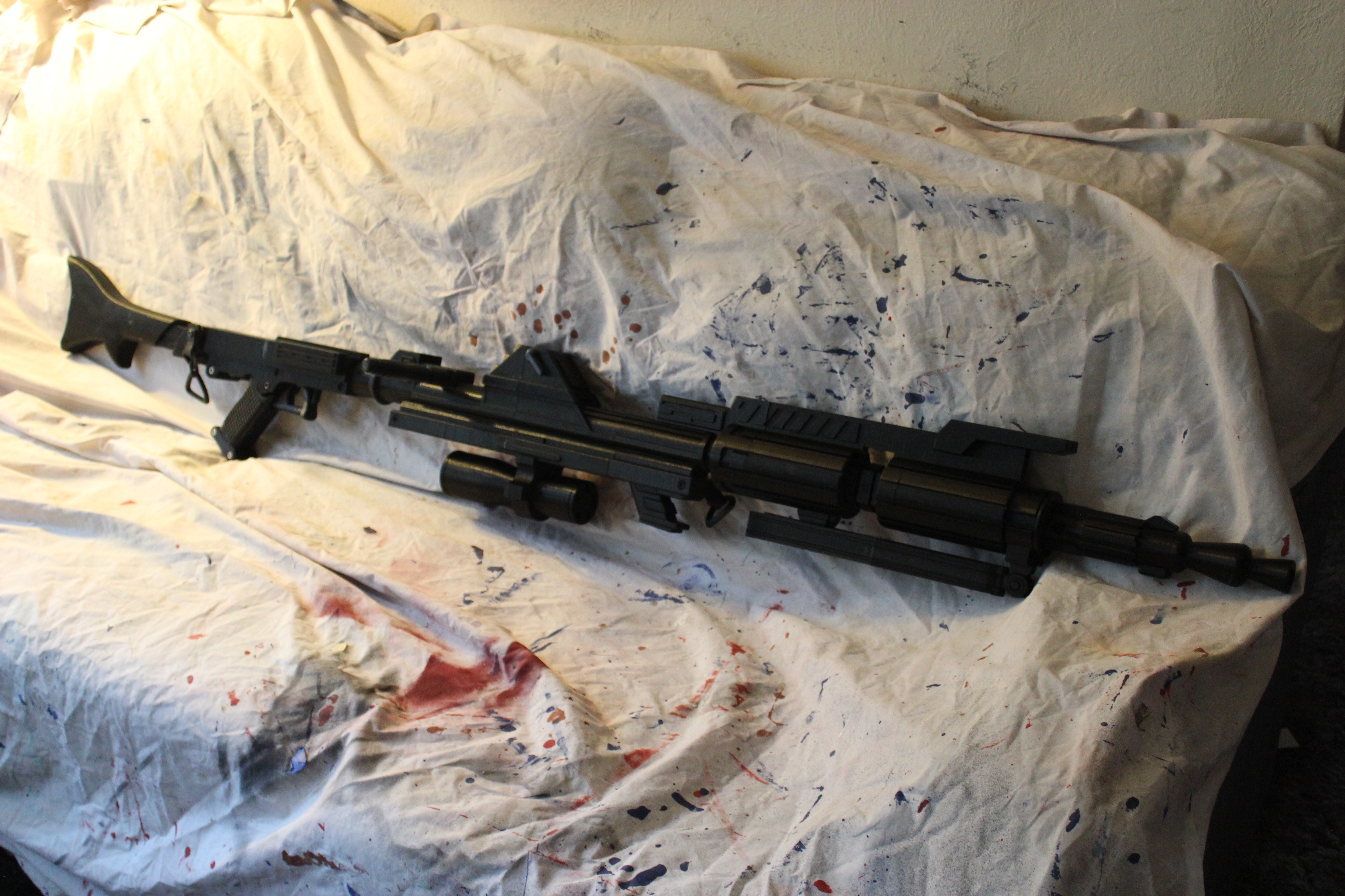

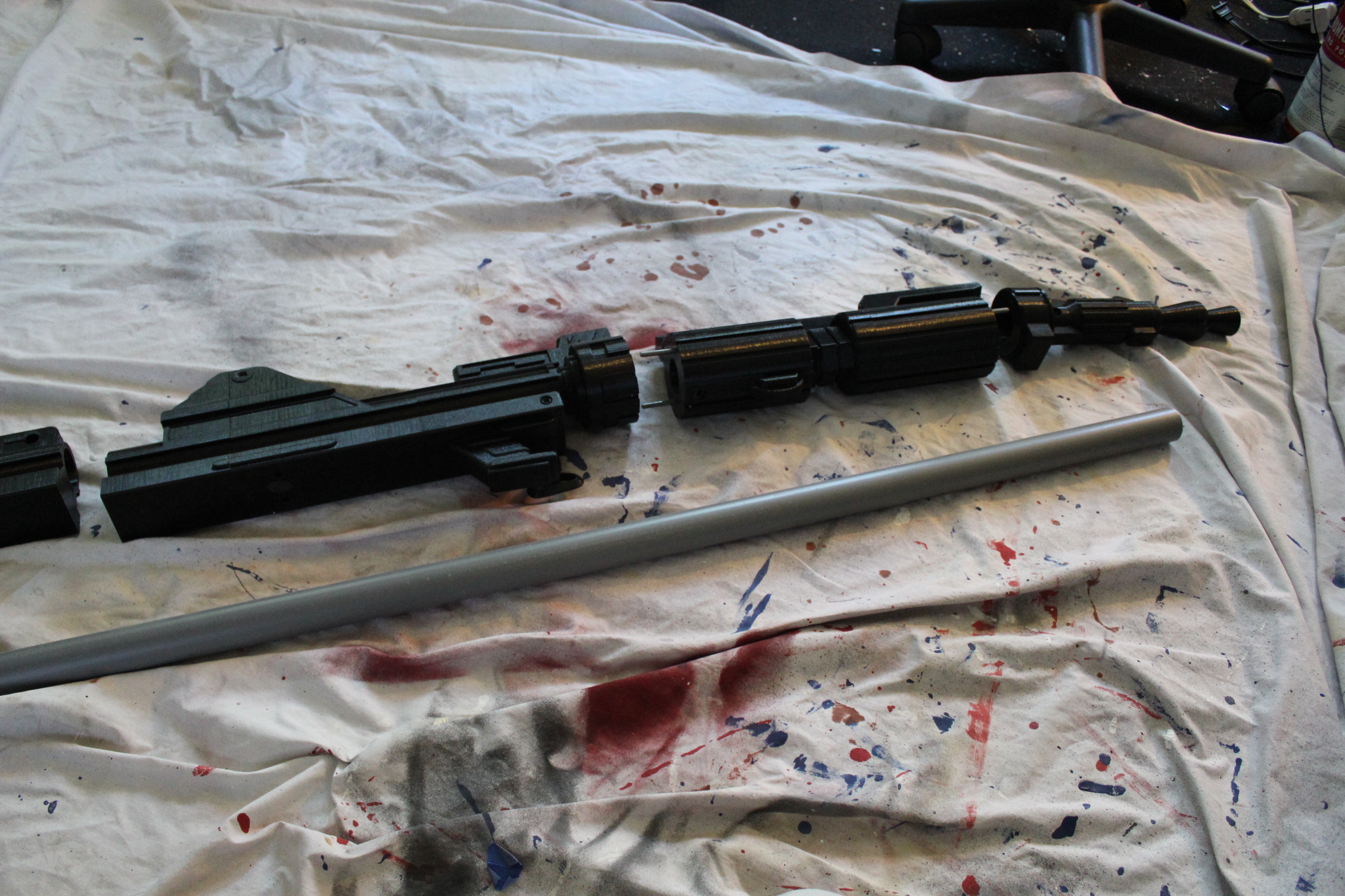

Now I am seeing the serious level of work that goes into print ready stl. I bought a blaster print from Buissonland and it was so prepped for prop makers that it had each material type separated. Wood handles, blaster body, flash hider, all separated so I can prep and paint each material type. The flash hider and barrel were so well designed as to allow me to just thread the two together using the threads already in the print. Separating this trident but still allowing for some alignment slots, minimal supports and scarring and with support rod holes....... not simple. Finding a great designer is like finding your favorite model kit company.
The elysium rifle from scornflake is that way, made for prop makers
