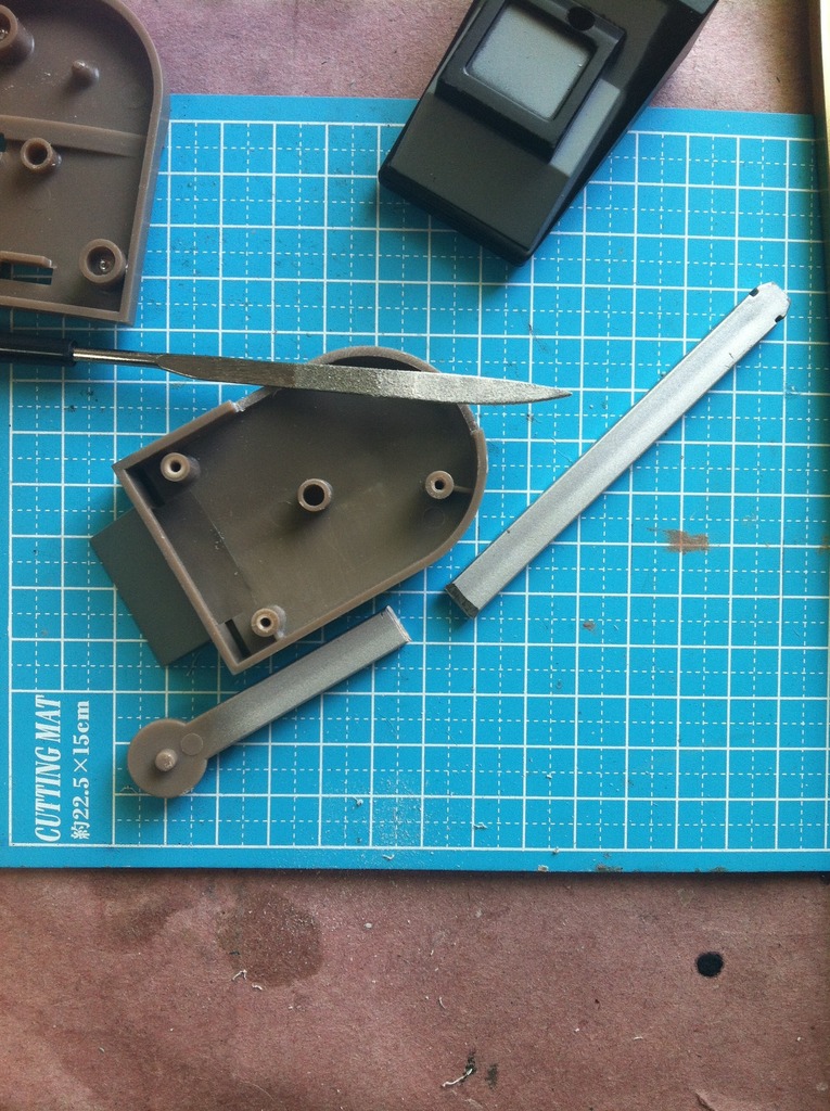

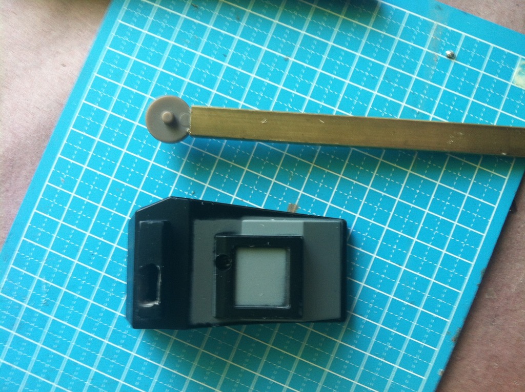

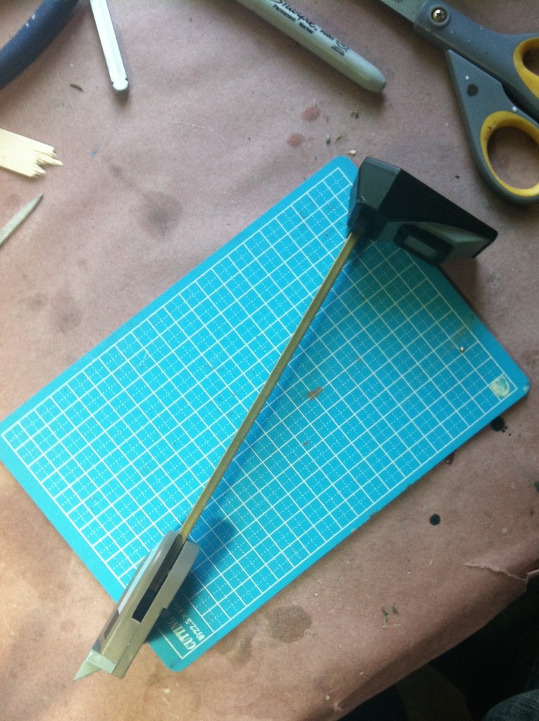

Thought I'd share how I lengthened my RF stalk. Not a strictly accurate result, but certainly better and sturdier than the original, and a really quick fix.
I had some rectangular K+S brass tubing that the plastic stalk almost fit perfectly inside of, so I trimmed the plastic down, ground the it a little thinner, and wedged it into the brass. The part that attaches to the helmet needed to be filed slightly to fit the new stock. The to rangefinder piece needed a slightly bigger hole to accommodate the brass. Cut the brass to the right length, and it all fits back together. I thought I'd have to break out the epoxy, but everything is friction fit very nicely.

Awesome idea Jas!
I noticed today that mine has started to bend over ever so slightly so reinforcement is definitely in order!

What is the length of the brass stock?

I found conflicting reports of the correct length on TDH, so I went with the longest, which was 187mm, plus the height of the inside of the RF (not counting the protrusion on the bottom of the RF where it fits in, since that's supposed to be part of the stalk). I figured I can always trim it shorter.
