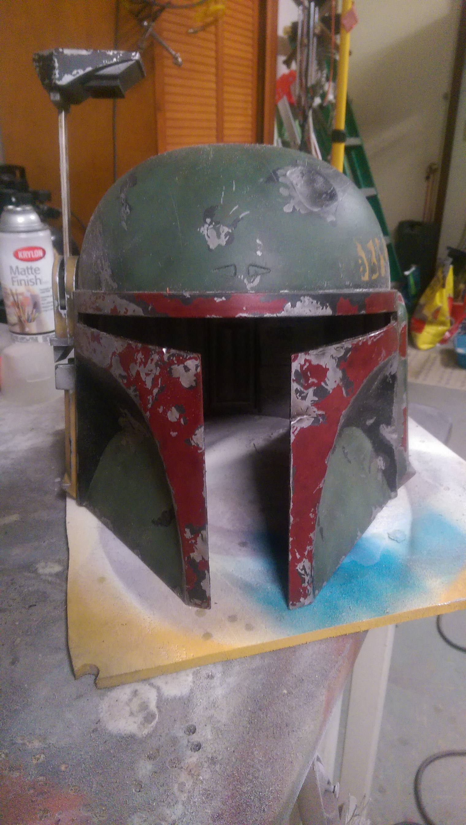

Got mine today. Was the last one they had, and the top of the stalk ear and stalk was missing.
Picked it up for $15. A new accurate ear and stalk is printing as we speak. Going to see about tinting / dyeing the visor tomorrow if I get the chance.

Update time. :) The cracked visor was taken out today!
A fair word of warning.. a few actually..
The visor is VERY brittle. It originally cracked pulling it off of my head form. (used in above photos) it cracked again with slight flexing of the helmet. If you plan on wearing this thing, you absolutely need to replace the visor. Not only did it crack easily but the shards were sharp! I would not want that breaking anywhere near, or God forbid on, my face.
Second. It is a lot easier to take it out BEFORE you assemble the helmet permanently. I used a dremel and got it about flush to where the visor sat. If there are some gaps between it and the new visor it won't kill me so I'm not too worried.
Third... Slush casting resin will not assemble the helmet permanently. :lol Used 80 grit sand paper to rough it up and slush cast SC320 into it, and it peeled out like no one's business. I have had silicone molds fight me more than this helmets plastic. However, If it's just for display you should be fine. It didn't come out until I really started handling it.
If anyone is getting ready to tackle this I hope this helps... Don't make my mistakes!!* :lol
PVC like that used for toy helmets tends to be quite slippery, even when roughed up. I recommend a two-part "plastic-repair" epoxy that includes PVC in its list of "will work with". I also use strips of sintra (also a form of PVC) and plain old super glue to back off and reinforce those seams. Independent testing has demonstrated it's one of the best adhesives for sintra and works very well with PVC, too. I then blend the edges into the inside of the helmet with two-part plumbers' epoxy putty (the stuff that's two shades of gray and sets up like concrete). With all three of those things each reinforcing the other, I have very good results. The Hasbro clone trooper and Boba Fett helmets I've modded I've used this technique, and dropped them multiple times on my concrete garage floor and they just bounce. Meanwhile, every time I've fiddled with a fiberglass- or fiberglass resin-reinforced helmet someone's modded, the fiberglass/resin just pops out.

In regards to those having issues "glueing" the halves together....
Ive successfully "welded" mine together using a cheap soldering iron.
I use this method a lot for joining "like" plastics together.
Nice, since you can apply pressure for a better seam and it rehardens almost immediately.
Do keep in mind though for other projects, not all plastics can be welded like this.
