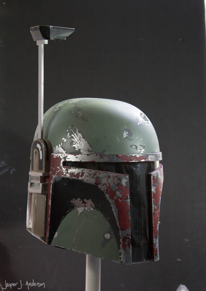

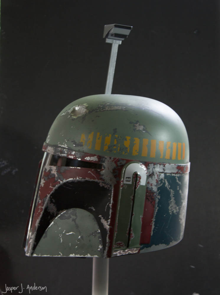

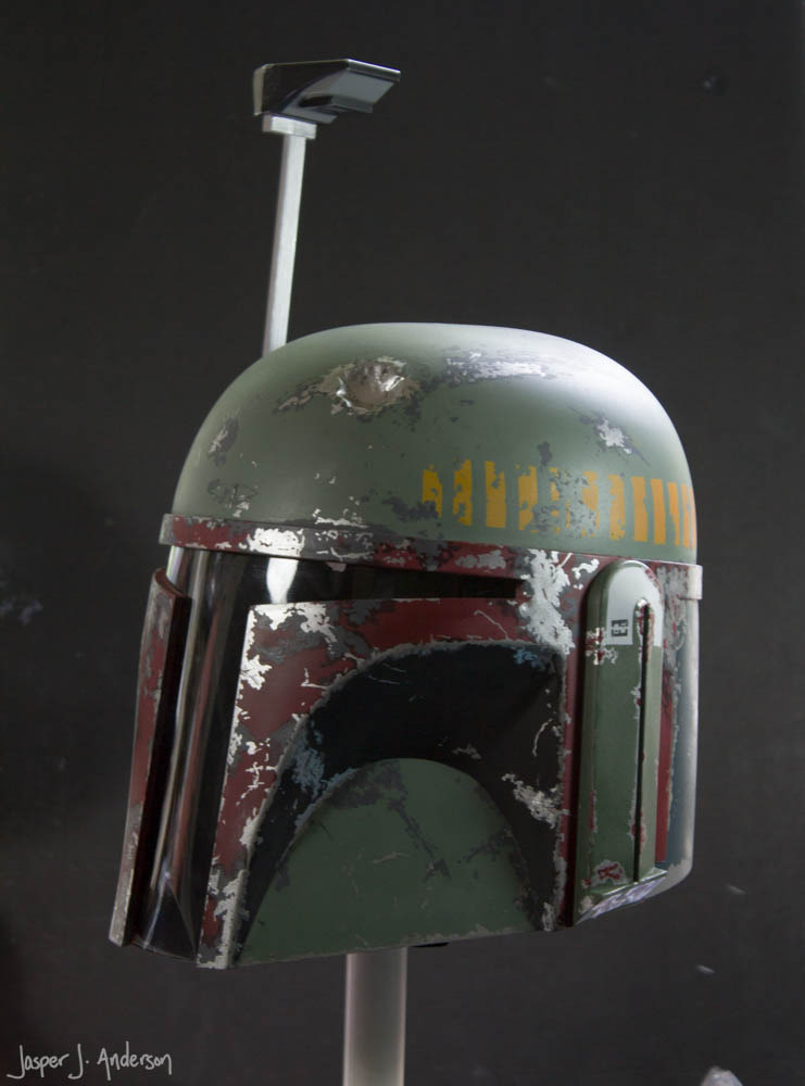

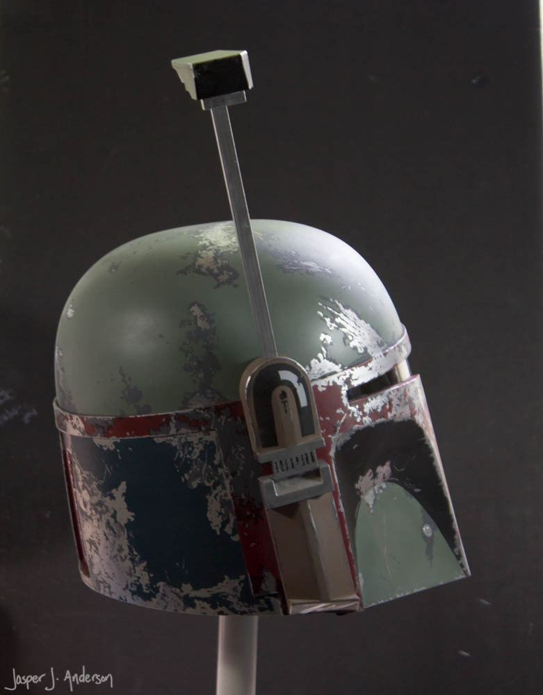

Finally (nearly) done painting by Target Boba. Wow, that took a lot longer than expected. Gives me a lot of respect for the guys who do these so well on TDH. I may still shorten the RF stalk a bit (I think I overdid the extension slightly) and add a bit more general weathering and missed details, but it's been a fun project! I used mainly Model Master enamels, since I don't really have any experience with them. Tried to get the right colors off the shelf, but ended up having to mix most of them, and still didn't quite hit them on the nose. As a learning project, though, I feel it went pretty well. Who knows, I may repaint the whole thing one day, haha.
Mainly a topical paint job. I used a variety of templates from the folks at TDH as a guide for the first pass of color in each zone, and freehanded the subsequent layers, so nothing's truly exact. I stenciled the decals by transferring templates to blue tape with graphite paper, which turned out to be a really easy easy to get them done. I haven't decided how I want to tint the visor yet, so there's just a piece of fabric behind it for now.
The dent shape was corrected somewhat with Apoxie sculpt, and the rangefinder stalk extended with brass as I posted a couple pages back. At some point, I'd like to fix the shape of the RF, too.

Finally (nearly) done painting by Target Boba. Wow, that took a lot longer than expected. Gives me a lot of respect for the guys who do these so well on TDH. I may still shorten the RF stalk a bit (I think I overdid the extension slightly) and add a bit more general weathering and missed details, but it's been a fun project! I used mainly Model Master enamels, since I don't really have any experience with them...

A good paint job makes all the difference in the world! You mentioned using Model Master enamels, but mixing up your own colors. Which paints did you start with? I think it turned out beautifully! Did you do any other mods besides paint and RF stalk?

If I recall correctly... (Model Master unless otherwise noted). First layer and stencils airbrushed, everything else with paintbrush
Dome: Dunkelgrun RLM 82 + white
Red: British Crimson + black + blue
Back Blue: Dark Sea Blue + Russian Armor Green
Back "concrete": Testors Tan + Gunship Gray
Cheek: black
Grey detail: Gunship Gray
Silver detail: Chrome Silver
Yellow: Testors Yellow+ Testors Red (more red and blue for fade)
Rt. Ear: Testors Tan + Italian Dark Brown + Black
Lt. Ear: Dome mix + Russian Armor Green
All this on top of a coat of rattlecan primer
