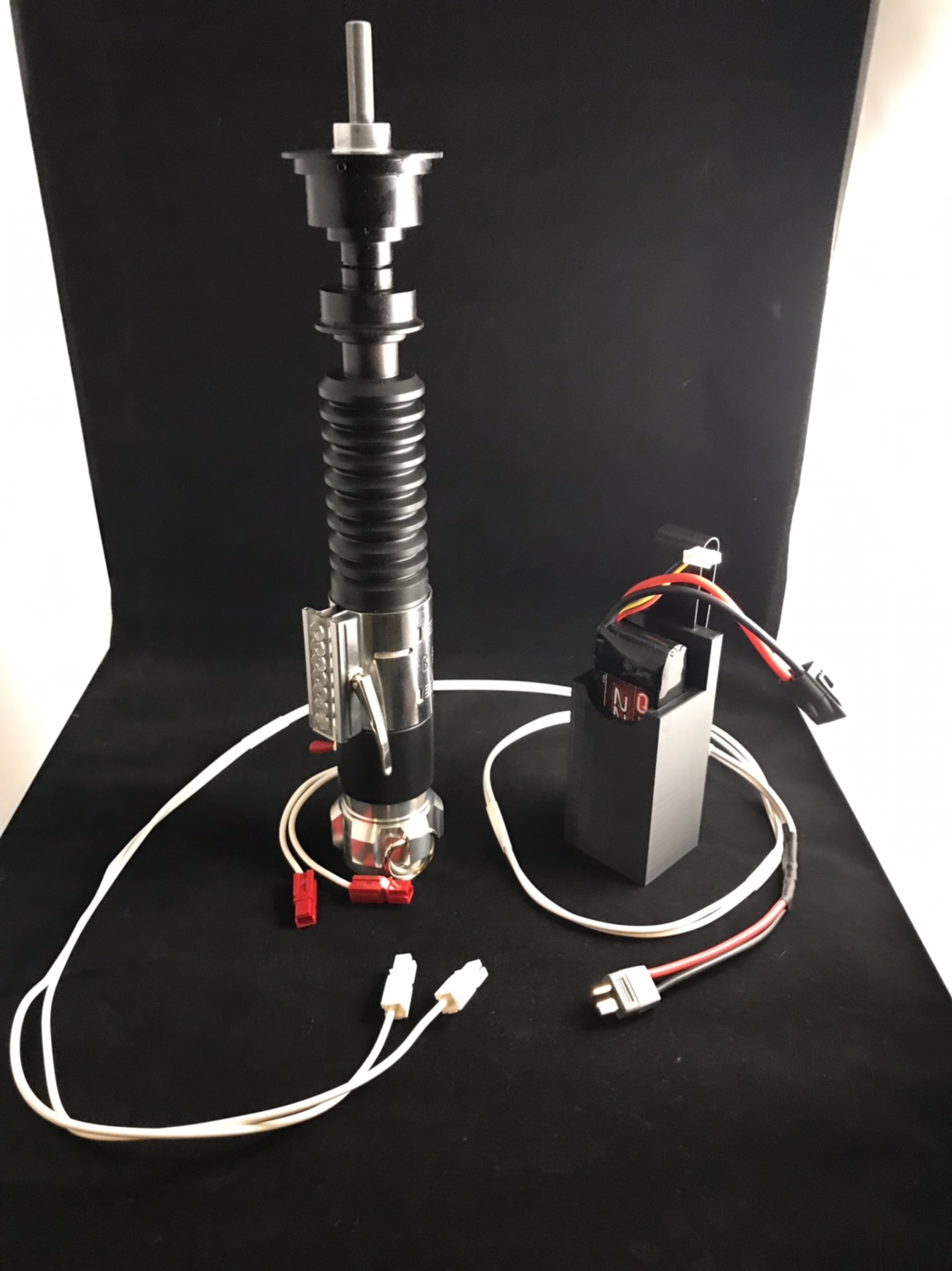

on March 31st, 2019 I completed a goal I've had for a very long time. I've been dreaming of this since 2015 when Anakin "Dan" Starkiller did his first run of V2's. The internals of his first generation was very tight, now knowing what I know I think it still can be done on his older runs. But when I saw the room inside his new generation I knew it could now be done.
I needed to learn how to 3d Print, Trooper Trent walked me through many tutorials via video chats and i got a basic grasp. I ordered a printer and figured I'd never get it to work lol
I now had the tools, enough knowledge to be dangerous, and a Trooper Trent if i had questions. but i'm not a electronics expert. I fried my first motor setup, only to realize when taking it apart i forgot to heat shrink 1 wire..
I wanted to put a speed controller in it so the Hilt could be used on anyones cell phone, each phones camera has a different frame rate, shutter speed (im no expert in that field either, but only know from my experience with this hilt)
So i road out to a RC hobby shop next to my bothers shop. Those guys taught me A LOT!! they hooked me up with some parts and i began experimenting. I would still be struggling with motors if it wasn't for them.
but before I learned about PWM (pulse width modulators) or simply put, speed controllers. i would take a black strip on the blade and make it wider or shorter for different cameras i used.
but now with the speed controller you can dial it in to any camera with just 1 single pin stripe on the blade
i tried 14 different combinations of motors and controllers and finally dialed it in where i like..

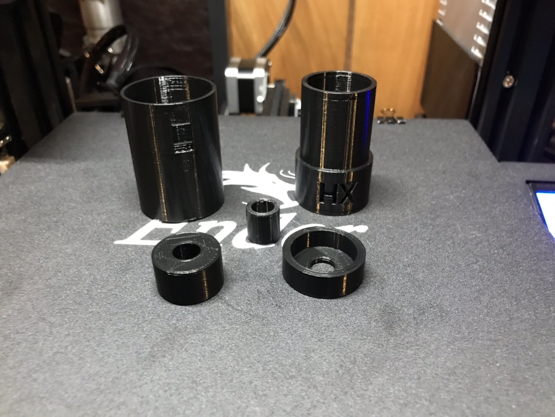

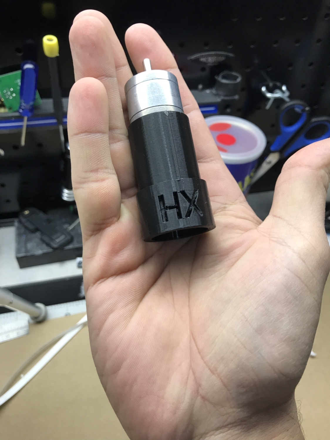

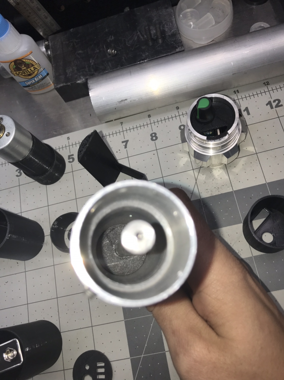

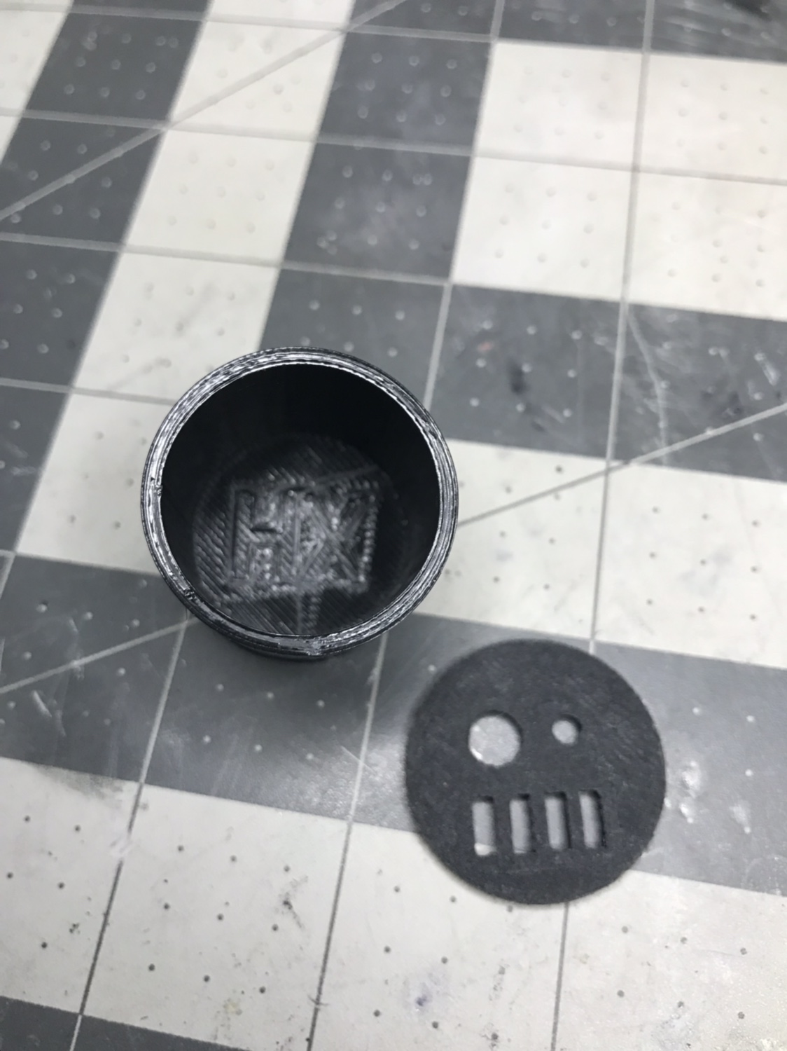

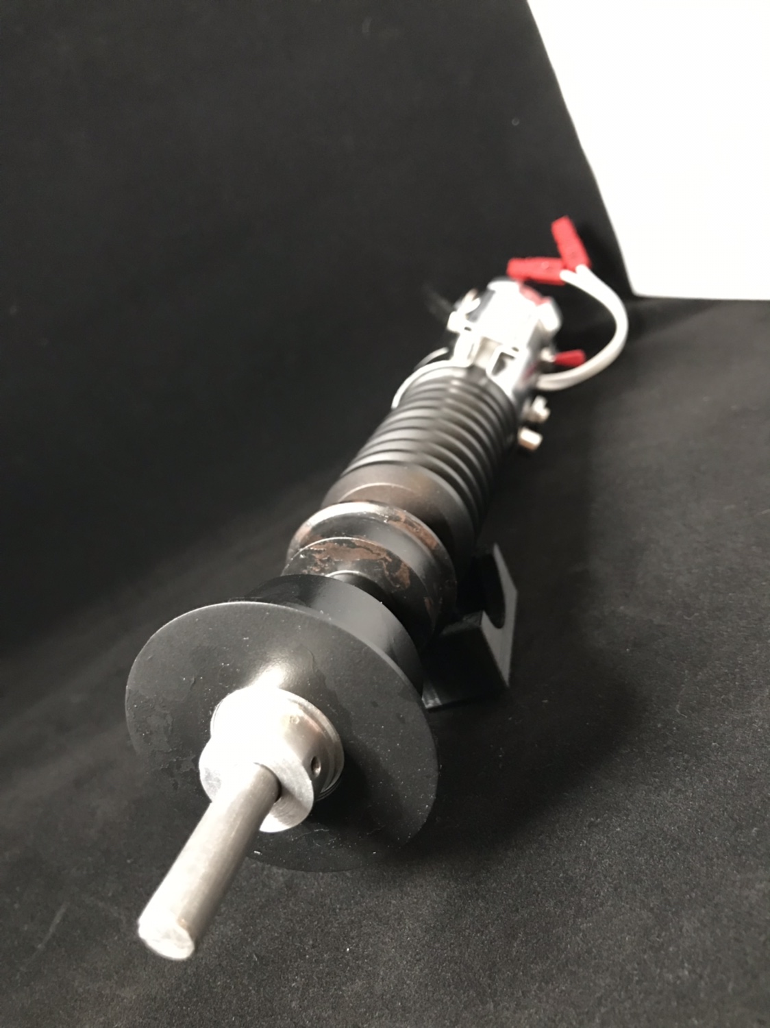

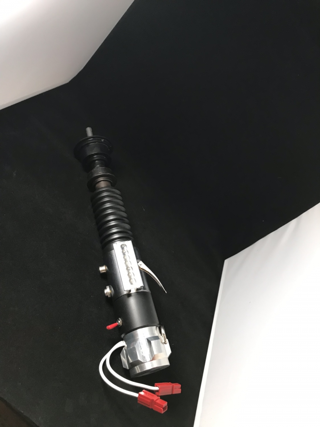

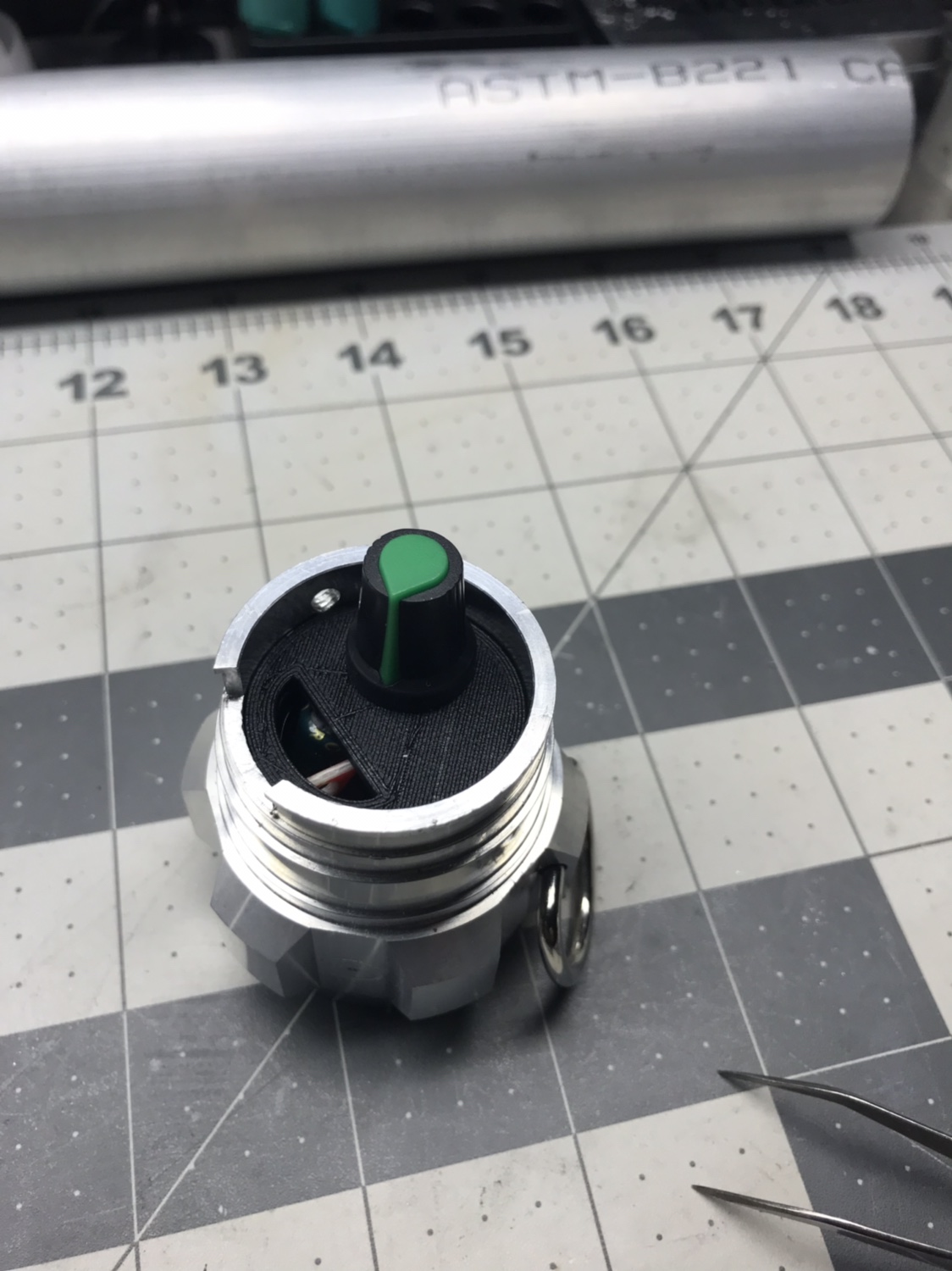

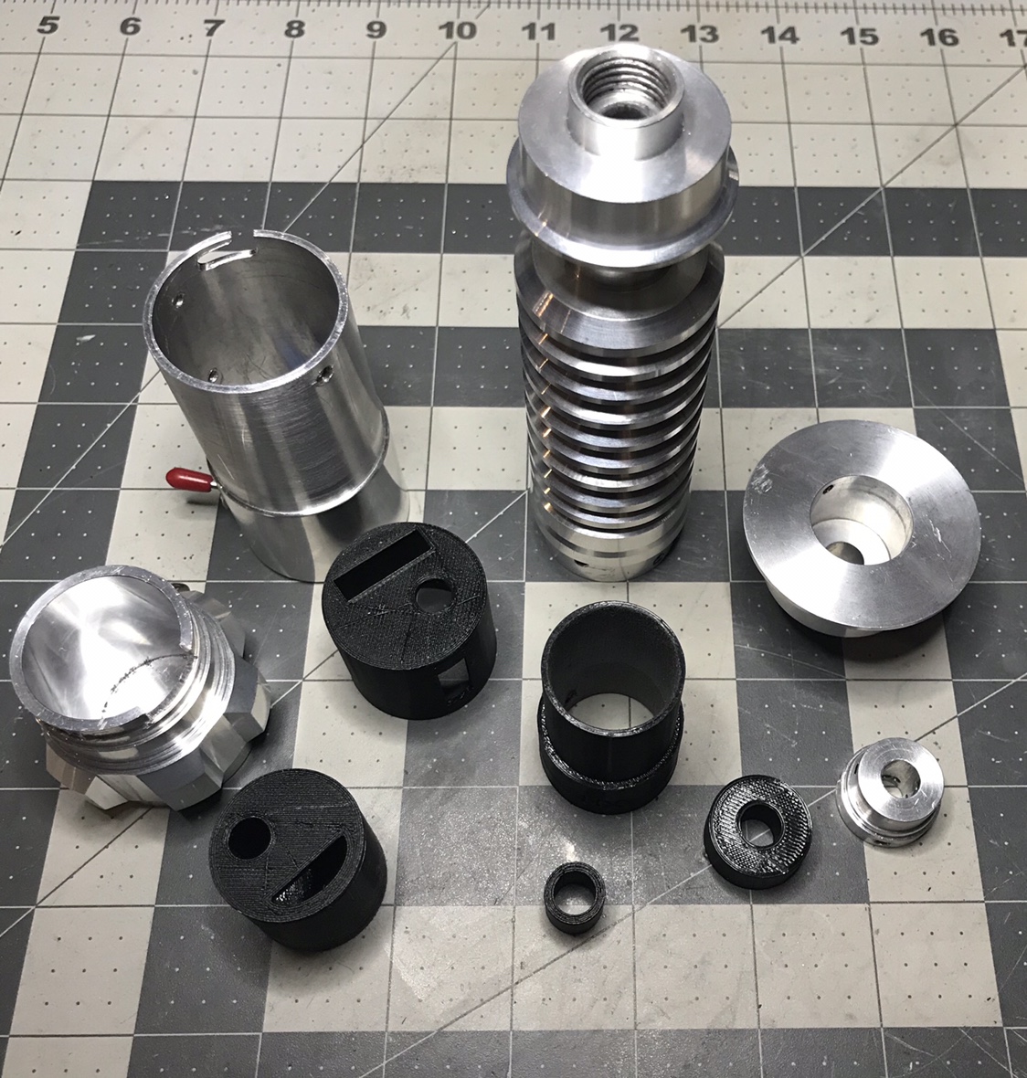

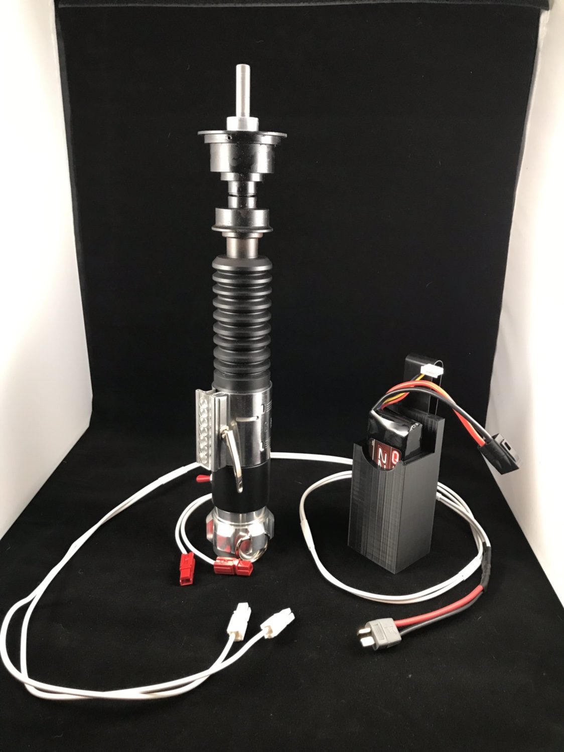

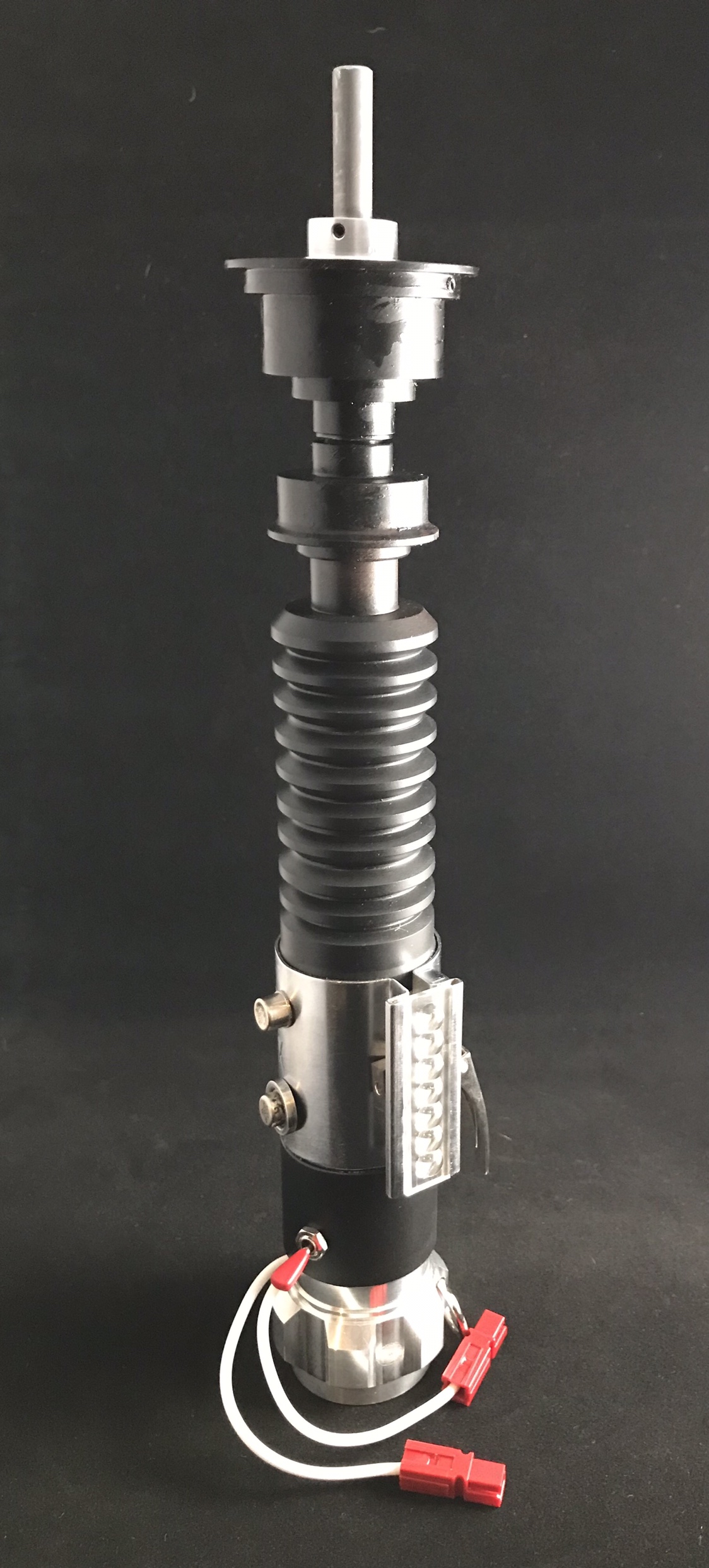

Some inner working pictures
Pommel Cup - Speed controller hidden in pommel, in protective “cup”
Motor Mount

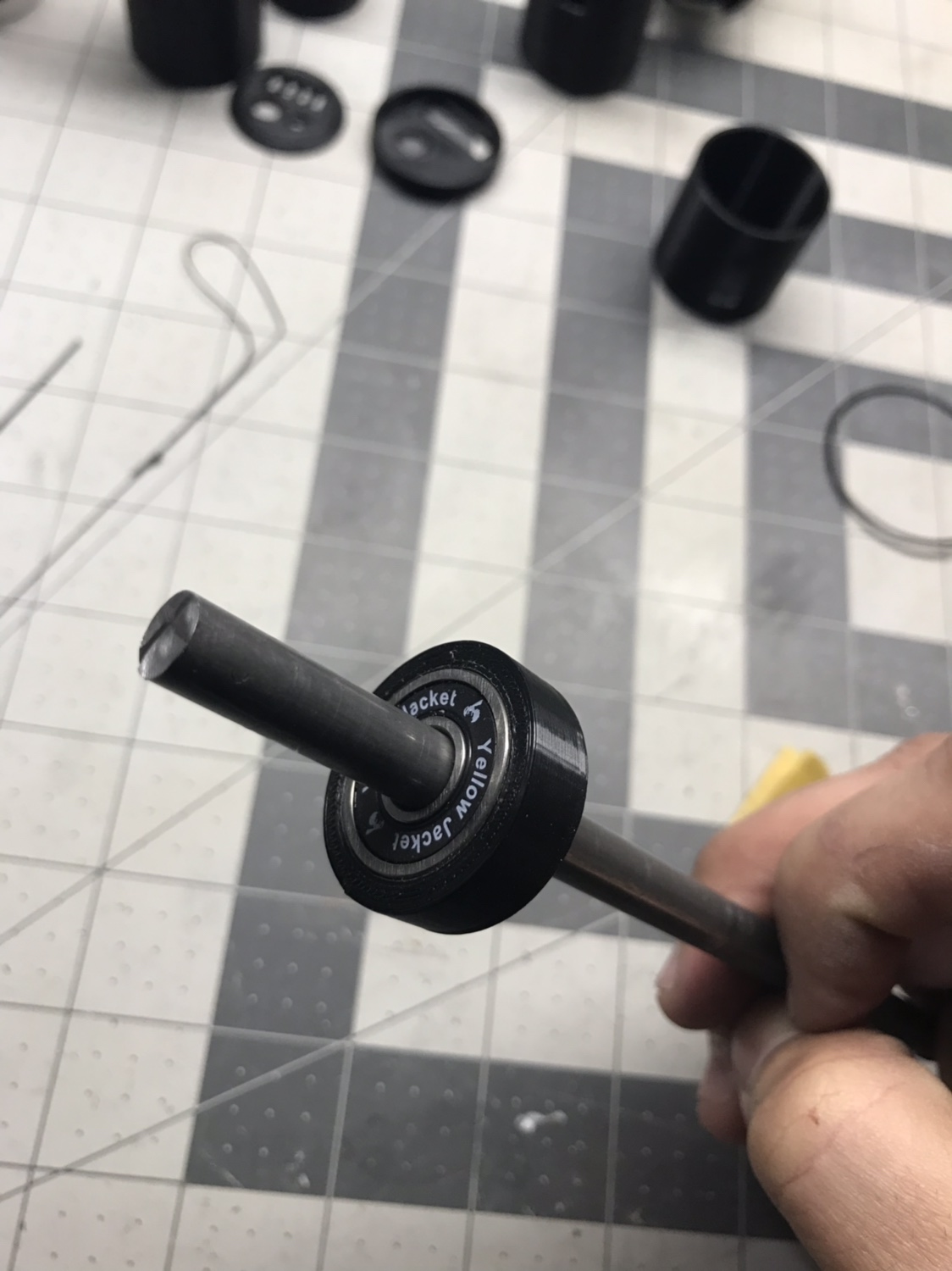

Roller Bearing plate installed up the grenade with 8mm Drive shaft
Funny story I was talking with Trent way back and telling him I need to find a bearing with a 8mm center hole. While we were video chatting he was like “wait a minute” I swear to god he pulls open the drawer right in front of him, pulls out this random bearing he has in the draw, throws the mic’s on it and throws his hands up in the air “right here man!!” lol big thanks to Trent for this bearing!! And it’s a funny story too, what were the chances of that
more prototype pieces
