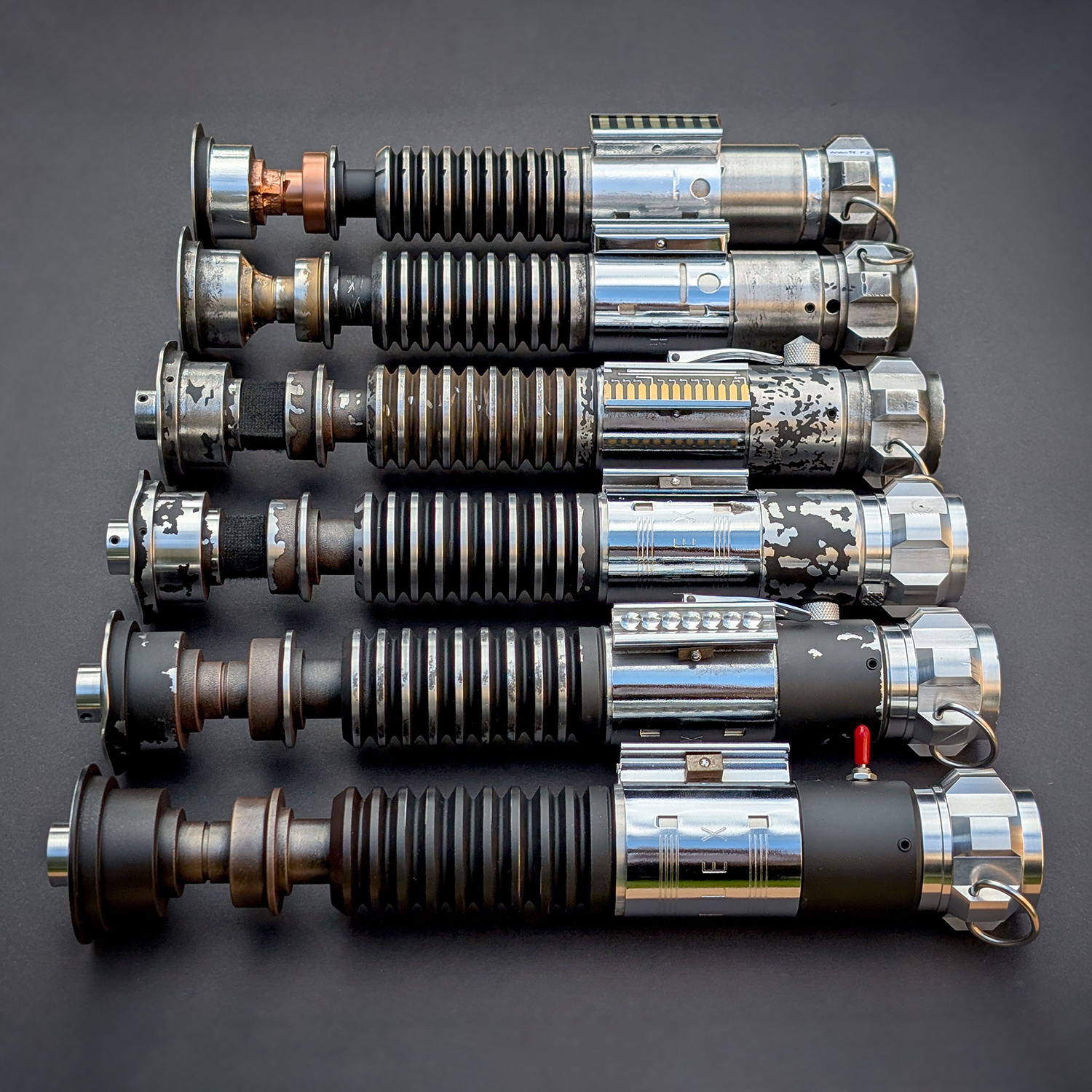

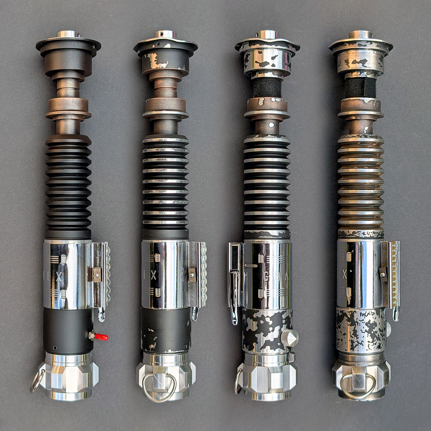

For now though, here are some images from this last batch of finished commissions. I hope you like how they’ve turned out.

Wow, those are absolute stunners. So much fun to look at and admire.
If I may ask - those V2's in the center...a few subtle differences it seems? The weathering on the main grip, and the overall height as well? I was wondering if these are two different sub-types of the V2 model.
Hi there.
Thank you so much! So, aside from the clamp orientation, they're physically the same. They may appear to be different lengths due to the irregular emitter being oriented differently too (and not being positioned perfectly for the shot :D)
As for the paint/weathering, the one on the right is the current day /post-production V2. The one on the left is my take on a mid-production / early throne room version. We know for sure what it looked like at the beginning of production (the deleted sandstorm scene). There are also some good references from behind the scenes of the prop during filming, where it appears to have lost a fair bit of paint, but not quite to the extent that it has today. So, that one is my interpretation of how the prop could have looked at some stage midway through production, based loosely on some of the available references, but also by extrapolating backwards from how the prop looks today and adding in more paint/less weathering.
Hope that makes sense.
Thanks again for your kind words.

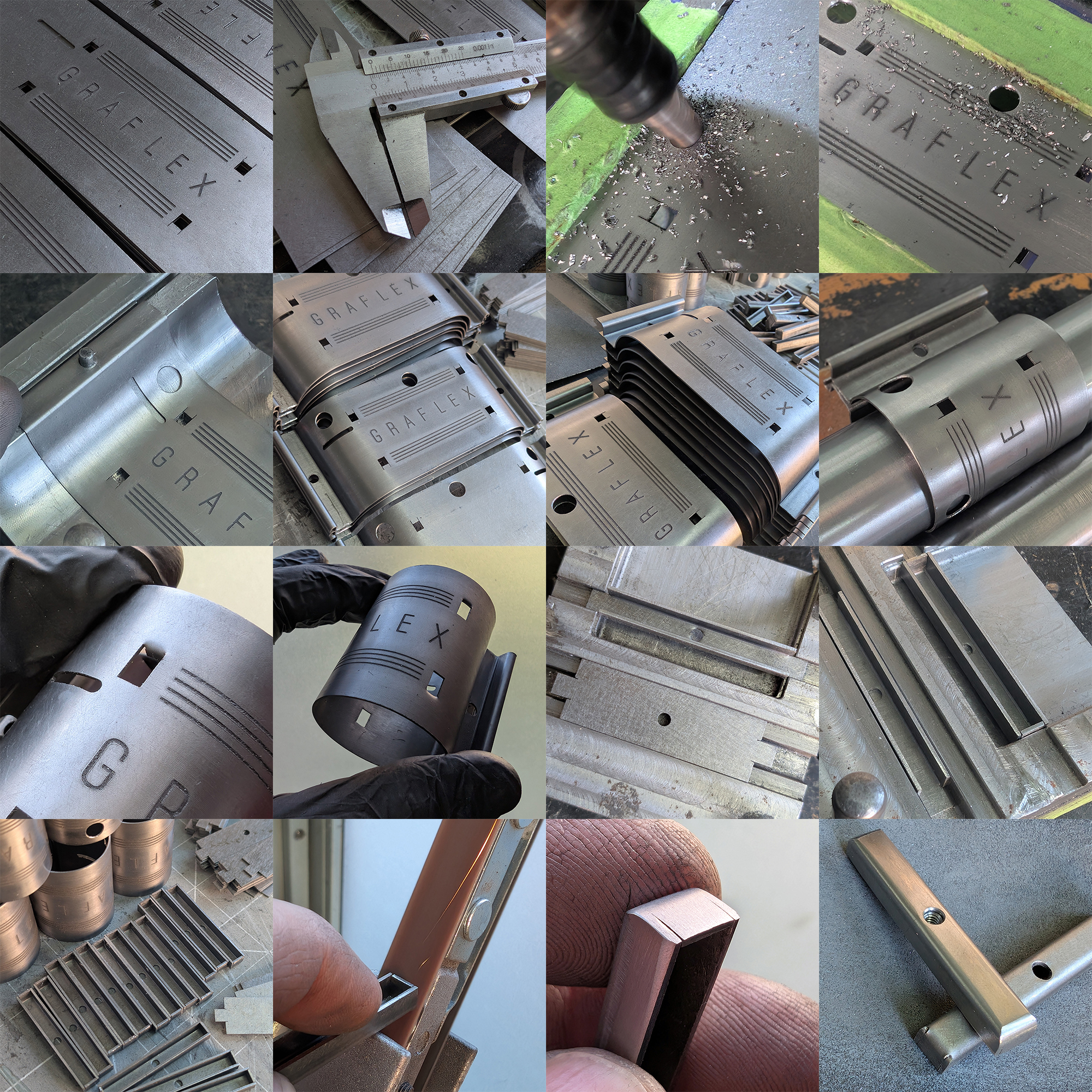

This last week has been all about clamps!
In particular, the sheet metal parts, which are formed in-house from flat sheets.
This is incredibly time consuming and labour intensive, but also very rewarding.
It’s great to start off with a pile of flat shapes and gradually see my workbench filling up will finished clamp parts.
As I mentioned previously, I am now working on getting all of the remaining clamps for Batches 5 and 6 finished and on their way to the platers.
I’m nearly there! Just another day I would say, to make sure that everything is perfect.
There are quite a few processes involved with these. It’s not just a case of running them through a press.
The clamp sheets are 1mm too long at each end for a start! So each plate has to be trimmed down by hand. V3 clamps have to be drilled, and de-burred. Tabs need to be bent inwards and then removed too.
Once folded, the clamp bars are tidied up by hand to give them the smooth curves and tidy corners that are seen on genuine Graflex bars.
It’s a LOT of work. And a LOT of clamps! I’m happy to say though, that it was a very productive week, and we’re nearly there! (y)

Clamps have arrived back from the platers and are beautiful. I will get some pictures taken once I get some of them assembled.

For the original run the body section was designed for use as V2 or V3, with me making the necessary modifications and adding fixing points myself. This was A MISTAKE! :eek: The savings made by doing this were minimal, but things like this have had a huge effect on the amount of time it takes me to complete a finished commission.
I have endeavoured to rectify this for this additional batch by adding fixing points to the model and making the body section specific to the V2.

There is a third reason for the increase in price. I spend a LOT of time sanding and polishing tool marks from certain areas of the parts. This is a conscious decision on my part, as I have opted for a rougher surface finish in favour of a lower production cost. Again, this has an impact on the time it takes me to finish a commission.
This time around, I have selected a smoother surface finish, which should speed up my process and reduce the amount of time that people have to wait for their finished commissions.
There will always be some cleaning up of parts to do, but if I can reduce the amount of time I spend doing this, I'll be able to focus more on painting and finishing.
