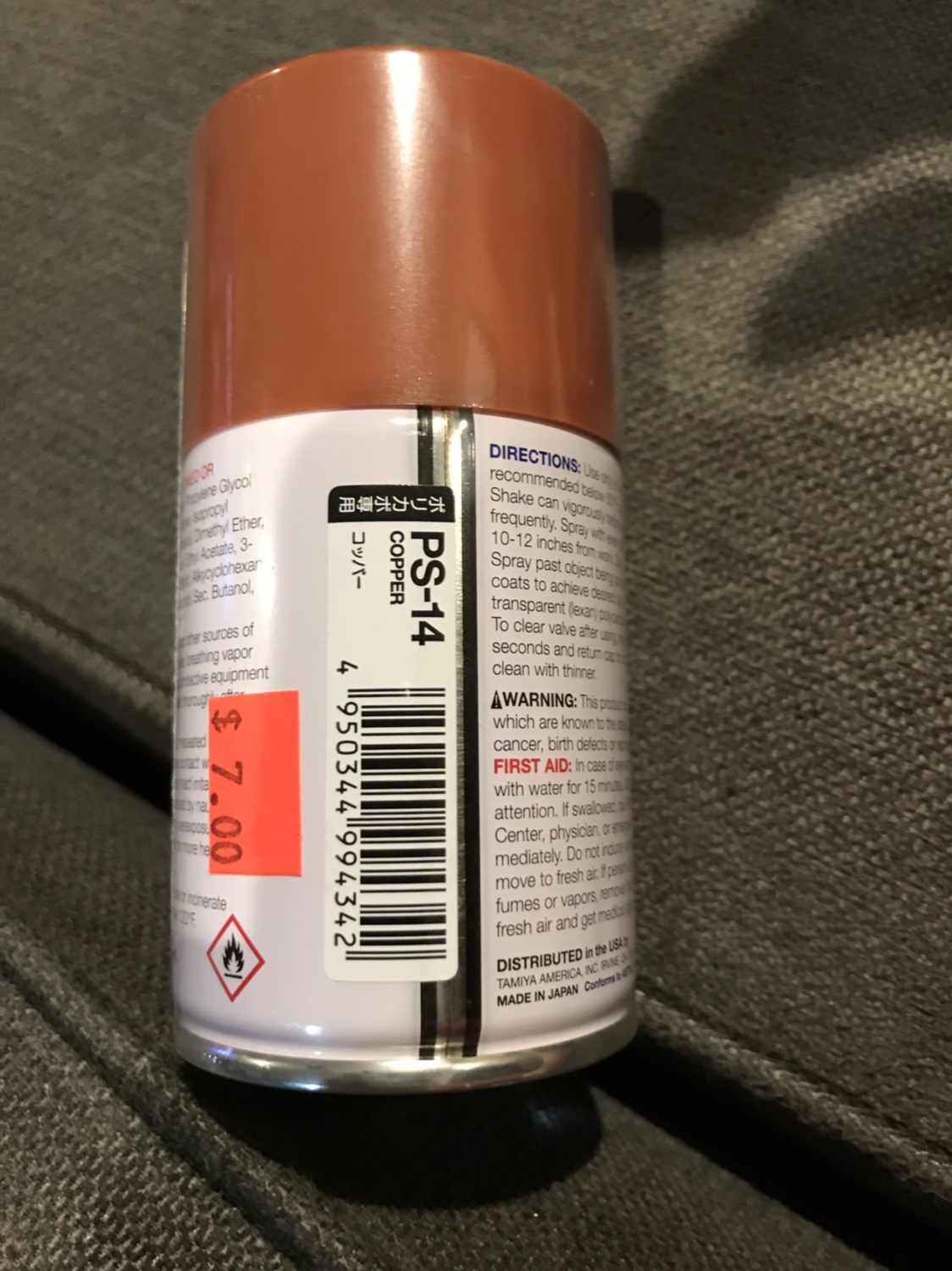

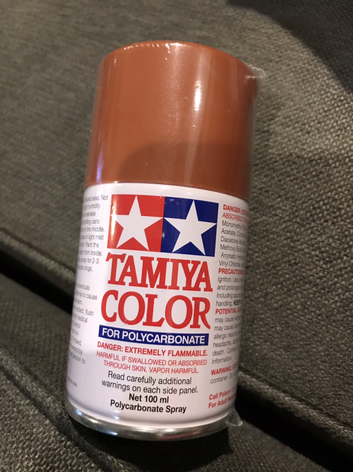

Heh I cant really say of one personal copper choice. I fooled around with other props with metallic copper (which I don’t have with me to show you) but not the v2. Problem is I can’t find a off the shelf rattle can that is copper wire out the dang metallic flakes in it..
The copper I use is tamiya spray paint. I use this over rustoluem because the rustoluem has metal flake in it, this doesn’t
It’s also my color of choice for v3 windvane weathering
I recently have gotten this from the RC shop that helped me build the electronics for the legend. I don’t know if you can grab this off amazon or eBay but I’d check there
