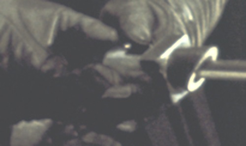

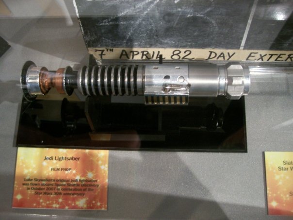

(2nd image is thanks to Rudy Villalpando/Spirit of ob1) I tried to find the original source for that one but no luck. It looks like its from the Archives as seen in the Original Prop Blog pics but it doesn't match any of those. Anyone got this one or know the source?
Yeah, that pic is from this book:
That's the only place that I've found it, personally. And your example is strangely skewed.

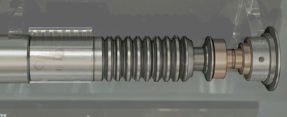

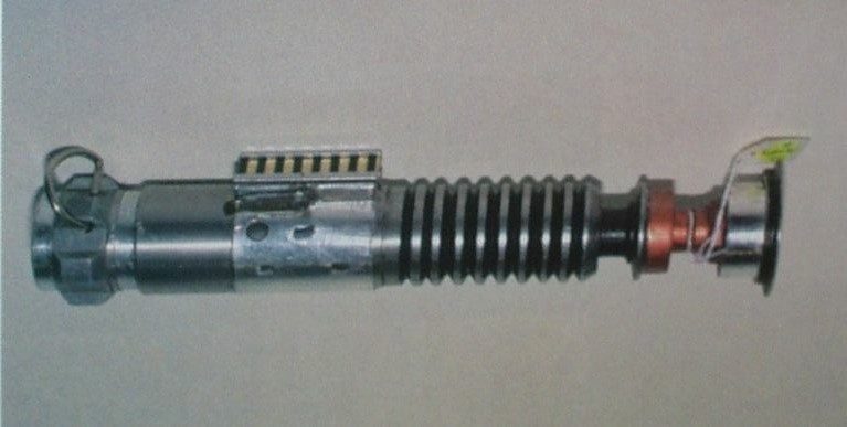

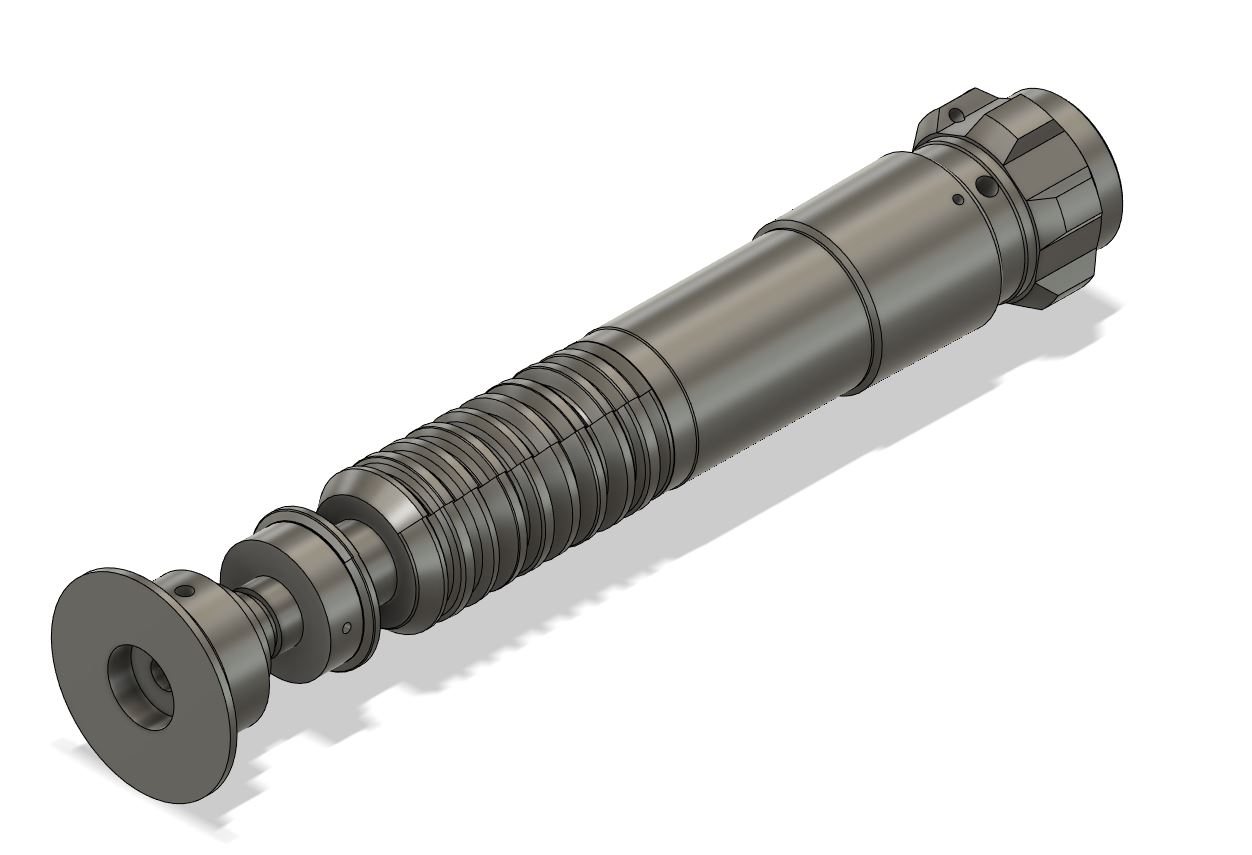

I think I've finally got the grenade rings dialed in! Maybe one or two spots that I'm about to touch up. Here's what it looks like now, though it doesn't look like a lot has changed

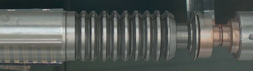

Some checks on on the rings:
Also funny that thd mentioned not to use the clamp as a marker - I had done exactly that on a few images believing it to be correctly oriented (whoops!) That caused some of the rings to be a bit off before, but that's fixed. I found a pretty clear-ish gash on the 3rd ring that tells me what side I'm looking at now!
Besides a last pass on the rings one other thing has been giving me trouble - the screw holes. Getting the booster and wind vane screw in the right spot has been a bit annoying.. I model it correctly to one picture but when comparing it to another it's incorrect. I need to find that sweet spot where it works for all of them

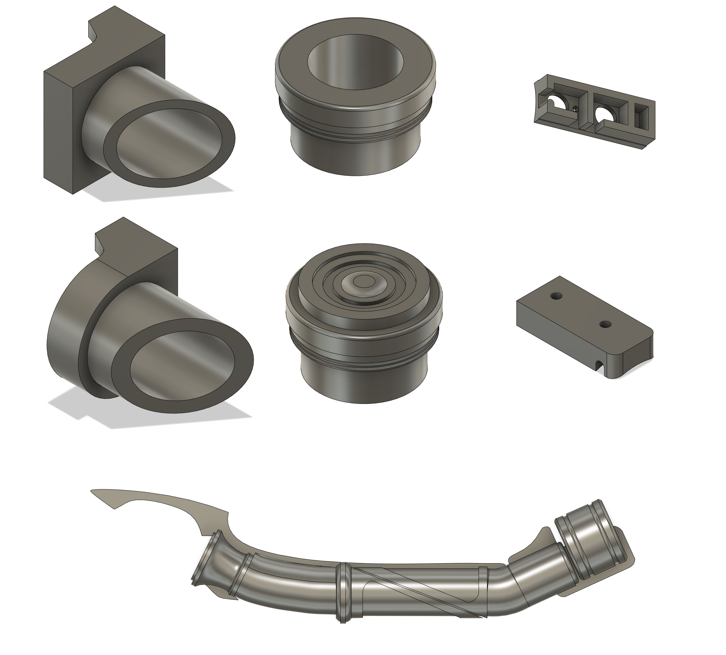

For those curious, I've almost finalized all the parts + finished some technical drawings.. So hopefully soon this will be a physical saber :)

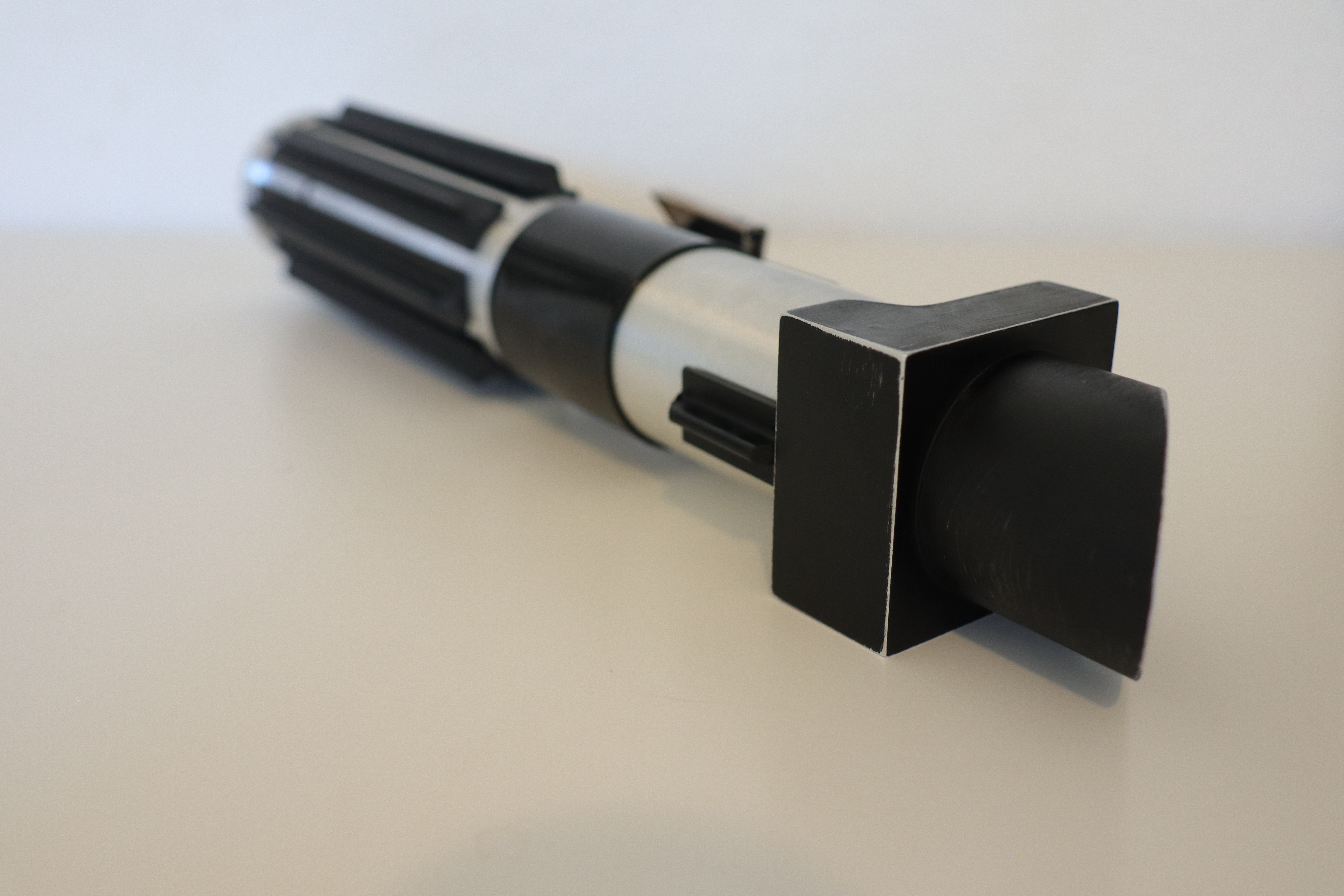

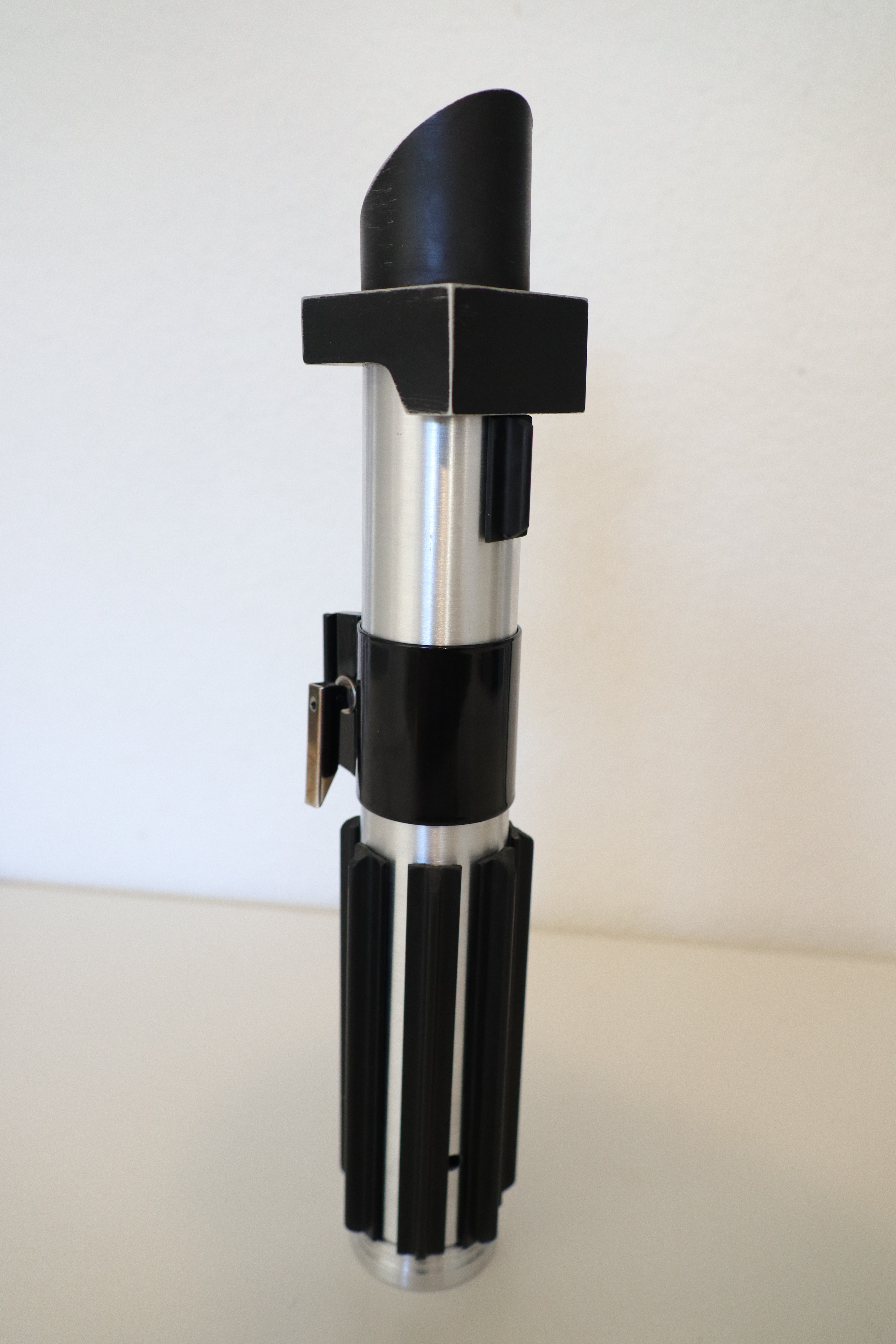

Anyhow..... I started on *another* project a few months ago and all the parts finally showed up at my doorstep so I rushed to put it together this past weekend. (quite a few things need tweaking still, but I figured its worth a share). An A New Hope-style Barbican/Vader Stunt saber! My first physical saber build in quite some time. I really dig the look of this saber for some reason, especially the weird looking square shroud. (Guess I got a thing for weird stunts) I went for a look that it might have walked off the set of ANH – grips are all randomly angled/not exactly straight, etc. Assuming that the ANH grips got replaced for ESB of course. The tube is actually a bit too long... things to work on but I probably won't fix it anytime soon if I'm being honest.
(wire for fun where it would come out of)
The endcap was machined by a friend, and is based on the severed hand resin cast and the few screenshots of it in ESB with what seems to be an open cap, so I'd wager the plug was added post production to match an MPP. Maybe.
OK so the shroud wall is a little too thin and I don't know how I let that slip under the radar. I had it CNCed by one of the shops I was potentially looking at to machine the V3. The dimensions and tolerances were great, the surface finish could have been better. Then again I left it as 'as-machined finish' next time I'll be sure to specify... Now this is the fun part – as I was getting ready to paint it and it fell before my eyes and bounced on concrete :sick: and that's where the dent came from. Coulda tried to fix it but I decided the real one is beat up enough that a few scratches are fine, so I took back some paint afterwards to match. I may try to fix it eventually and redo the paint job
Some more points of note: I bet the real one would have used a toggle switch similar to the Obi stunts as this lamp switch (which took almost 2 months to get here from the UK!) has a fairly large diameter to mount it, and the real hole for the switch is a lot smaller, but I decided to use the lamp switch anyways. Also thanks to Roy/Wannawanga for the extra bit of T-Track for the MPP release greeblie! Really ties the whole thing together, with that sort of 'this is a clearly fake MPP' look.
By actually having this in hand though, I can see why the Vader stunts were finicky. Since there weren't any screws in ANH that we can see, the shroud would be pretty loose on the body and I've managed to tighten it down with a shim, but I imagine if you're swinging this around with a blade you'd have to hold onto it the way Prowse does to keep the shroud from flying off.

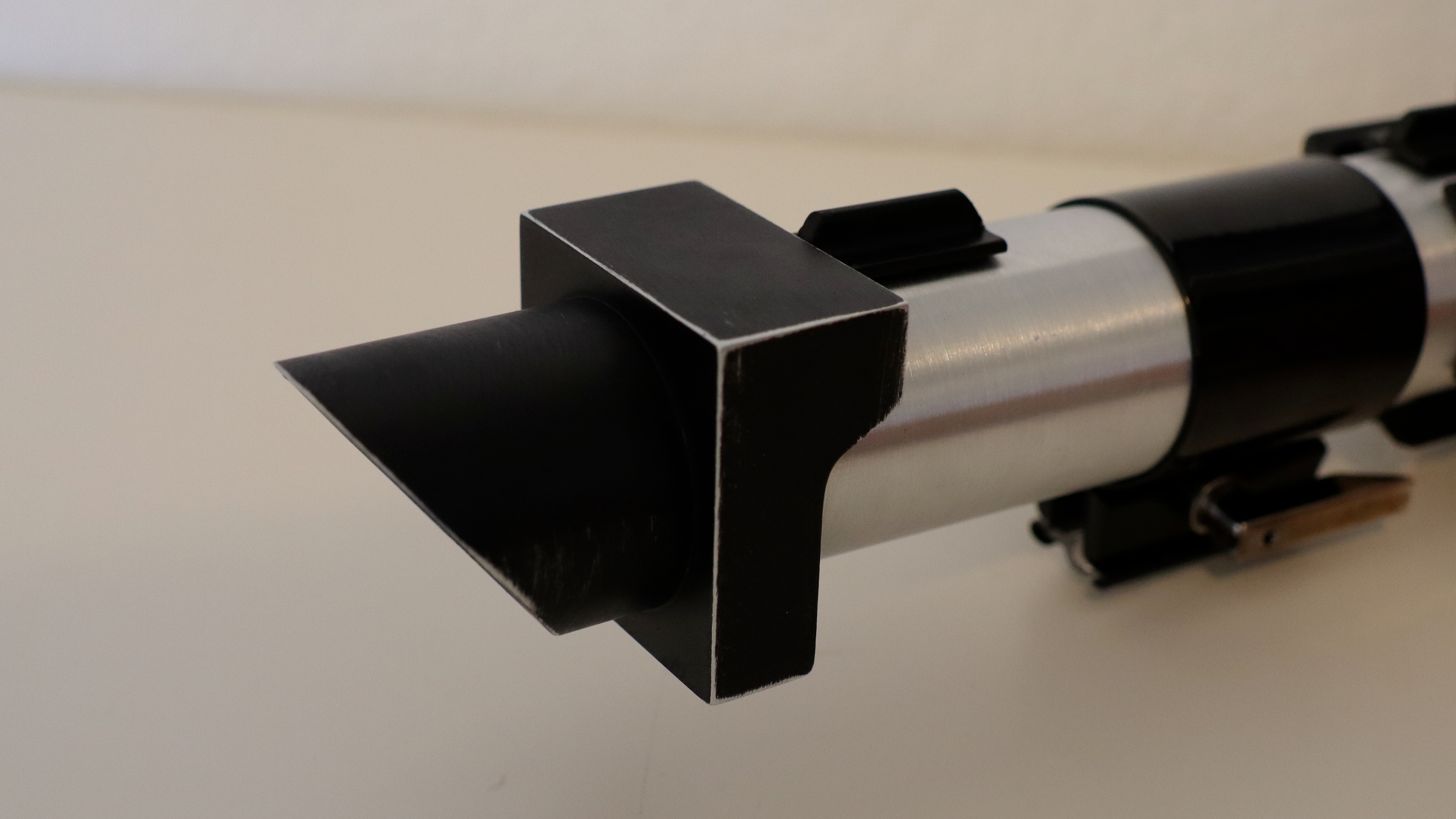

I love this. I've been trying to inspect it, can you show us how the shroud tube is attached to the main tube? I assume the pommel is slid up inside the body

Yep, the pommel slides into the bottom of the tube. The shroud is just pressure fit on there thd! (There's a washer fit in it to mimic the core in it now)
Popping it on and off made it loose, even after painting. So I added a small piece of tape to act as a shim. It actually holds on surprisingly well!
