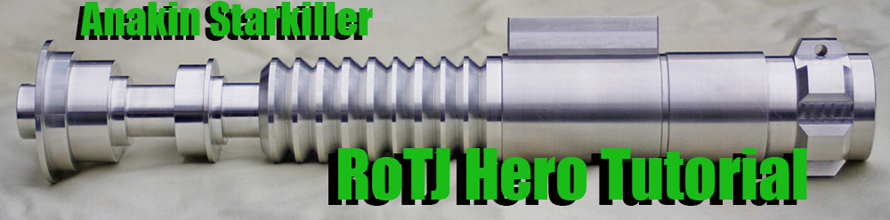

This is the official Tutorial for Anakin Starkiller's latest RoTJ Hero run. Below you will find his assembly guide and official painting instructions for both the Hero & Yuma. Please feel free to ask questions here, and post your finished Heros/Yumas! It is hard for our European friends to get their hands on the Ace gold, Please see post #3 where we share over seas color combinations!!
Parts required to complete kit
Anakin Starkiller RoTJ Hero/Yuma Hilt
Sloth Furnace Clamp Card
Tools List
2mm allen wrench
pliers
dremel w/ cut off wheel
dremel w/ sanding dumb
small file set
4mm tap
100,200,320,400,600,1000,1500 sand paper
e6000
scotch tape
masking tape
0000 steel wool
glass cup
Paint List
Tamiya German Grey
Tamiya Clear coat
Rustoluem canyon satin black
Ace antique gold (wind vane secret weapon!)
Ace Antique Gold
INSTRUCTIONS
It is very important to follow the instructions below when applying Ace Antique Gold!!
- First clean the entire hilt with isopropyl alcohol
- Find a glass cup, fill approximately 2" of water
- Shake Ace Antique Gold for 2 solid minutes
(this is a serious part, metallic paints are very finicky)
- Microwave water for 2 minutes
- Place pre shaken Ace Antique Gold into warm water and let it heat the can for 2 Min
- After the can has been warmed, shake ace gold again for 1-2min
- Apply ace gold with VERY light coats
- Repeat light coats until you are satisfied with the finish and done!!
Video Tutorials
Unboxing & review
Assembly of the Hero featured guess Anakin Starkiller himself!
Hero Painting and finish work
Yuma Stencils and ACCURATE finish work
-last update 3-22-20

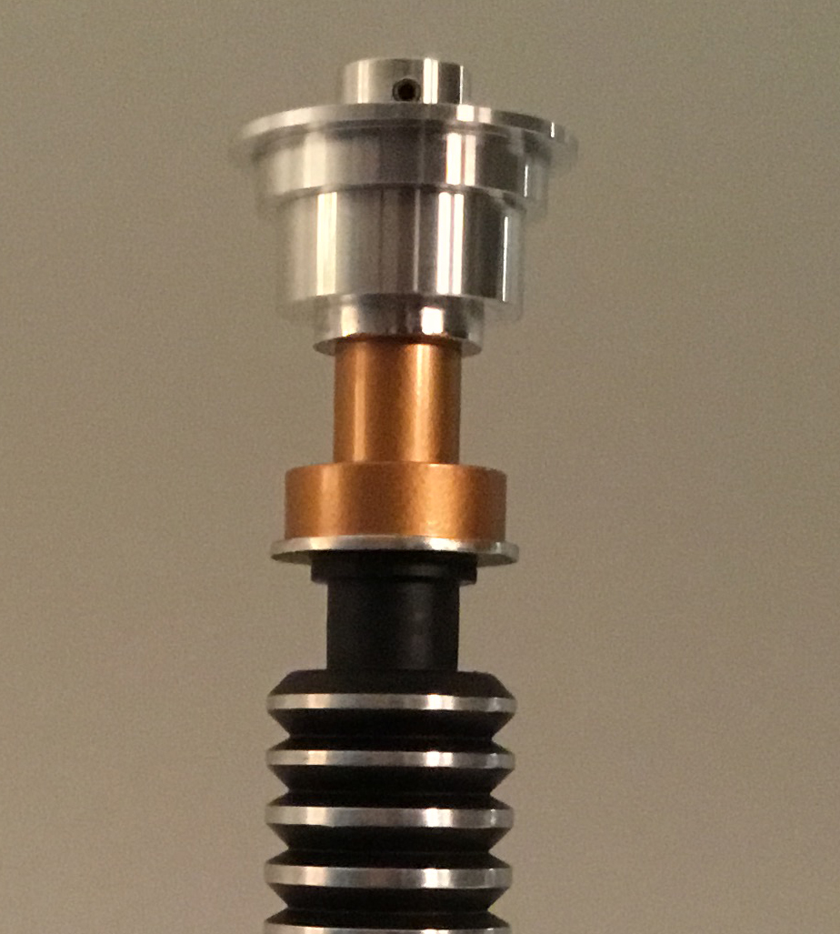

Anakin Starkiller has seen the Hero in person more than anyone else. He has matched the color of the wind vane to a off the shelf spray paint found exclusively at ace hardware. Which is great for us guys in the states, but isn't so easy to find over seas. Many Euro members have reached out to me with what colors they have come up with and i wanted to share them here in this gallery to help others decide which way to go. Below is the ace gold as reference. Photo of Gregatron's hero paint job
Europe Paint Options Gallery
Jamie Owen's Humbrol Color
Jamie used a 50/50 mix of Humbrol 12 & Humbrol 54
BTTUK used the products below to achieve his look
UK based and I used Montana Gold (maker), Matt Gold (colour) from Fat Buddha Store in Scotland.
Damok used the product below to achieve his look
1. Halfords Primer Grey
2. Halfords Satin Black
3. Halfords Nissan Gold Metallic
If you have a color combination you would like to share, please post here and i will link it to this gallery post to help others (who can't get ace gold) determine what colors to go with. Thank you all for your support!​

I have one of Dave’s finished ISYHCANLs. He resides in the UK, and the paint he used for the windvane is very close to ACE antique gold. If you check his build thread you can see the spray paint he used.

On my Hero that I put together a while a go I used foil tape to do the rails on the switch box, it matched the machined copper neck perfectly. I don't think that it would be a good solution here, I think those two parts need to match in color.
