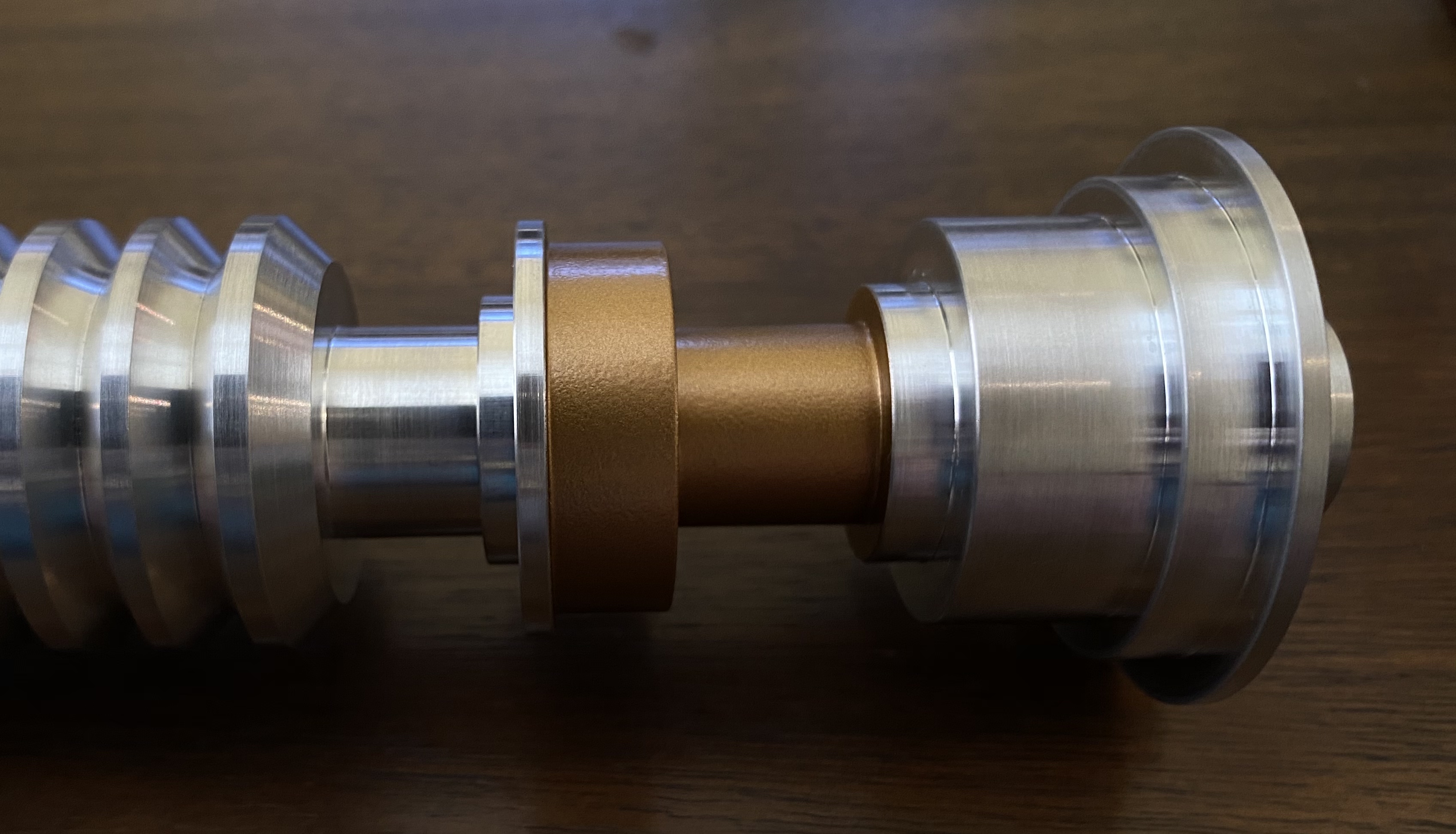

I'm attempting to repaint the thin neck and upper control box on Lukyanov's CU with the Antique Gold technique for an "idealized" Luke. So far I've tried and failed. I heated up my paint but it just came out really dark and speckly. I primed the bare brass first as I thought because it wasn't aluminum like the AS kit it would affect the color. What am I doing wrong? Pls help!

What is the temperature and humidity in your area now?
I may not be you-
Sometimes the can of paint may also just be bad even after mixing. Sometimes they sit on the shelf a long time... some folks have had similar problems and have been forced to find ‘newer cans’
I may not be you-
It's nearly 90°F where I'm at. I did the first few coats outside before realizing that could be badly affecting the finish, then I moved inside where I have air conditioning.
Next question: is the primer ALSO ace brand? And have you been re-coating according to the recommended wait time?
Sometimes primer and topcoats don’t interact well between brands.
Basically.... it could be a LOT of different things.
To touch on temp. 90° is fine (helps curing) but Humidity plays a large role as well especially with paint composition and atomization
Primer is not ACE, will try that next time. Thank you.
Too hot to paint in my own opinion.. I’ve been struggling with this the last 2 weeks.
Also like Bryan says, don’t mix brands. Rustoleum with rustoleum, krylon with krylon

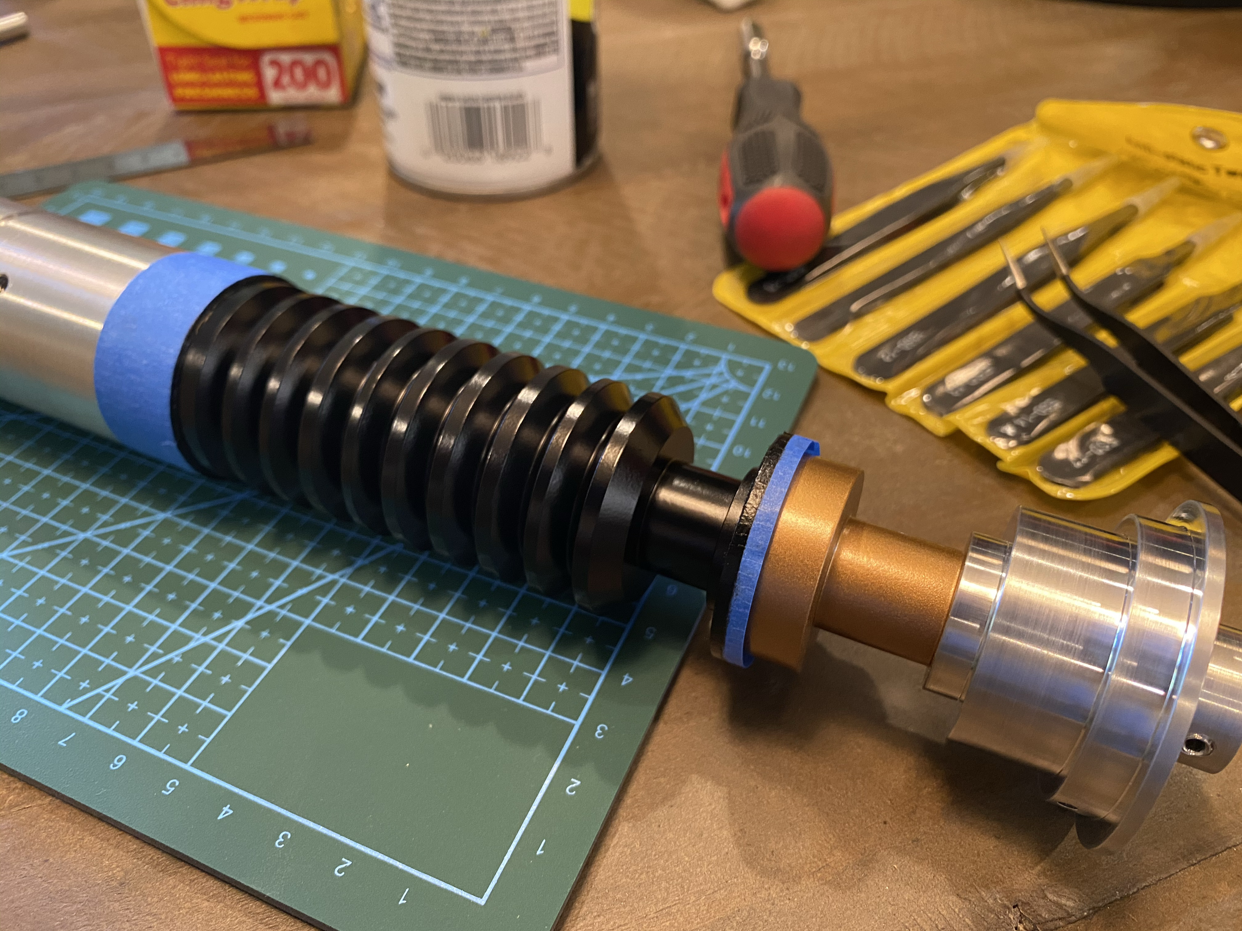

Now with 2ish fresh coats of satin canyon black. How long do you recommend waiting to take off the masking? Edit- never mind, masking came off cleanly after ~1 hour in 75°F.
Honestly with my weather here I wait 3 days
Thankfully the heat is now gone, today is the second day in a row that is normal
