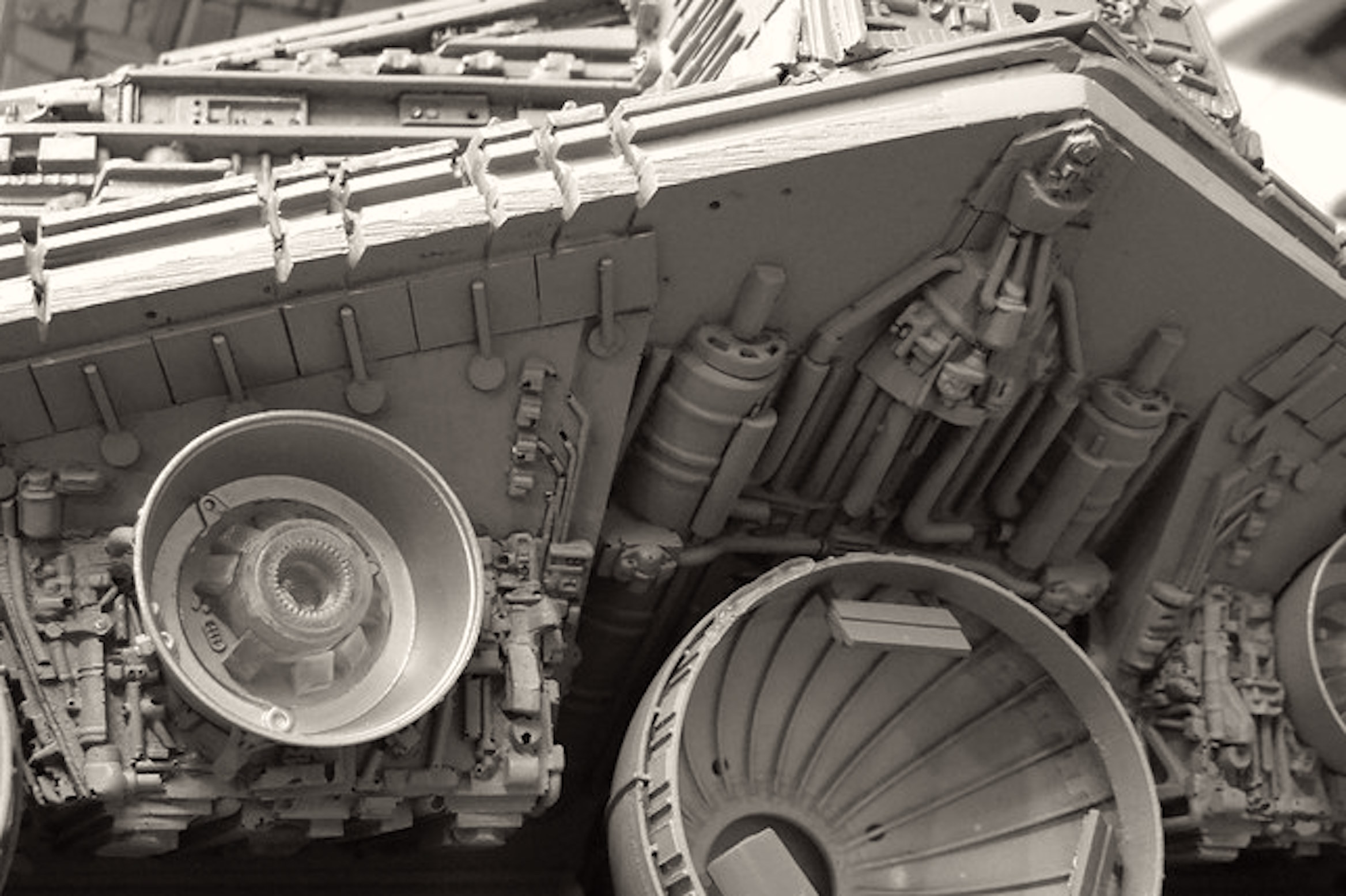

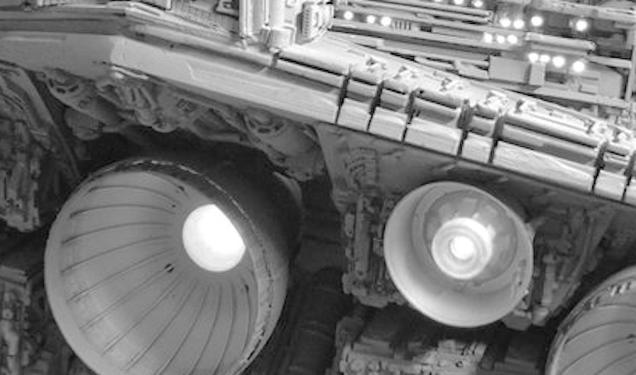

Something geometrically went wrong with the Engine Area. I built it as per Randy´s advise with Parts "Top" and "Bottom" written on the Resin parts.
But in the End, the upper triangular Engine "backwall" protuded out of the Upper main Hull plates by aproximately 5 millimeters.

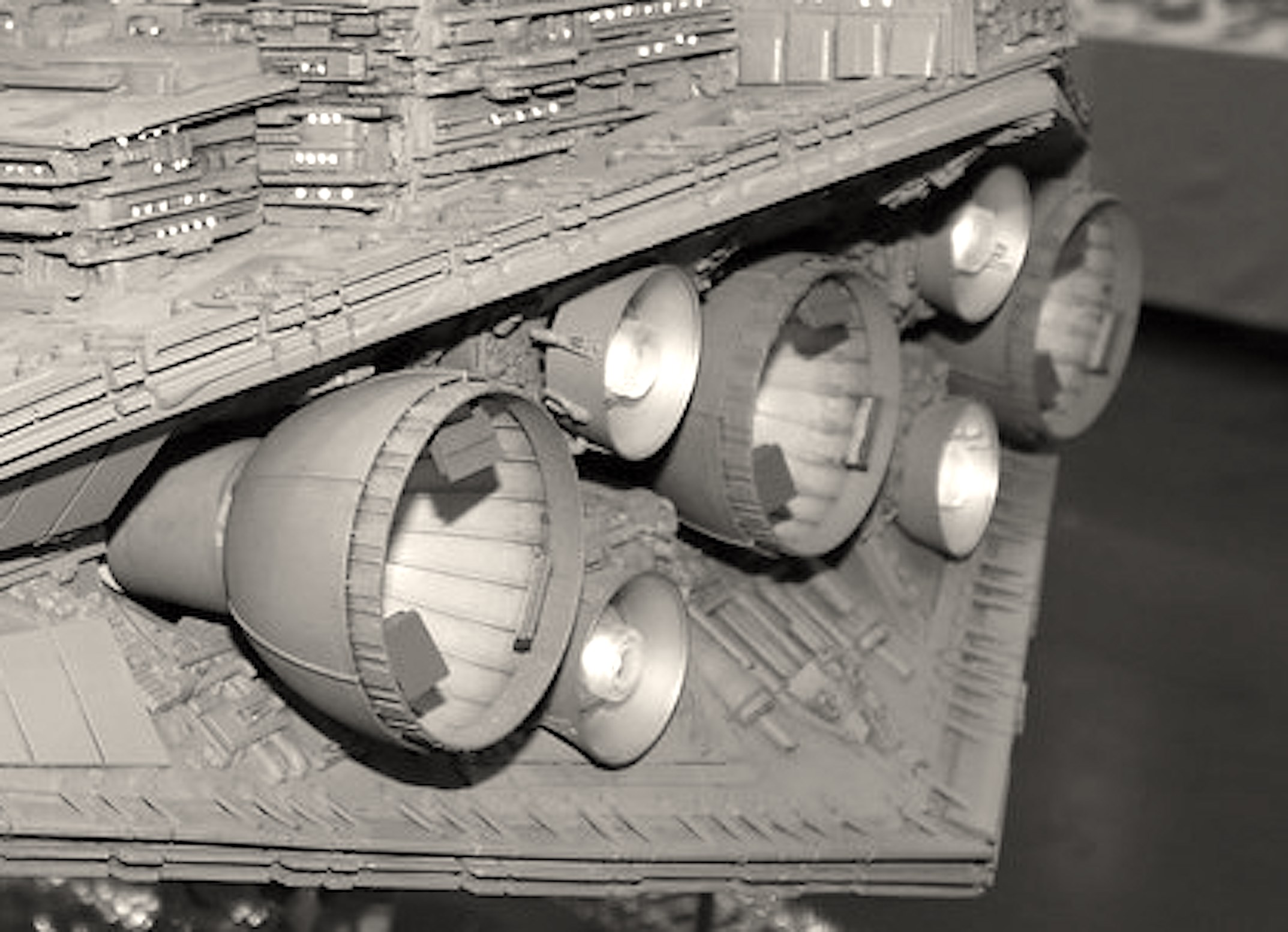

I have seen that Issue on most of the Randy Cooper SD builds:
(sorry, photos are third party since i havent photographed the Issue on my model)
The only way to solve this the easy way is to grind off a significant amount of resin material from the upper triangular engine backwall, and to try to blend inaccuracy with alot of putty and sanding.

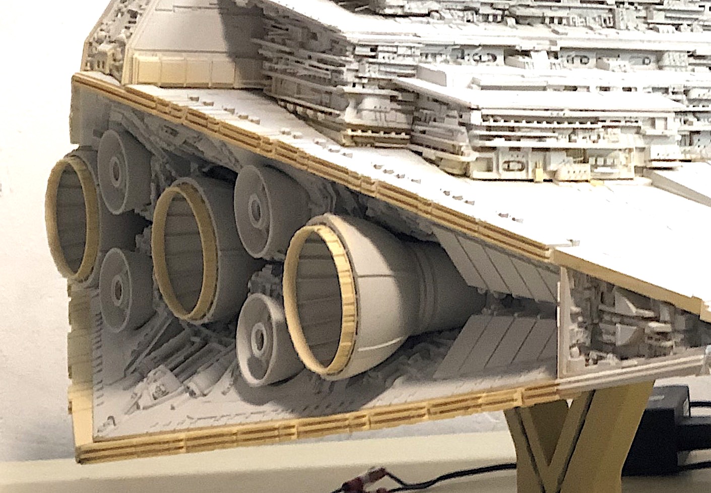

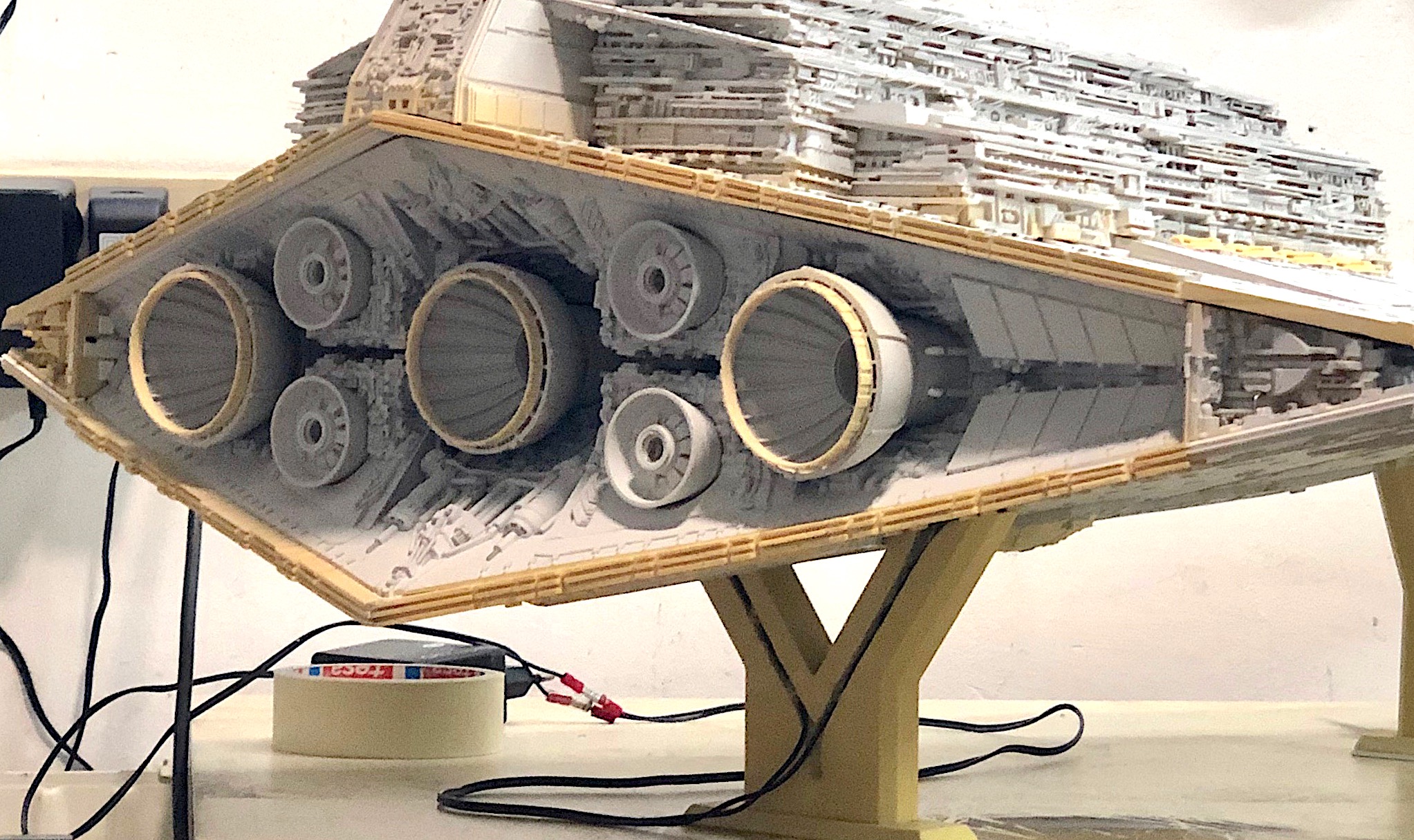

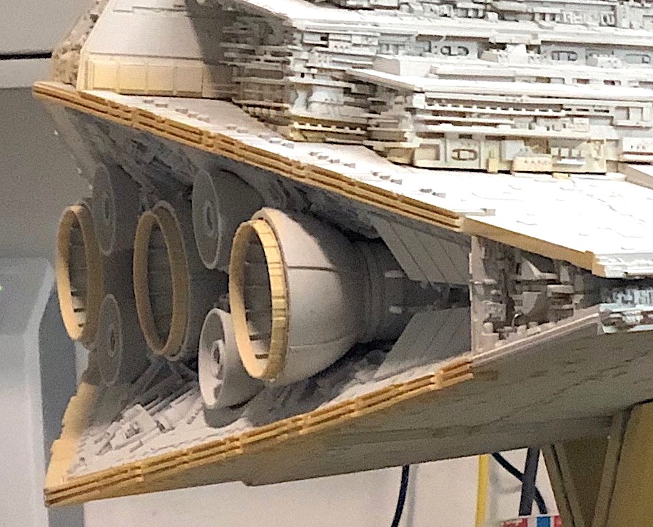

I managed to hacksaw, dremel and break out the whole engine assembly as one piece and was able to fit it back in the model, an half inch deeper as before.
Now the parts are glued in upside down. Top is now bottom, and bottom Top, dont know if Randy has written it wrong on the parts, but as said before, many Cooper Star Destroyers show this problem.
Better now:
Also fitted and glued on the outer Thruster Rings.
