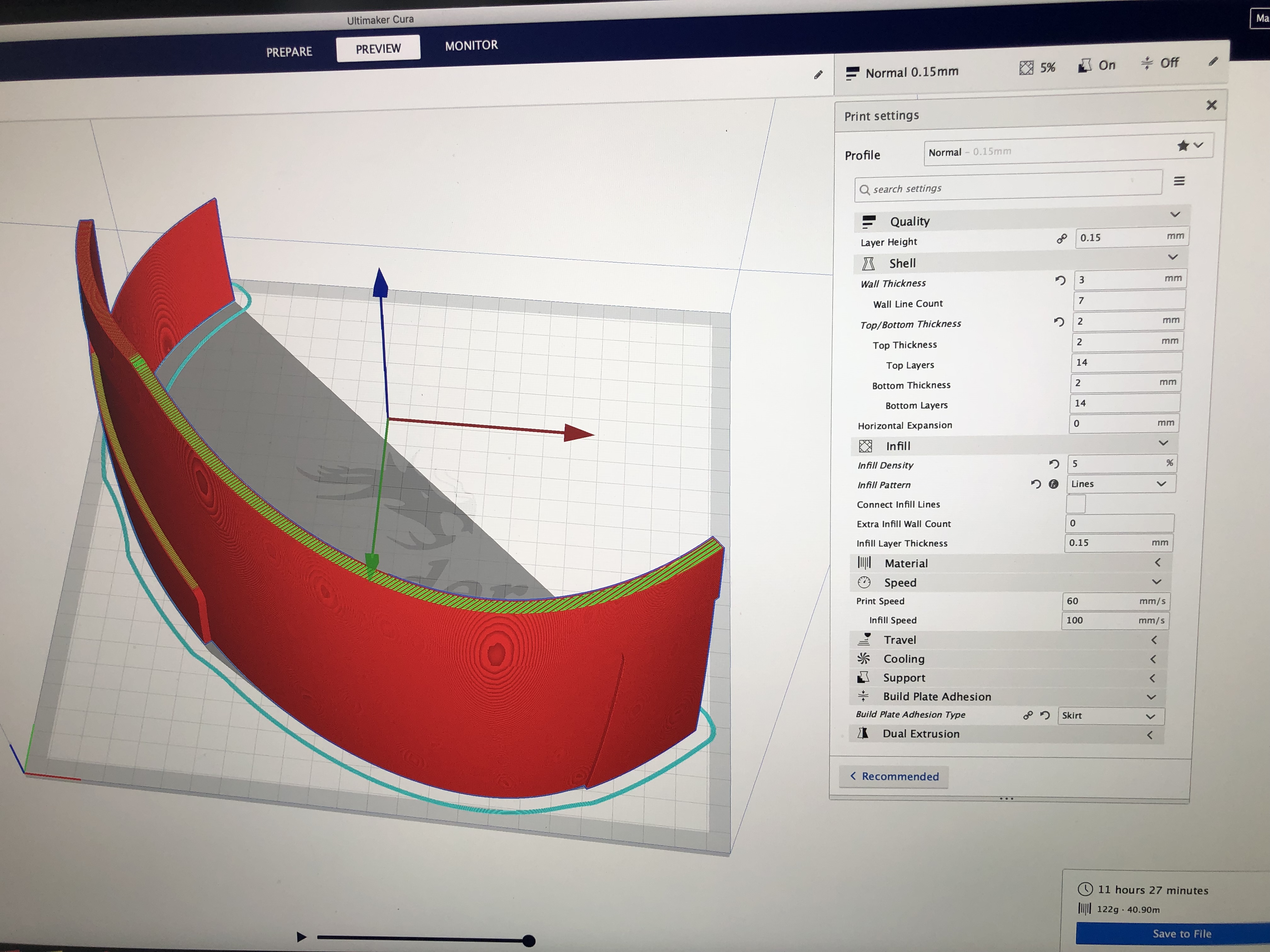

oh wow that looks great! if you wouldn't mind posting a picture of your settings so i can see about what i should have or copy them that would be awesome.
Just keep in mind these settings are what works for this file. I had to play around with it to get what I wanted. Print with overhangs and arches are going to need supports most likely. Even the infill density might need a higher percentage but I really don’t need it here.
