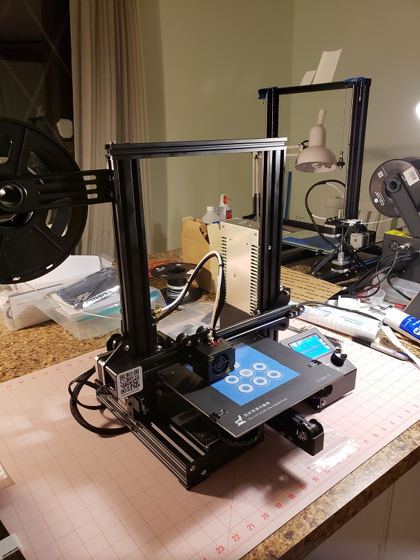

Thanks NS4. I built mine last night and dialed in the settings. Got a decent first print. I have replacement PTFE clips on the way and a tube while I was at it. The included one looks a bit ragged on the ends. Thanks for the FB link.

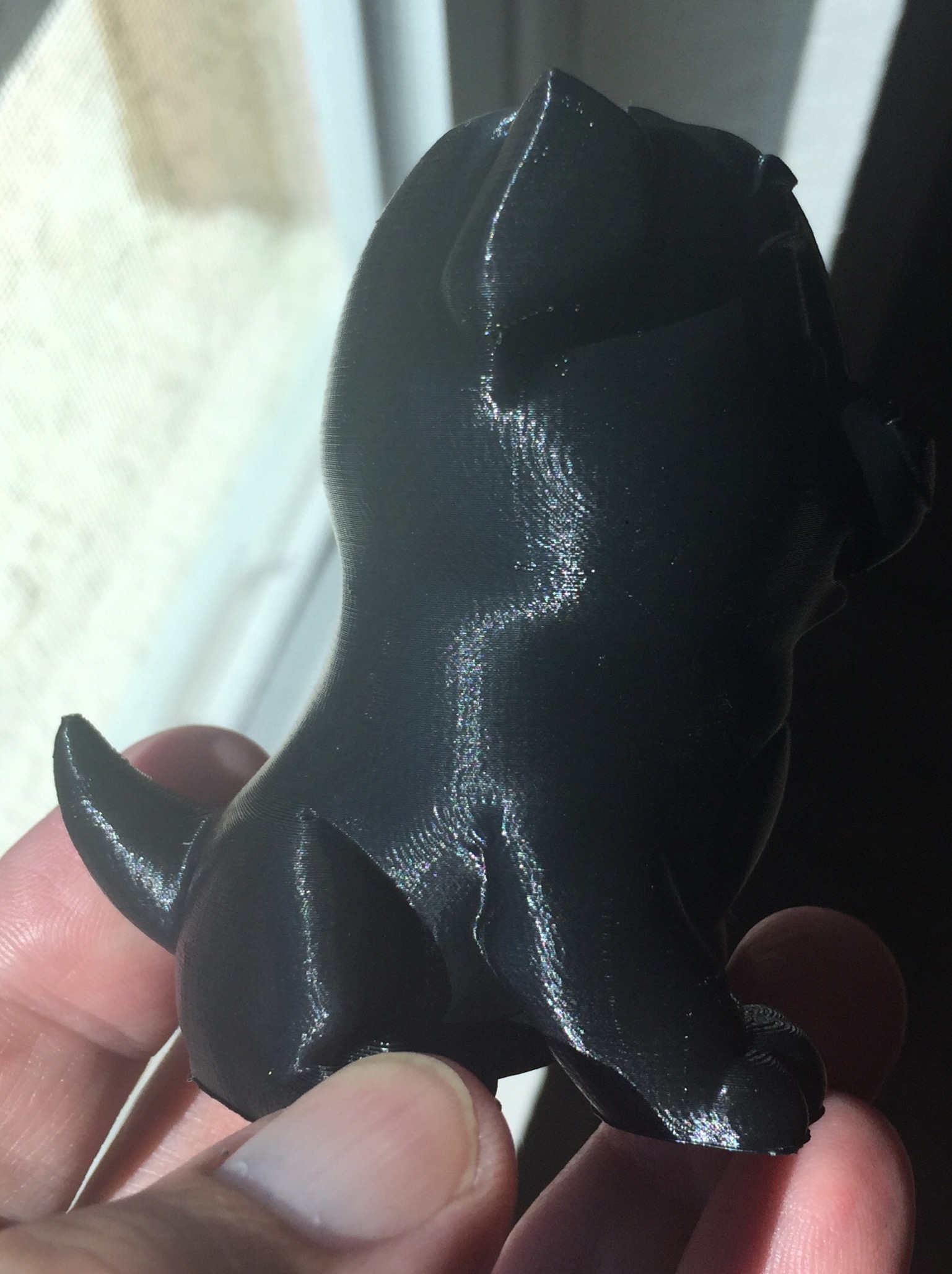

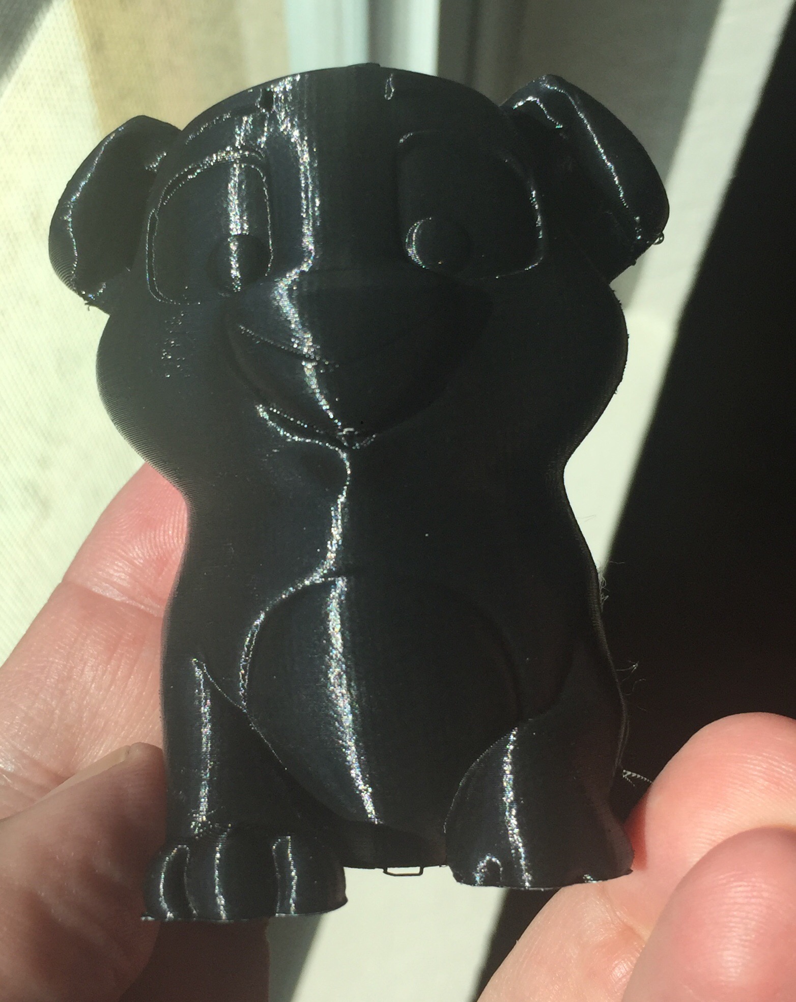

I use Cura. First print. Wuff!
