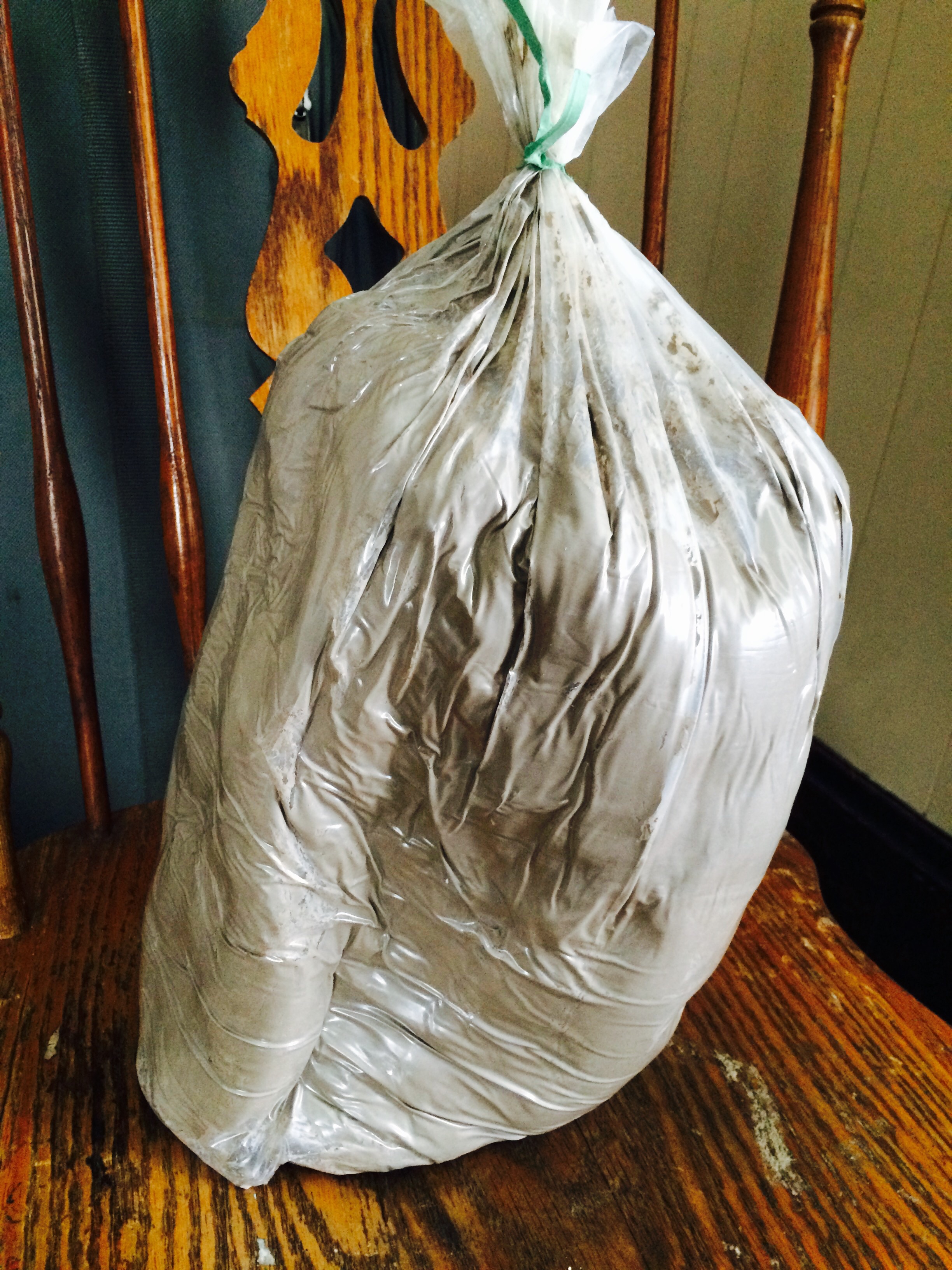

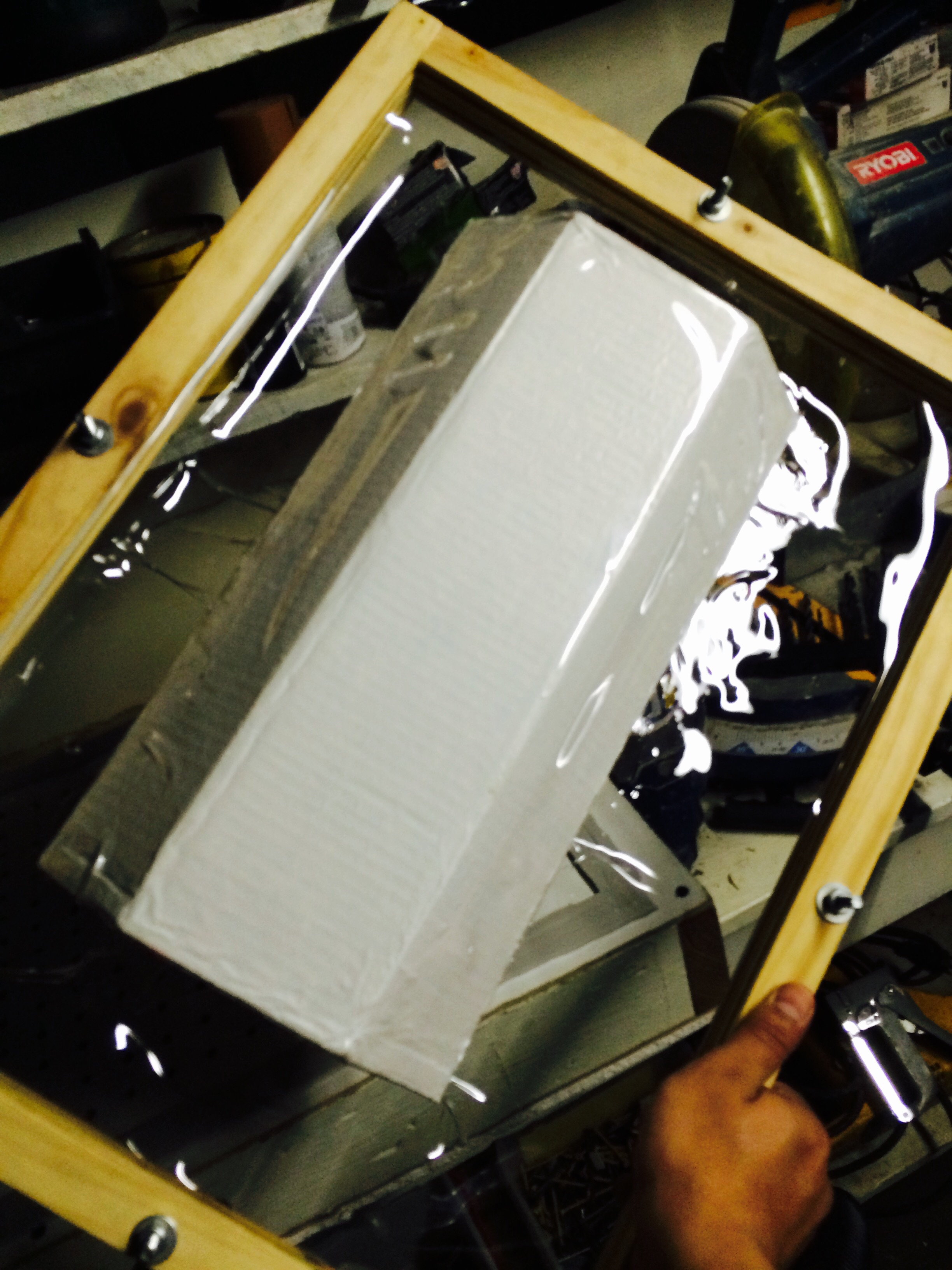

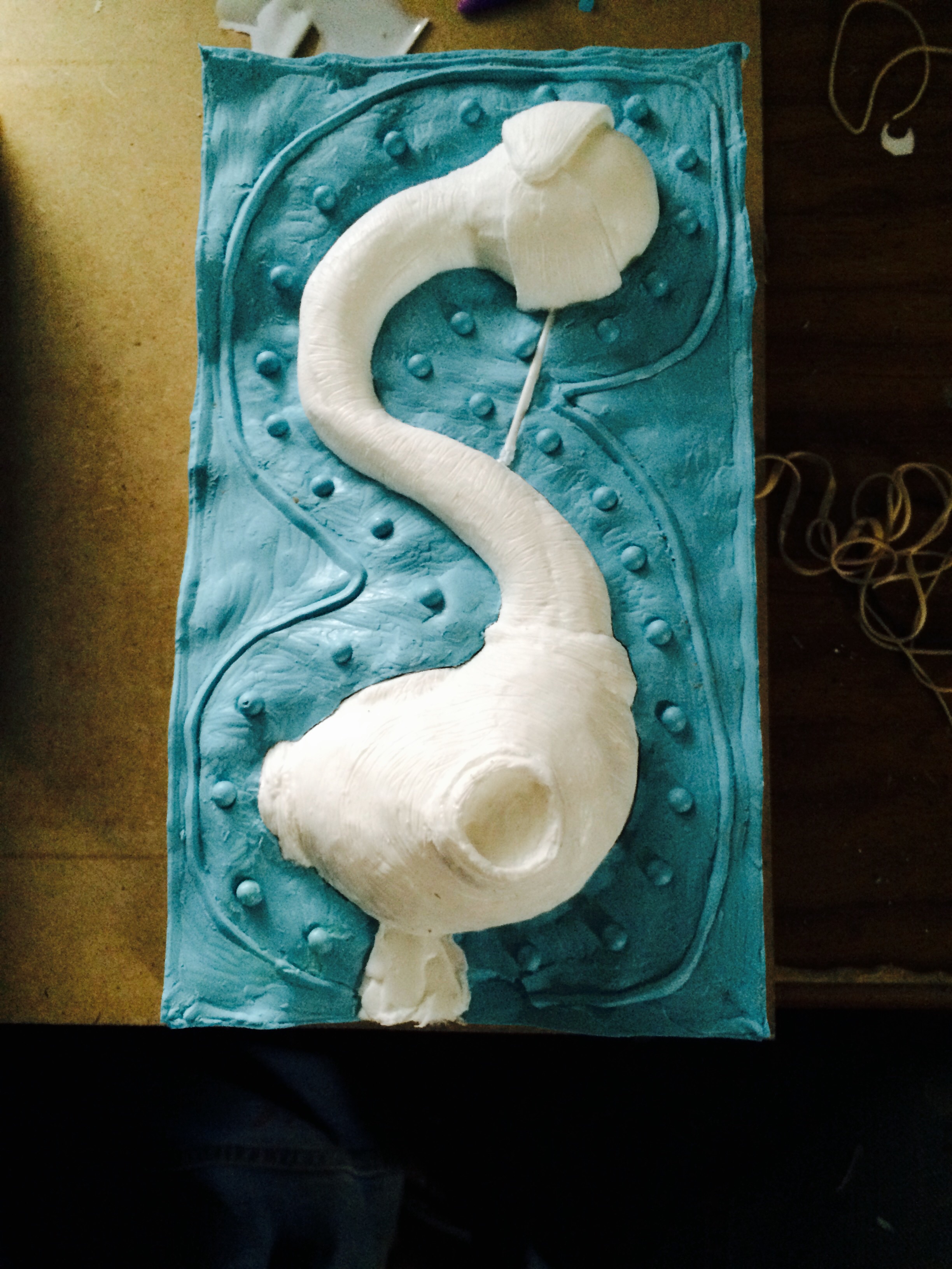

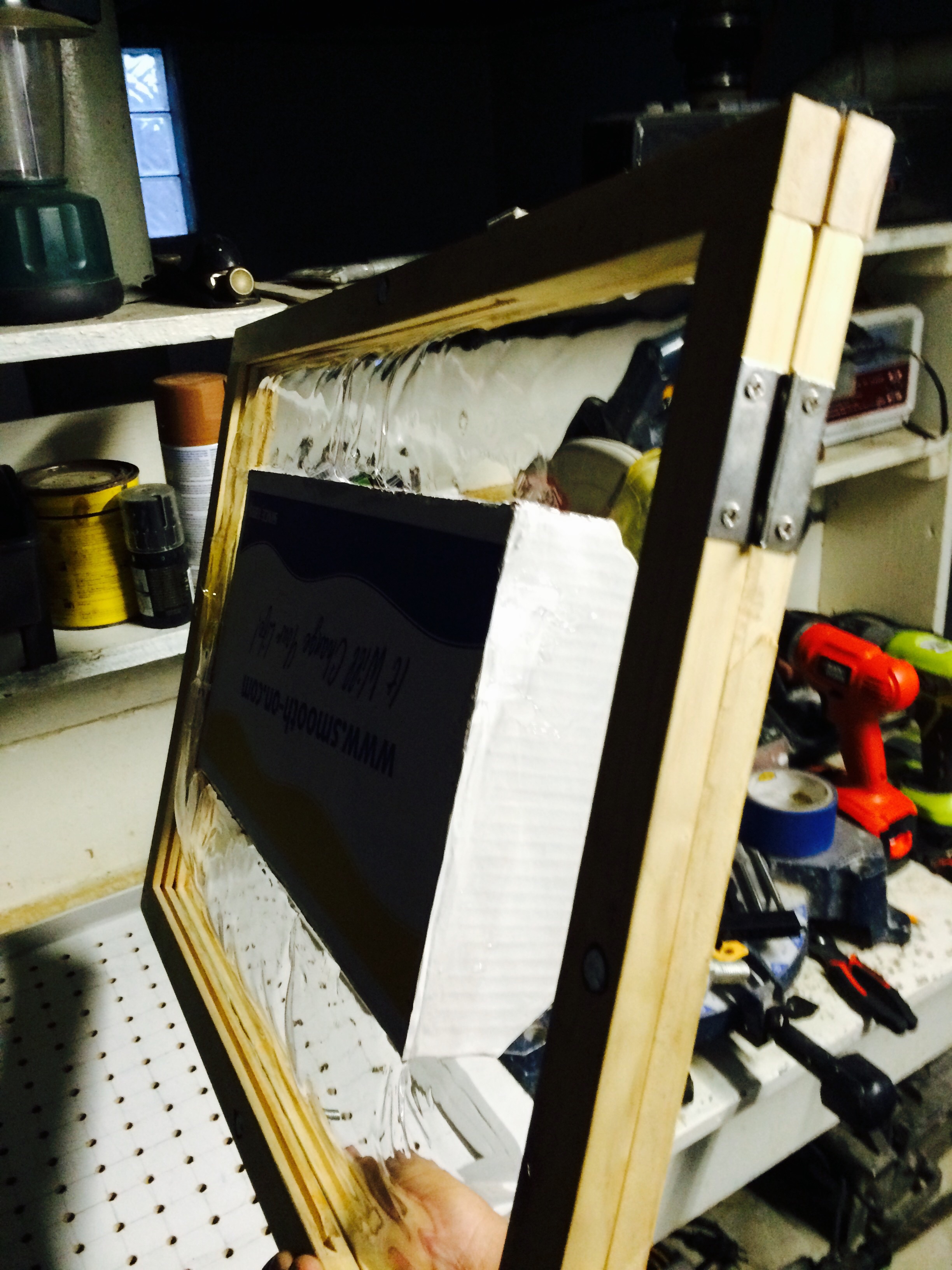

image.jpgimage.jpgimage.jpgClay arrived for my clay beds and I tested my vacuum former with the inferior heat source I had on hand, I'm fairly confident all things should work once I have a proper heating element

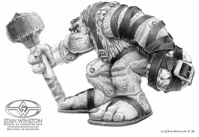

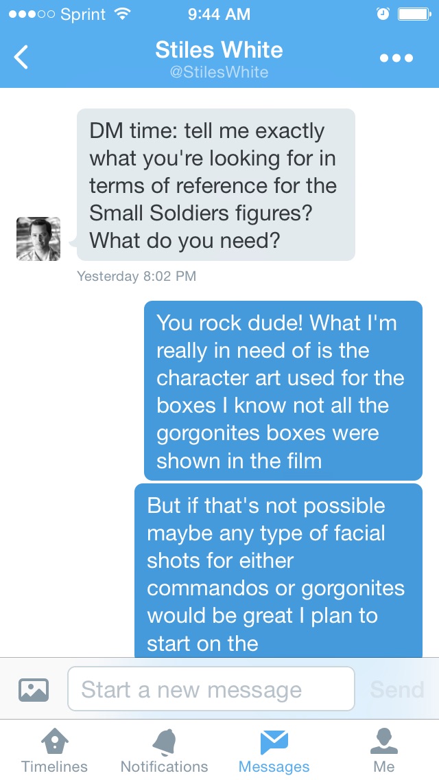

I love Twitter! Stiles white, who was the production coordinator for small soldiers, over saw everything from the film from concept to final production including all the work done by Stan Winston studios. He followed me on Twitter and sent me a direct message in reguards to my small soldiers figures ( notice he said small soldiers not just gorgonites) long story short he's going to look through his archives to see what he can provide in terms of reference. image.jpgimage.jpgimage.jpg

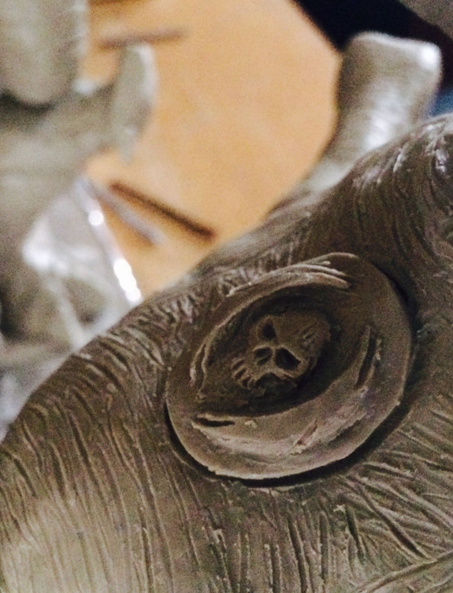

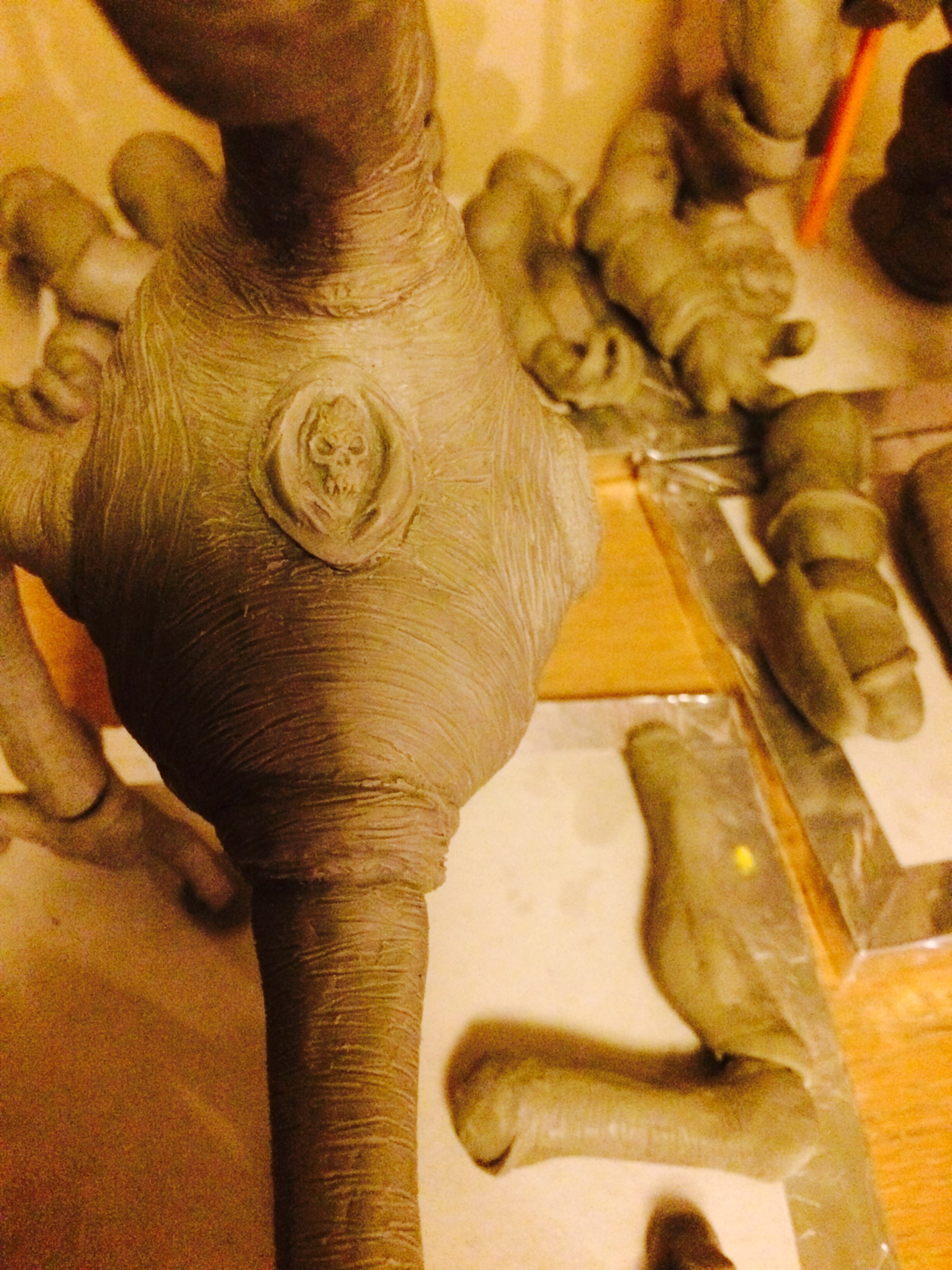

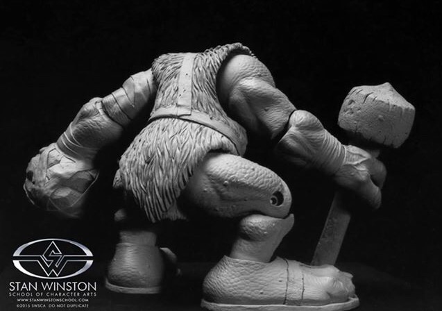

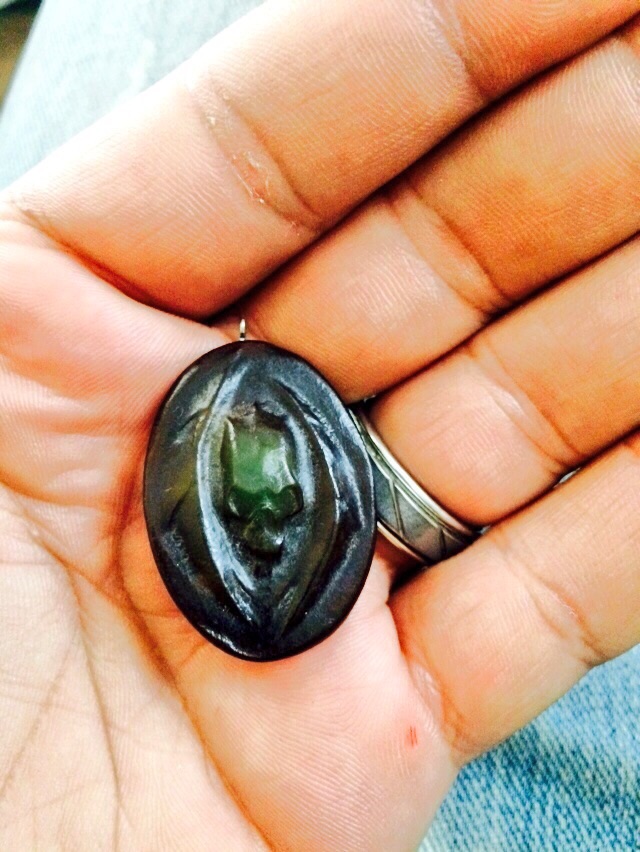

image.jpg Look what came in the mail today! It's not an original but it is a duplicate from a screen used gorgonite. It's not the clearest in terms of details but it definitely allows me to get an idea for scale. I'll just use this one as references for my sculpted emblem

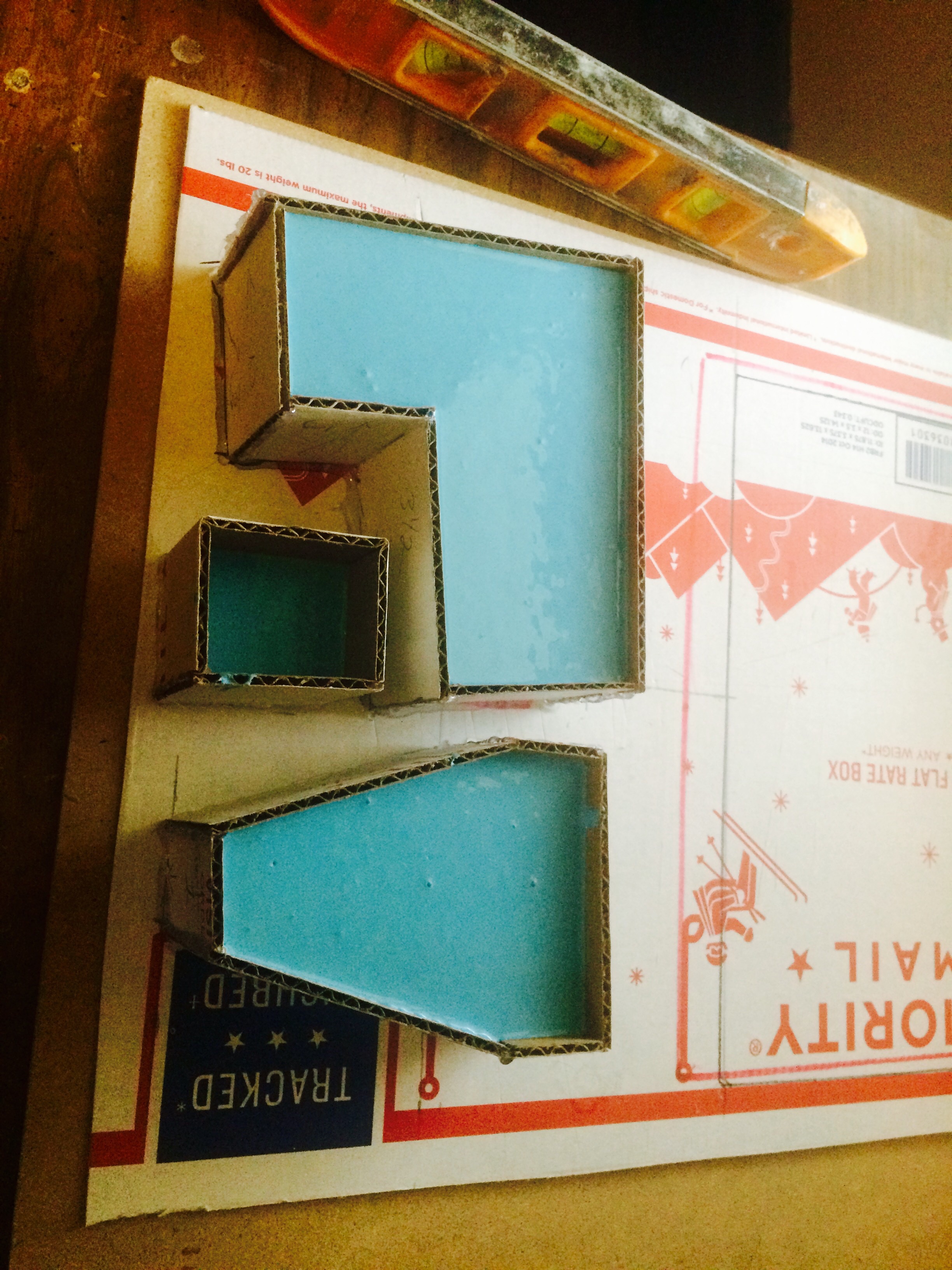

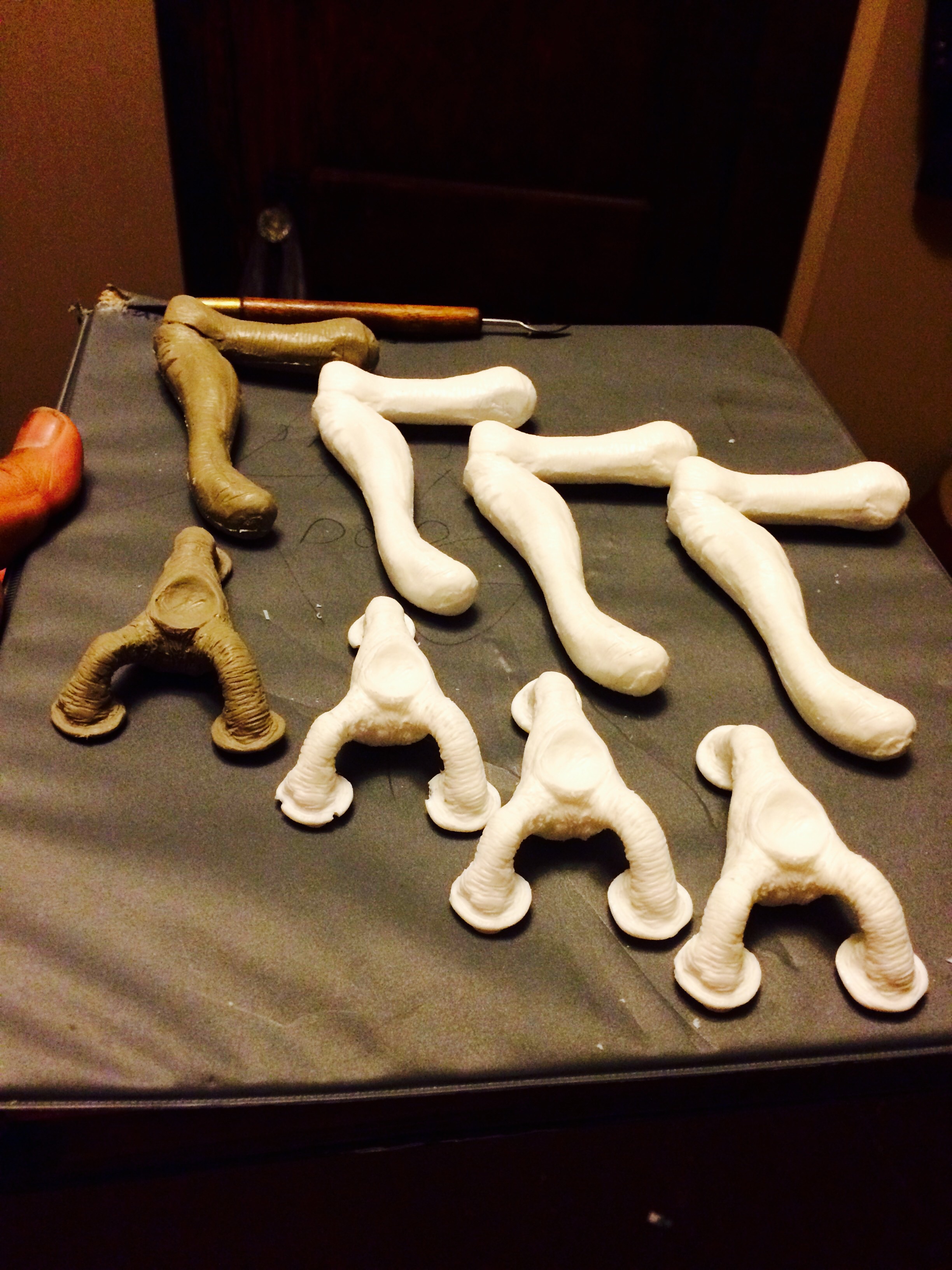

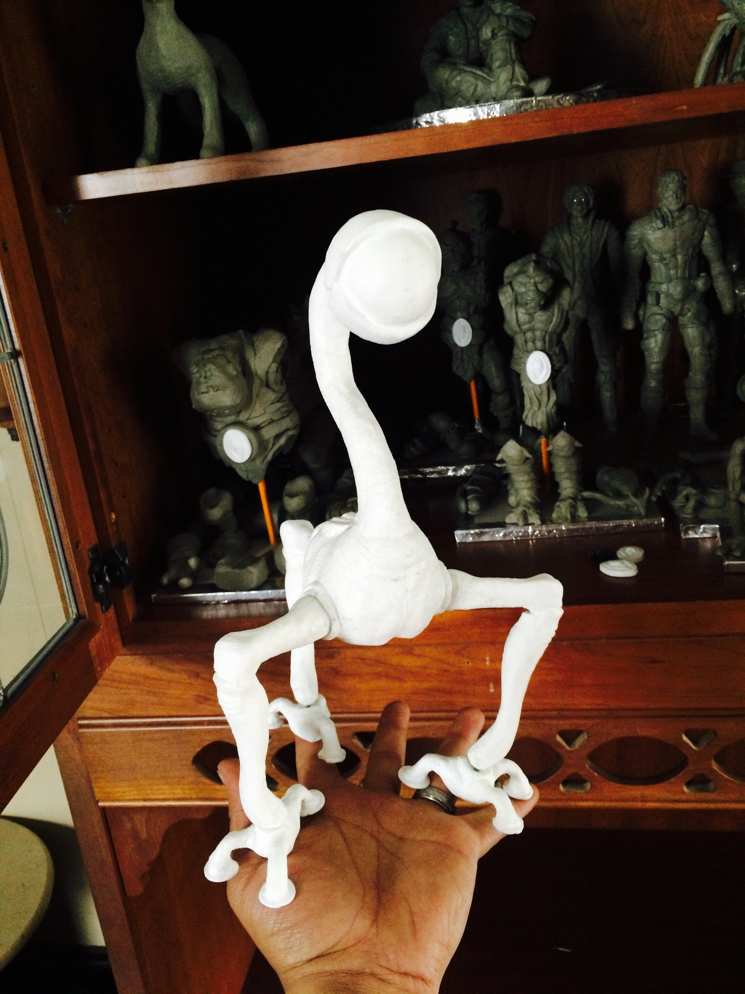

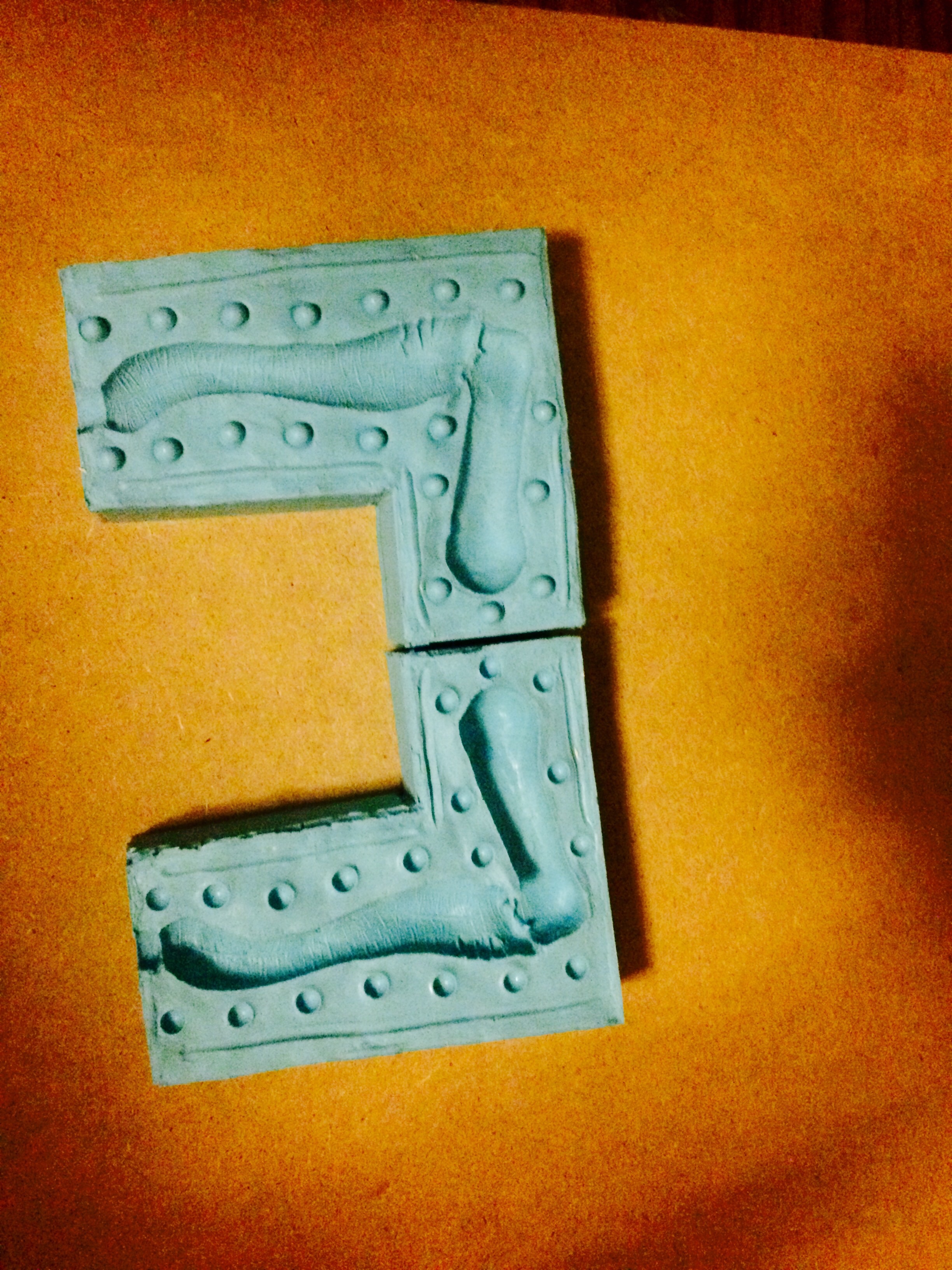

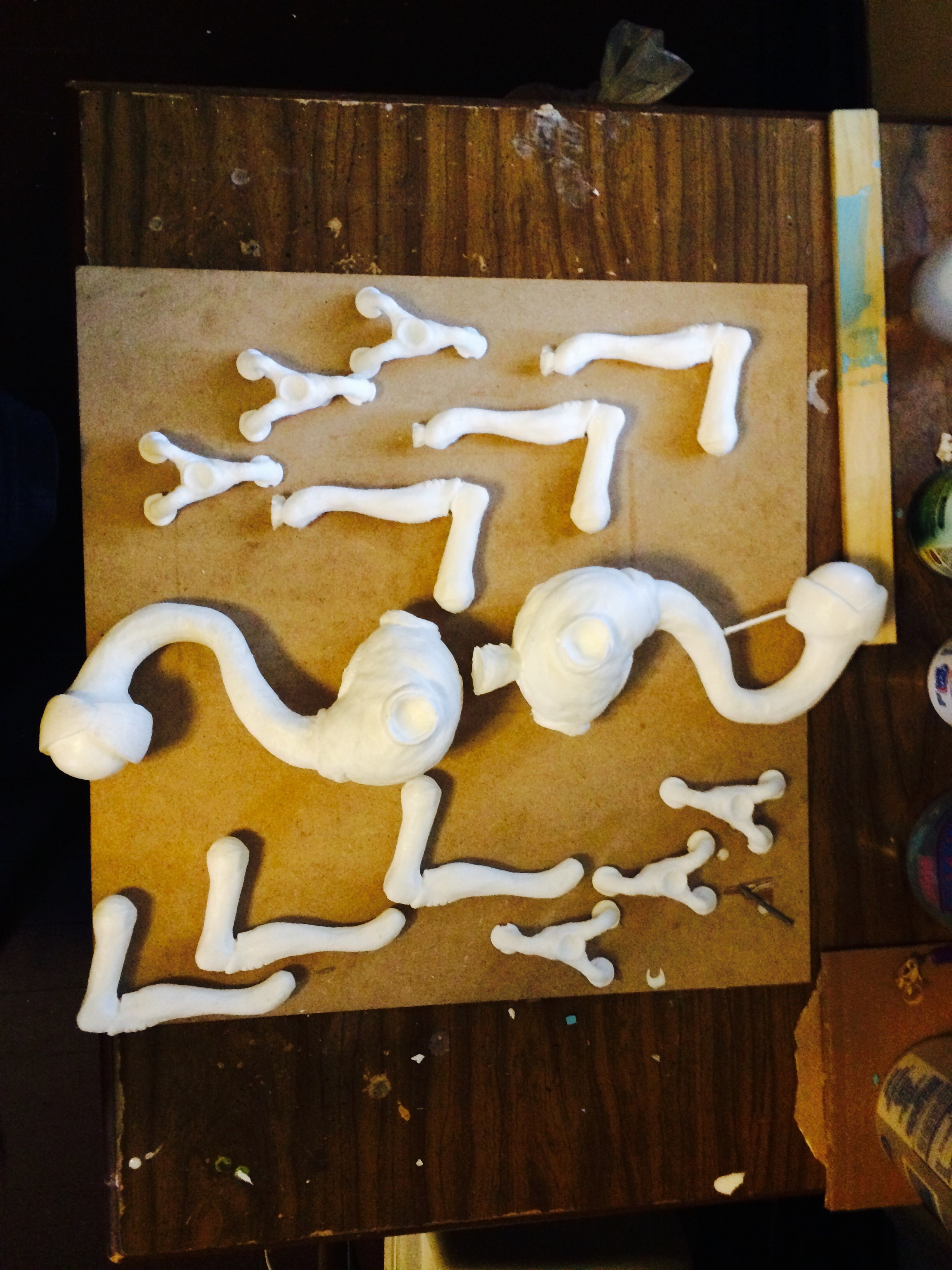

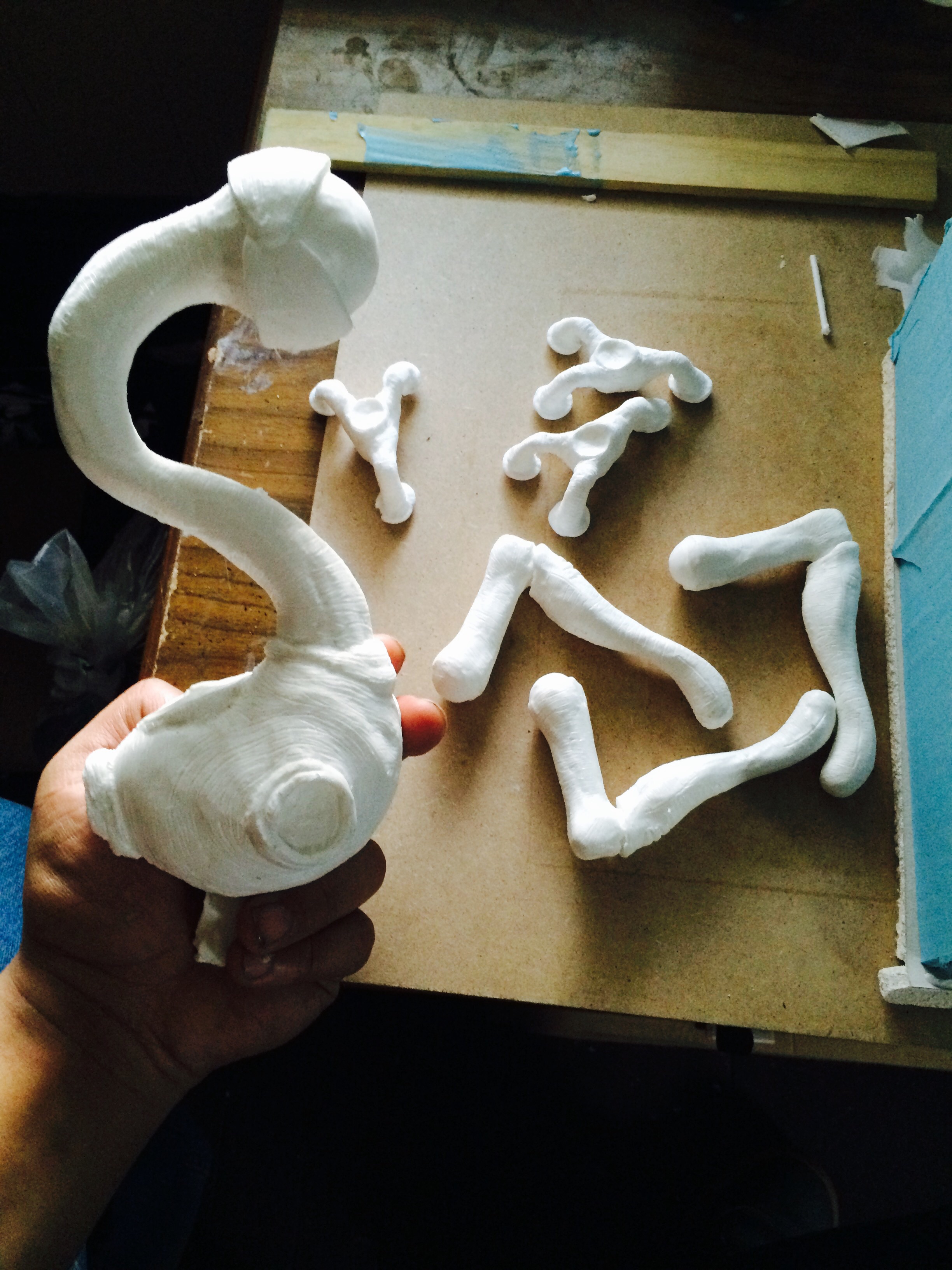

Finally got a chance to sit and mold ocula'a leg. I went ahead and only molded one leg and foot and just cast 3 copies since they all fit each leg hole ( saves me a bit of silicone) I'm going to be adding details to the emblem a bit foe definition. Still have things to refine not to mention slamfist and punch it's height & bulk up. In the mean time Here are my progress shots image.jpgimage.jpgimage.jpgimage.jpg

Thanks, if all goes well I should have the mold for ocula's body in a couple days, making those clay beds nice an clean is such a time consuming thing but it pays off seeing as the legs had little to no excess flashing. I've got to aquire a decent airbrush to do the paint job justice. I hope to have more updates soon. After ocula's mold is complete I'll be finishing scratch it's teeth and add his final details ( warts and muscle lines) then he'll me up next for molding since he's so small it will be done in no time. I'm talking to someone who owns an archer, slamfist and insaniac stunt prop, hopefully as time goes ge wouldn't mind taking some nice hi res shots and detailed measurements for me to accurately tweak my base sculpts. I've got my fingers crossed :)

Thankyou :) I finished the mold for the body and I'll be casting the first test to assemble and see what adjustments I may need to get nice clean casts. I'm slowly working on adding size to slamfist after reviewing the 60+ behind the scenes photos of slamfist from concept to finished character that stan Winston schools posted to their facebook page a few days ago, I've got plenty of reference now. I hope they plan on showing all the characters in this manner

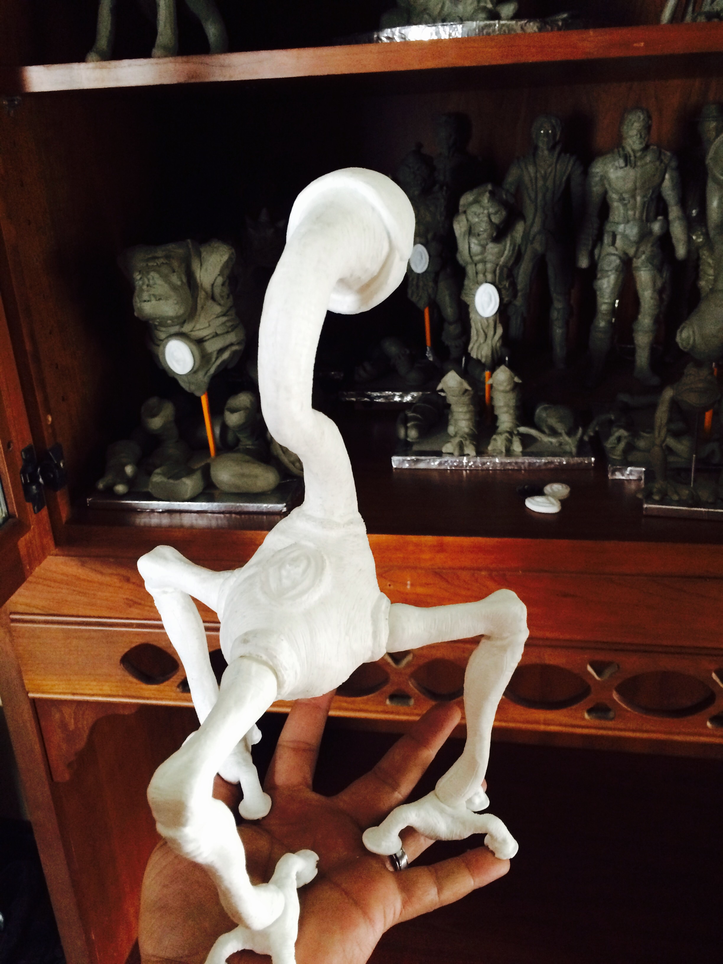

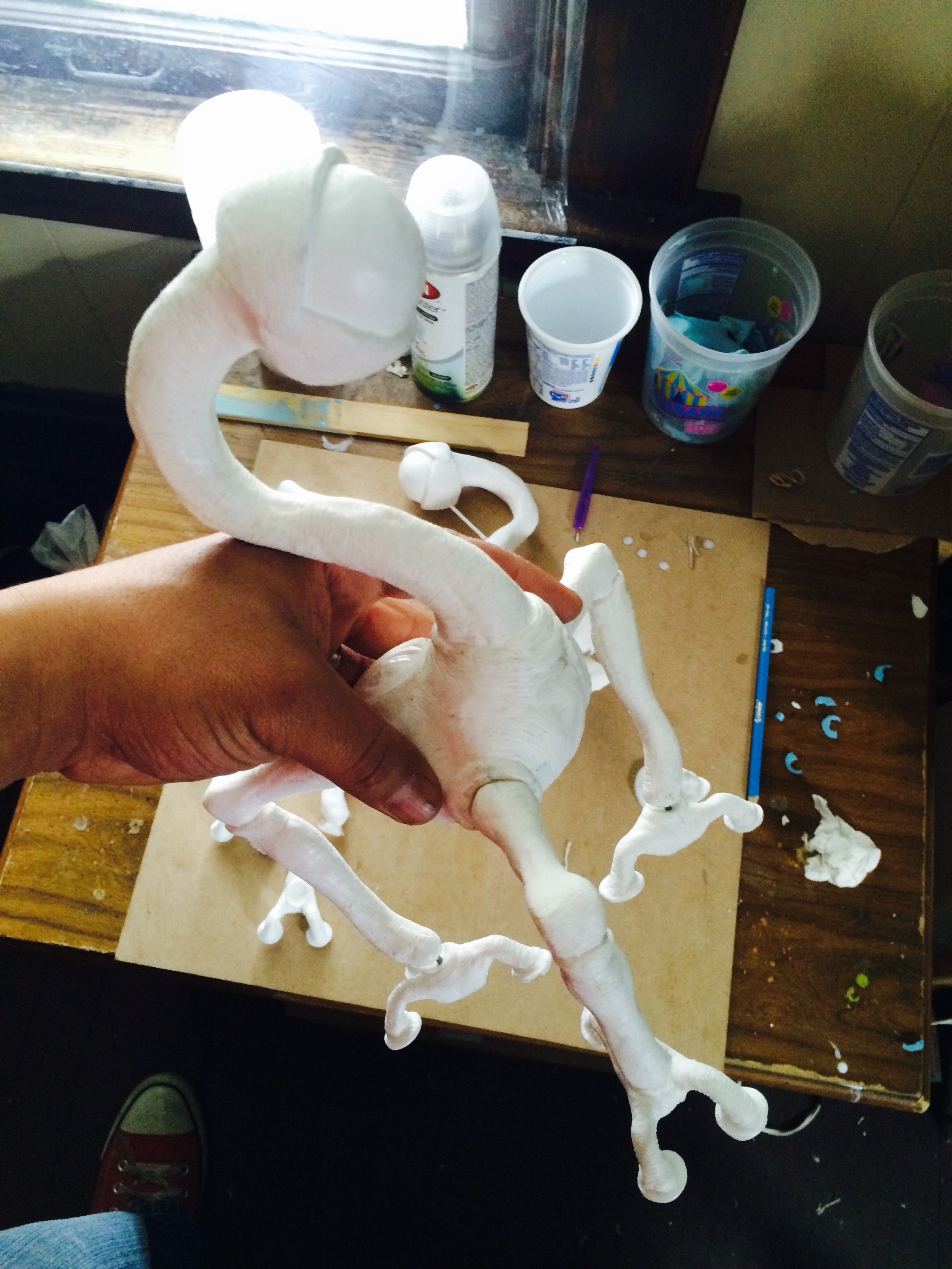

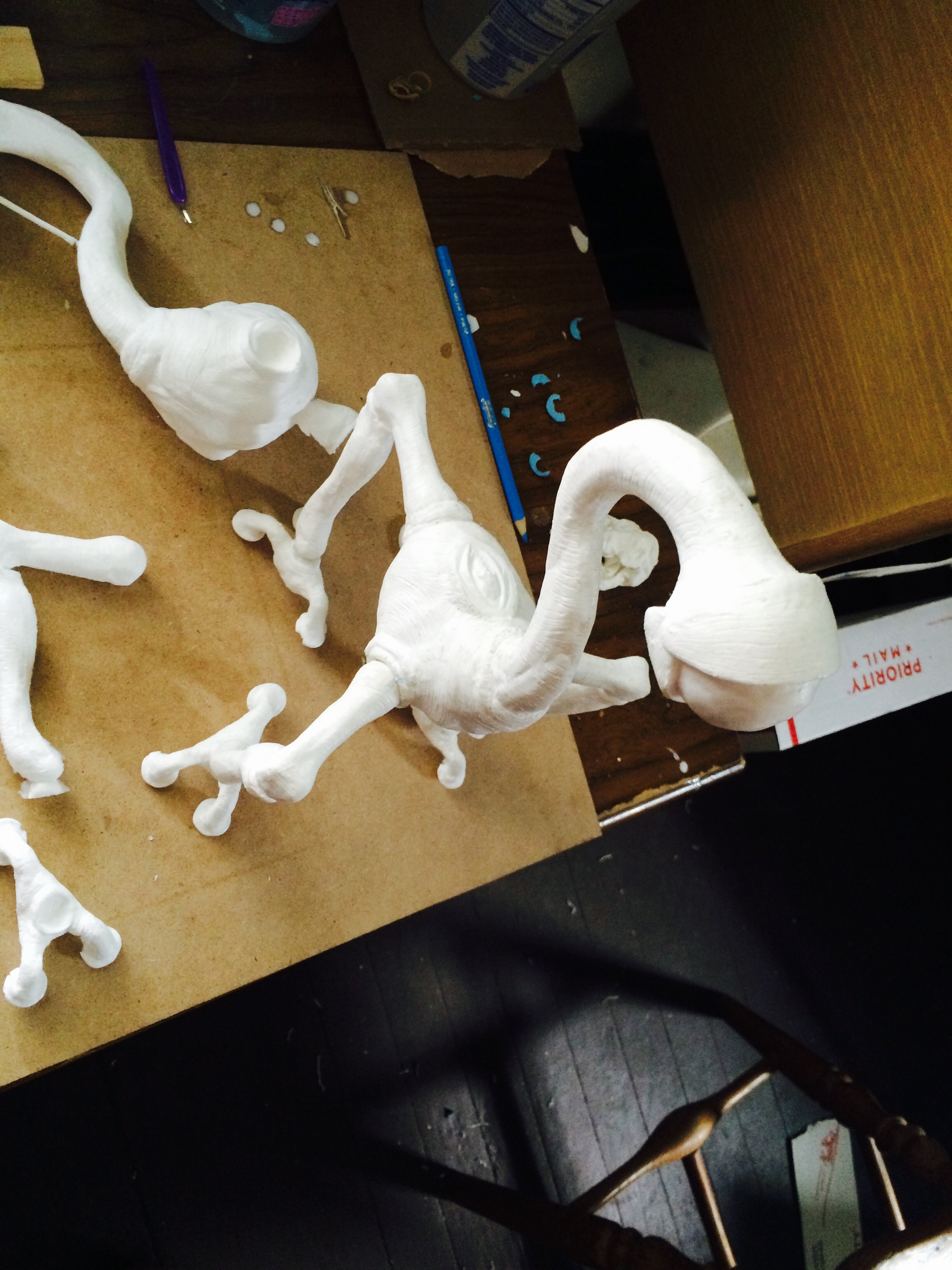

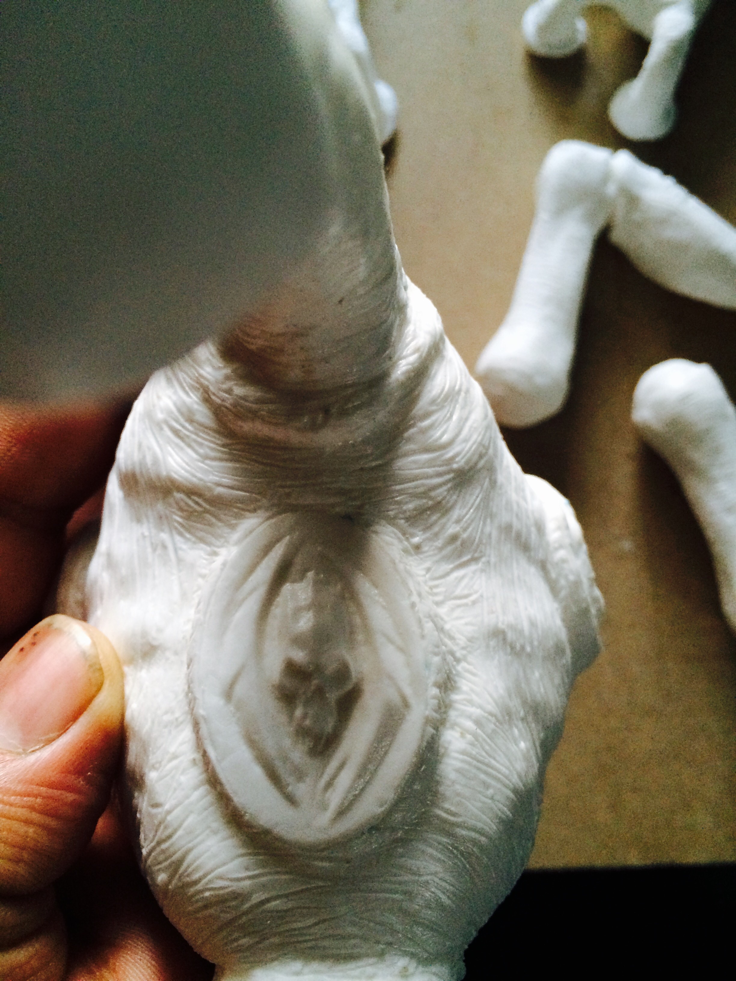

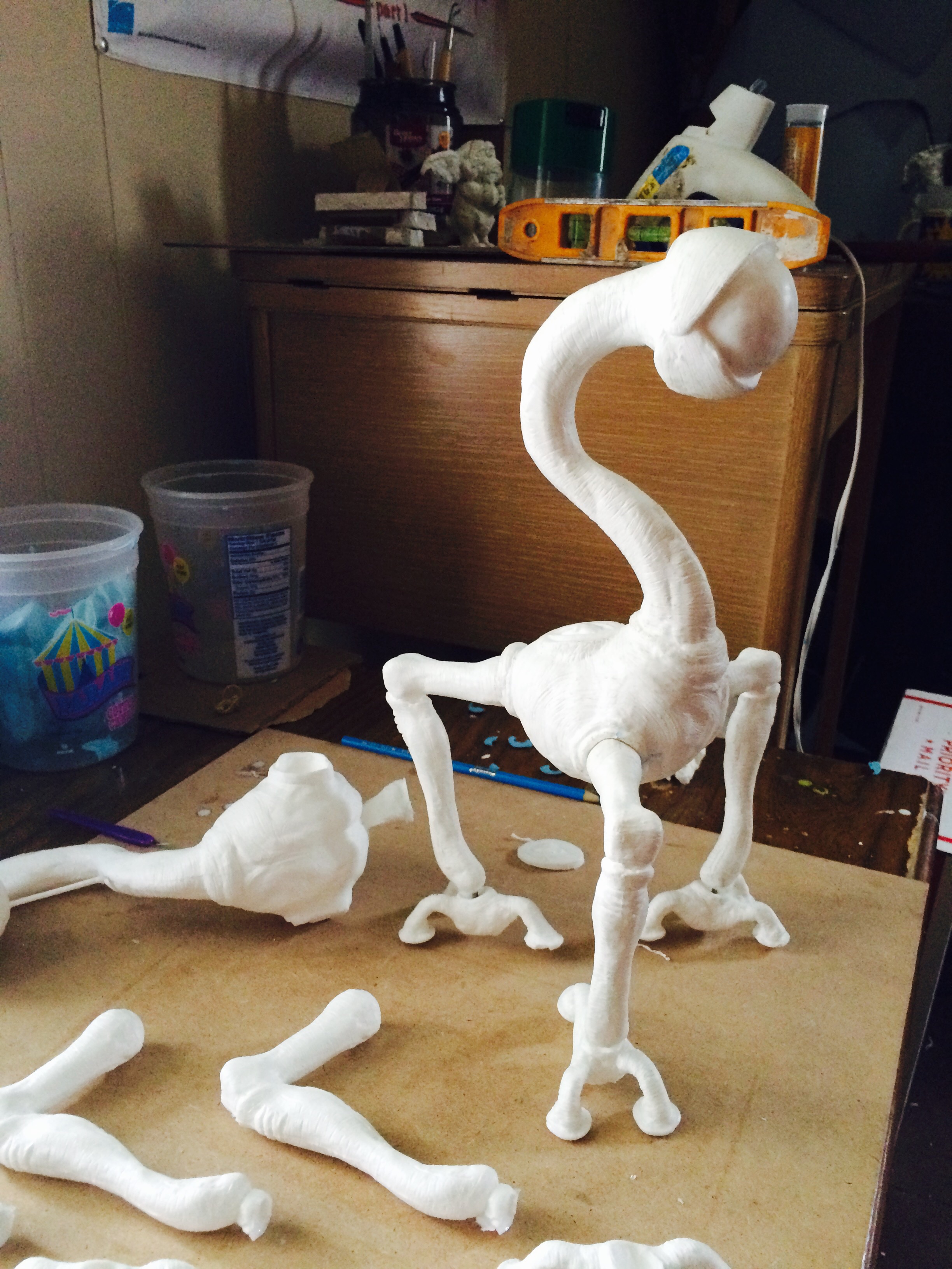

image.jpgimage.jpgimage.jpg Some assembly required XD gotta drill some peg holes to attach the legs to the body and some cleanup work and ocula will be ready for paint (and false eyelashes) I cleaned up the emblem to better see the details but still needs refining.
