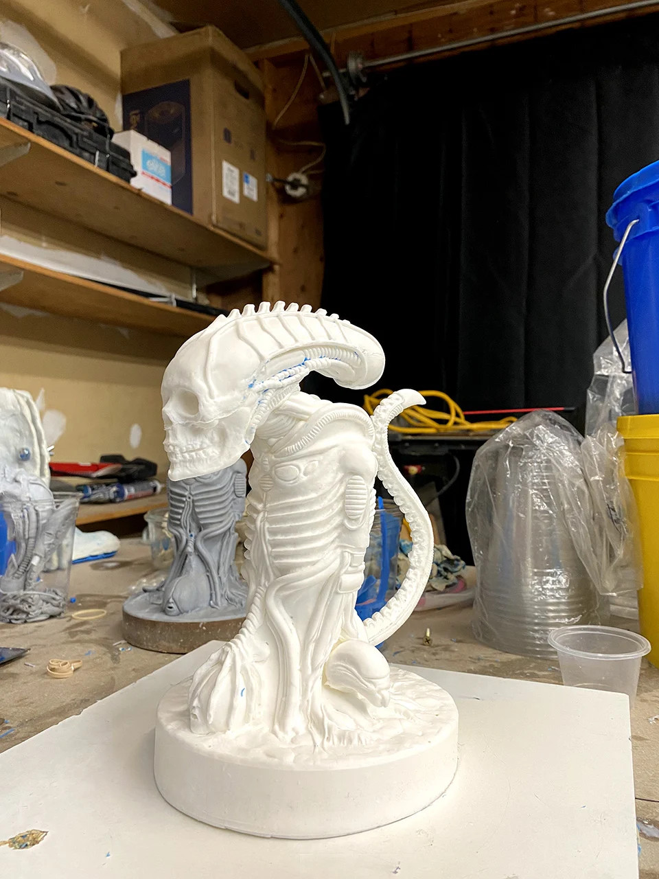

  • Beginning the print layer

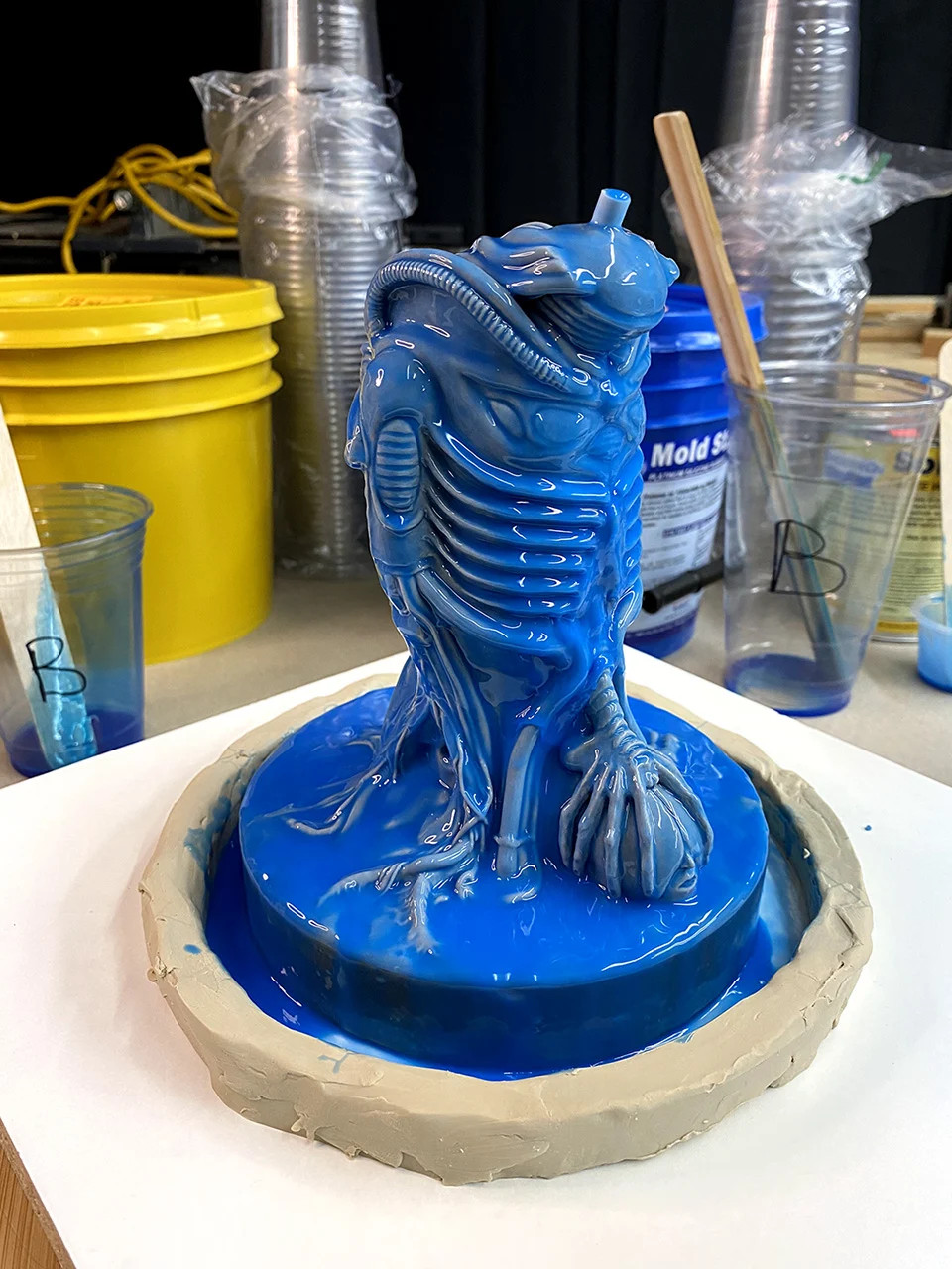

  • The clay shroud and shims

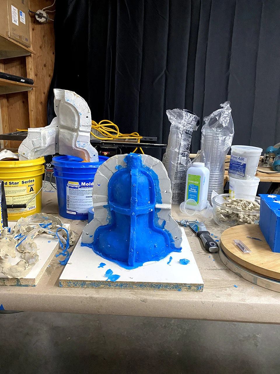

  • Shell complete and prepping to pour the glove

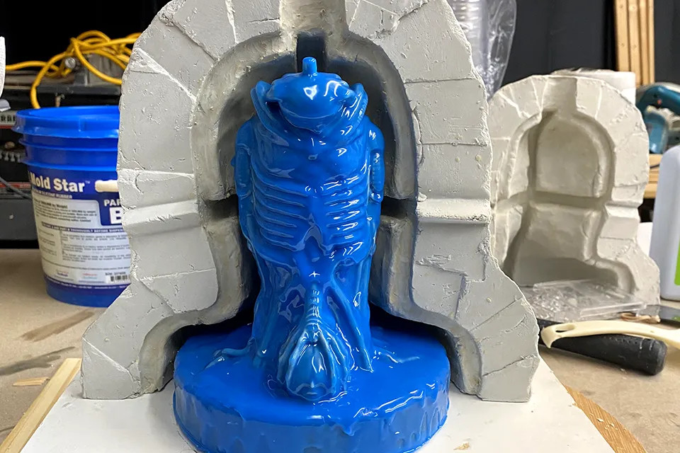

  • Glove in shell (cracked the shell but was able to fix with some super glue)
  • Body separated from the glove

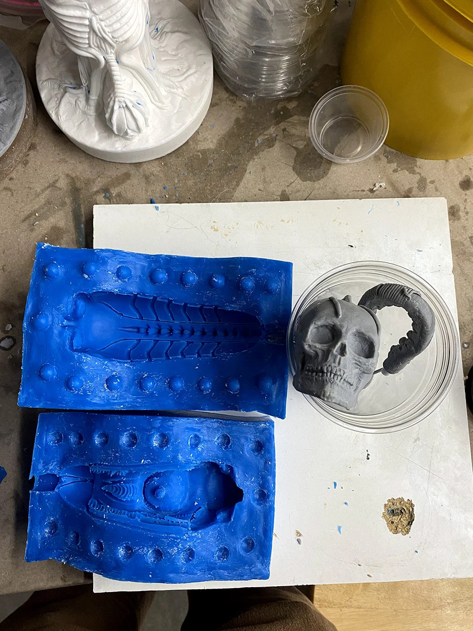

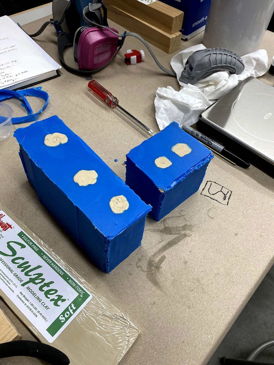

  • Tail and smaller head box molds
  • Main head mold
